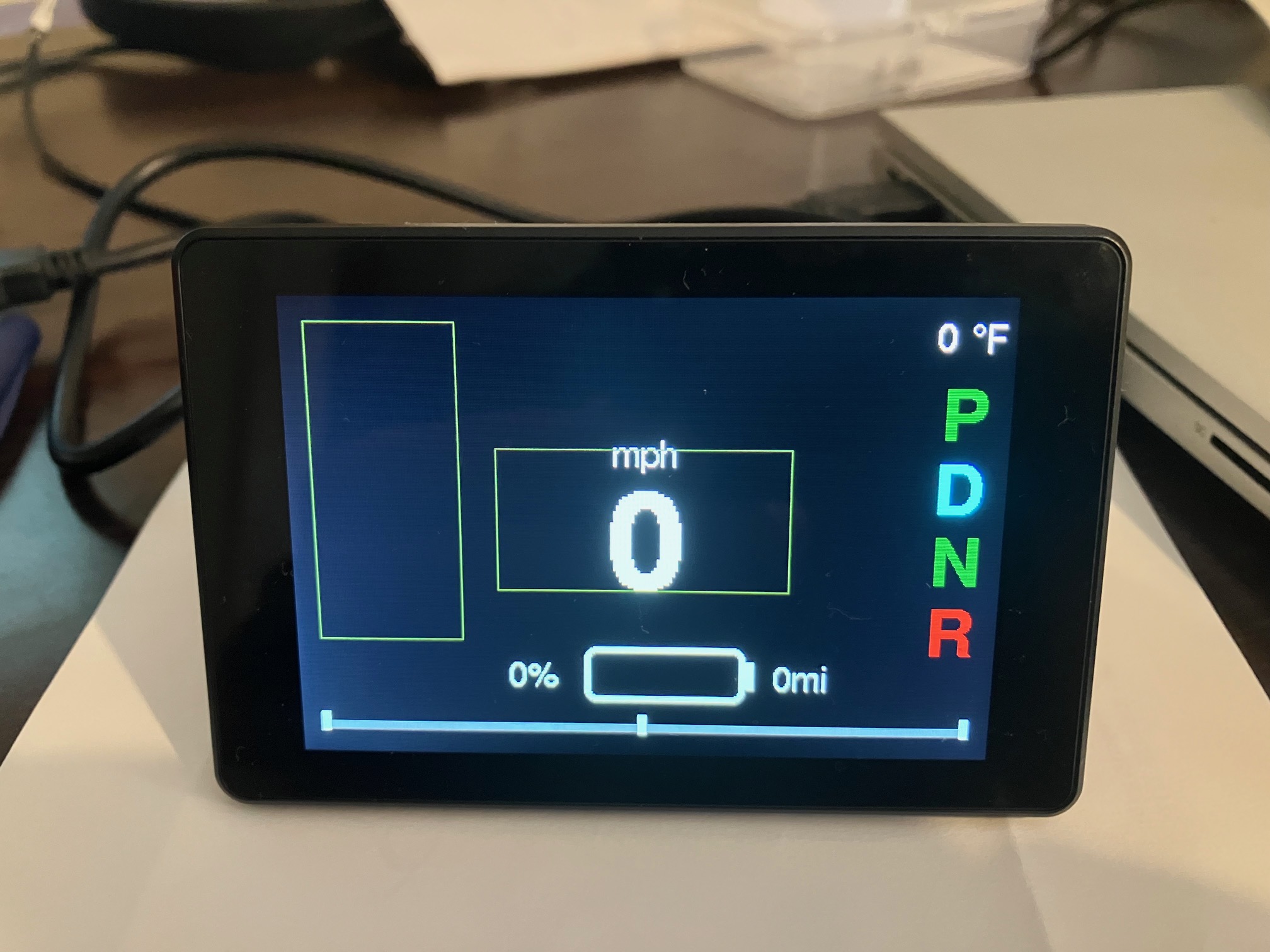

I've been experimenting with "cheap" displays from AliExpress, with the intent of running user interface / display off of them in my Beetle project.

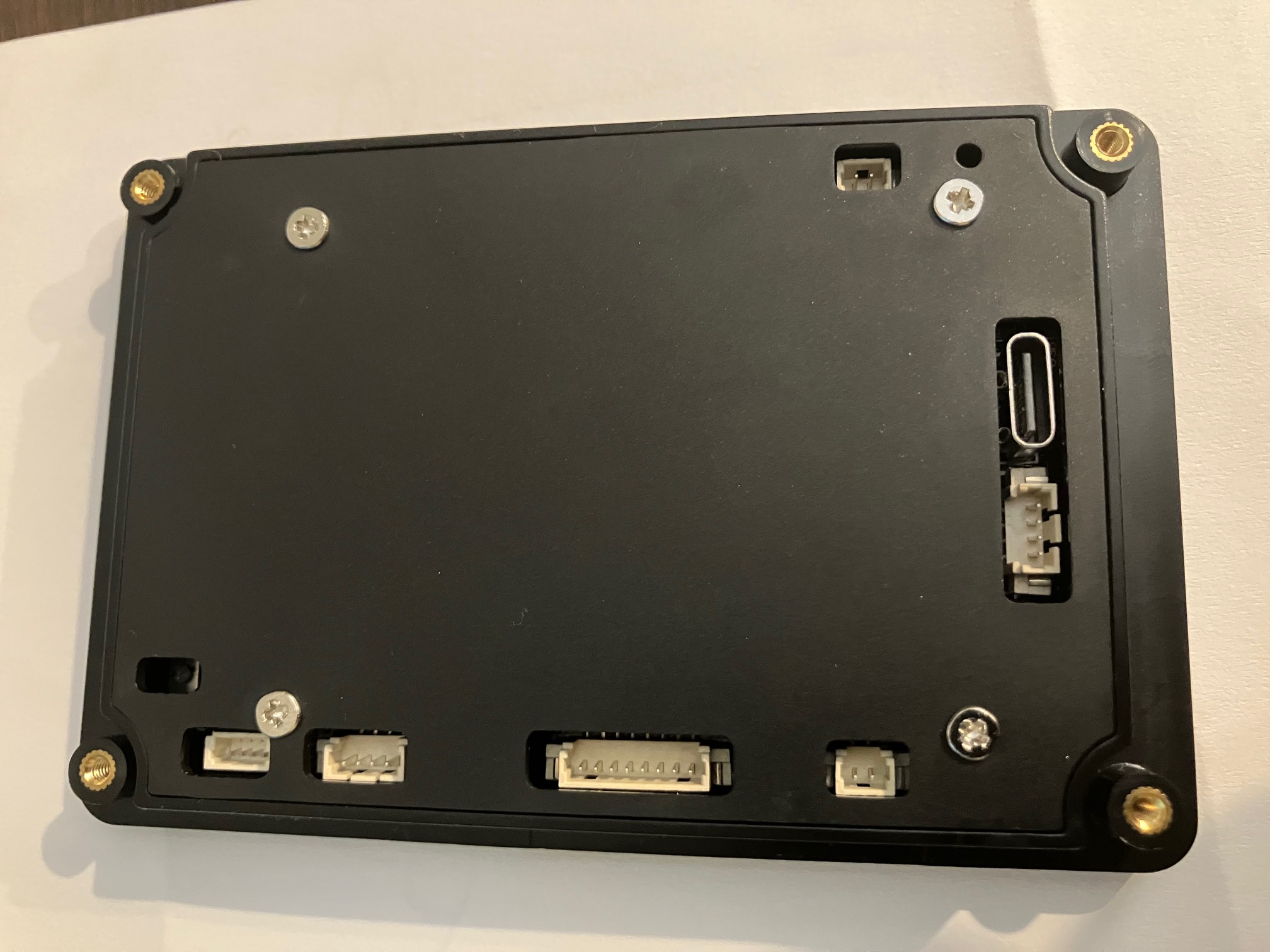

The display I have started with is the Guition JC3248W535 display. This is the cheapest display at <$20. It is defined as a 320 x 480 pixel 3.5" TFT display with capacitive touch:
This display looks promising because it has:
ESP32 S3 chip, dual core (of which I am only using one core for Arduino) Actually no longer true, I am now multithreading to improve the graphics and touch performance.
Lots of memory (SPIFFS and PSRAM)
Wifi 2.4ghz
BTLE
USB-C and serial comms
SD card
Speaker output
10 exposed general purpose input output (GPIO) pins, split into 3 japan solderless terminal (JST) headers (in 1.00mm and 1.25mm)
Can be powered by serial 3.3-5v, USB-C, or battery
At first it seemed like there was not a lot of support for the display, but with some tinkering with libraries and my own code, I have pretty much everything I need. Here is the display I have programmed:
On boot:
After giving it Serial commands that mimic CANBus:
I modeled the display off of my ID.4 center display. I am using the Adafruit_GFX library for graphics and the bb_captouch library for touch, and these things work.

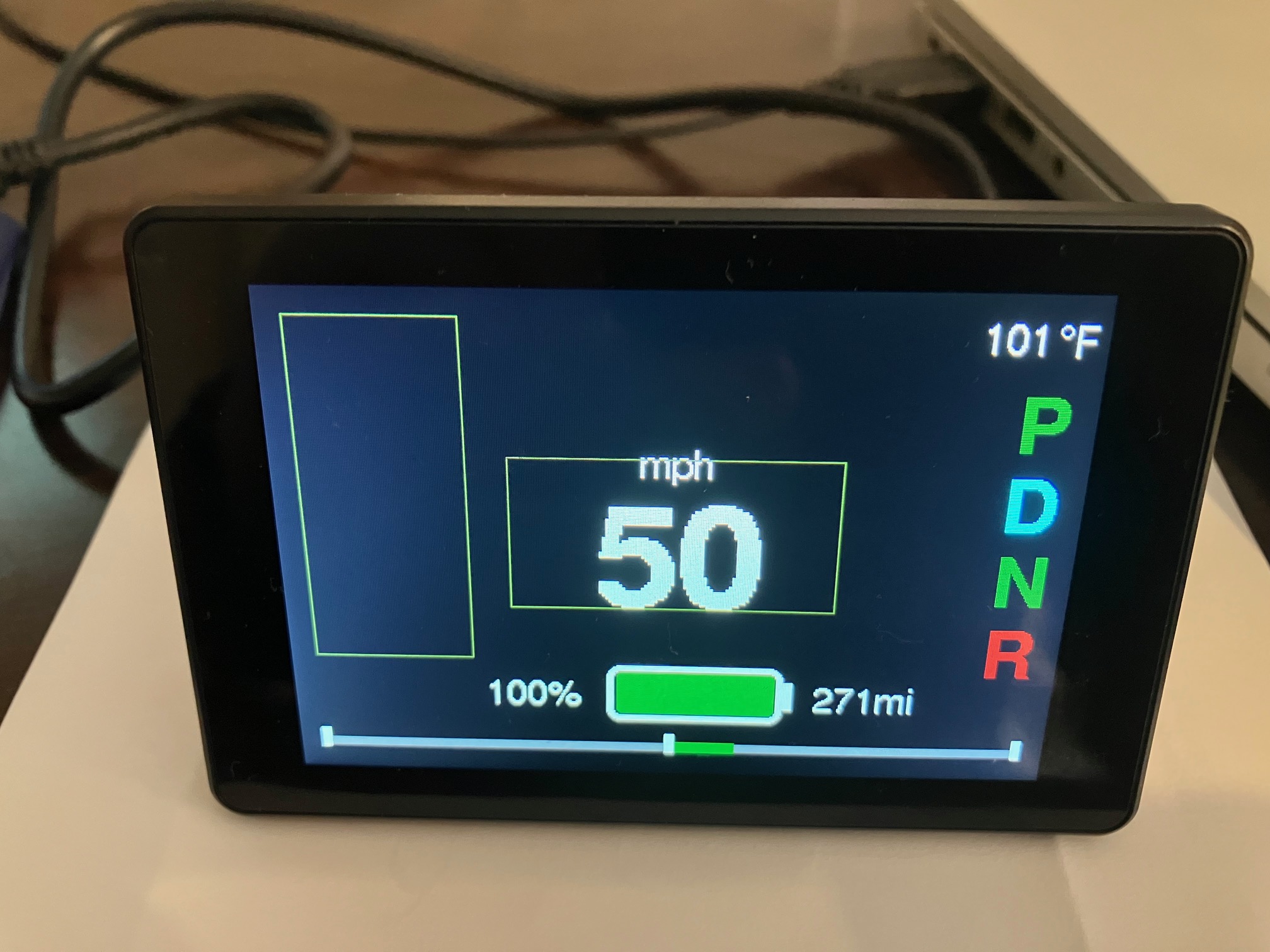

Successes so far:
- The Guition JC3248W535 display is the most mature now. So far I have been able to:
1) Generate graphics including improved fonts and BMPs for various warning indicators.
2) Touchscreen working but haven't done anything with it yet
3) Built a full simulation Serial interface which can set everything on the screen, including turn signals
4) Added sound via I2S protocol and added a small speaker. Have made "tick" and "tock" for turn signals, "start beep" and "warning" so far
5) Added CanBus read/write capability with the JTA1050 and can read/write commands I tell it to (still need to work on the Inverter side)
6) Have a working ESP32-CAM for backup camera, currently via WiFi and a WiFi connected device (clearly that won't work on the street)
But failures:
The other two displays, I haven't been able to get to work with the GFX library. I have learned that is is a lot harder to get a RGB display to work than a QSPI display. Although they accept the sketches without errors they. just. won't. display. stuff.
So, next:
1) Going to try a new approach. Instead of GFX I am going to try the Espressif ESP32_Display_Panel library and translate my graphics code to that other format. According the the manufacturers of the RGB boards, it should work a lot better.
2) Figure out a Serial protocol for the camera vice WiFi
3) Finish wiring in the OpenInverter and see if I can read its CAN
Edit!
I struck out 1) above, because after a lot of trial and error, using copilot to help me debug, etc., I found that the library I was already using was the correct one. I got the JC8048W550 working with the Arduino_GFX_Library. I haven't quite gotten the 480x480 display working, but it is displaying SOMETHING, meaning I just need to tweak RGB timing parameters until it works.
I also picked up an even larger 7" 800 x 480 display and will try out that one as well. Based on the limitations of the hardware, my final setup will probably be:
1) The smaller JC3248W535 display as my HUD, and also the hub of data. The reason, since this display uses QSPI protocols for the display, there are a lot of open GPIO pins that I can use for temperature, GPS, CAN, switches, etc.
2) A larger display near the radio. This will display the backup camera and serve as my GUI for CAN reading. Since all the other displays I have are RGB, which take a LOT MORE pins from the ESP32, it really only leaves a couple I can use for other things. However, each of these RGB displays has at least TWO free pins, enough for CAN, and I will use the UART-USB bridge for communicating with the camera (still experimenting with that)
3) The backup camera mounted in the rear, hard-wired via a USB cable.
