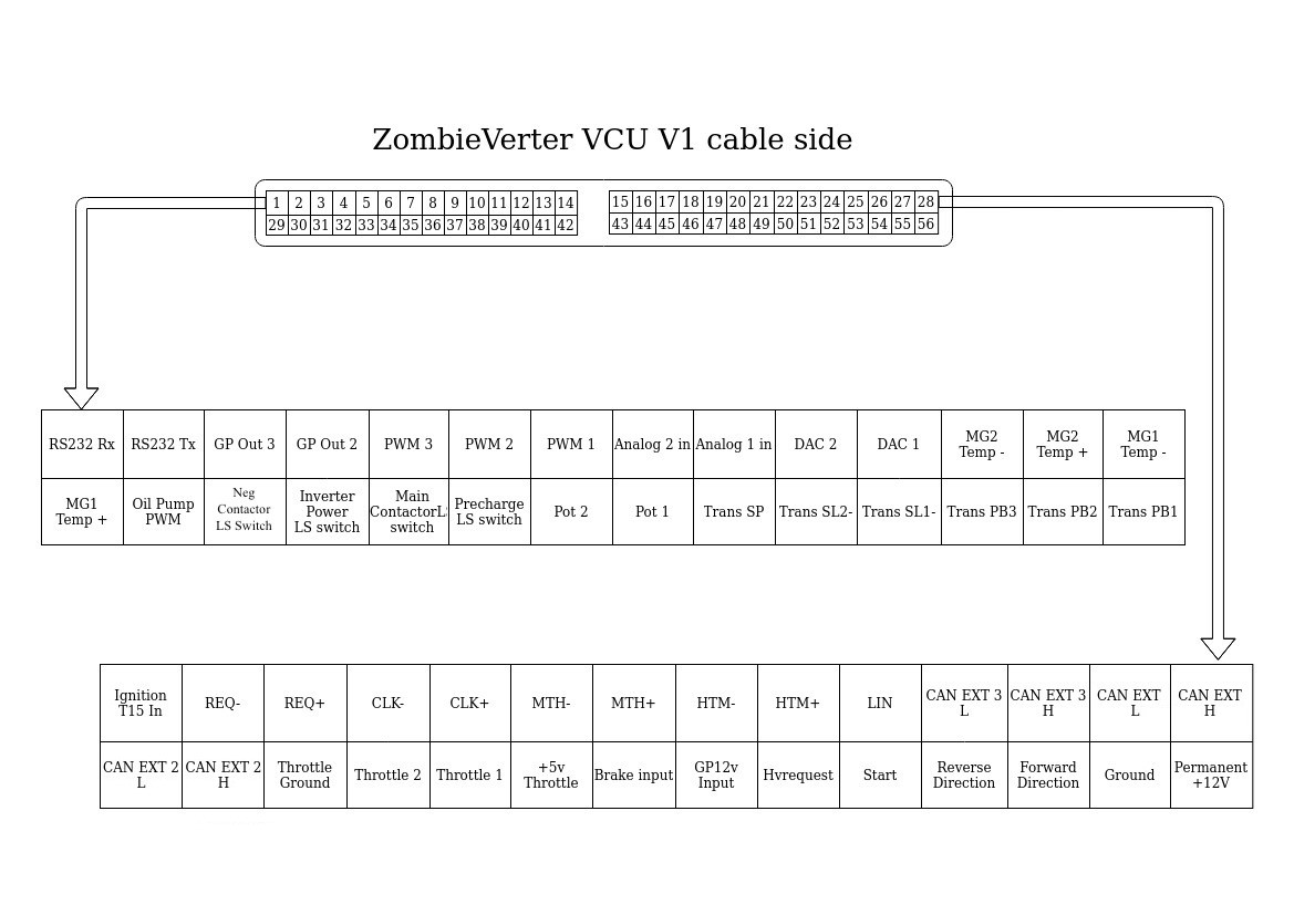

Not sure how to edit the Zombiverter VCU pin-out info which is very incorrect and had me doing a double take for a while.
It is completely incorrect and because it is linked back to github and is a jpg, I cannot edit it to correct it.
https://github.com/damienmaguire/Stm32- ... ematic.pdf
Its on the main Zombi VCU and Leaf Stack with Zombiverter wiki pages.

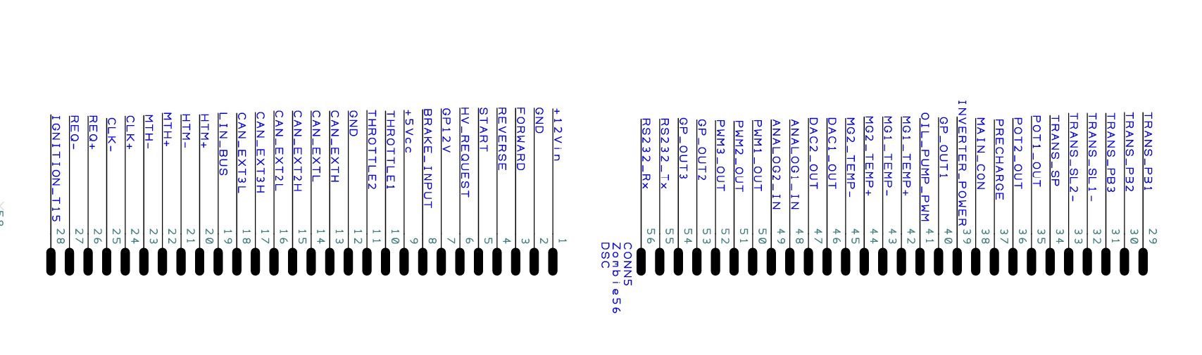

Rustybkts wrote: Fri Feb 14, 2025 10:14 am Zombiverter VCU pin-out info which is very incorrect
This is the pinout from the schematic which has the pin numbers reversed and the Can1 and Can2 swapped.
It doesn't really provide any useful information, so not sure why it was added to the wiki.

Removed now, it have no value to an "end user" they are intrested in wiring.
