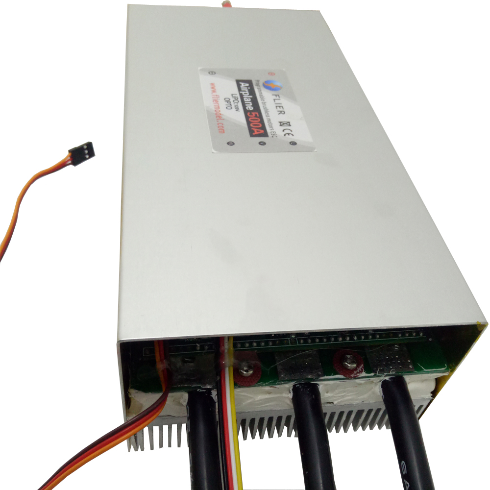

Unfortunately, there isn't space for a Prius 3 inverter, no matter what I try. :?
So I'll need an Elcon TC HK-J 3.3kW charger plus either a (pricey, closed source) Curtis Model 1239E inverter or a (scarily) light & compact Chinese drone inverter. Specs are impressive, but it looks like it'd destroy itself if you looked at it funny.
https://fliermodel.en.alibaba.com/produ ... A_esc.html
If I go with the Chinese 500A thing, it'll fit under the seat, which is ideal for air cooling. In my diagram, I can swap the position of batteries 1 & 2 with the inverter.
Anyone tried one?

Well, here's the answer: apparently those Chinese "500A" inverters are pure garbage. :(
Great video, by the way. Time for another rethink!
