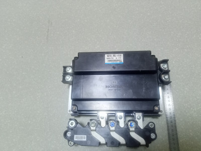

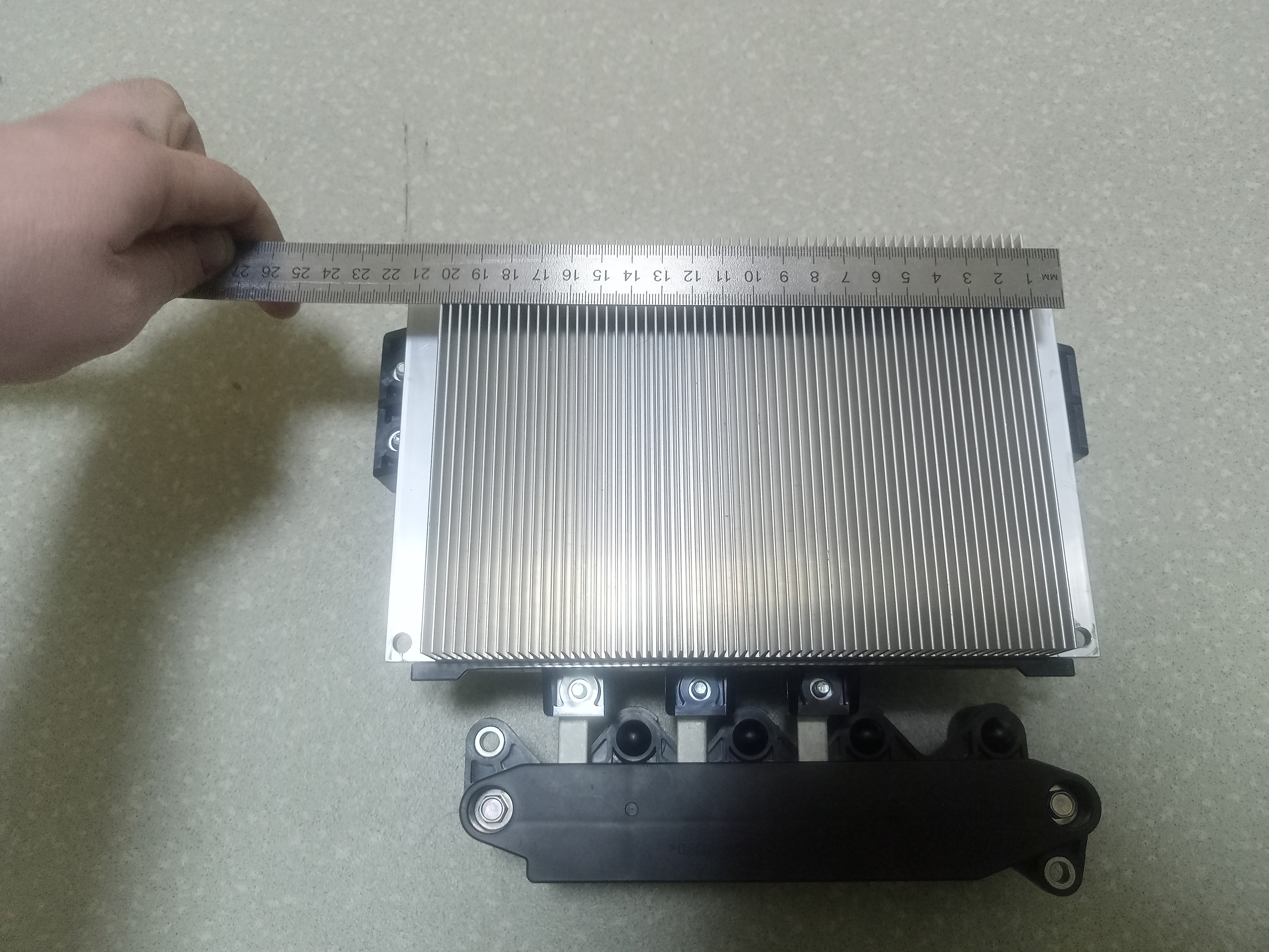

Good afternoon, I bought an inverter from Honda Insight

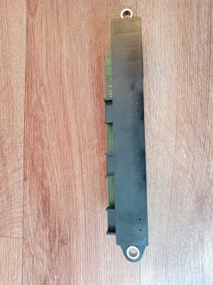

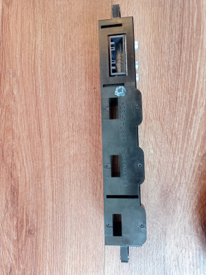

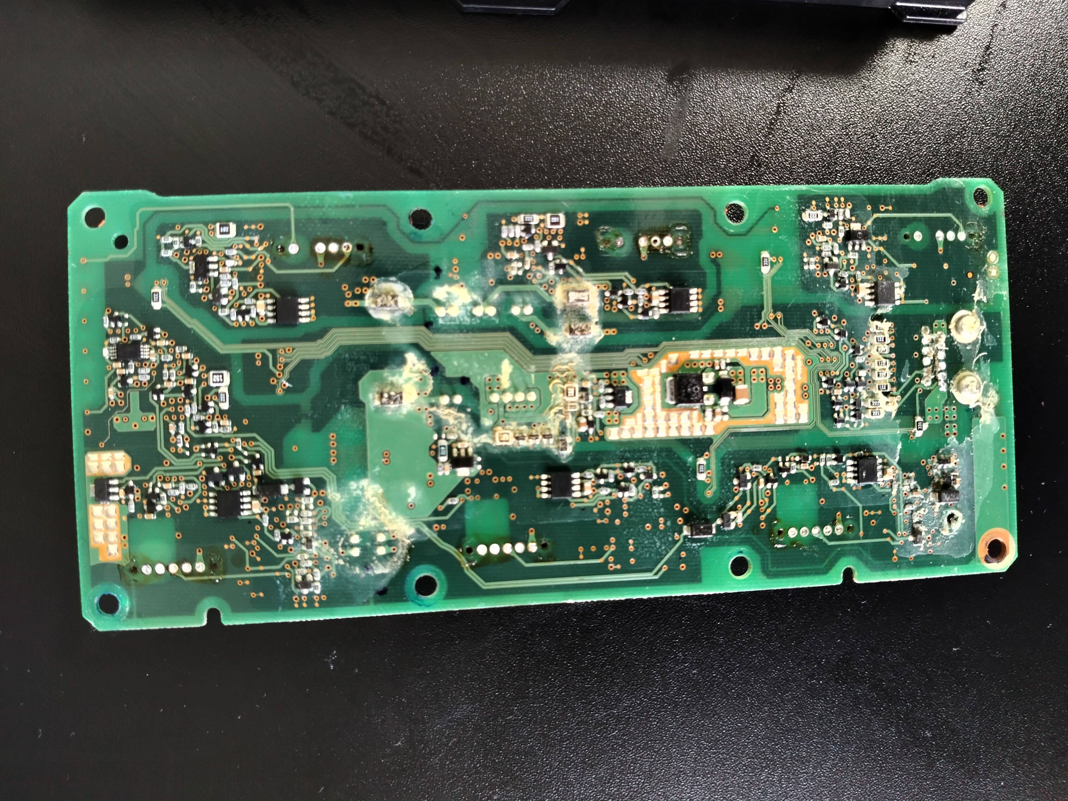

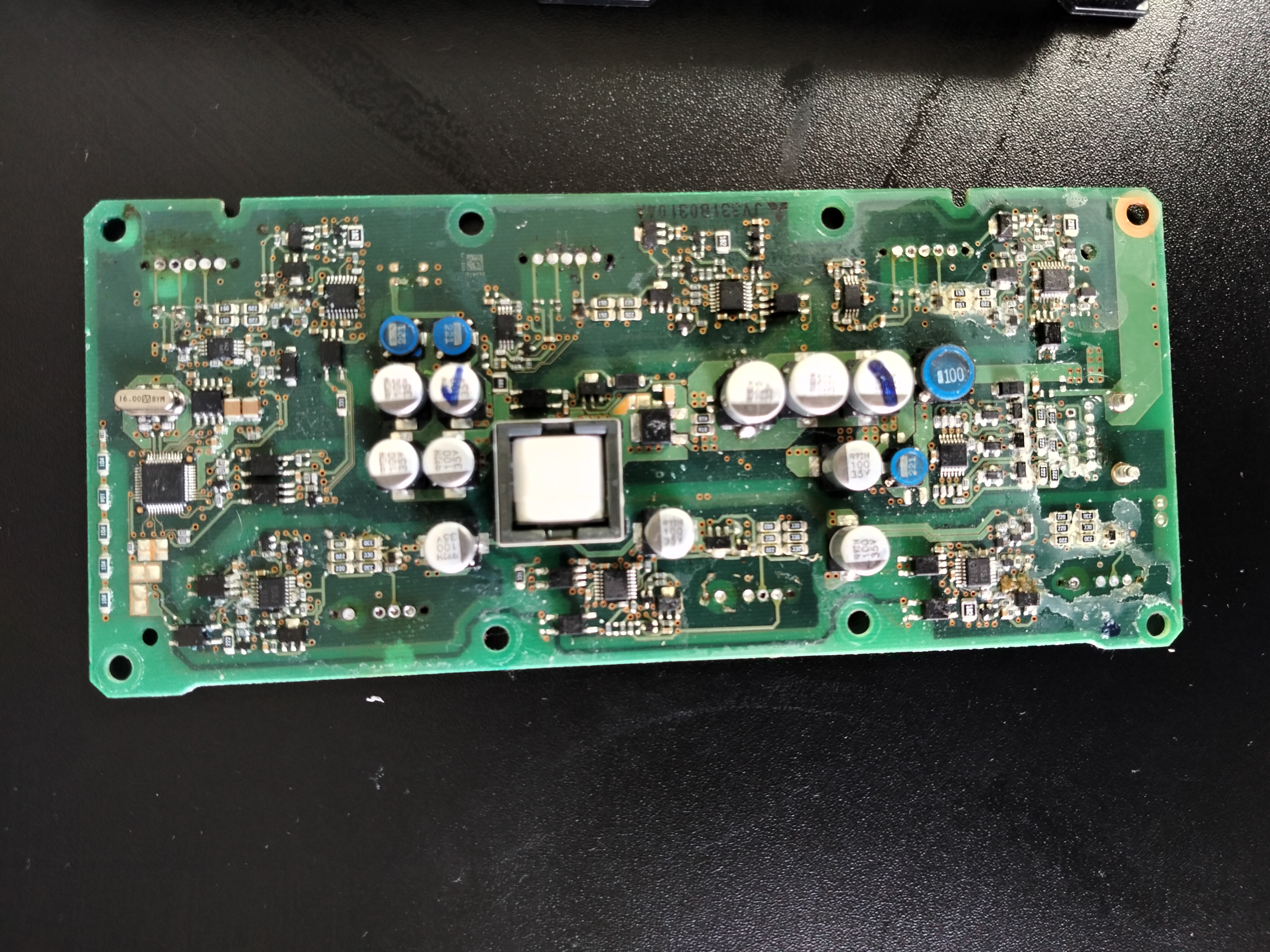

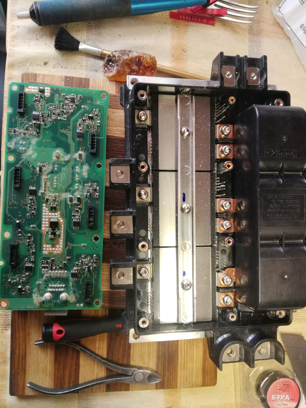

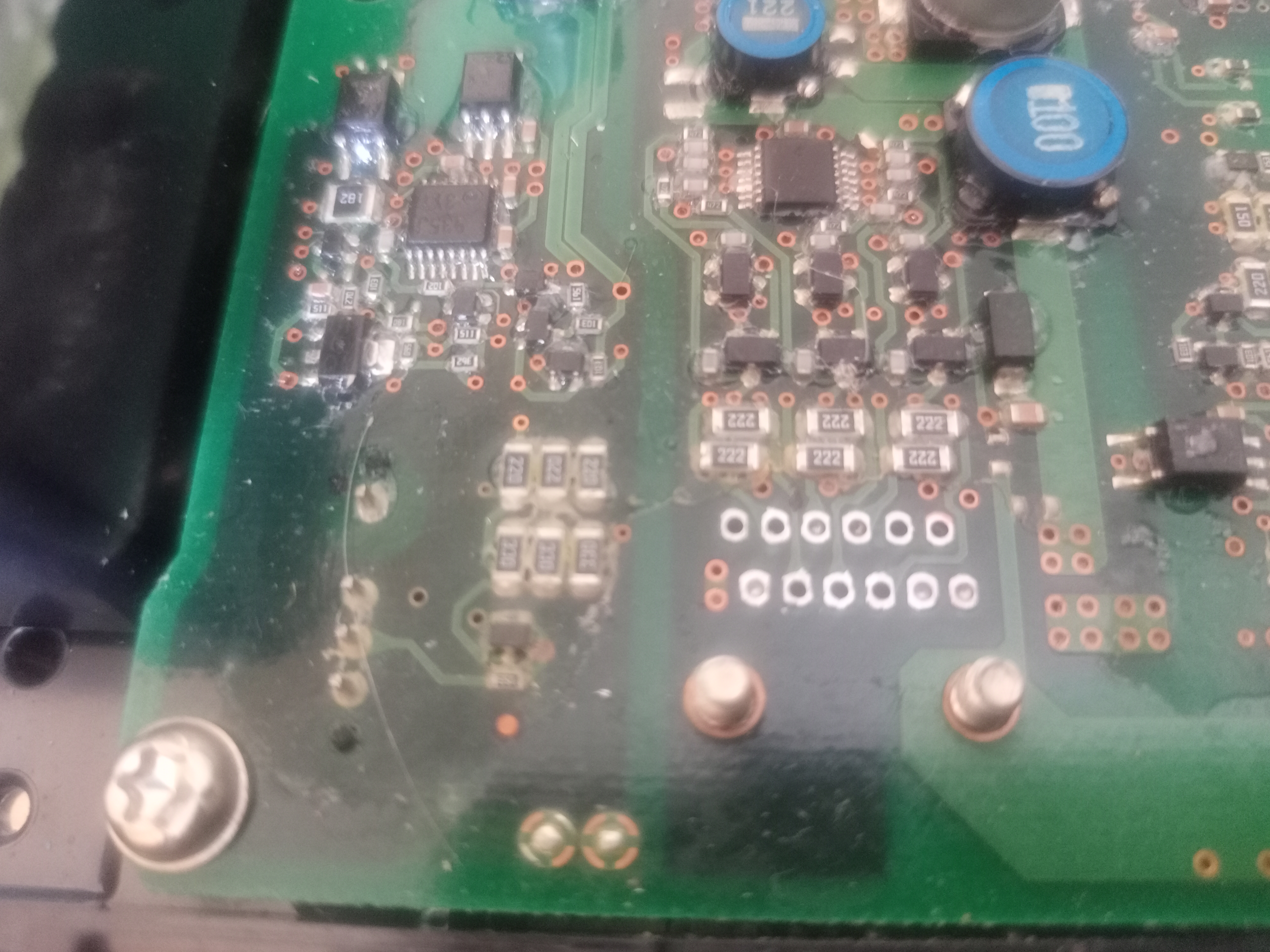

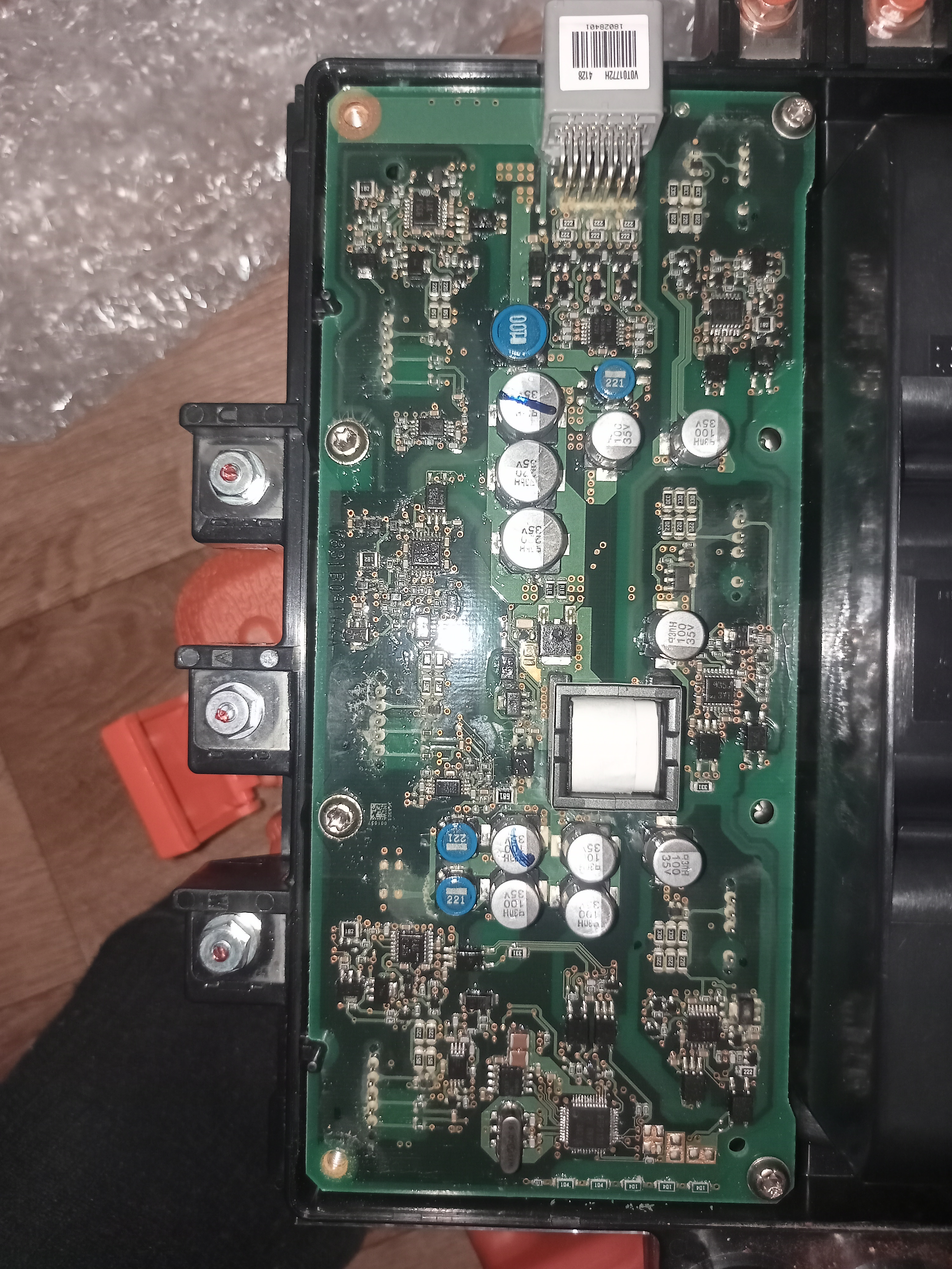

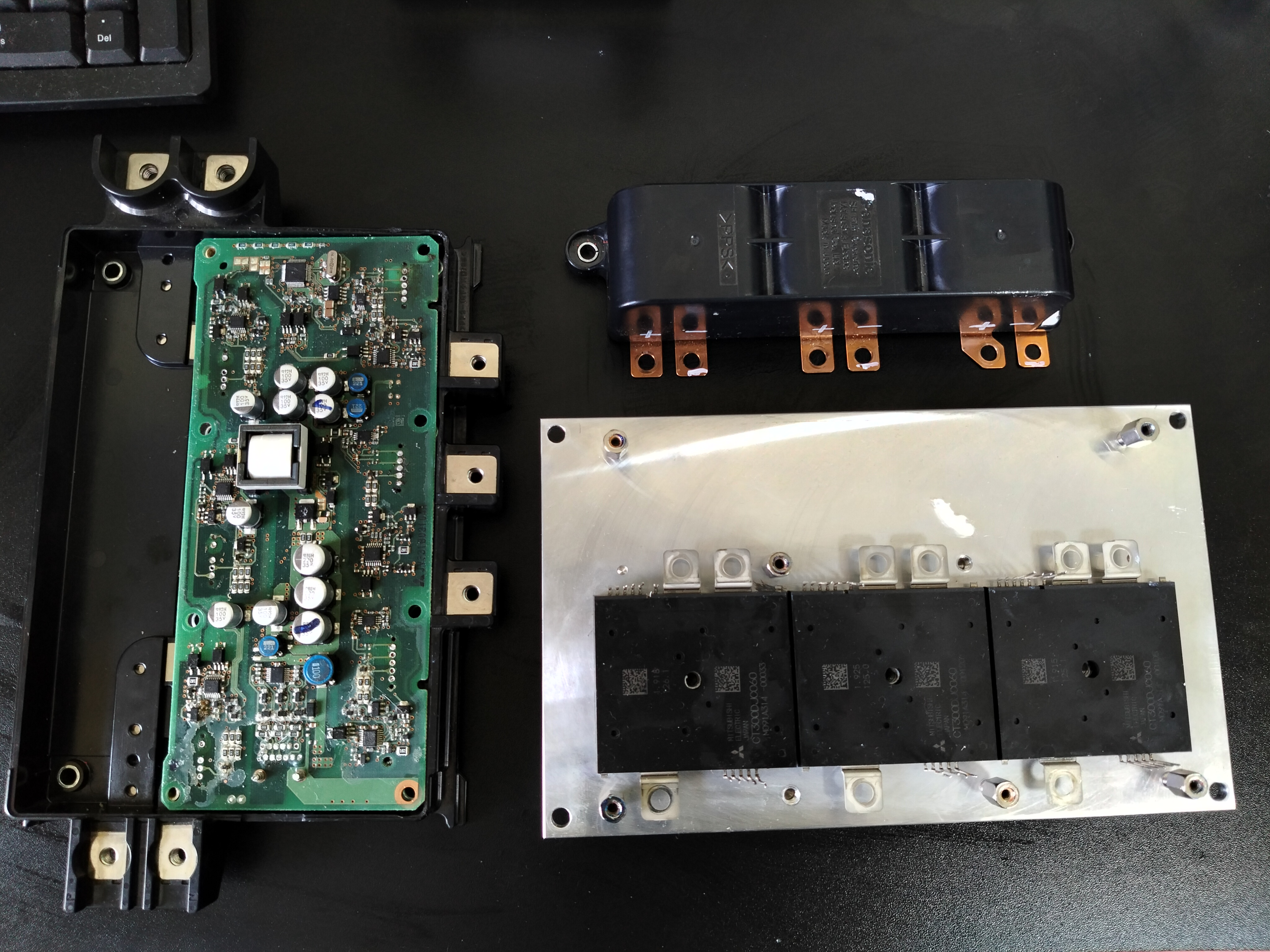

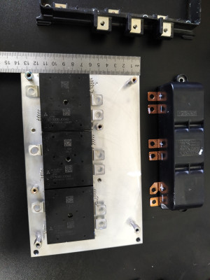

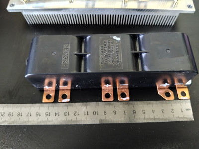

We continue disassembling the inverter, the top cover is held on by 4 bolts , Also disassembling current sensors

Not exactly, the Civic inverter has logic already inside the inverter, I may be wrong, but the inverters are Insight, Jazz,Fit, you can run it directly through the connector, the PWM signals come from a separate block!!!

Ryclanmoto wrote: Thu Jan 30, 2025 11:53 pm the PWM signals come from a separate block!!!
Thats how Toyota done the early priaiii (plural of prius) too so it seems very possible. I would mean getting control over the inverter power stage should be "relatively" straight forward once signals are identified and mapped.

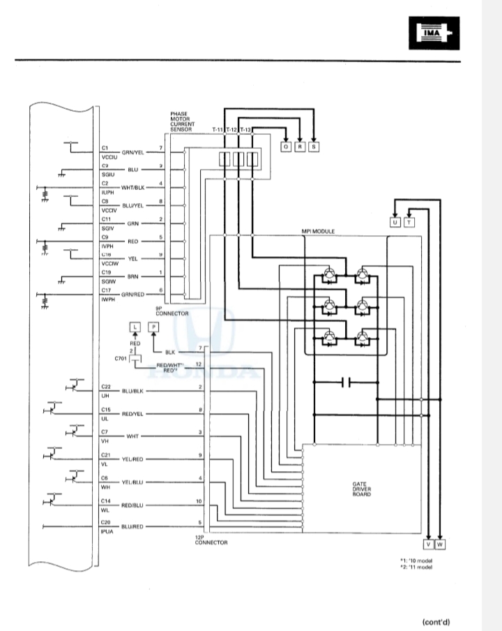

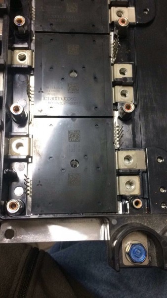

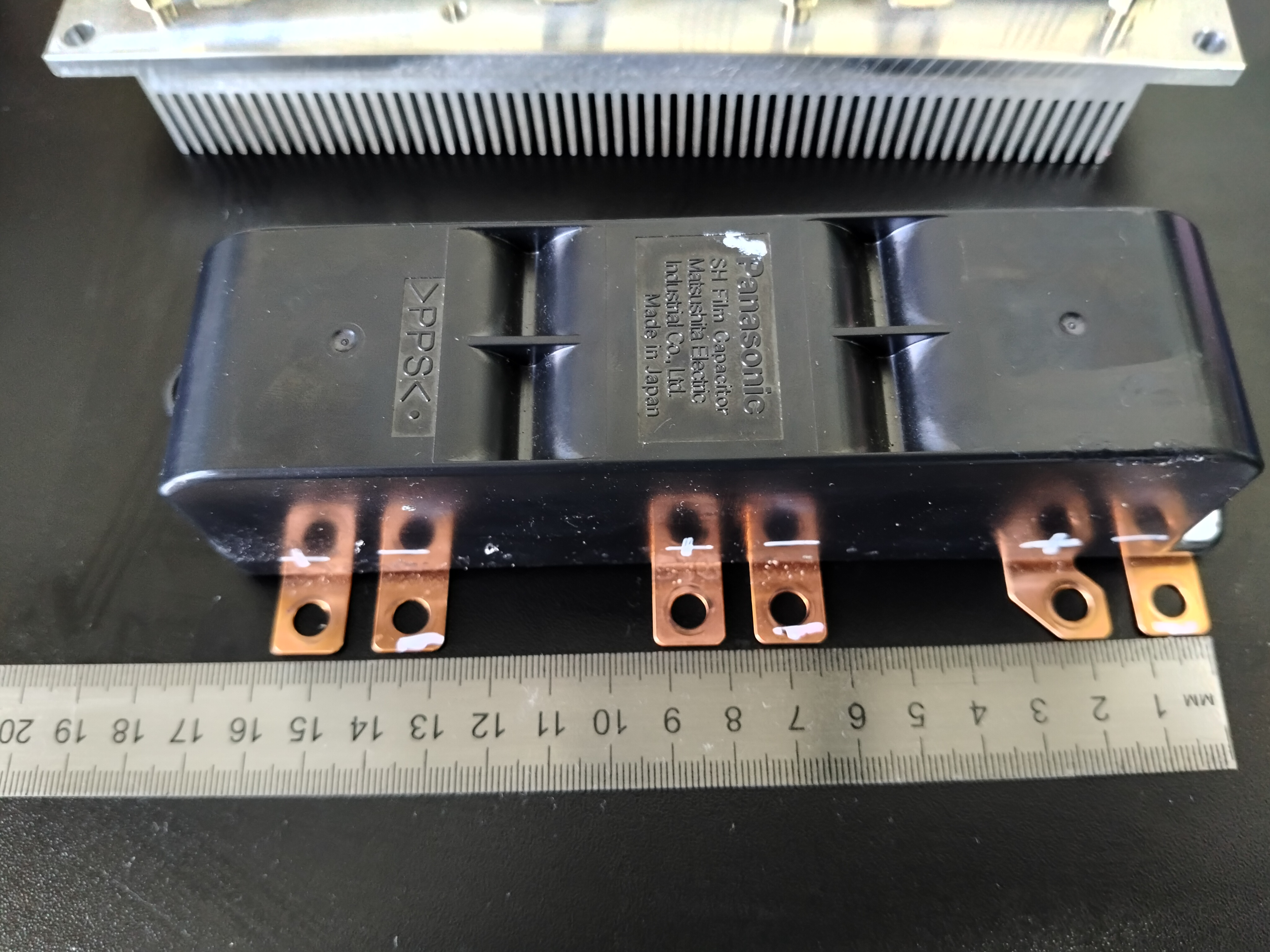

Yes, I am working on it, for now we have a diagram like this, a little later, after some time I will make inscriptions based on the photo, more detailed instructions, as I understand it, the inverter is from a Honda Civic, the capacitors are designed For voltages up to 600 В , but Honda insight has 450 volt capacitors , I couldn't find more detailed information on the capacities
Special thanks to a good friend for providing the photo.
Module IGBT For voltages of 600 and 300 А

The pinout of the current sensors is ready, let's move on along the path
