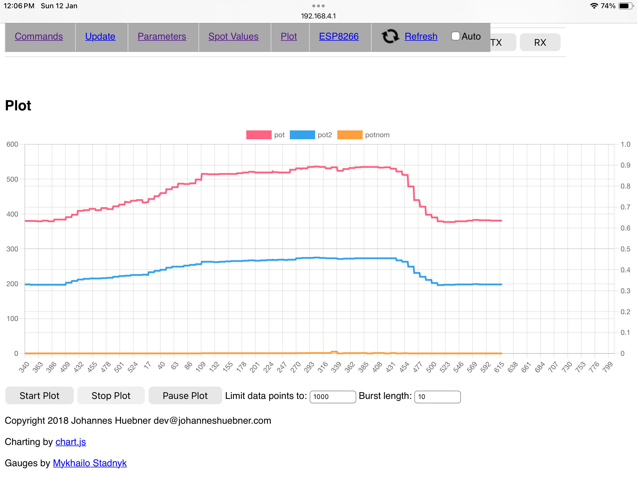

Re: Zombieverter & Gen2 Leafstack - RPM surging in Forward direction but stable in Reverse
Posted: Sun Jan 12, 2025 2:22 am
by Iceman96
tom91 wrote: Sat Jan 11, 2025 12:35 pm Please make a plot of potnom and speed so we can review what is happening.
Hi Tom - wasn’t sure how to export the plots you requested, so I just took screenshots. I hope that is sufficient. One of the plots is just me gradually applying the throttle from 0 to 100% with the car turned off. Feedback as expected from both pots, but no feedback at all from potnom. The next plot is with the zombie in Run mode and Forward direction selected, I only applied partial throttle as the car was in neutral. Again, expected feedback from both pots, but almost nothing back on potnom. And the last one is in reverse, with similar results. I hope this is what you are after, and please let me know if there is anything else you need

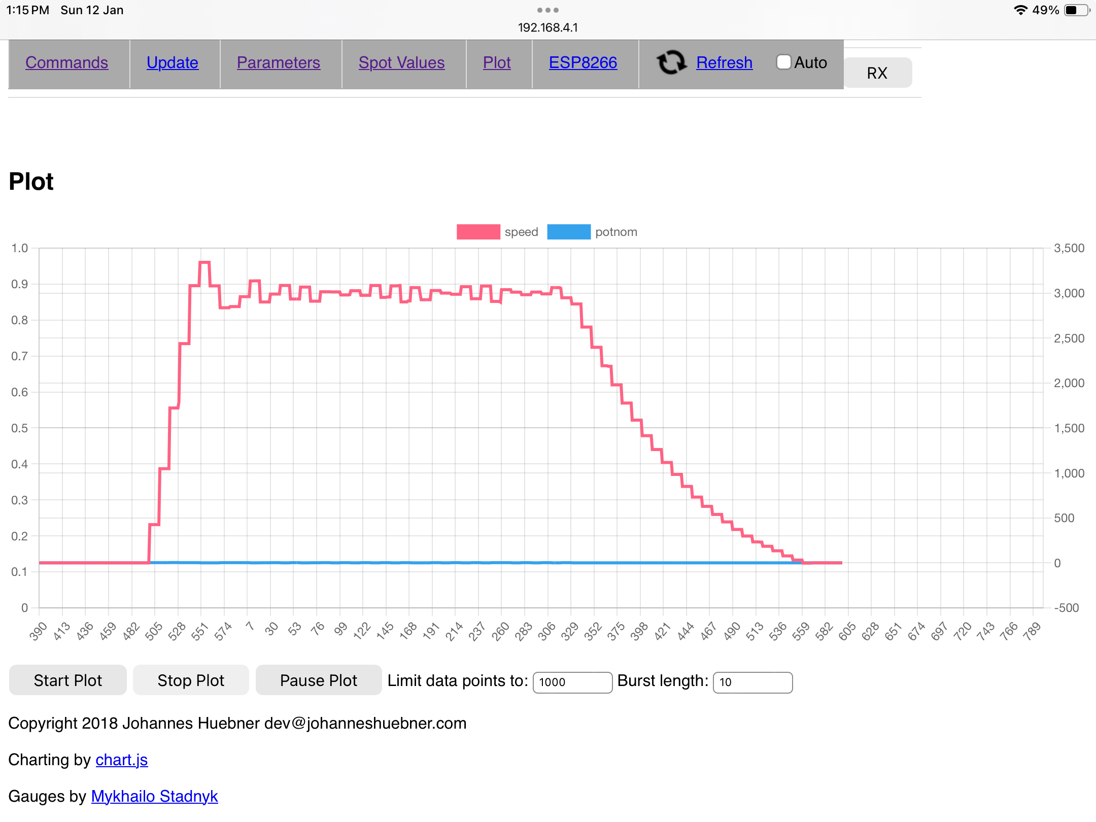

Posted: Sun Jan 12, 2025 2:28 am
by Iceman96
Hi Tom - I just realised you asked for potnom and speed. I will go and get those plots for you
Posted: Sun Jan 12, 2025 3:30 am
by Iceman96
Hi Tom, - this time I got the plots for speed and potnom as requested. First plot in Foward and 2nd in reverse. As you can see, no readings for potnom in either direction. Also, I gradually applied the throttle pretty much the same in both directions, but you can see from the plot,that in the forward direction that the motor gets up to the revlimeter ( 3000 rpm at present) far more aggresively. While in reverse it is a far smoother and gradual build up to speed. I backed off the throttle straight to zero the same in both forward and reverse, and in both instances the rundown to zero rpm is pretty much the same. I have regen set to zero at the moment.

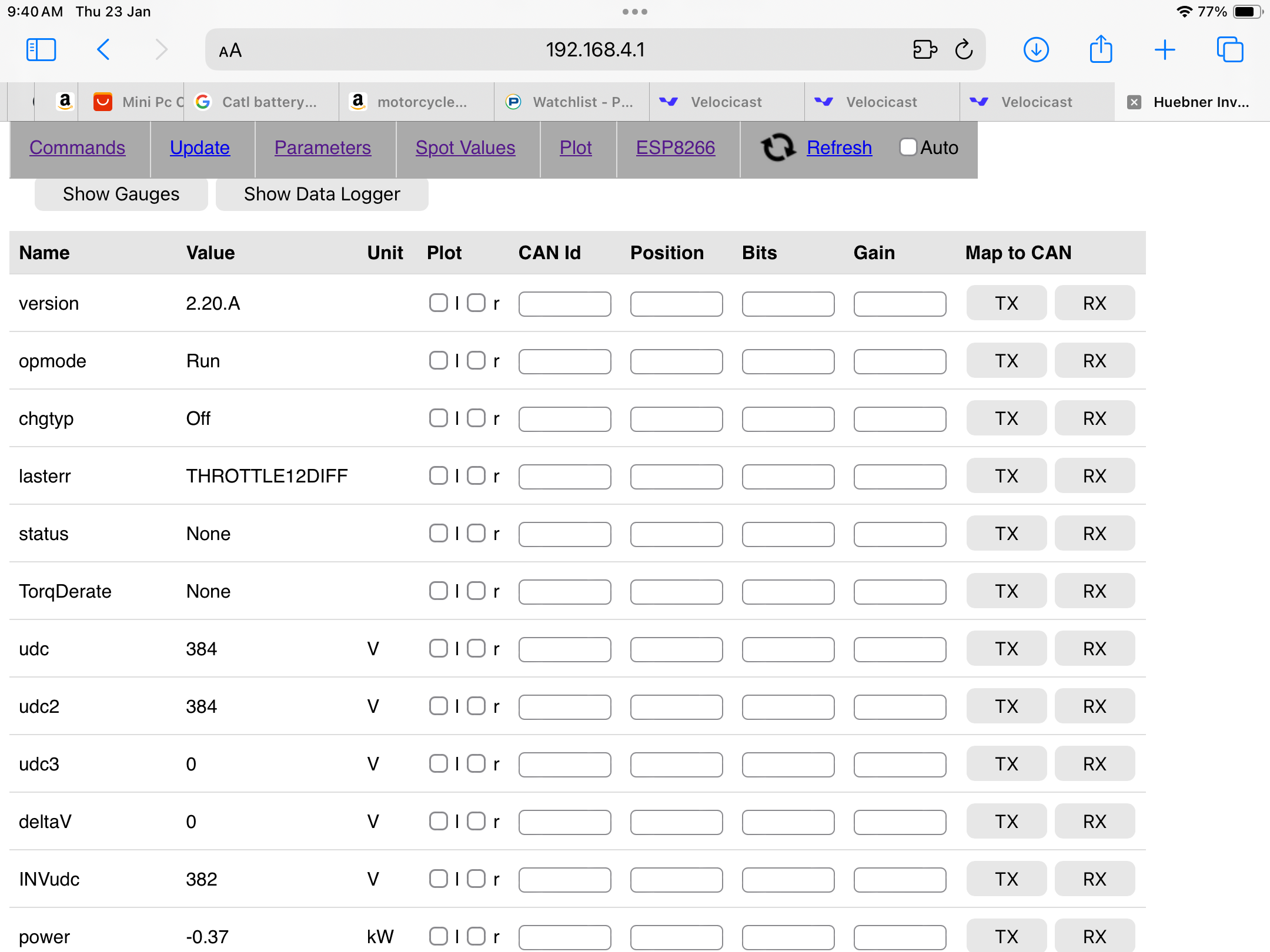

Posted: Thu Jan 23, 2025 1:50 am
by Iceman96
Hi again Brainstrust,
I have an update on my throttle problems, after following Tom’s advice of turning off regen, it definitely improved my no load performance. It is still very smooth in reverse, and is a lot better in Forward, though it still seems to come on suddenly compared to reverse. I still seem to have issues with potnom and invStat however.
So I decided to take the car for a drive on the road to see if that made any difference. 1st problem I encountered was I had no torque in reverse. Unless the car was on dead flat ground, it really struggled to get it to move in reverse. I also noticed that the Zombie showed a “Throttle12diff” error message. My car is a manual, so I got arround this by selecting reverse gear and running the motor in forwards. I then tried driving the car forwards and now it performs much better. I thought the Performance and throttle responce while driving was very good. My only complaint would be that the initial start off is still a bit sudden. But once it is moving it behaves well. I will attach a copyof the current parameters in the Zombie, as well as a picture of the error message, and a plot i took of the vehicle taking off from a standing start on flat ground and accelerating up to approximately 60kph. ( car was in 3rd gear, which gives me a final drive ratio a little bit taller than the standard Leaf ratio). Potnom still does not show meaningfull values, and InvStat is still showing as off, even though the zombie is in Run mode, and drives the vehicle OK??
Thoughts anyone?
Posted: Thu Jan 23, 2025 9:12 am
by tom91
Iceman96 wrote: Thu Jan 23, 2025 1:50 am “Throttle12diff”
this will create a judder
Other thing to try drop your "throtramp": 10 to lets say 2.
Iceman96 wrote: Thu Jan 23, 2025 1:50 am Potnom still does not show meaningfull values
this is a problem, can you plot potnom, speed and torque
Iceman96 wrote: Thu Jan 23, 2025 1:50 am I had no torque in reverse
"throtmaxRev": 50 is what limits reverse torque, you can try changing this.
Posted: Thu Jan 23, 2025 10:54 pm
by Iceman96
tom91 wrote: Thu Jan 23, 2025 9:12 am this will create a judder
OK - if I changed my throttle to single channel would that eliminate it as a cause of the judder at takeoff?
i will give it a try and report back
tom91 wrote: Thu Jan 23, 2025 9:12 am this is a problem, can you plot potnom, speed and torque
Will do
I had increased it to 50 from the default value of 30 that Damien uses, but it made no difference. But I will increase it to 100 and see if that does
Posted: Thu Jan 23, 2025 11:10 pm
by tom91
Iceman96 wrote: Thu Jan 23, 2025 10:54 pm OK - if I changed my throttle to single channel would that eliminate it as a cause of the judder at takeoff?
Set it to single channel and it will eliminate the error being called, which can be source of your juddder.
Iceman96 wrote: Thu Jan 23, 2025 10:54 pm I had increased it to 50 from the default value of 30 that Damien uses
Note the Nissan leaf motor is limited in the the stock inverter firmware.

So now with 12VDC going to the zombieverter, and to the correct inputs on the PDM, Inverter, and the Battery pack, but no “Ignition on” signal, or “Start” signal going to the Zombie, I logged in to the zombie to see what state it was showing. Everything looked ok to me except for the fact that the “InvStat” feedback was showing as on. But no volts were showing on udc, and the DC-DC converter was still off. I then did a download of the parameters which is below:
params No1.json
(2.13 KiB) Downloaded 440 times
I then connected up my arduino Due and started savvycan logging on my CAN1 bus, which has the zombie, pdm, inverter, and bms all on it. I continued logging for a bit as it was, and then turned the ignition on. I saw no appreciable difference on savvycan ( IE no new channels appered in the list of what was being logged). I then gave the zombie a “Start” signal. I-heard the contactors close, the zombie went into run mode, and udc1, udc2, and Invudc were all indicating approx 384volts, the DC-DC converter powered up as my aux volts wentup to 14.8v and everything seemed okother than my “InvStat” was now showing as off. I checked Savvycan and there was now extra channels being monitored.
I left it like that for a few more seconds, before turning off the ignition. It sounded like the contactors dropped out, but i was not sure. The zombie went into “Off” mode ok, “InvStat” went back to on mode, i think the dc-dc turned off as i am fairly sure the aux volts dropped back to approx 13volts. After a short wait i stopped the savvycan logging and the file is below:
rodeo-leaf log.csv
(3.32 MiB) Downloaded 452 times
Something strange that I noticed was that it appears that the value I had saved for udcsw of 360volts had been ovverwritten by the actions of starting up the inverter, as it was now showing a value of 364volts. (Not sure if it is a coincidence or not, but that was a value I had been using previouslyfor udcswI ). I tried doing a refresh, but the value remainned at 364 volts. So I did another parameter download which is attached below where you can see the value has changed:
params No2.json
(2.13 KiB) Downloaded 424 times
I then cycled power to the zombie and checked the parameters again, and udcsw was back to 360volts again???
I then tried powering up the inverter again to see if it did the same thing (it did), but on powerdown the contactors sounded funny again, so after isolating eveything again and checking, i found the contactors stuck closed again. So even though I did not run the main traction motor at all, the power draw of the dc-dc converter was enough to reweld the contacts, so I wont take any more risks with these contactors, and will have to wait until my kilovacs arrive and are installed before I can get any savvycan logs of the “no torque in reverse” issue. But hopefully the one log that I did manage to get may give some insight into why my “InvStat” is behaving the way that it does???

Iceman96 wrote: Wed Jan 29, 2025 8:34 am “InvStat” is behaving the way that it does???
Does nothing with the Leaf inverter. As indicated by the spot value description on wiki. https://openinverter.org/wiki/Zombiever ... pot_Values
