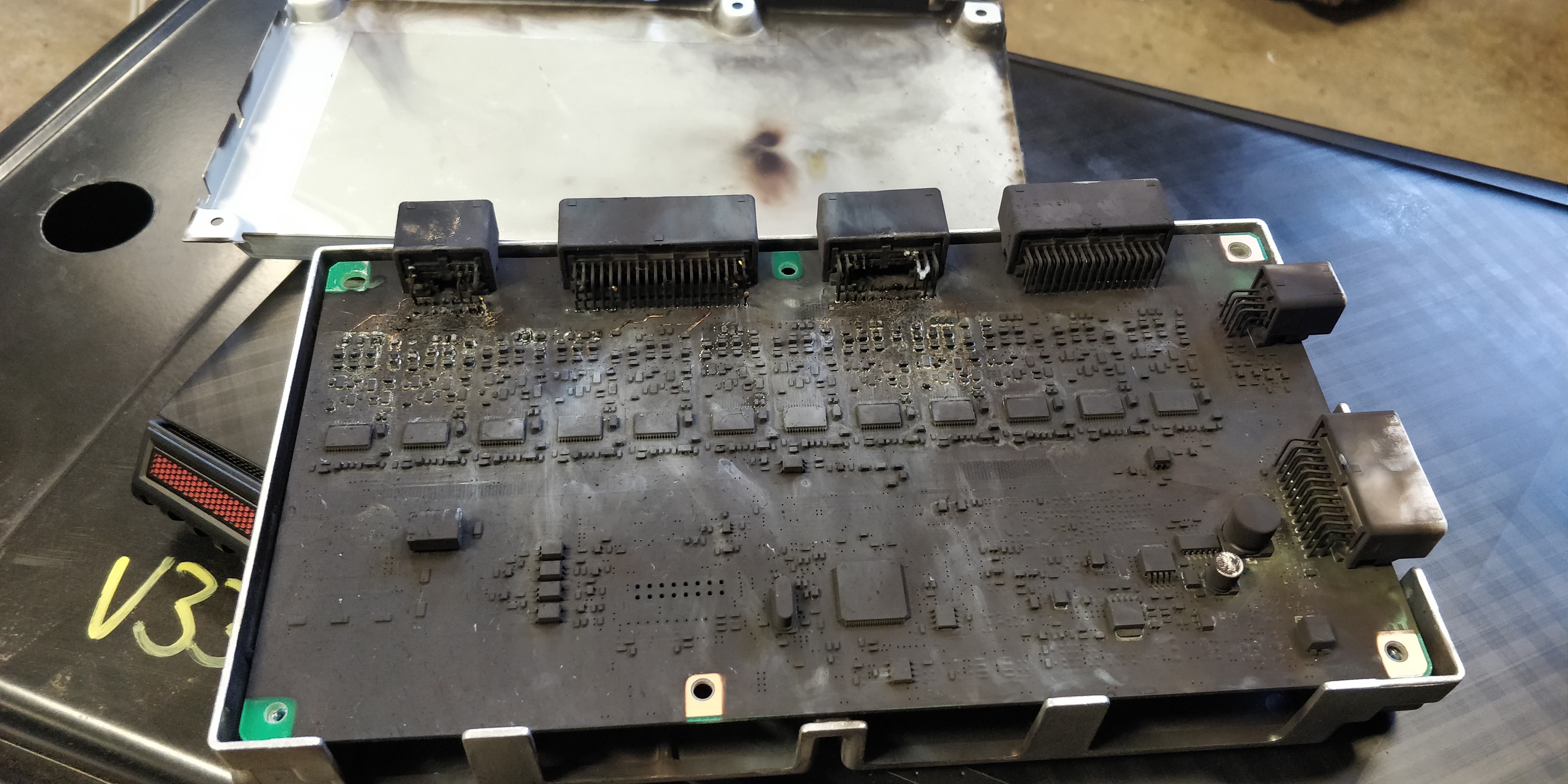

Seems that i need one of thease too 😁 this was renault Influenza bms. Battery module connectors were same, but they are not wired all same. Big bang and smoke when switched main switch on..

Wow, looks like the magic coal escaped! Thats why I was reluctant to just test out the Nissan BMS because I have no idea in which order the 4 inputs groups must be connected.
