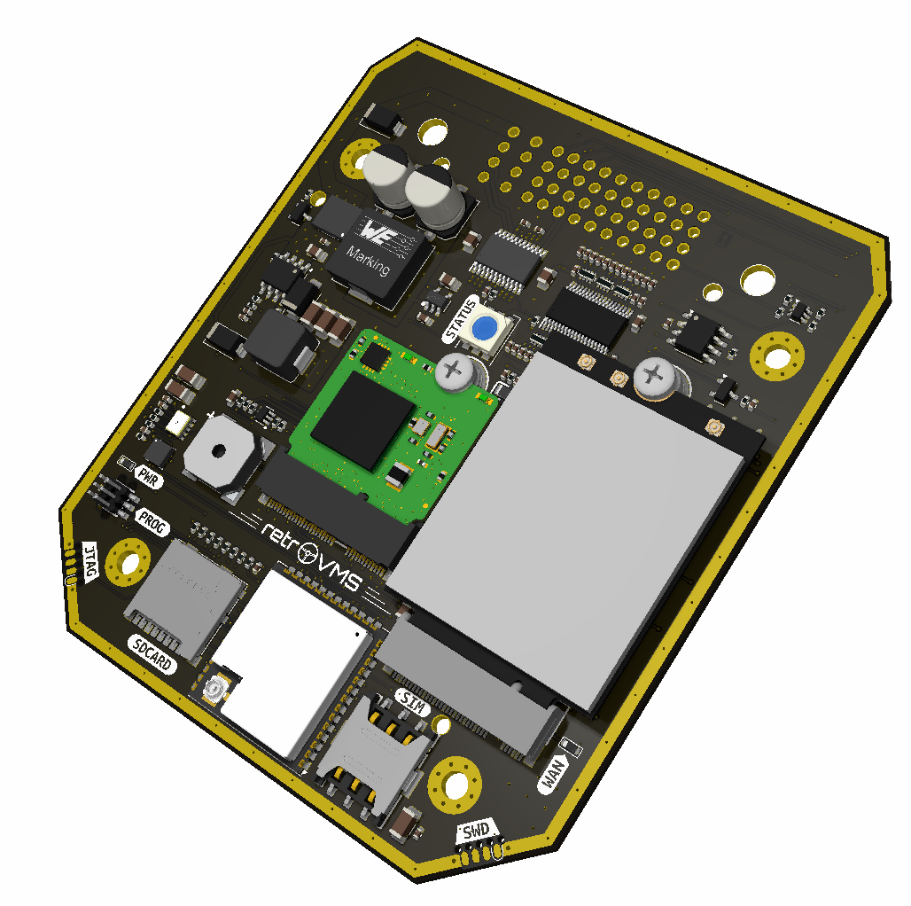

I wanted to introduce something I've been working on for a while, which I call HeadlessZombie.
[In the same way ZombieVerter was an OpenInverter without the Inverter, HeadlessZombie is a cutdown Zombieverter without even the Inverter drivers (supports CAN only inverter comms)]
The basic idea of the project is to enable a sort of "Tesla App" for EV conversions, by providing a flexible and to some degree future proof VCU+4G Gateway hardware platform with OVMS and OpenInverter compatibility.
This can be done using OVMS and ZombieVerter as discrete boxes, but I felt that building them together made sense for me, and hopefully others in the EV conversion community.
So I'm just about to send this 3rd version of the board off to manufacture, and was looking for feedback before I pull the trigger....
Few details about the build...

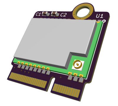

The board uses an ESP32-S3 N16R2, supports a plugin co-processor using MicroMod, currently targetting the Sparkfun STM32F405 for OI, (but could instead run RP2040, Teensy etc). Both processors expose 2 SPI interfaces one for GPIO, the other for CAN interfaces.
The plugin WWAN interface (accepts M.2 socket B 3042 WWAN modems connected on USB), eg SIM7600 with integrated GPS.
The board has a 48-pin Molex connector with 3 CAN interfaces, SWCAN and LIN/K-line.
I/O is 24 channels IN (analog or digital with optional switch wetting) and 10 channels OUT (HS/LS/HB supported), all run-time assignable, as well as 2 dedicated PWM channels (eg for Speedo/Tacho), a 12V LED strip output for in car ambient lighting, and a 5V protected sensor supply output.
IO is fully protected against shorts, supply reversal etc, and runs from 5-24V
Onboard peripherals include RTC, accelerometer, SDcard slot, SIMcard slot, status LED , user button (on underside), and a warning buzzer.
Nearly all on-board devices can be accessed by either the main processor or the co-processor (but not simultaneously)
ESP32 debugging over JTAG is integrated (requires and ESPprog for firmware development) , and STM32 debugging over SWD.

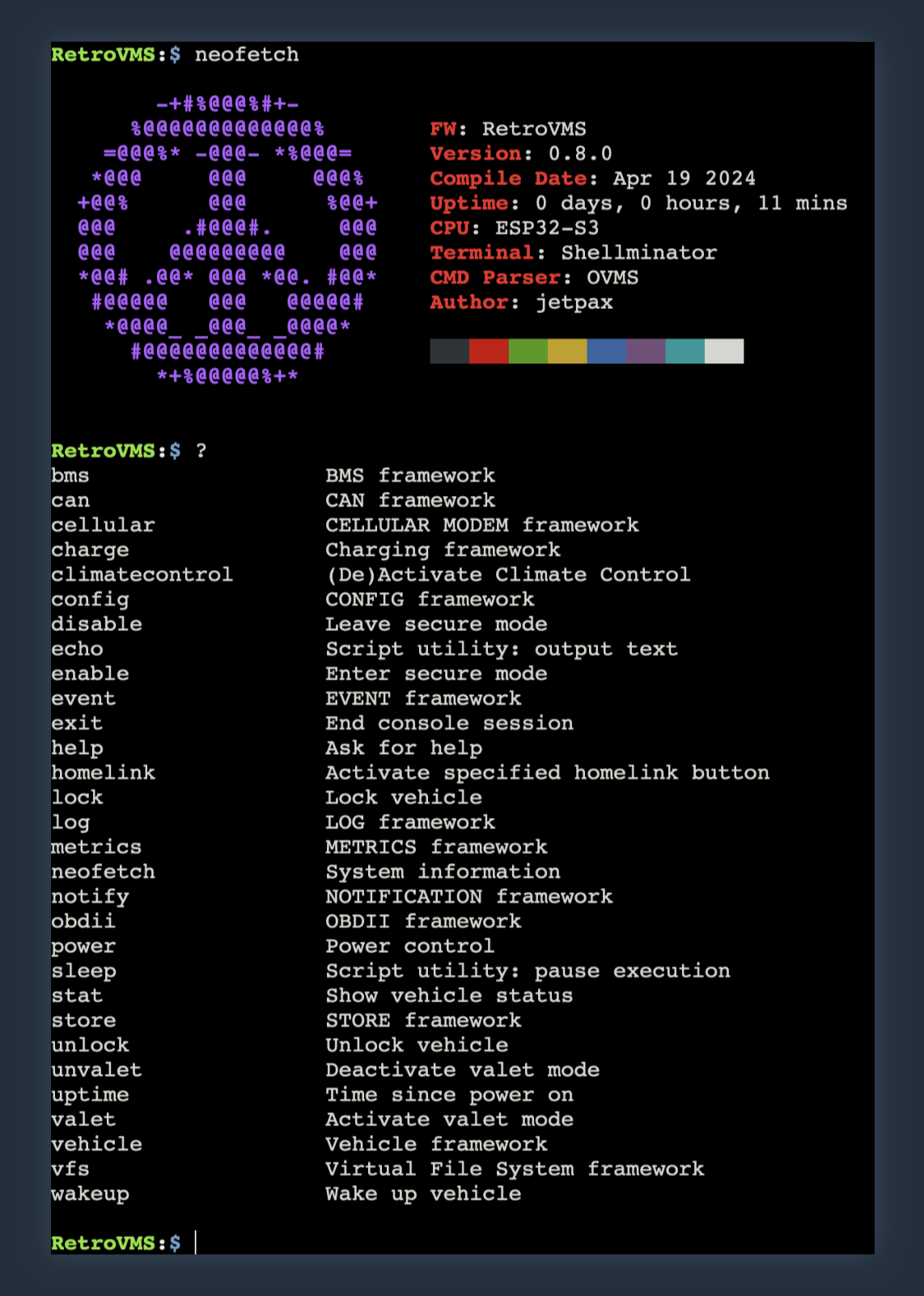

Firmware is currently based on a heavily modified OVMS, (eg native ESP-IDF web stack instead of Mongoose, native esp-idf PPP, all modules Construct on First Use, etc etc) and with the addition of Arduino SDK compatibility.
Planning to serve the OI web page to control a reduced functionality Zombieverter (No Lexus drive unit support, sorry), running on a Sparkfun Micromod STM32F405, over a CAN backend.

Looks great. Really clean layout.
I see lots of antennas and one connector below. They all connecting through the lid besides that one? Any need for a hole or 3 through the PC board to get to the bottom with the antenna wires?
Any reason to add unpopulated screw standoffs for different size expansion boards / support?

Correct, there are 3 antennae, wifi/bluetooth, LTE and GPS.
Current plan is wifi on bottom connector shown, (which routes through one of the large Molex clip holes) other 2 (which are technically optional if the WWAN is not used) use lid mounted pigtails.
Layout is tight in this enclosure so only plan to support M.2 3042 in this 'MINI' version.
Micromod does call out a larger 'Function board' size, but its easy enough to create custom plugins (eg my C1101 sub GHZ board for garage doors) using the processor form factor.

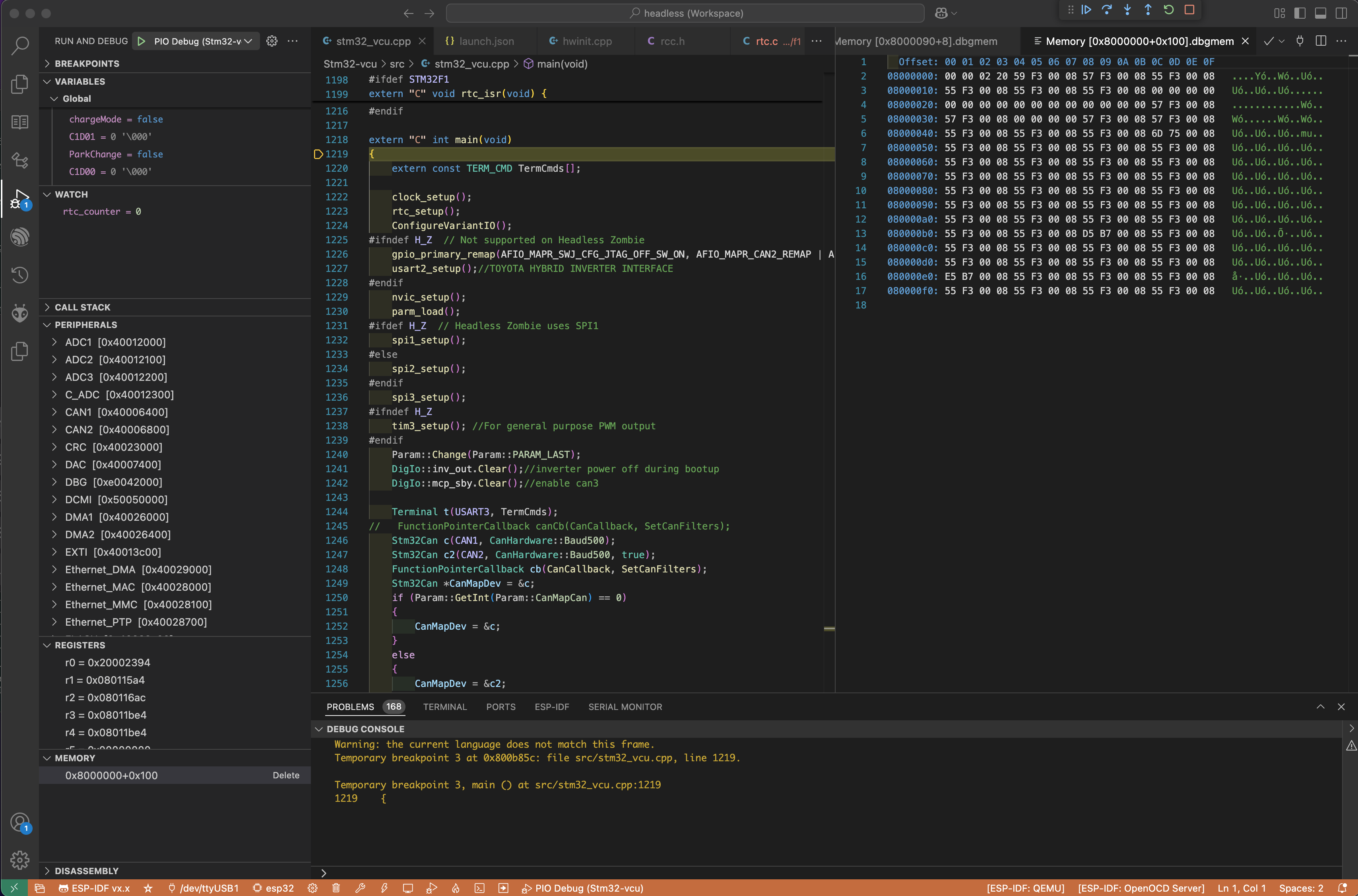

Since HeadlessZombie uses an STM32F405, I've ported the latest STM32_vcu code over (#ifdef'd for F1 or F4) and built it under Platformio for easier debugging
It's in a raw untested state as yet, but the Micromod STAT LED flashes
You can find the code here

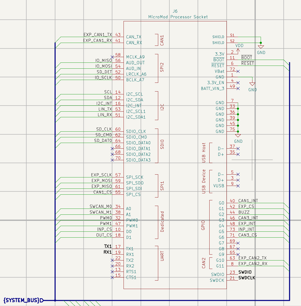

Re Micromod, turns out that the STM32F405 board linked above has 2 SPIs brought out, the second is actually on the "I2S pins", so I was able to use those (the motherboard uses one SPI for IO, the other for CAN controllers)
So actually had no need of more STM32 IO.
See
I suppose you could make an STMF103 board, but frankly I dont see the point
Re firmware , I did a prelim port of STM32-VCU which you can find here.
It compiles under Platformio using the vanilla Platformio libopencm3 (with small change from @johu for CAN), and debugger works great using Blackmagic
(I repurposed a Nucleo breakoff board as a BlackMagic adapter, also works great)

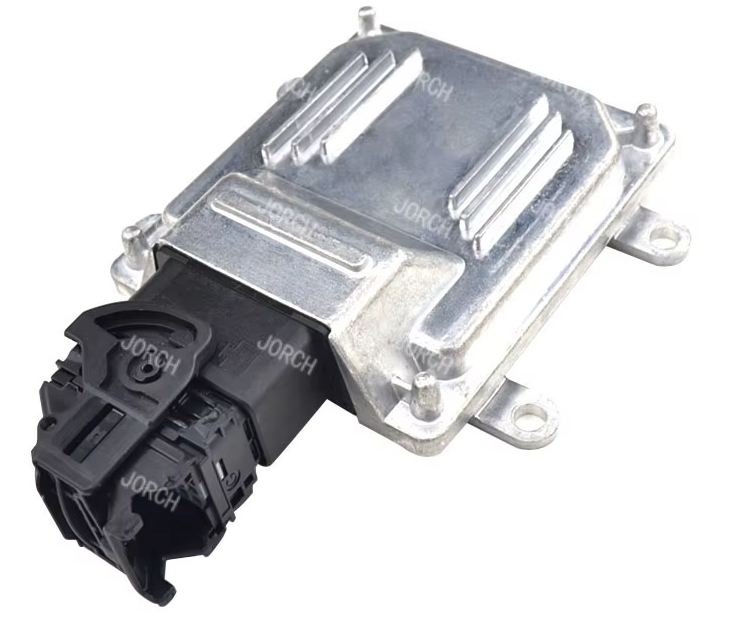

Definitely, if there is any interest.Scrappyjoe wrote: ↑Wed Jan 22, 2025 8:27 am Are you planning to sell this as a product in the future?
This is the MINI version that uses a commonly available ECU case
though it has to be drilled for antennae, and will be powder coated.
(Color preferences anyone?
Will likely do a larger pinout version with beefier drivers/ more pins in the future too depending on demand.

As another aside, I saw the schematic image shows a TIC10024. That IC is for digital switches only and doesn't have ADC support. Did you mean to use a TIC12400 instead? That one does have an ADC for analog inputs.
- jetpax
- Posts: 52
- Joined: Wed Jan 01, 2020 12:33 am
- Has thanked: 20 times
- Been thanked: 23 times
Re: Introducing HeadlessZombie
Indeed, well spotted grasshopper, was fixed in production release which uses TIC12400QDCPRQ1
(and also switched to the TI DRV8912 O/P driver, which is almost pin compatible with Infineon part...)
