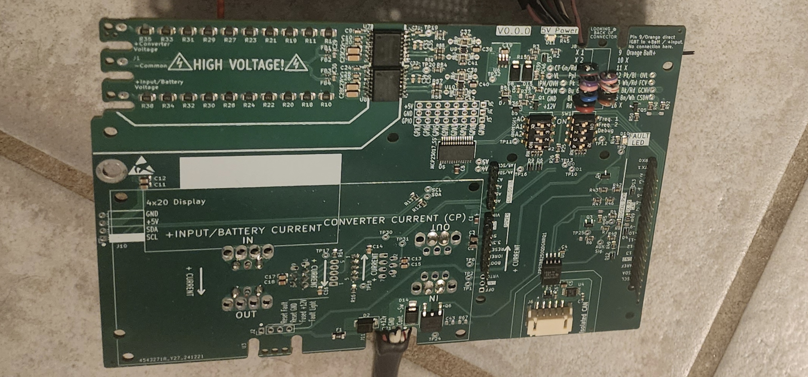

- I made a 48v GaN motor control board for this (sorry, won't be open source) for the generator side of things that is pin compatible with VESC for testing and future repurposing for/by the DIY community. Max voltage is 100vdc for components but will be kept to 48v in this application. This is the only pc board so far that is meant for this project that's done (but not tested.) The rest will be piecing stuff together to do testing.
- There may be multiple generators with their own motor controllers.
- has isolation between voltage sections
- I do have an isolated 3.3v current sensor rated for +/- 40A on the motor control board for the DC power in / out (a bit under 2kw.) It also has an unpopulated shunt across it so I can adjust the range if needed.

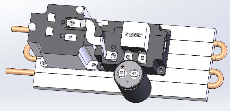

I got a 2008 Prius inverter and pulled the inductor and igbt out. I need to put them in a different housing to fit this in my project and will need water cooling based on where its located.
I really couldn't find any hardware to run this directly. I'm making an Atmel 328P board to run this along with a 4x20 display. I'll share my results as I make progress on this.

I do have an 850v isolated voltage sensing circuit for both sides of the converter already on the PC board I made. That could also be used in interesting ways in a current control mode. The R4 has a 14 bit ADC and the resolution should end up a bit over .05 volts. There are also dual footprints for current sensors for flexibility, using HO25P and HO100P current sensors for mine.
I have a v0.0.1 started that I'll be swapping the silkscreen to high voltage and low voltage as well as fixing a few things.
