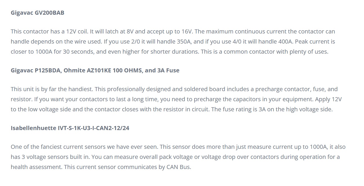

ISASCALE Current Sensor and 3 Gigavac Contactors
gonna provide some screen shots of the original listing in case it sells out and the linky link ends up being orphaned

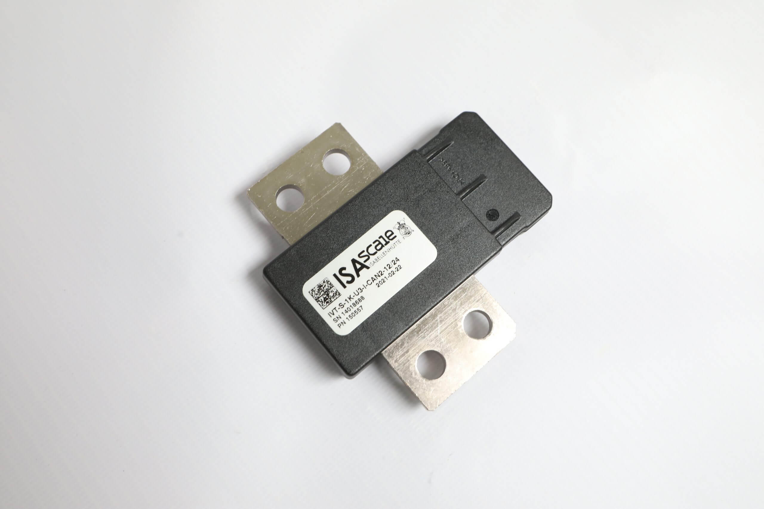

Re: I bought an ISASCALE Contactor Box - Now what?
Posted: Tue Nov 26, 2024 6:11 pm
by Gregski
original pictures from the listing

contactor information
  • 2 X Gigavac GV200BAB-1 $164 each
  • 1 Gigavac P125BDA $87
Gigavac GV200BAB
This contactor has a 12V coil. It will latch at 8V and accept up to 16V. The maximum continuous current the contactor can handle depends on the wire used. If you use 2/0 it will handle 350A, and if you use 4/0 it will handle 400A. Peak current is closer to 1000A for 30 seconds, and even higher for shorter durations. This is a common contactor with plenty of uses.

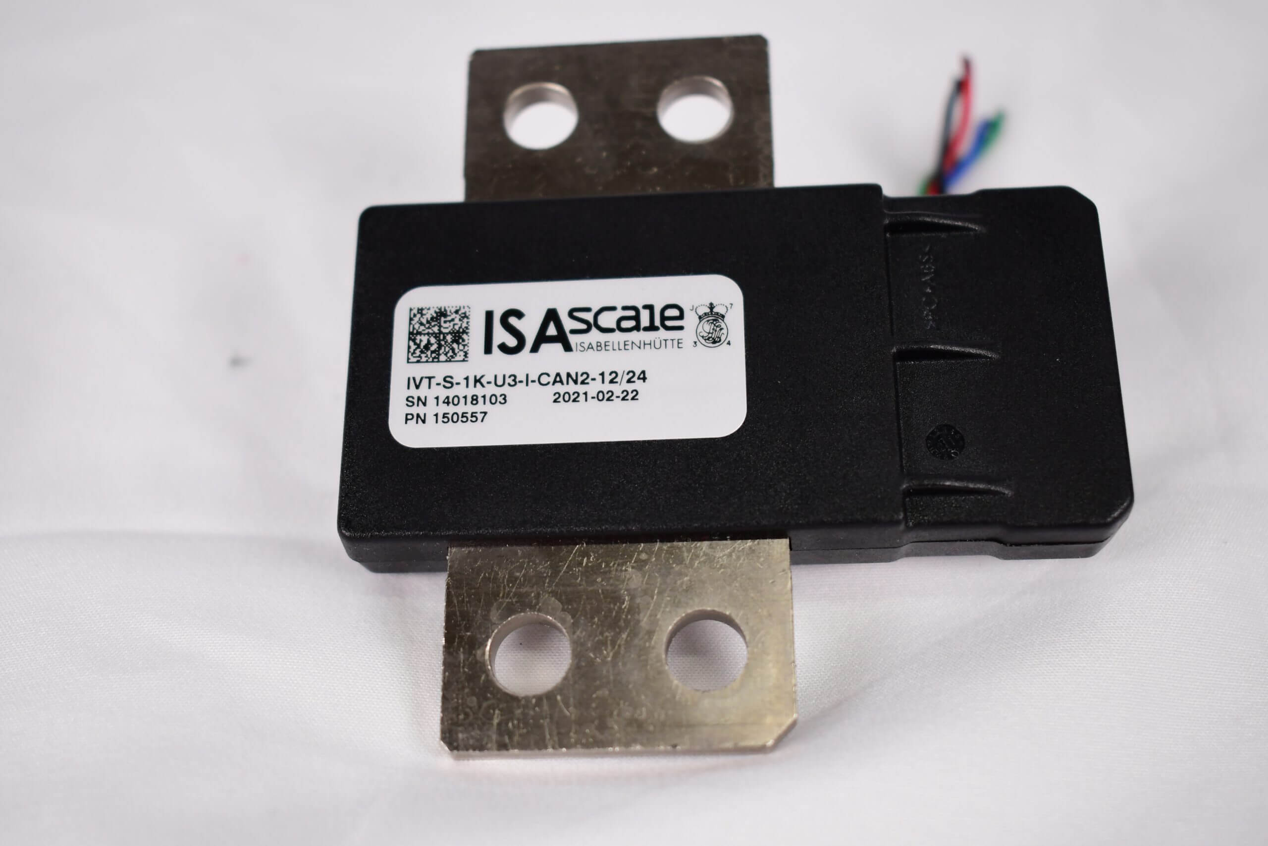

Isabellenhuette IVT-S-1K-U3-I-CAN2-12/24 $372
One of the fanciest current sensors we have ever seen. This sensor does more than just measure current up to 1000A, it also has 3 voltage sensors built in. You can measure overall pack voltage or voltage drop over contactors during operation for a health assessment. This current sensor communicates by CAN Bus.
Posted: Tue Nov 26, 2024 6:21 pm
by Gregski
Gigavac P125BDA, Ohmite AZ101KE 100 OHMS, and 3A Fuse
This unit is by far the handiest. This professionally designed and soldered board includes a precharge contactor, fuse, and resistor. If you want your contactors to last a long time, you need to precharge the capacitors in your equipment. Apply 12V to the low voltage side and the contactor closes with the resistor in circuit. The fuse rating is 3A on the high voltage side.
