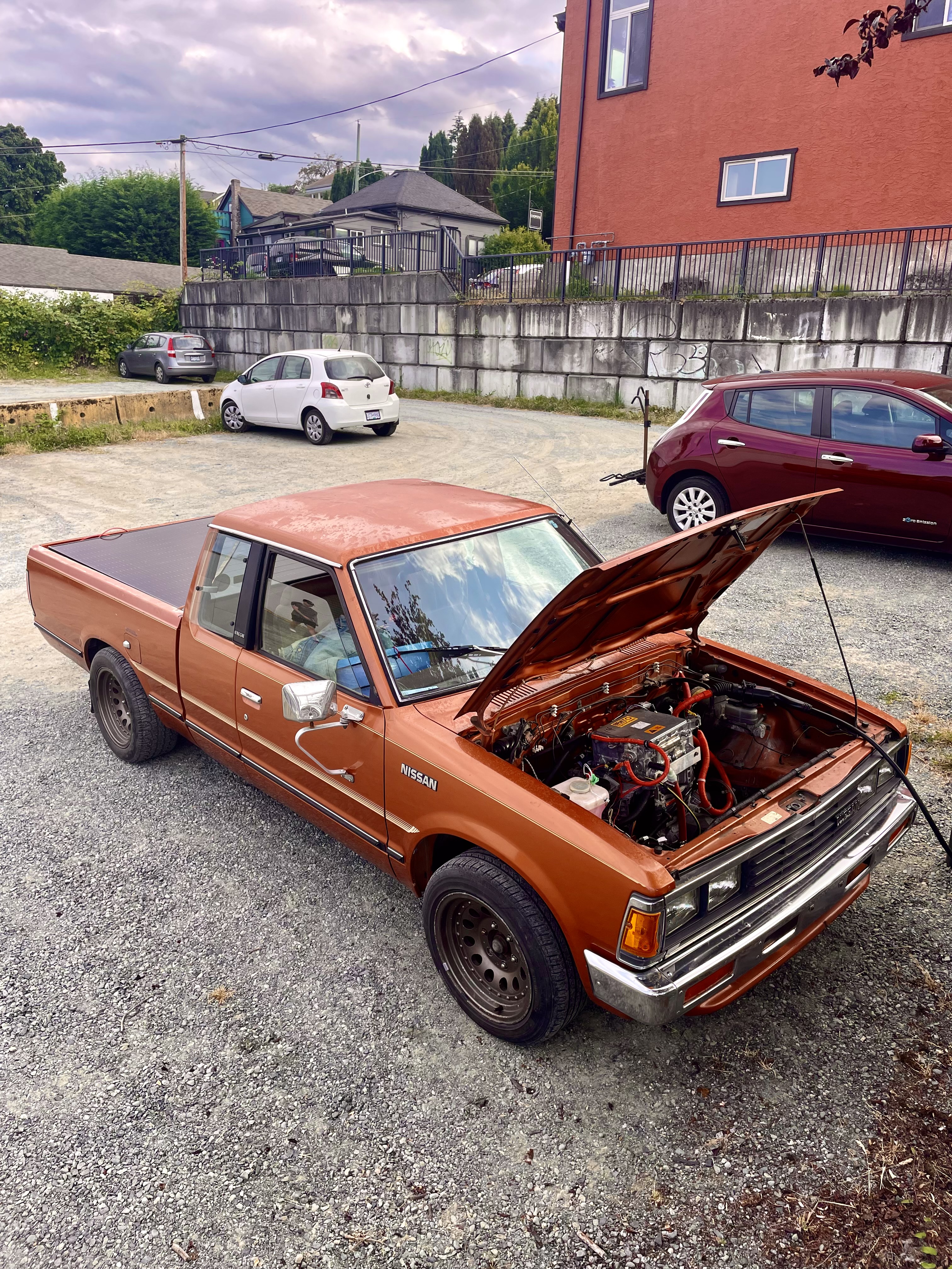

Datsun 720.
gen2 leaf motor, outlander OBC, chevy volt battery, zombieverter, my adapter plates. thrown together on the side of the road with what i mostly had laying around.
Daily driver for around town, cruising and hauling stuff!

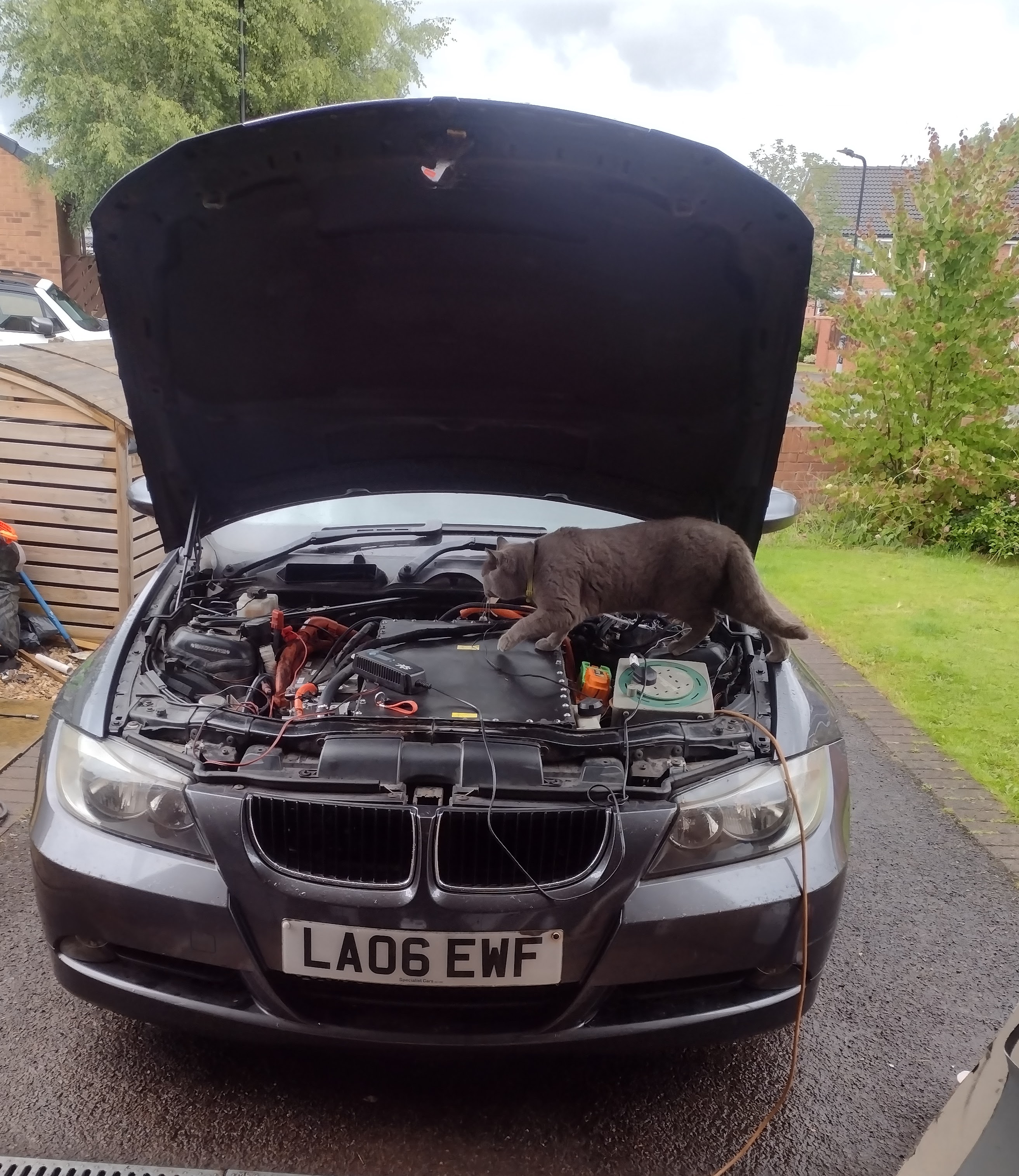

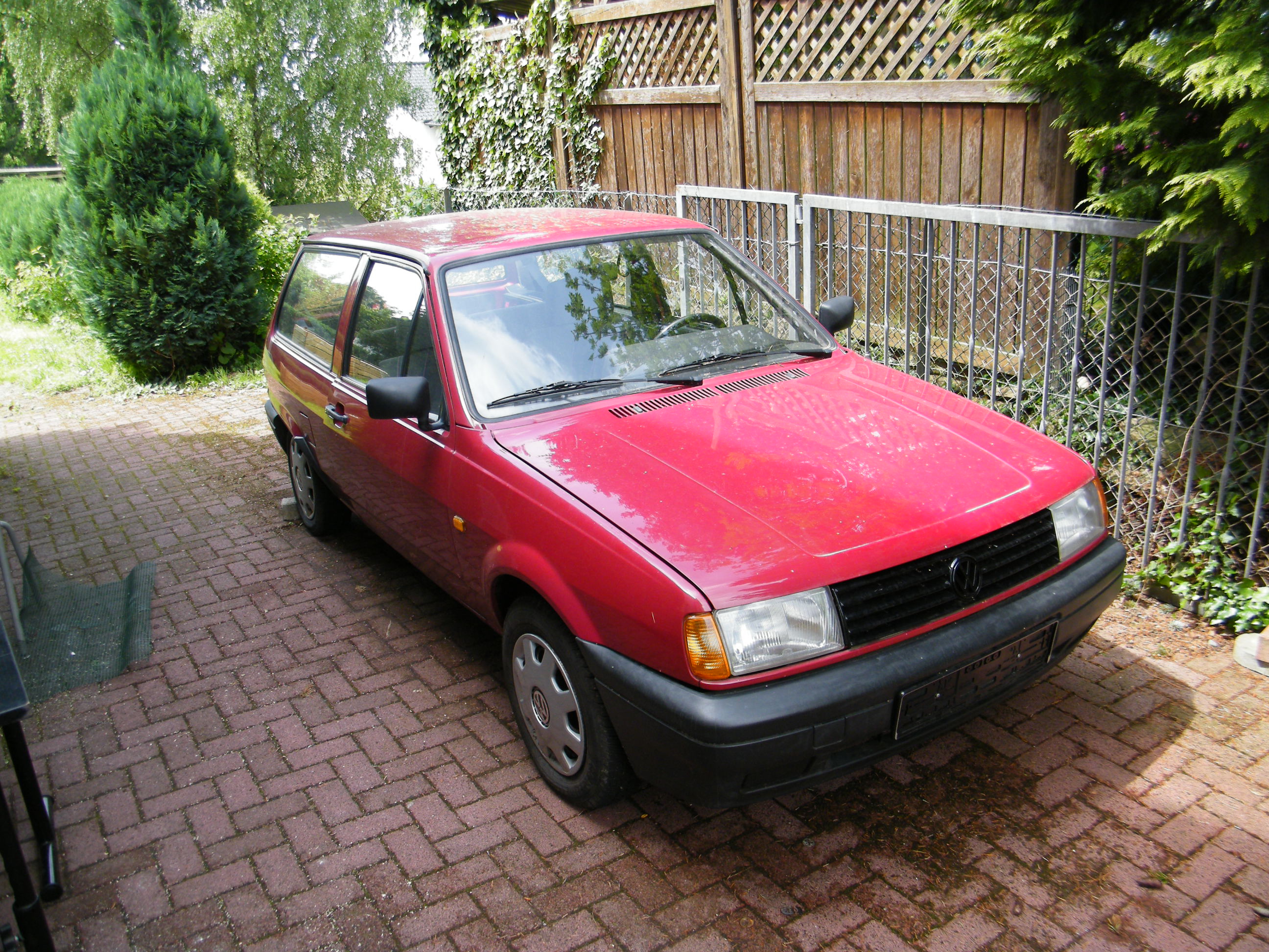

This is my first project, taken by a professional photographer for a newspaper article on the car, they opted for a stock photo in the end :S
This is my current car, I don't have a cat.

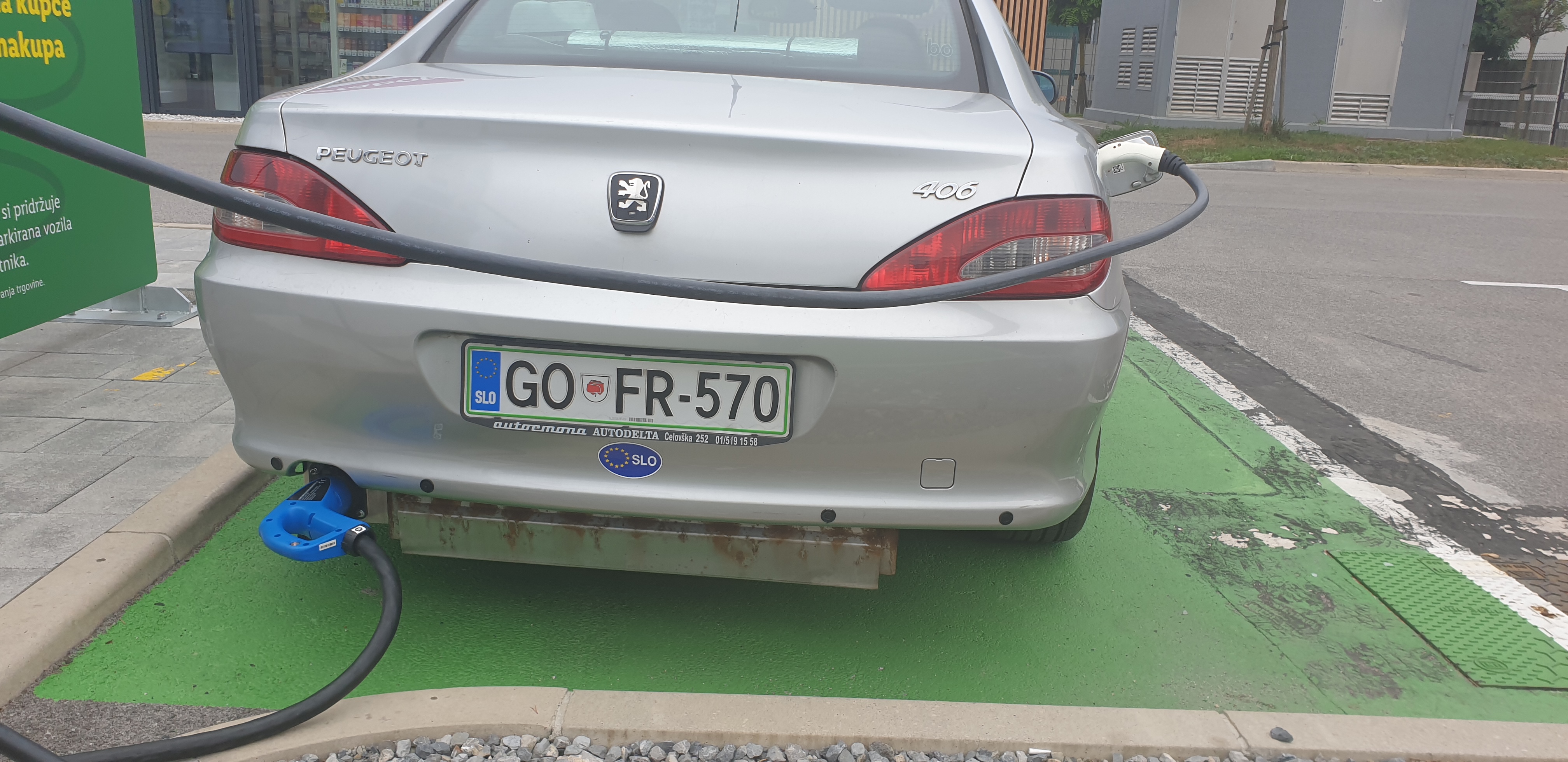

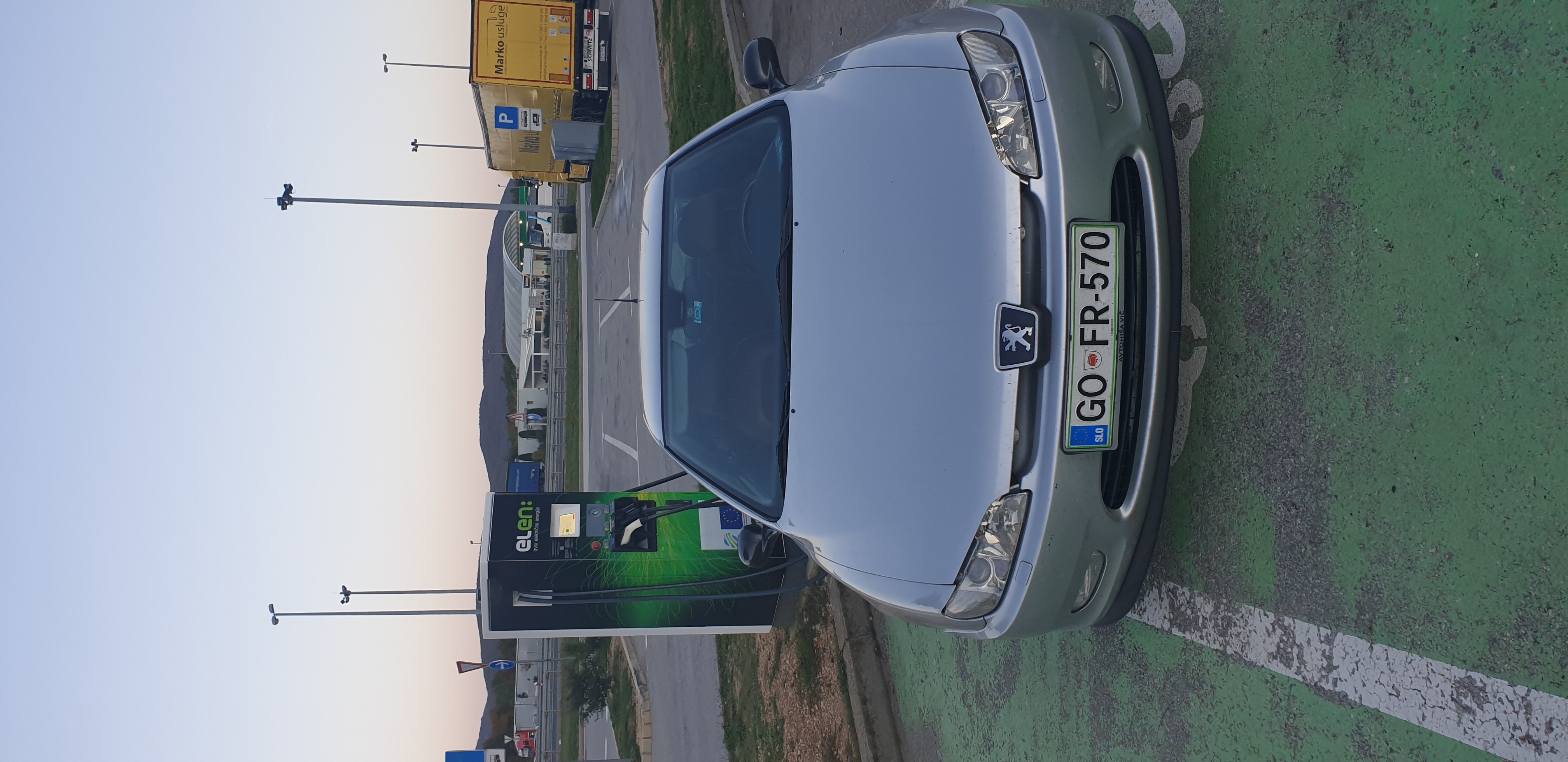

Photos of Peugeot 406C cheeky fast charging :)

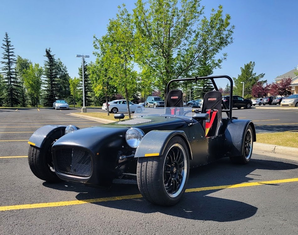

Posts: 385
Has thanked: 168 times
Been thanked: 160 times
Re: Best photo of your build!
Post by Zieg »
Heh, blood, sweat, and tears.. I believe there are trace amounts of all three circulating through my cooling system and various other parts of the car.
Scratch built Lotus 7 replica, built for autocross but with concessions to keep it street legal/driveable. Leaf drive with OI board, Pacifica battery, Thunderstruck BMS/charging (Foccci coming soon). 1450 lbs according to the roadside scale.
Build thread

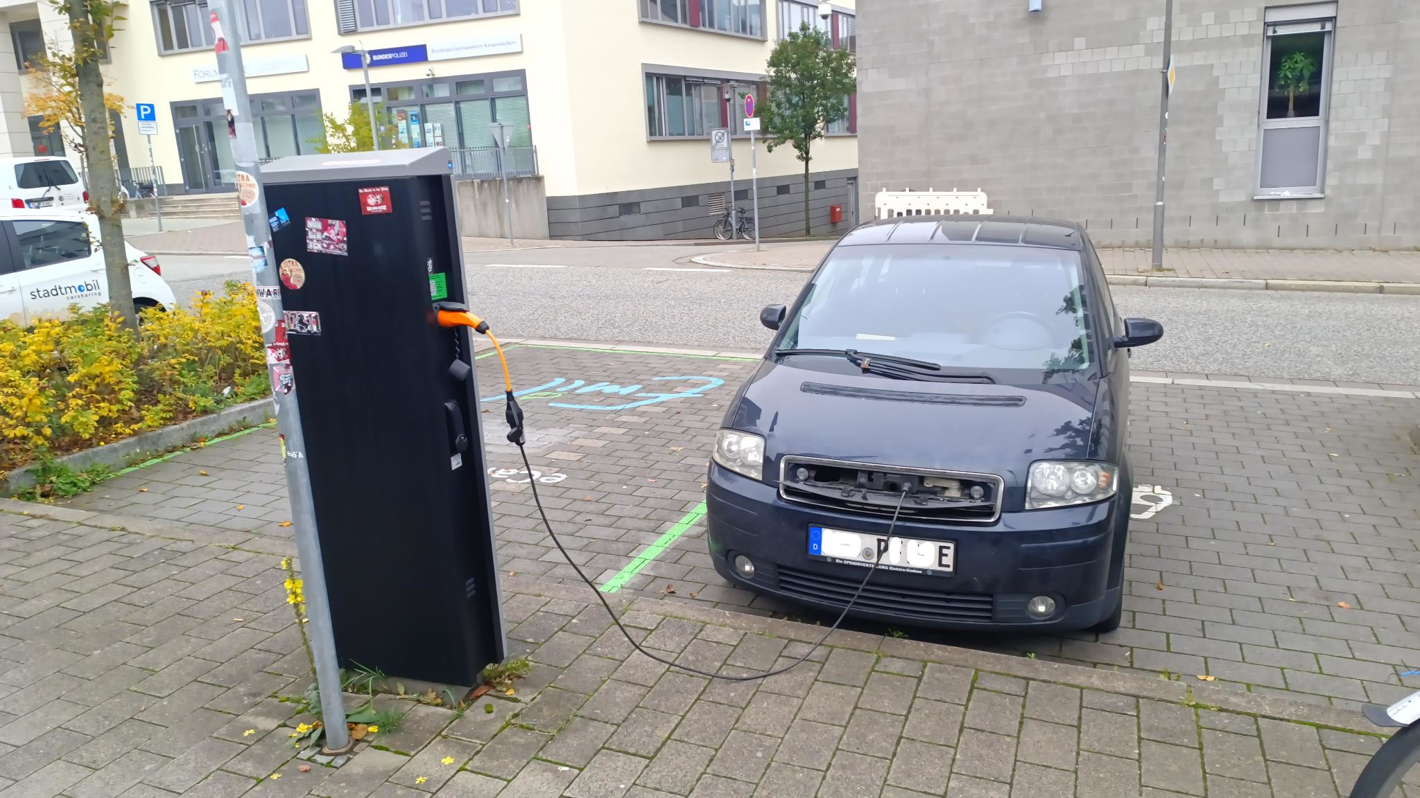

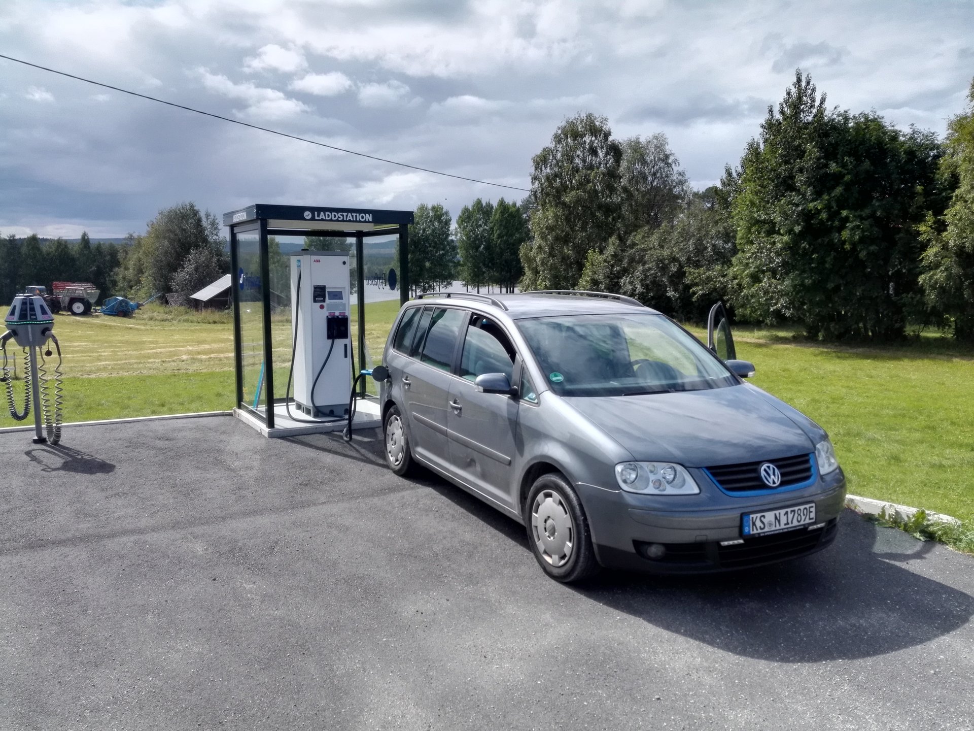

Favorite car at my favorite place :)
Leaf motor, MEB 52 kWh, CCS rapid charging
Only good Audi A2 photo

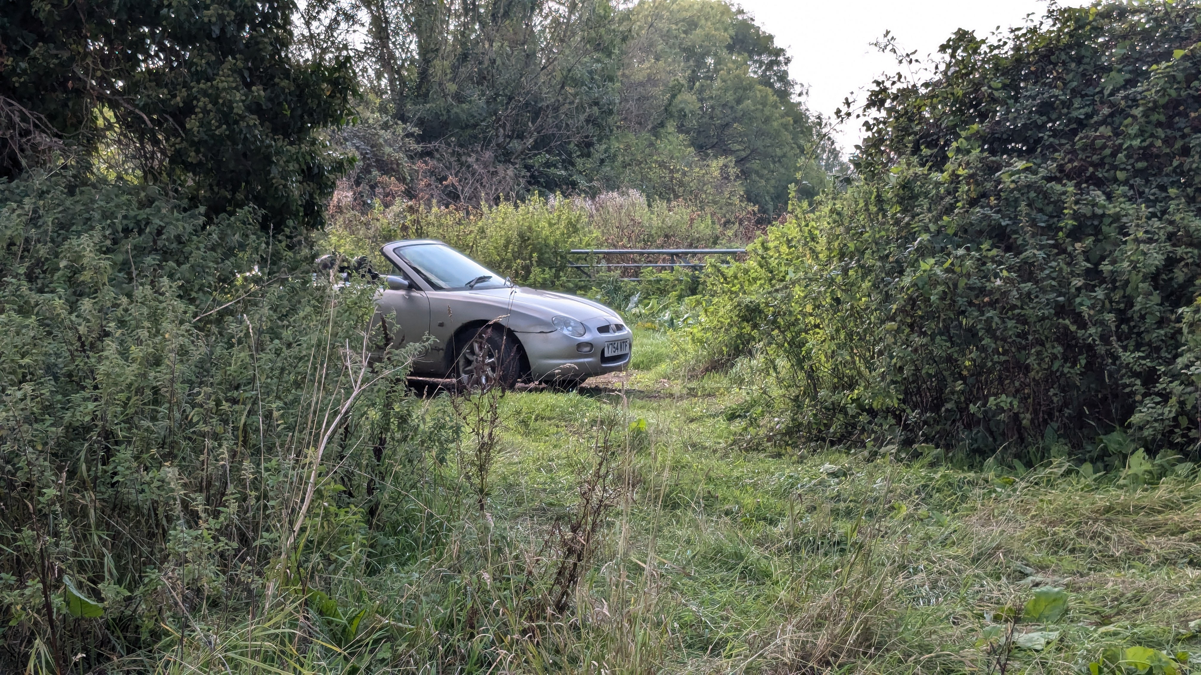

Last time I had the top down this year in comfort. Taken while dropping off some spare parts to a broken down baler during the final bit of hay making we got to do this year.
MGF - Zombie. Outlander Rear Motor, inverter, charger. 12kWh BMW hybrid battery.
Build thread: viewtopic.php?t=181

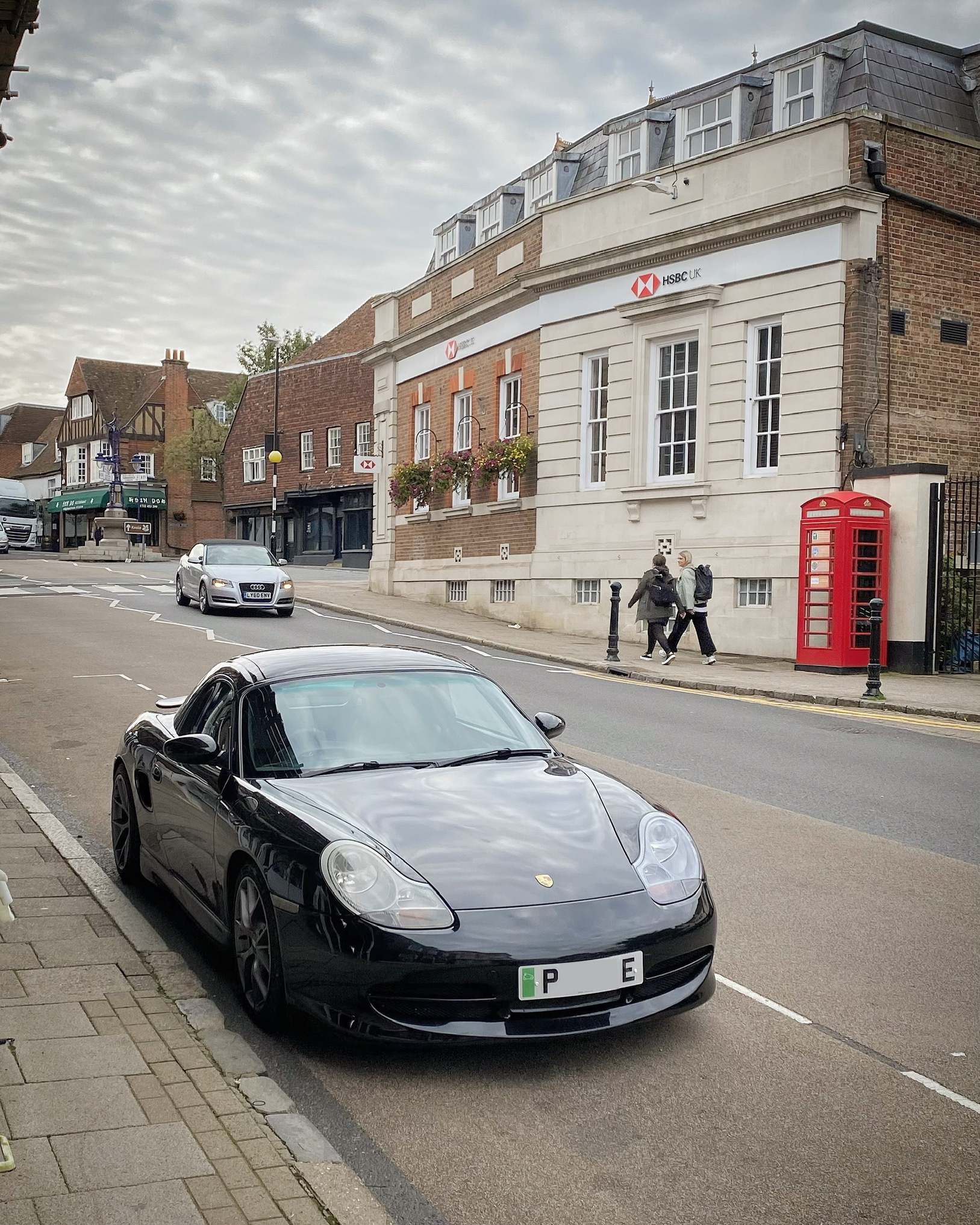

2000 Porsche Boxster with Tesla LDU and baby Chevy volt battery.
Build thread here: viewtopic.php?t=210&hilit=Porsche

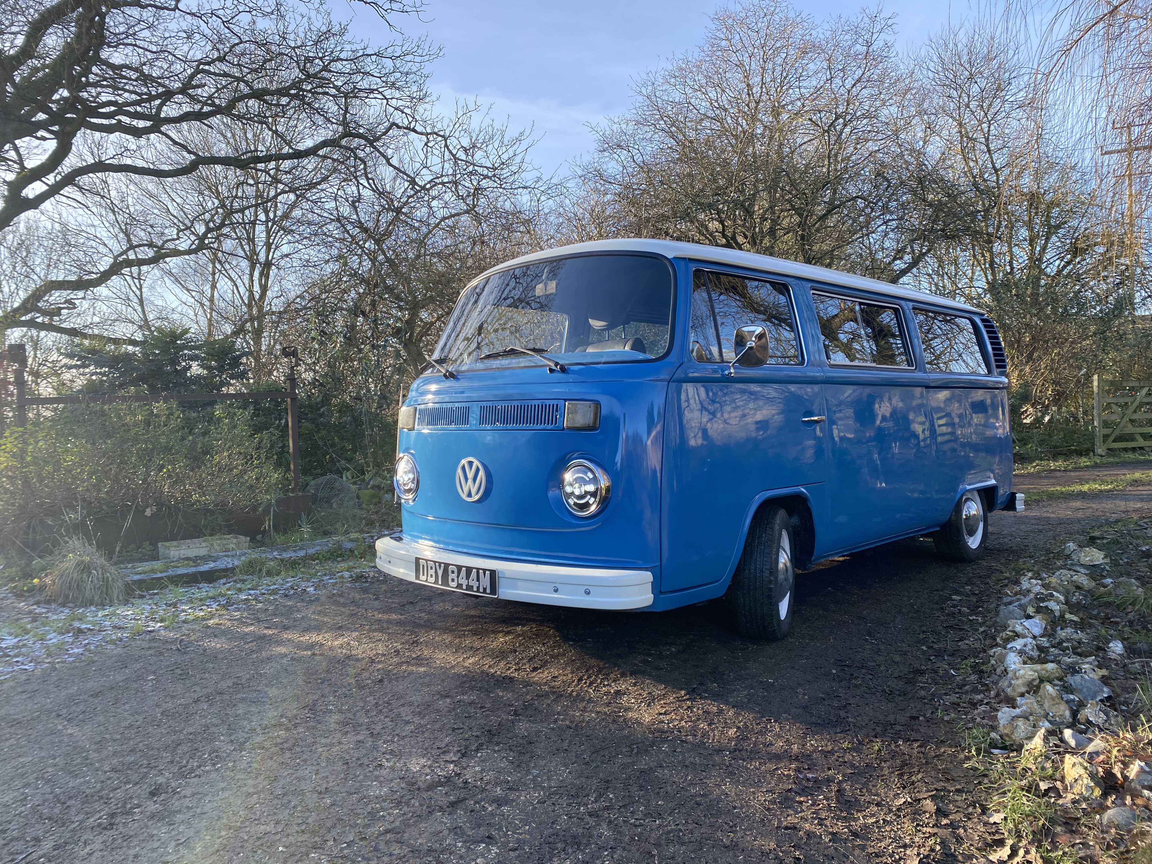

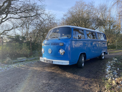

1974 VW T2
Originally with 1800cc petrol.
Now - 2015 Nissan Leaf 80kW motor, inverter, PDM.
Battery from later (2022?) 60kWh Leaf. BMS from 62kWh Leaf.
Mounted to VW gearbox using Brat Industries adaptors and coupler. Left in VW mechanical 3rd gear.
VCU - Resolve-EV
Used for summertime festivals and other camping fun. Travelled 1200 miles at the time of writing as an EV. Range on full charge 150 miles.
Build thread - https://openinverter.org/forum/viewtopic.php?t=4943
