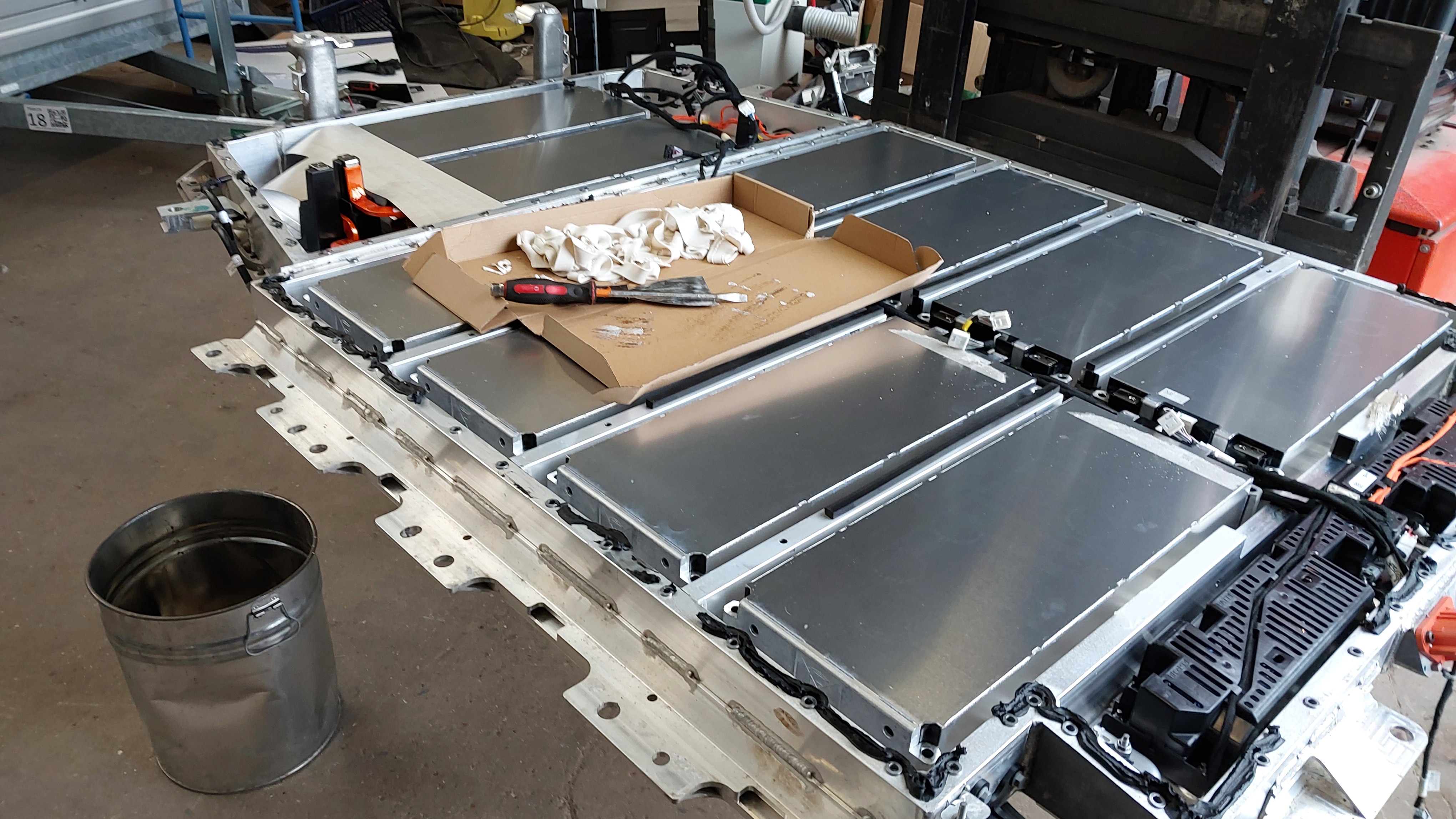

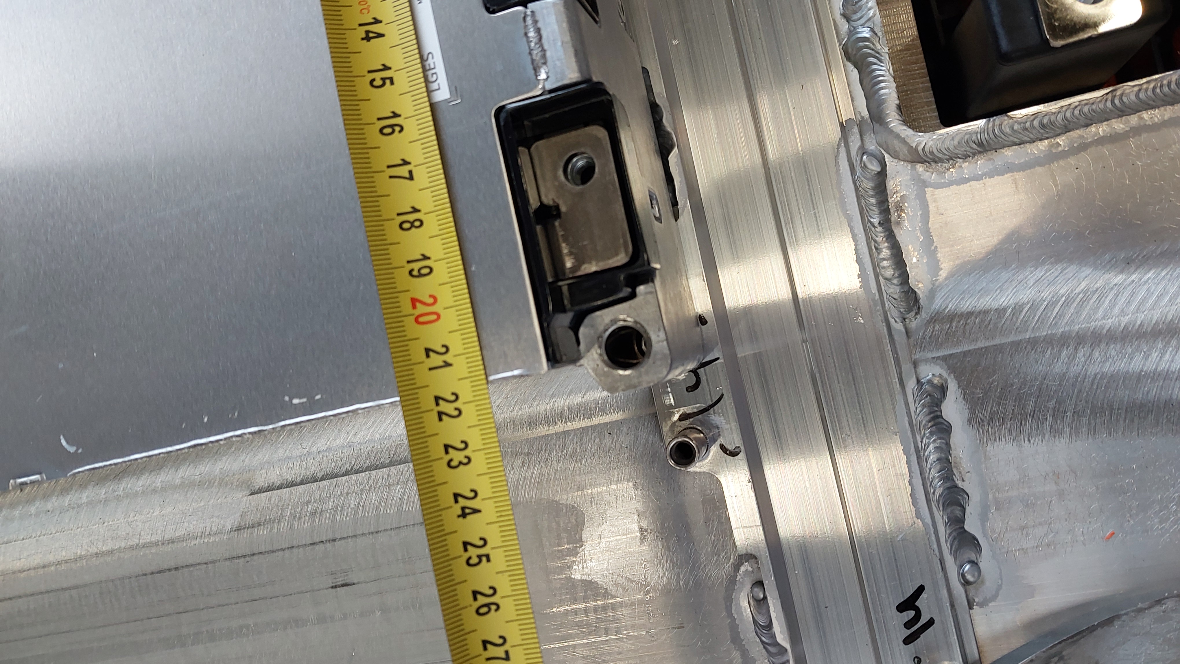

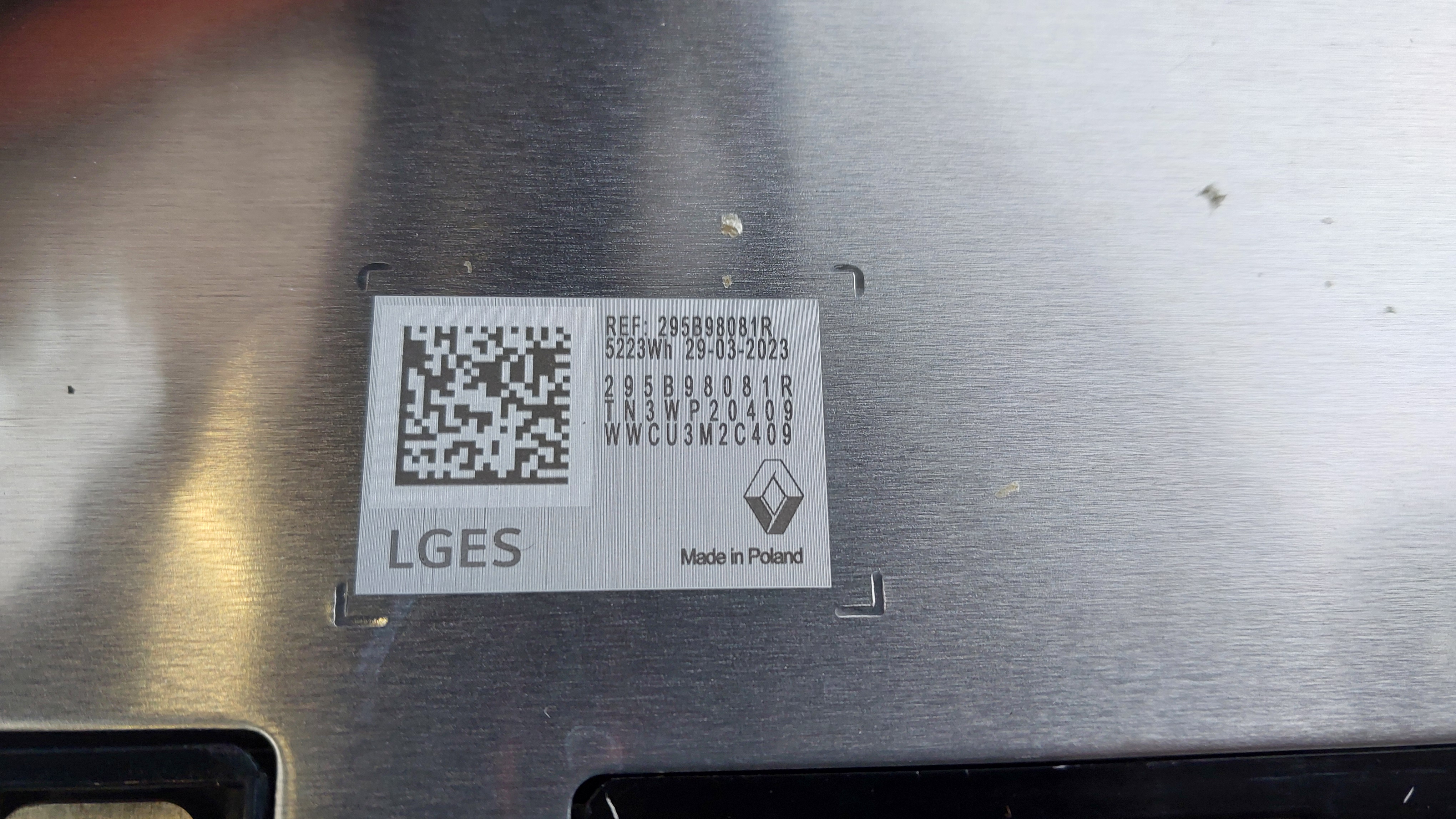

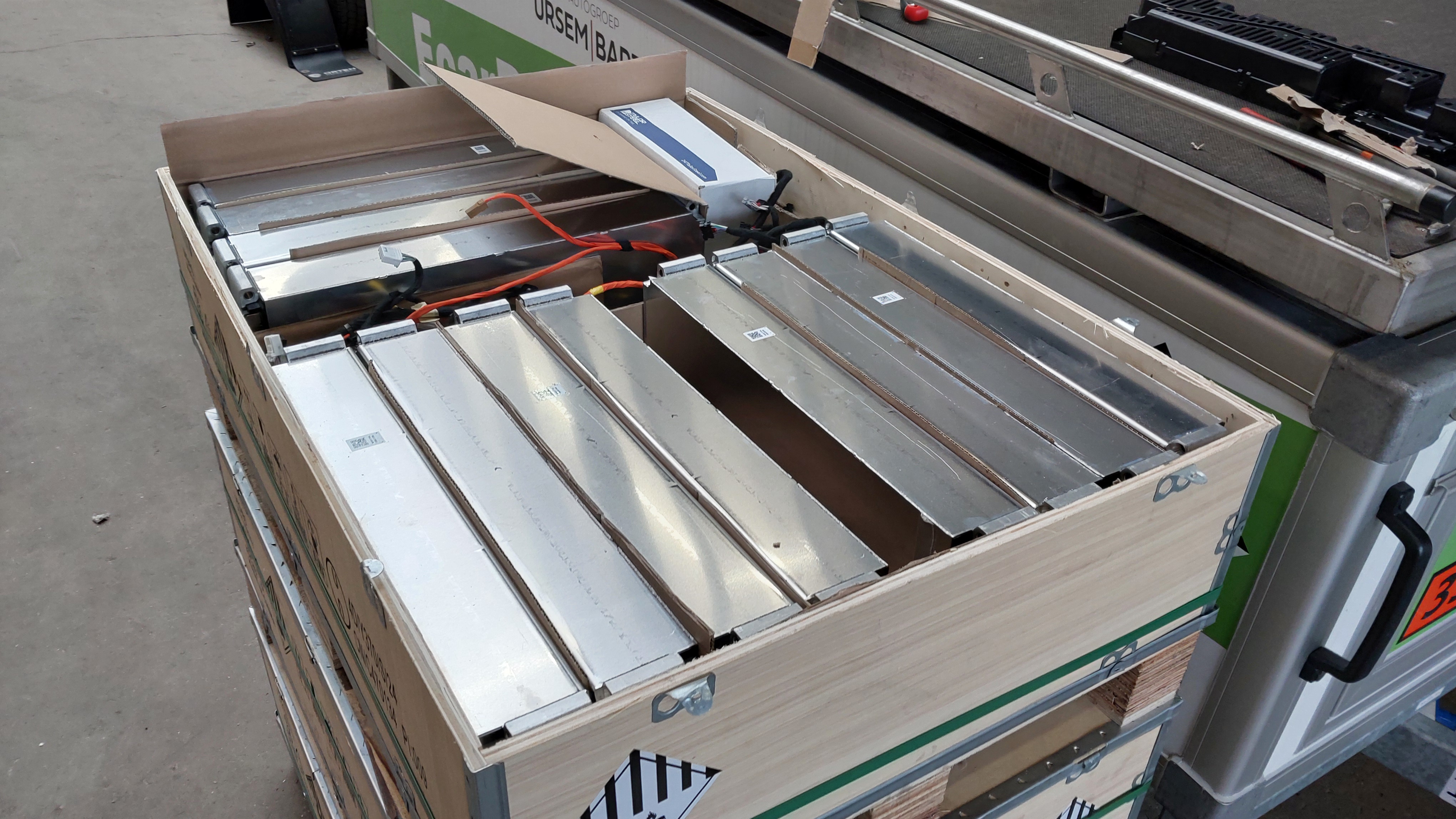

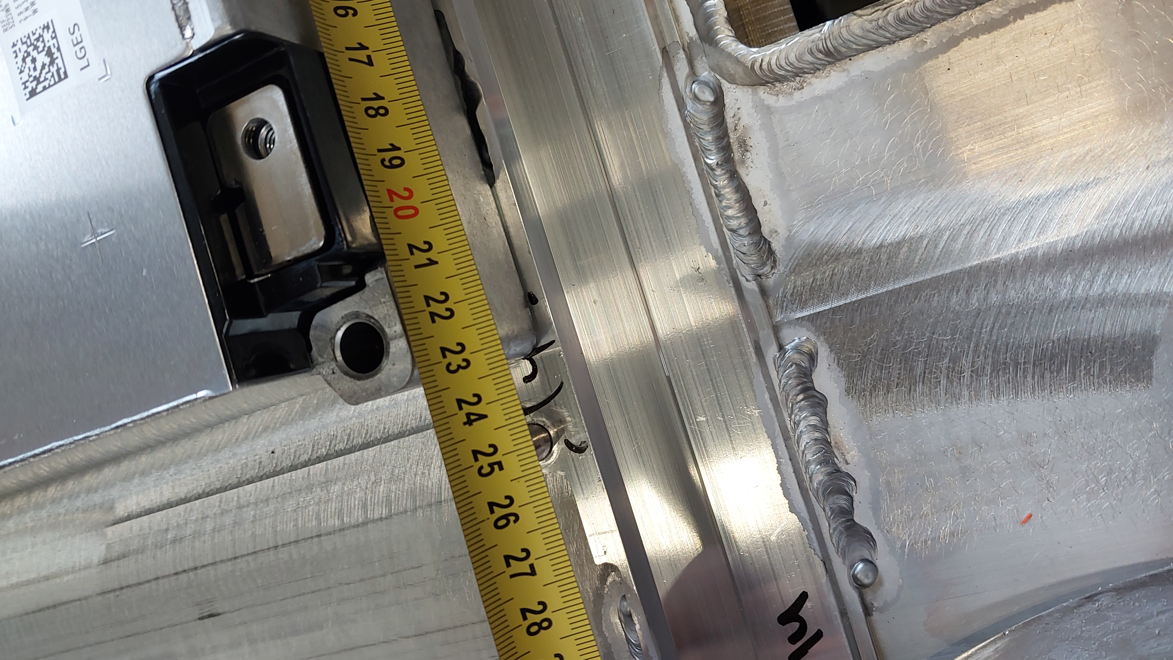

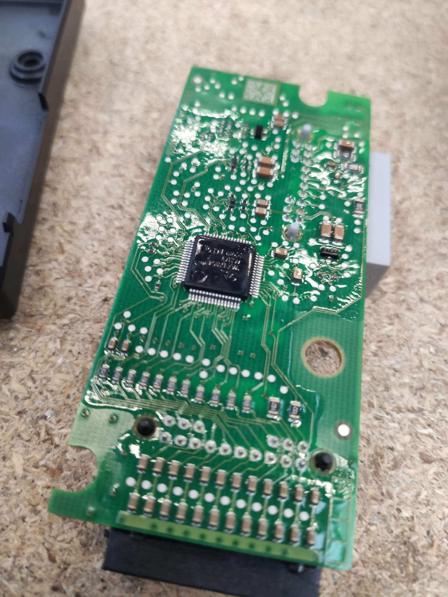

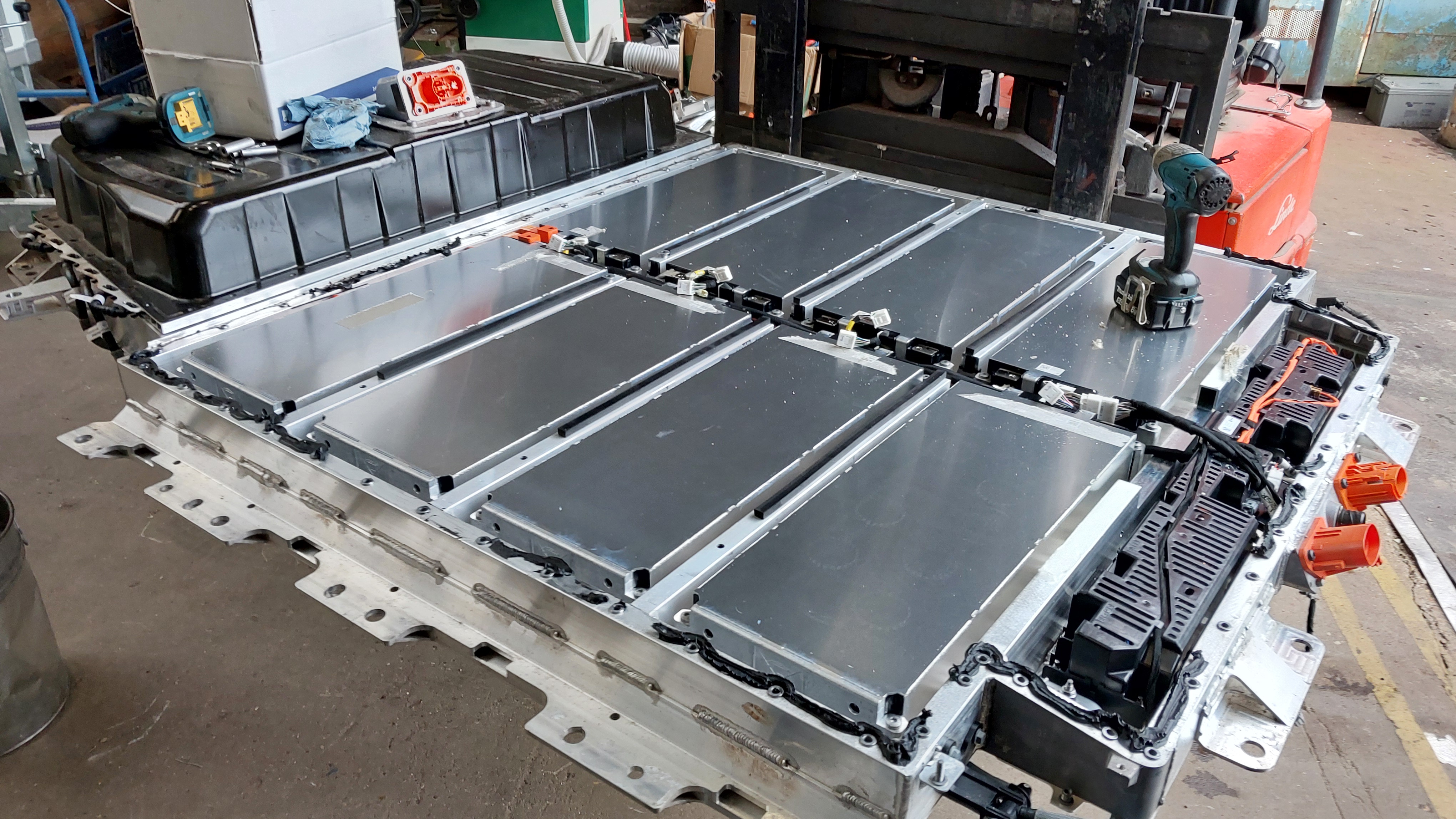

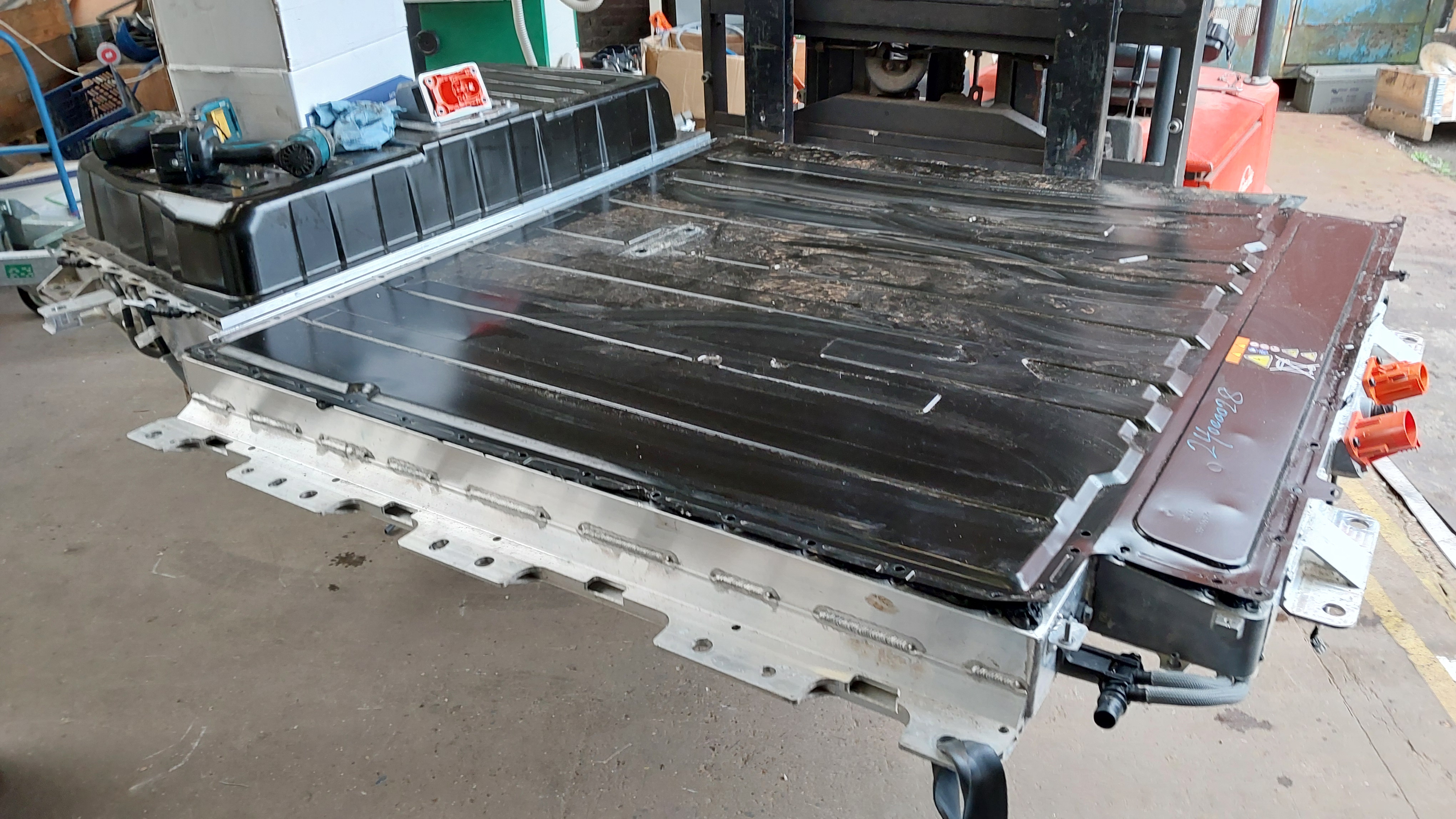

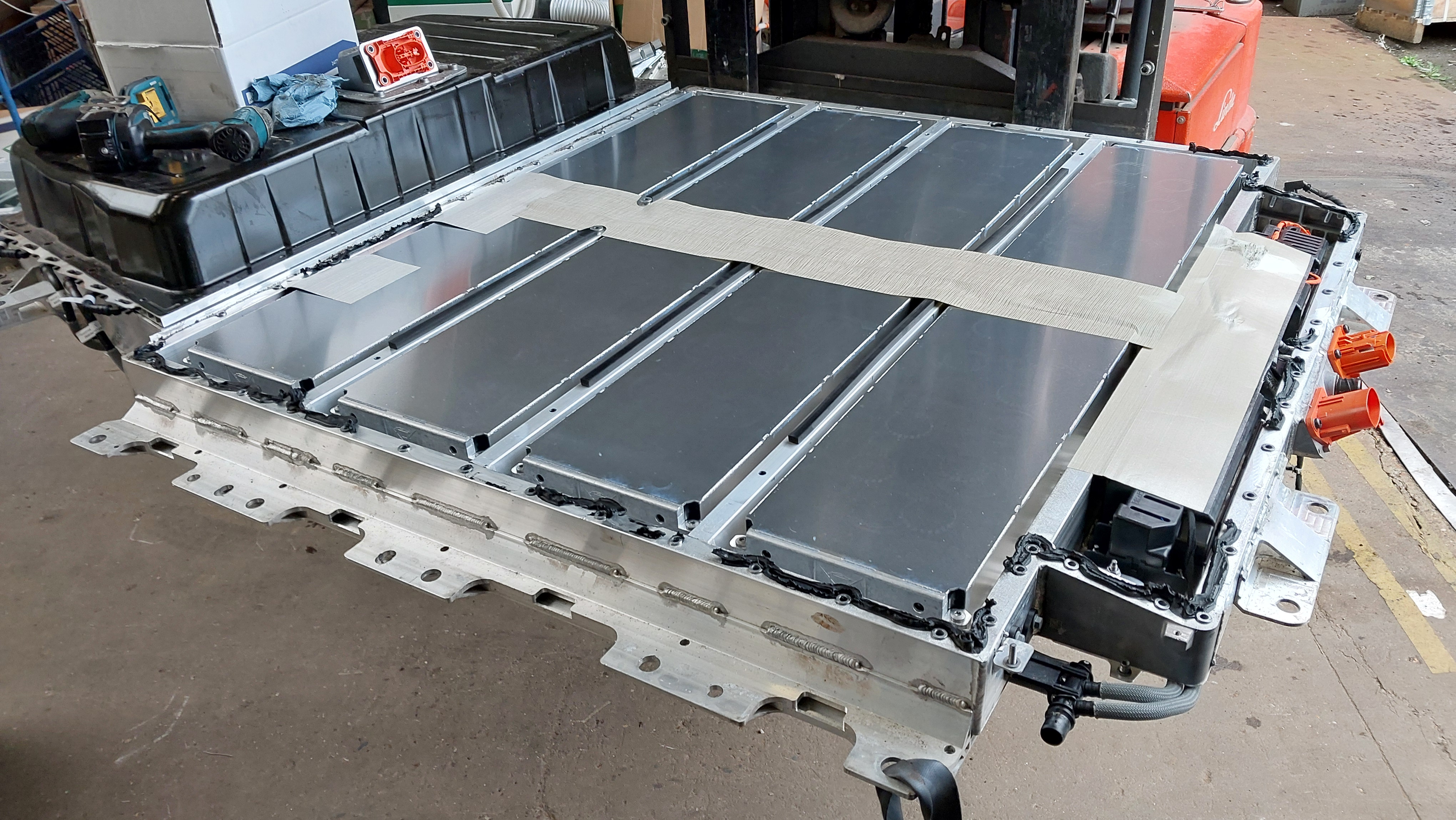

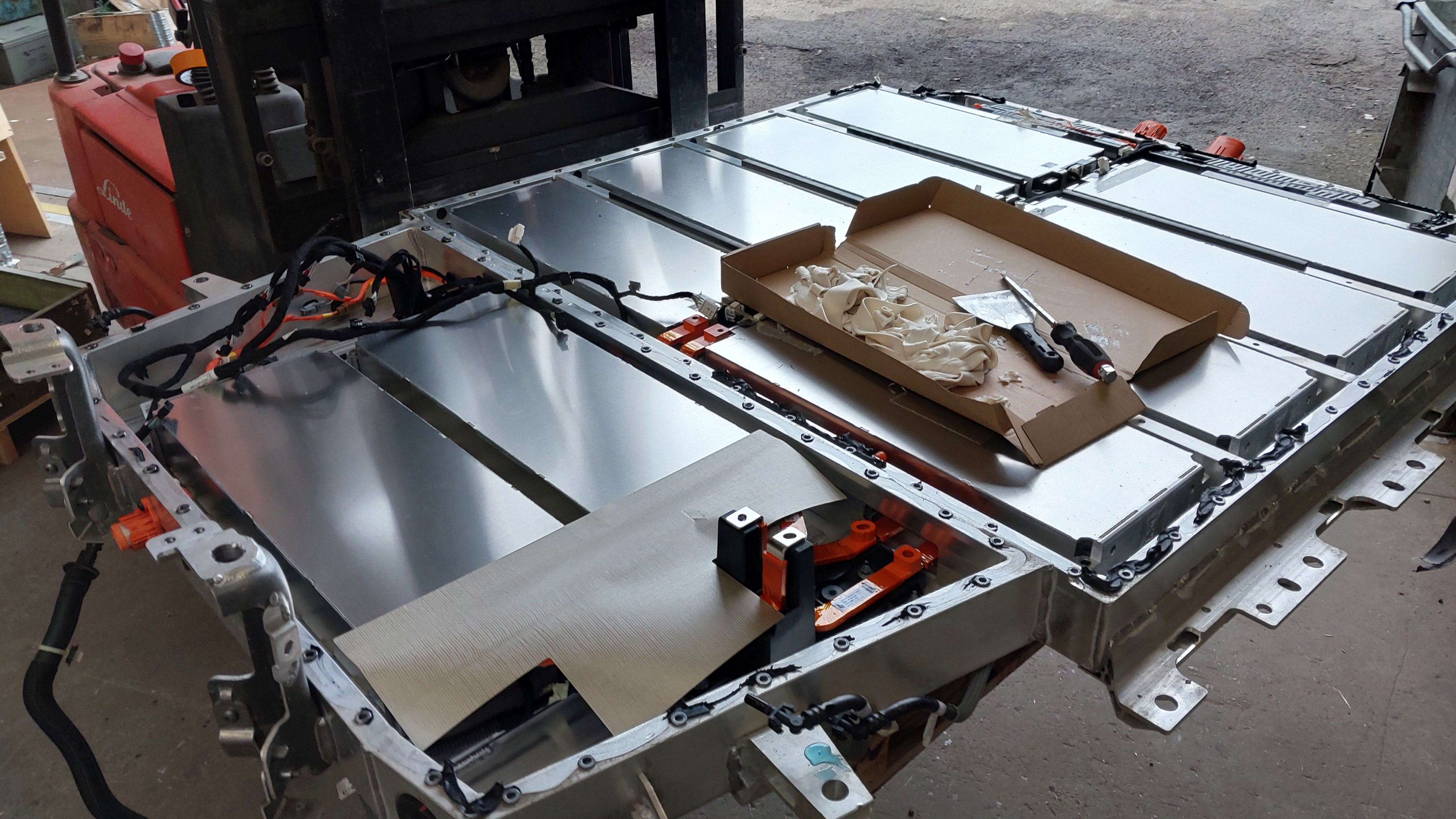

Renault Megane E-tech EV60 battery dismantling
Post by boekel »

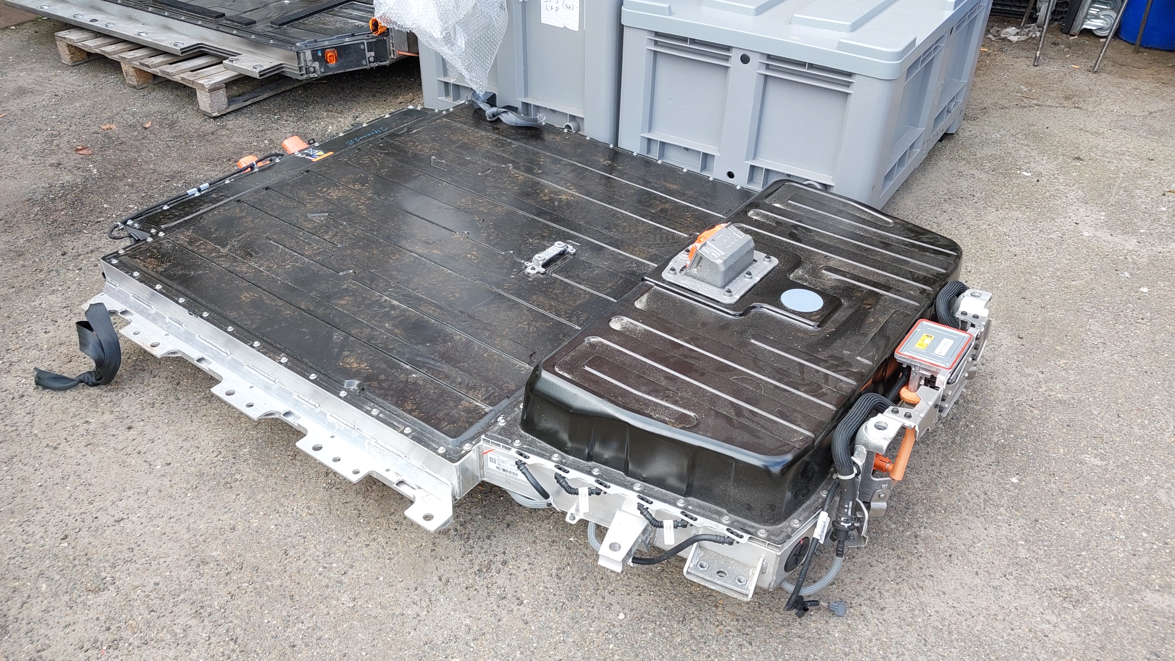

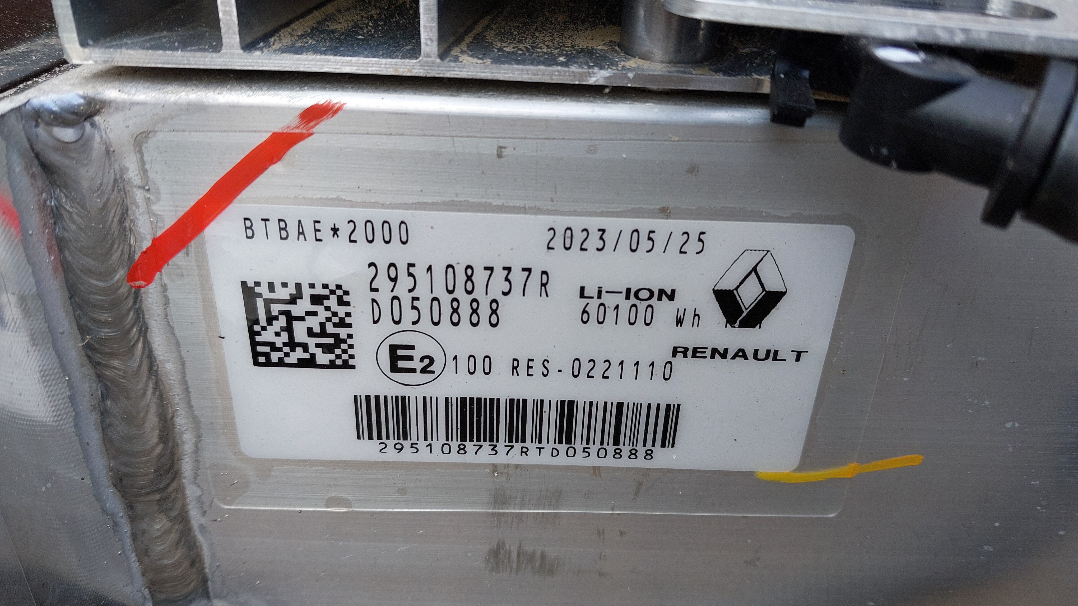

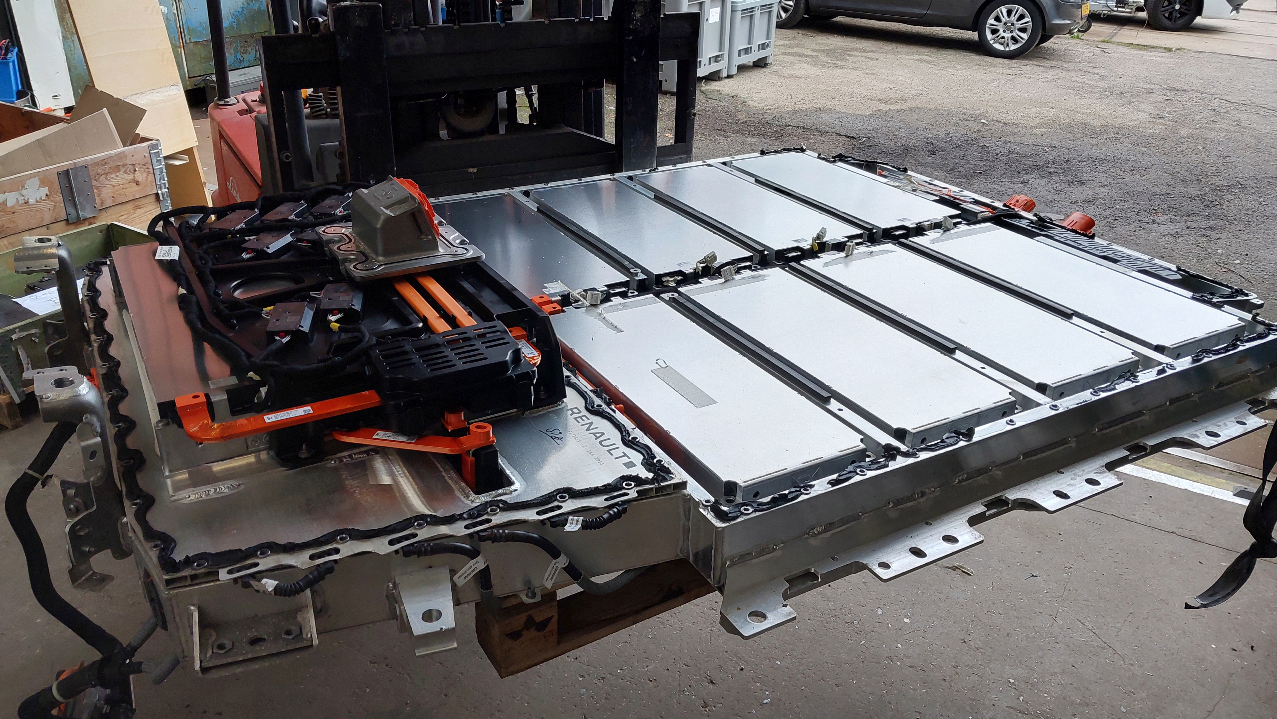

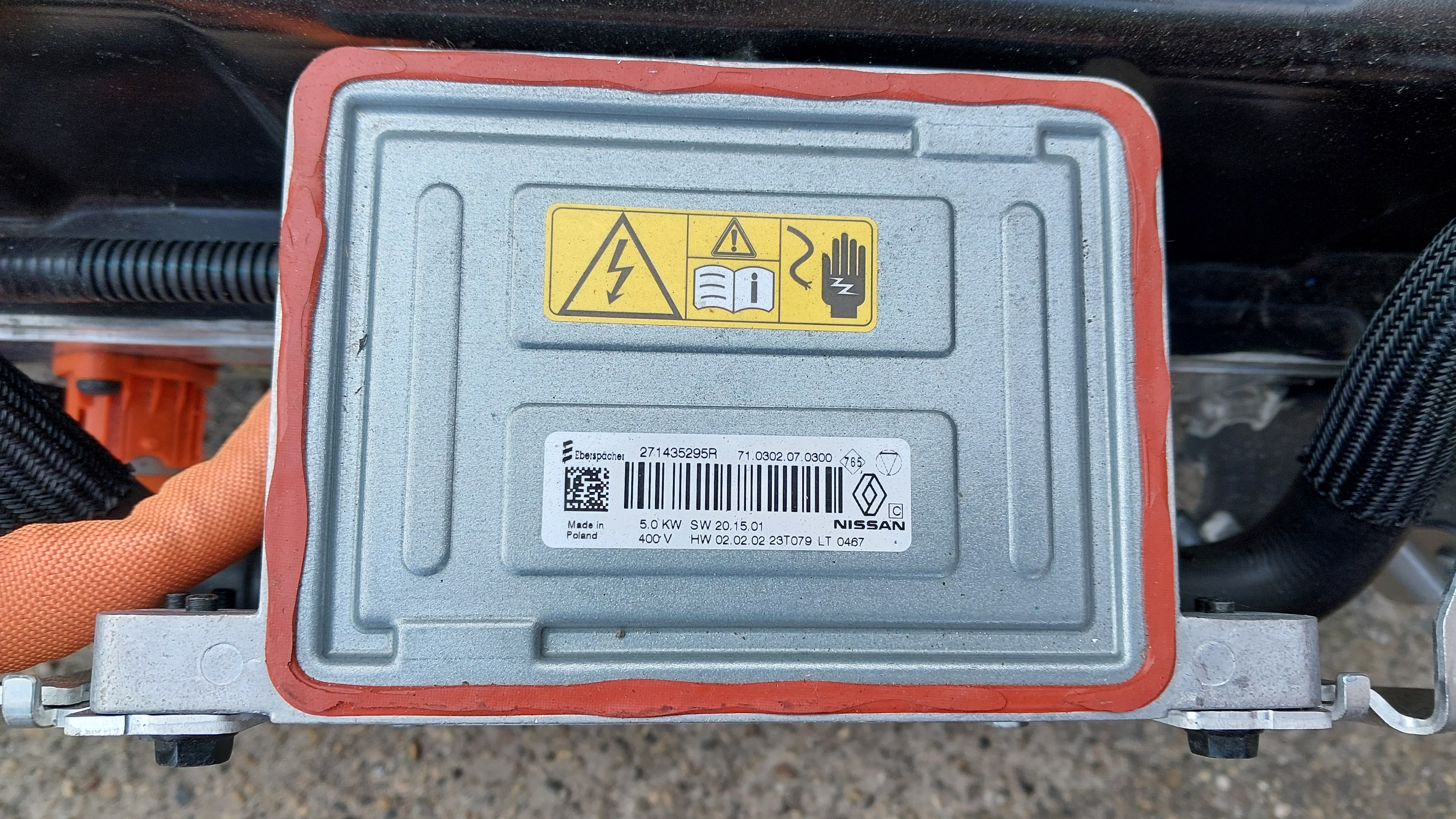

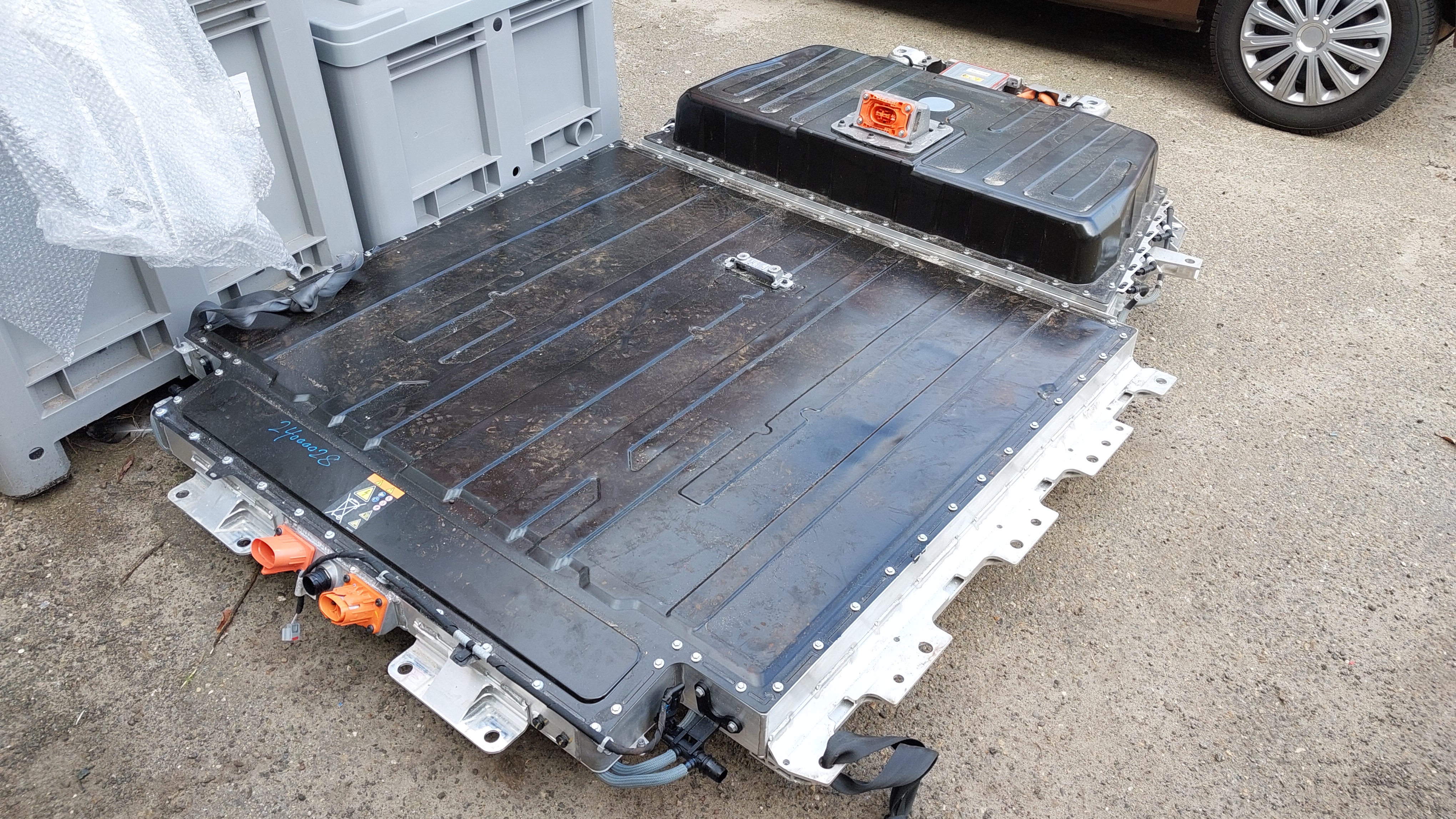

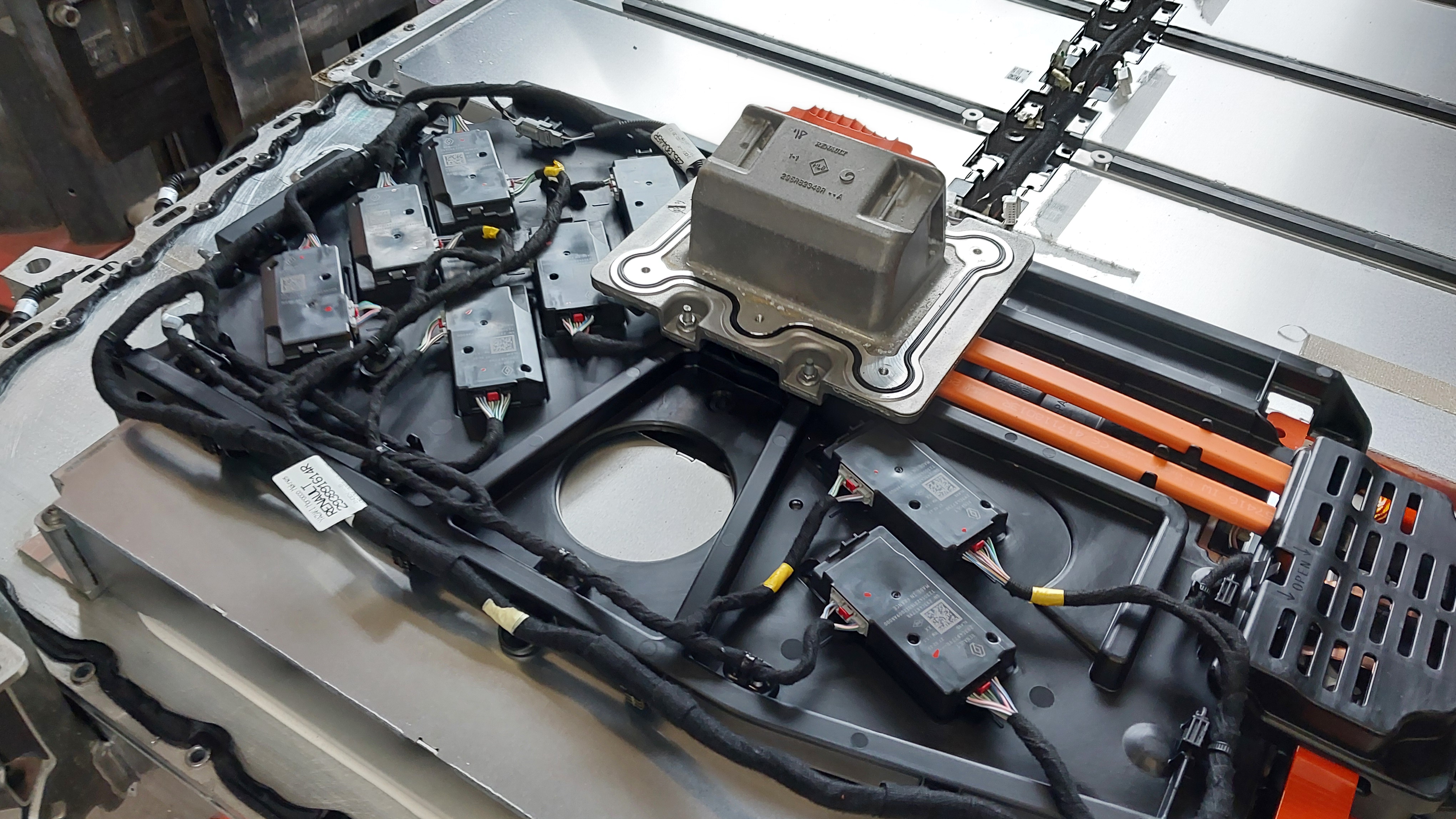

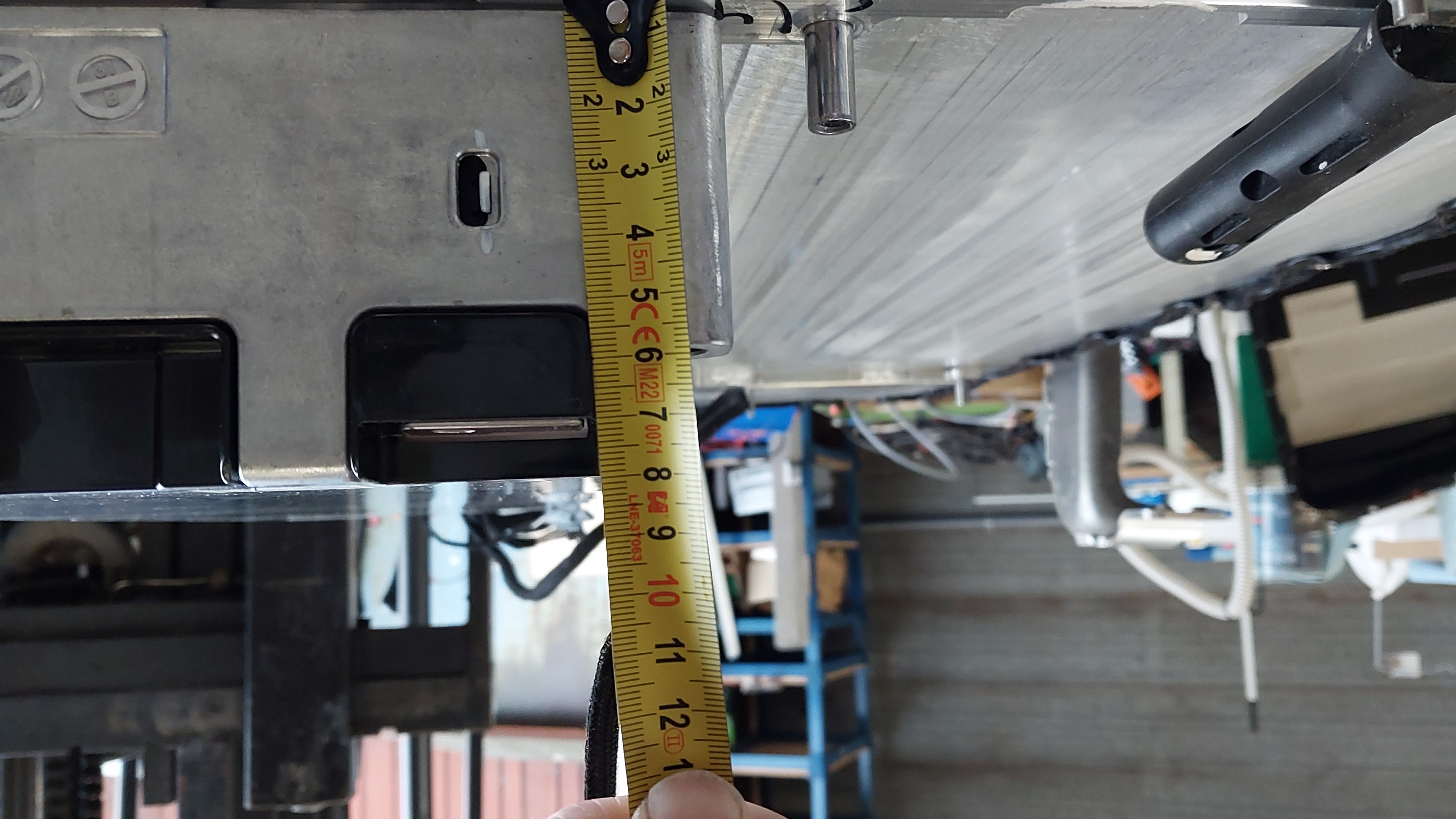

The 2023 Renault Megane has some nice 8s modules (12 of them) connected to 8x a 12s CMU (with the Max chipset)

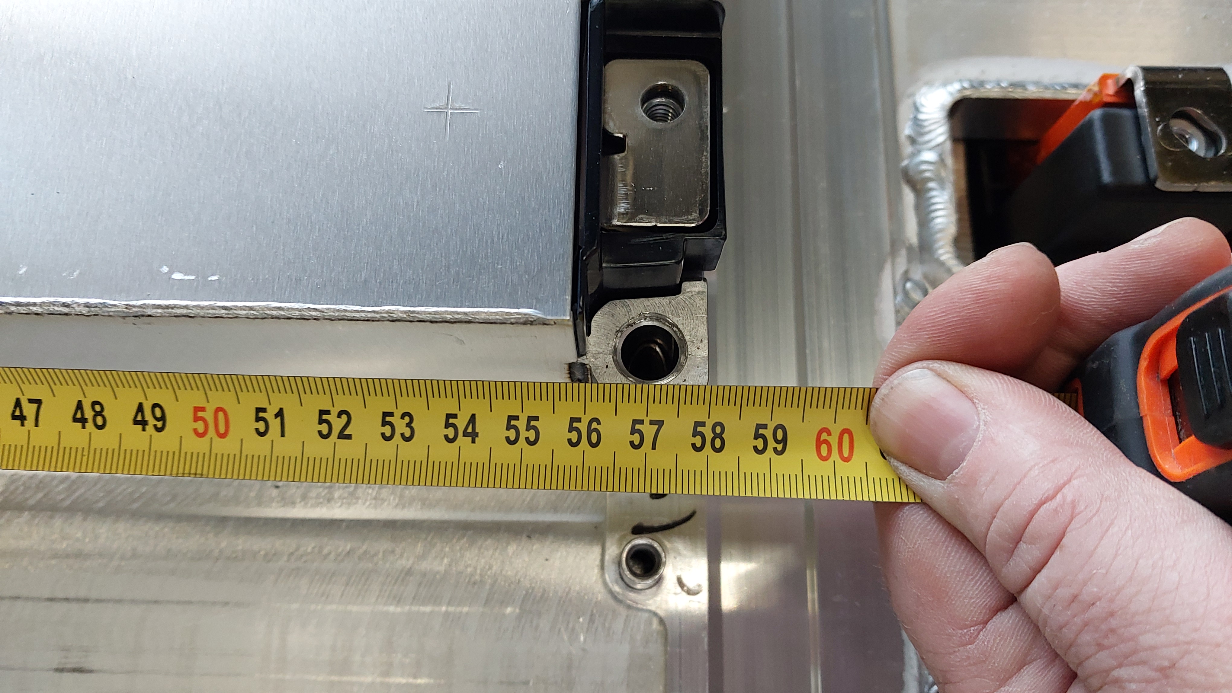

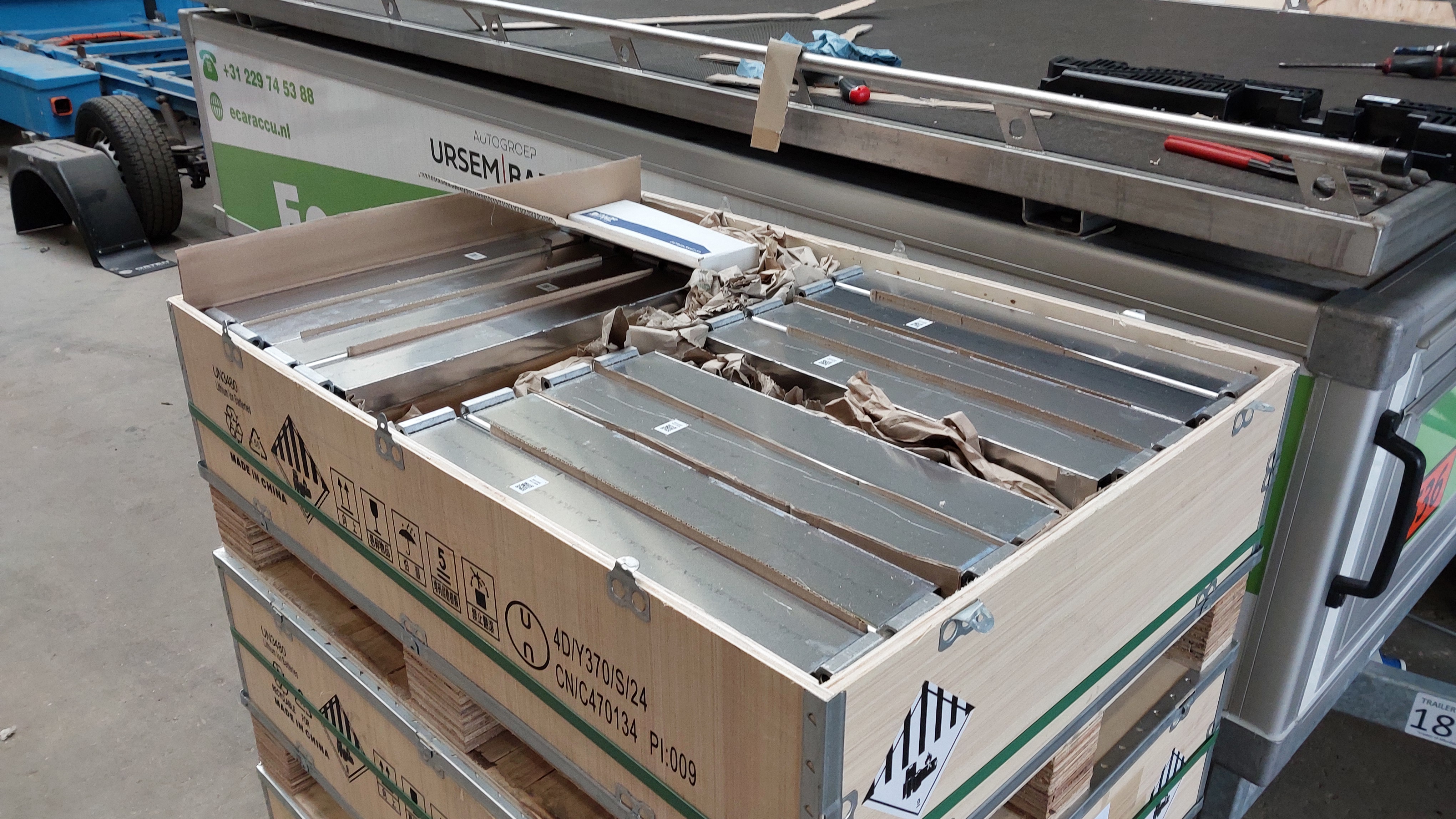

So: nice size modules, smaller than MEB modules! (they can be too big sometimes)

boekel wrote: Tue Oct 01, 2024 10:50 am So: nice size modules, smaller than MEB modules! (they can be too big sometimes)
How are BMUs connected to main controler? Via CAN or SPI? Would we need to keep 12x BMUs + master BMU?
Tnx
boekel
Posts: 135
Been thanked: 25 times
Re: Renault Megane E-tech EV60 battery dismantling
Post by boekel »
arber333 wrote: Tue Oct 01, 2024 11:18 am How are BMUs connected to main controler? Via CAN or SPI? Would we need to keep 12x BMUs + master BMU?
Tnx
it's 8* a 12s BMU (connected to 12* 8s modules)
looks like 2 wire comms, not CANbus
