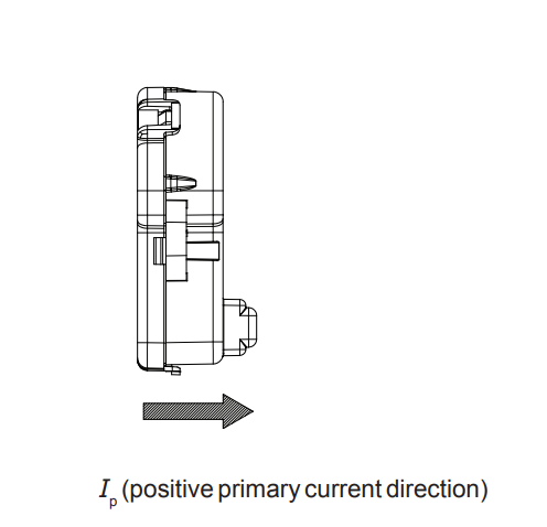

Does anybody know if orientation of the CAB300 matter? It can be mounted with the front side with LEM logo facing the battery and with the back side facing the battery. I mean will current reading be positive or negative or it won't have any difference? 😊
Posts: 2962
Has thanked: 330 times
Been thanked: 847 times
Re: LEM CAB300 C/SP2 Current Sensor
From the datasheet
Installation requirements in this datasheet for the CAB sensor range.
https://www.lem.com/sites/default/files ... eet_v1.pdf

Hi, sorry for non technical person is the positive current when it is drawn from the battery through the negative busbar?
Posts: 2962
Who knows, up to you and your BMS.
