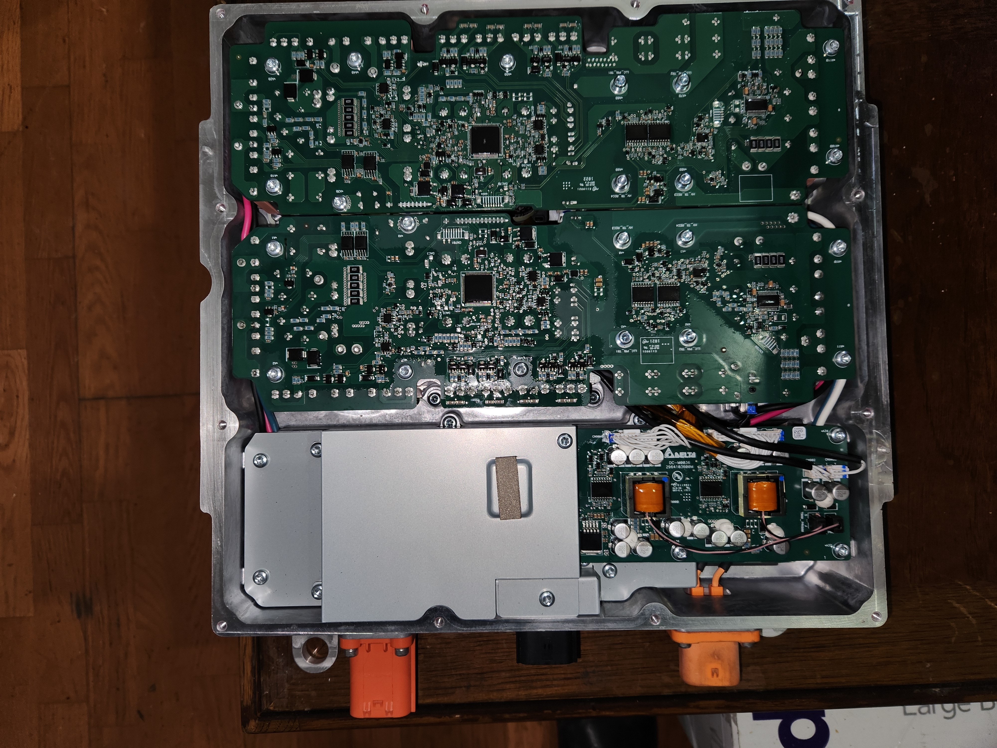

I also collected some of the part #s, but not all. I will post more and more photos of the unit this weekend as I integrate it into the car. Speaking of integration, I will post later today about my control plans. I'm working on an idea for a simple board to control the charger based on input from FOCCCI and the ISA shunt.
Battery connection: TE 4-2103177-4
AC connection: Aptiv 35197127
Control connection: Same as Volt Gen 2, Molex MX150 33472-1201
Photo attached of my sketchy in car testing. The standoffs on top of the charger are the mounting points for the DC-DC converter.

Not much of an update, but I do have a few photos to share (below), and I did get both units mounted in the car. It does look like the part number of the DC-DC converter might need updating, the one I had ordered had the necessary pins blocked off, and it looks like there are a mountain of very close parts with different pins blocked off. I have a new one coming tomorrow and will update once I know it works.
Anyways, here are the charger part number, DC-DC part number, and the two stacked. One note on the part numbers - it does seem like there are several different numbers used, and most wrecking yards list the components as the wrong thing on Ebay or Car Part. Both of these they categorized as "ECM"
DC-DC
Charger
Stack

I wonder if the charger has some sort of hard coded limit on the amps it will draw on 120V power. I'll need to experiment with that a bit as well.
On 120V it only uses 1 of the 2 internal boards for charging. It's a 3.6kw charger on 120v essentially.
Not sure how the 11kw version would work though.
I have pictures I can upload.

Alright, I was able to get much better data yesterday using a clamp multimeter and my home 9kW charger. Data in the excel attached and my new github repo here: https://github.com/PSMangelsdorf/Bolt_OBC
Looks like on 240V charging the best fit curve is
I'm hopefully going to find time this week to update my charge controller and see if I can make that work in the car.
I'm also hoping to start work on another project this summer that may require/allow me to work on integrating this into Zombieverter. But first, getting my simple Arduino solution working.
Edit to add: these are the AC current into the car.
