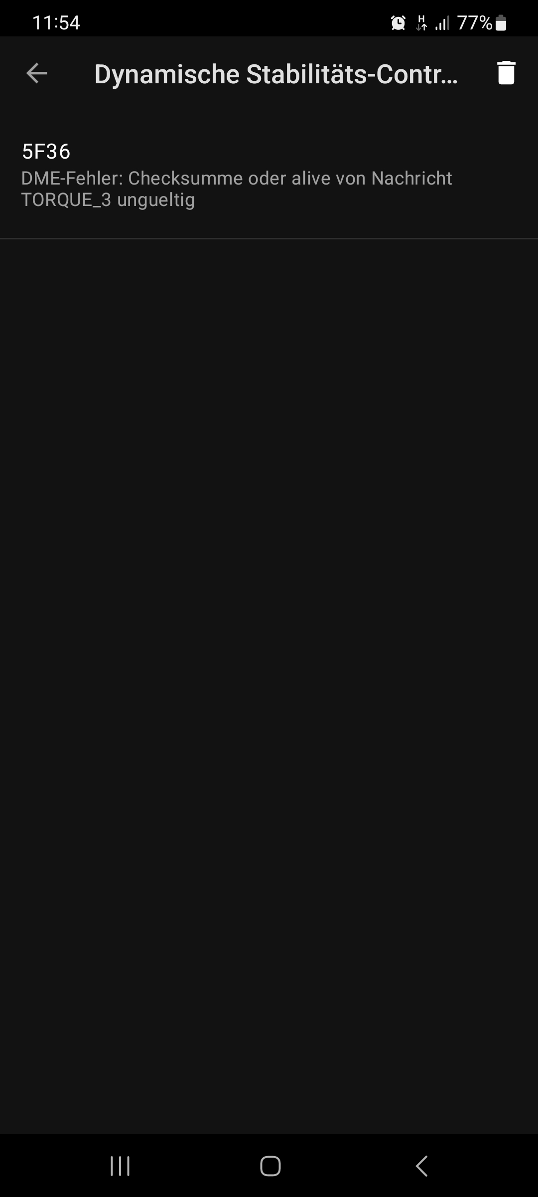

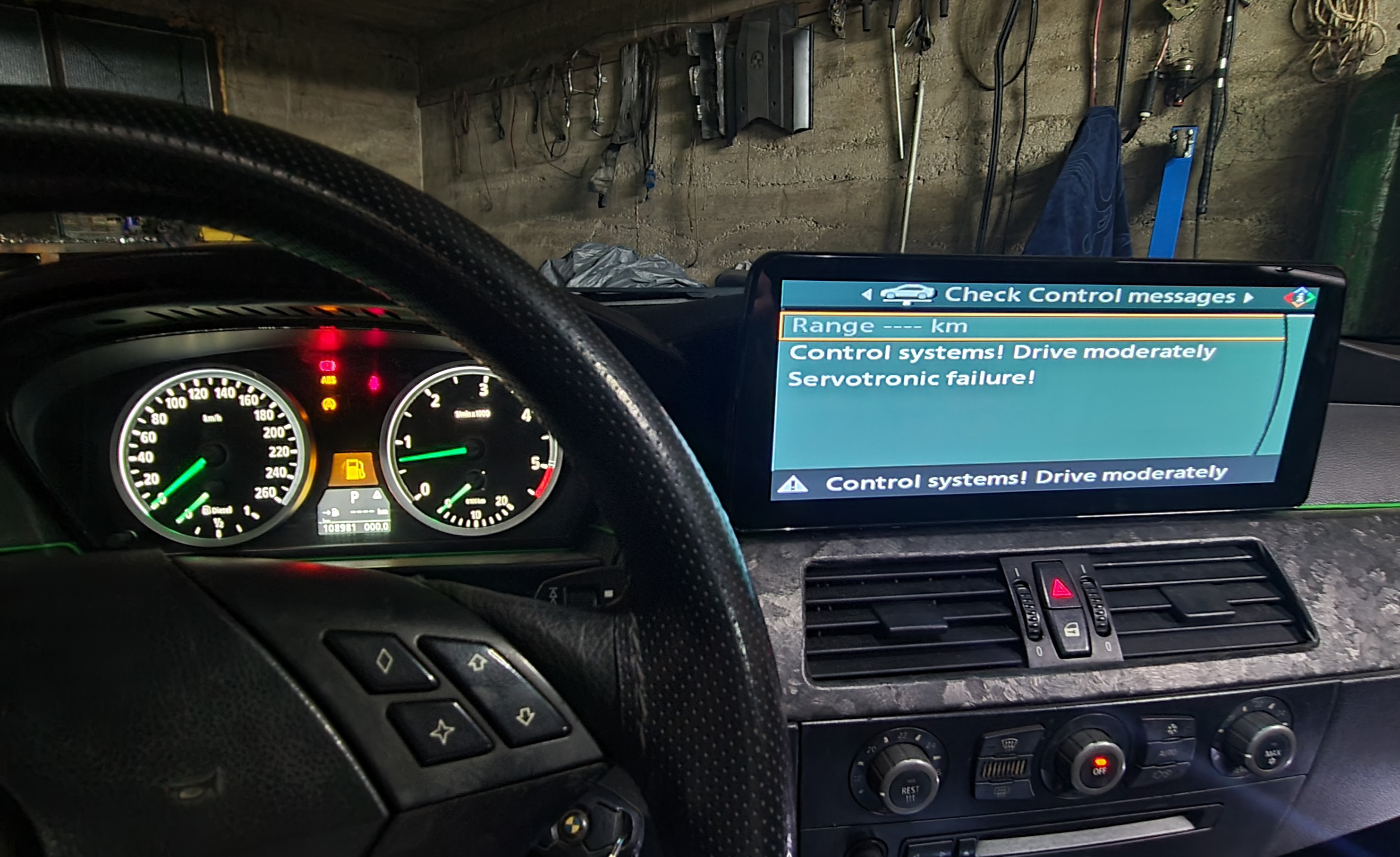

Hello everyone,
I have installed the zombieverter in my E60, but there are problems with the ABS, DSC, an error is also triggered, it reports that there is a fault in the servotronic, but the car does not have a servotronic installed, if I start the car without the VCU, then the error goes away, could it be due to the E65 configuration??

Re: Zombieverter, E65 vs E60
Did you take CAN logs before taking out the engine?
What version of the Zombie Software are you on? Which vehicle did you select?
We need more data to figure out what your car wants to see.

Well, there is news, you have to connect the 2 CAN cables on the DME connector to each other, but it doesn't say anywhere that you have to do it that way.
Now we also have the ABS in the CAN bus system, but I still get an error message, could that be due to the E65 message??

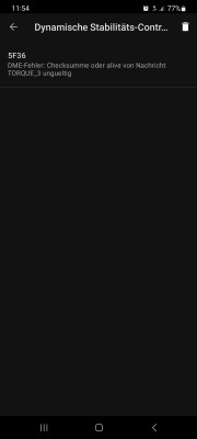

Thats upto you to figure out, it is impossible to document each car. Torque 3 is message: 0xAA

So there maybe a possibility it is upset due the lack of a counter in the message 0xAA. You are capable of compiling Damiens STM32_VCU repo right? Then I can provide you something to try to add this in.

medo wrote: Tue Aug 20, 2024 6:01 pm Yes, i can compile
Dm'ed you update to the BMW E65/E9x coding to try
medo
Posts: 207
Joined: Thu Dec 07, 2023 9:32 pm
Location: Kosova
Has thanked: 21 times

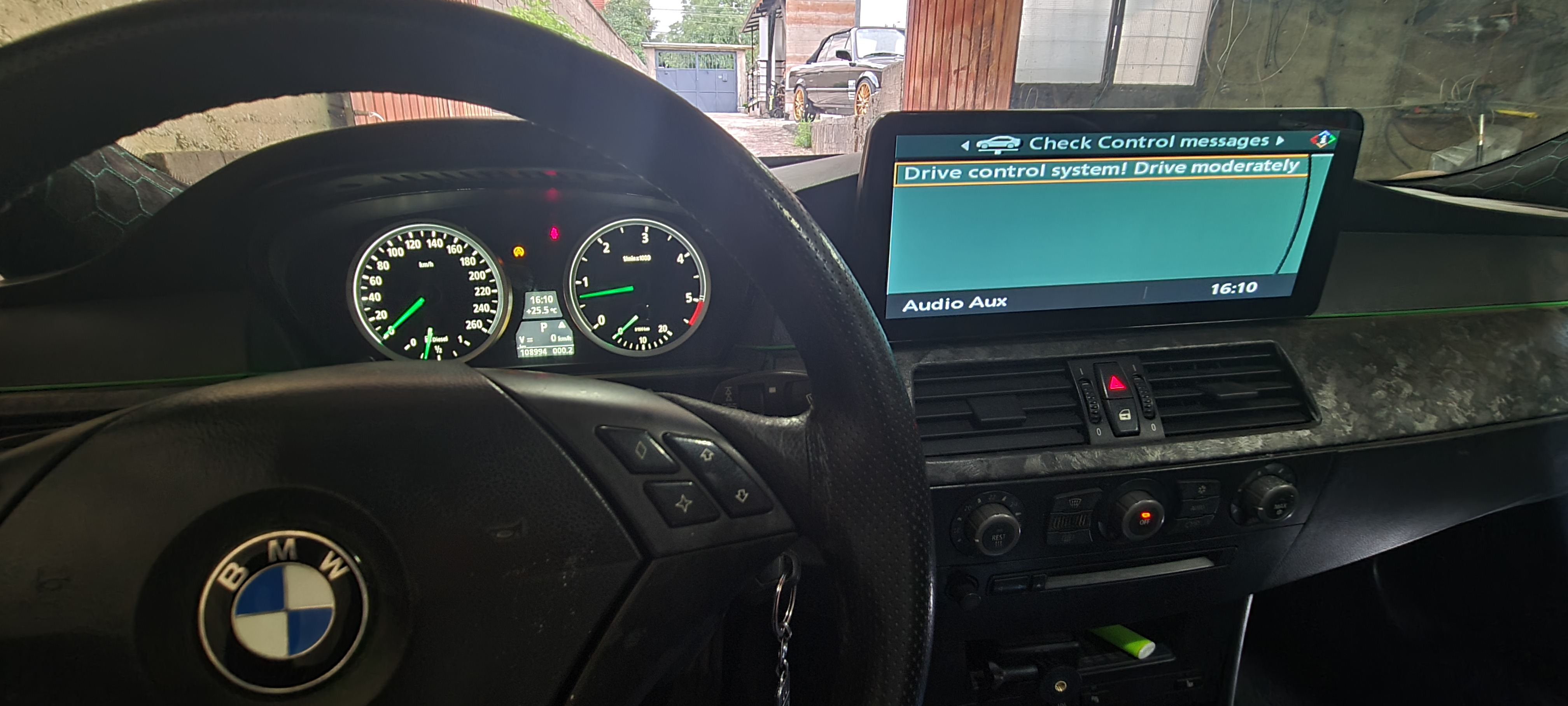

Post by medo »
that Works, Many Thanks

I'll test it tomorrow while driving, there was another error when I brake at about 20kmh, a strange error that I've never seen before, something to do with OBS, I'll report tomorrow
