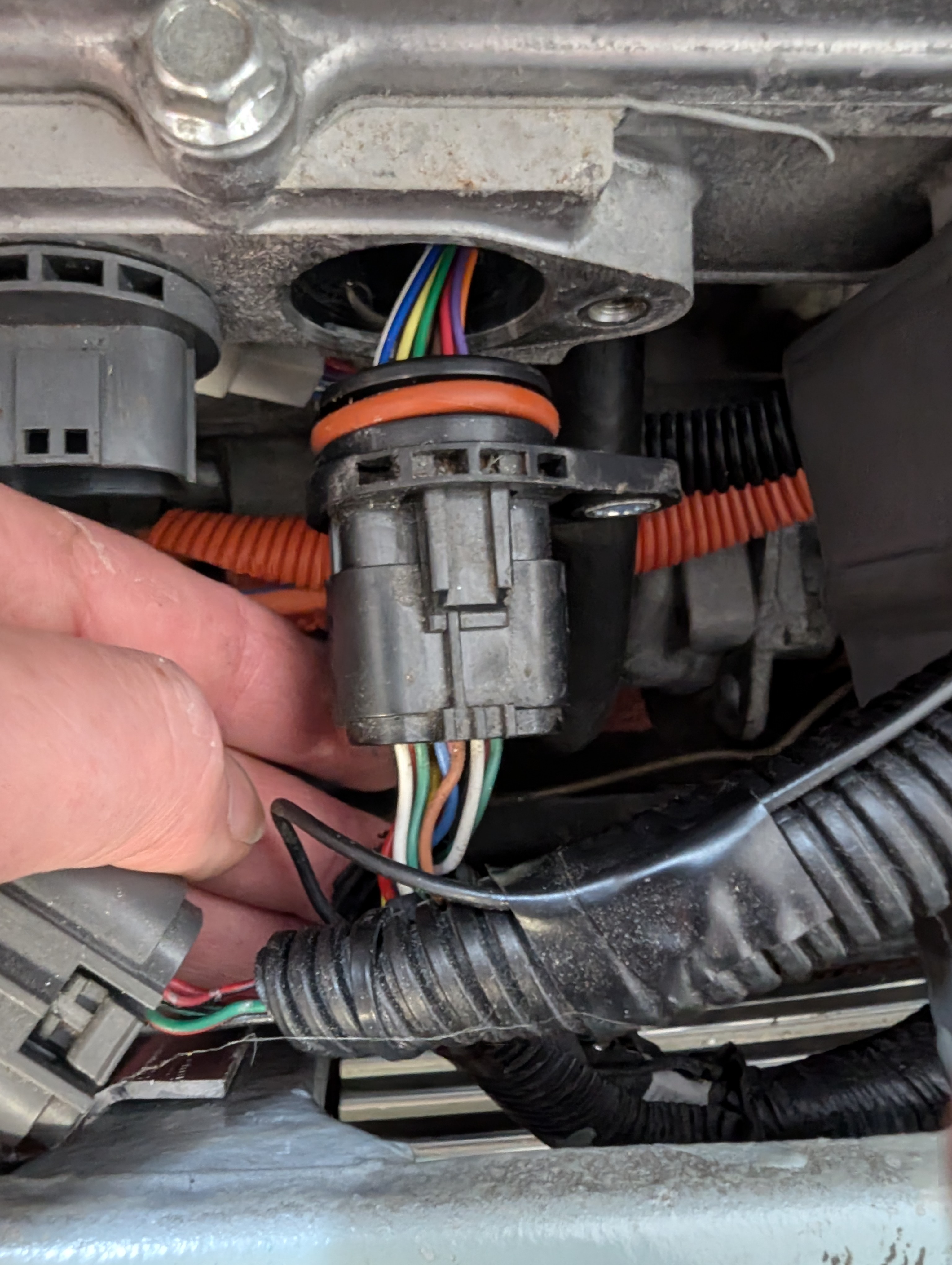

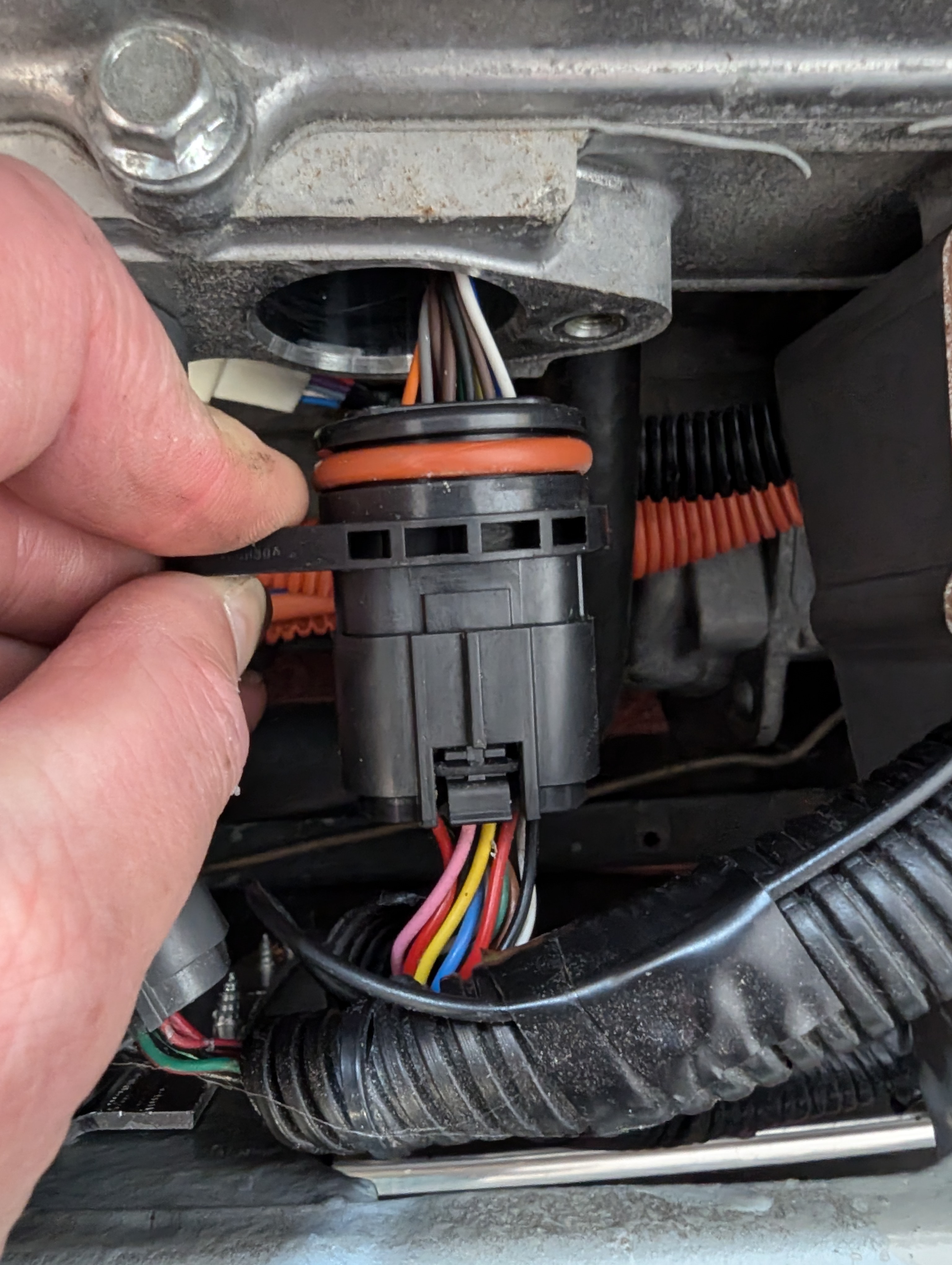

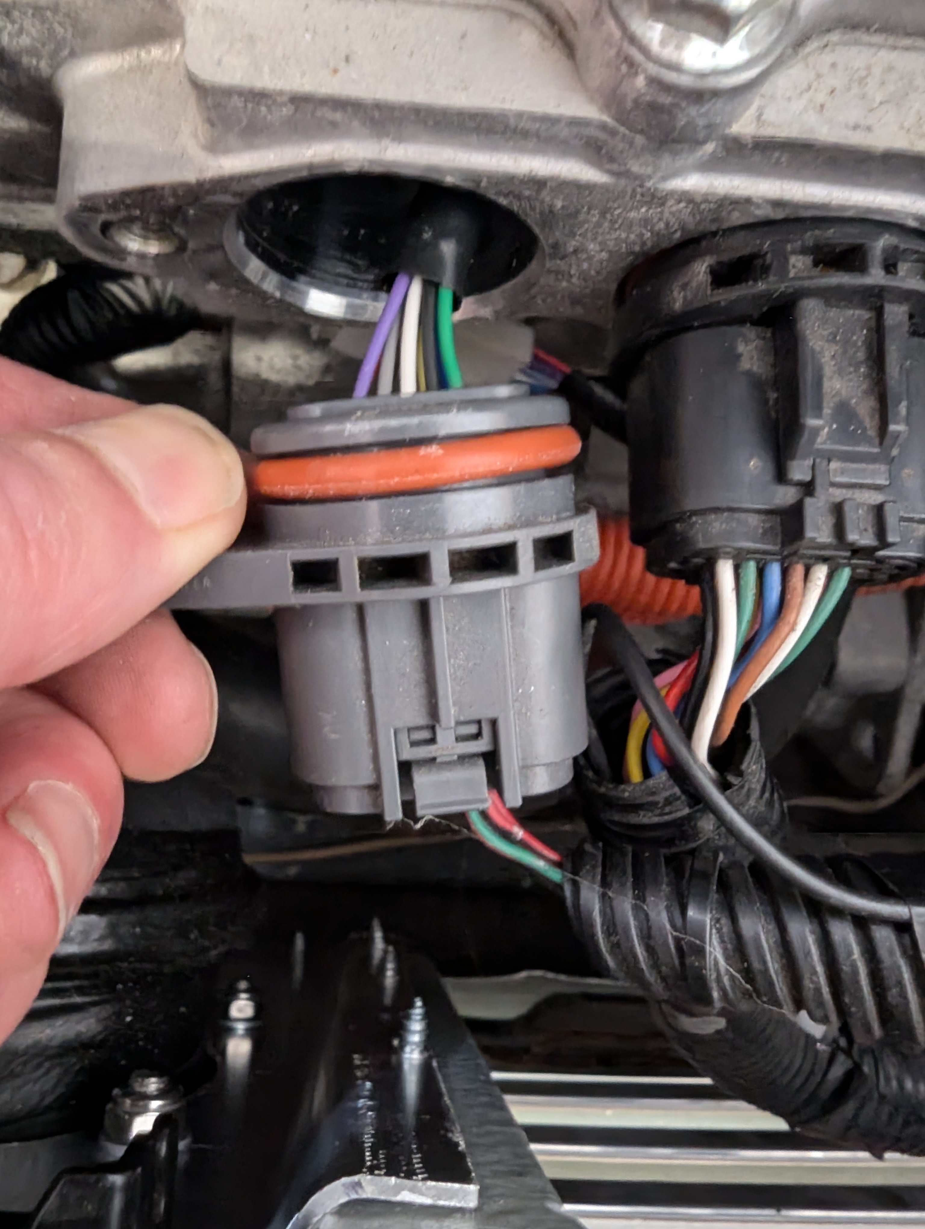

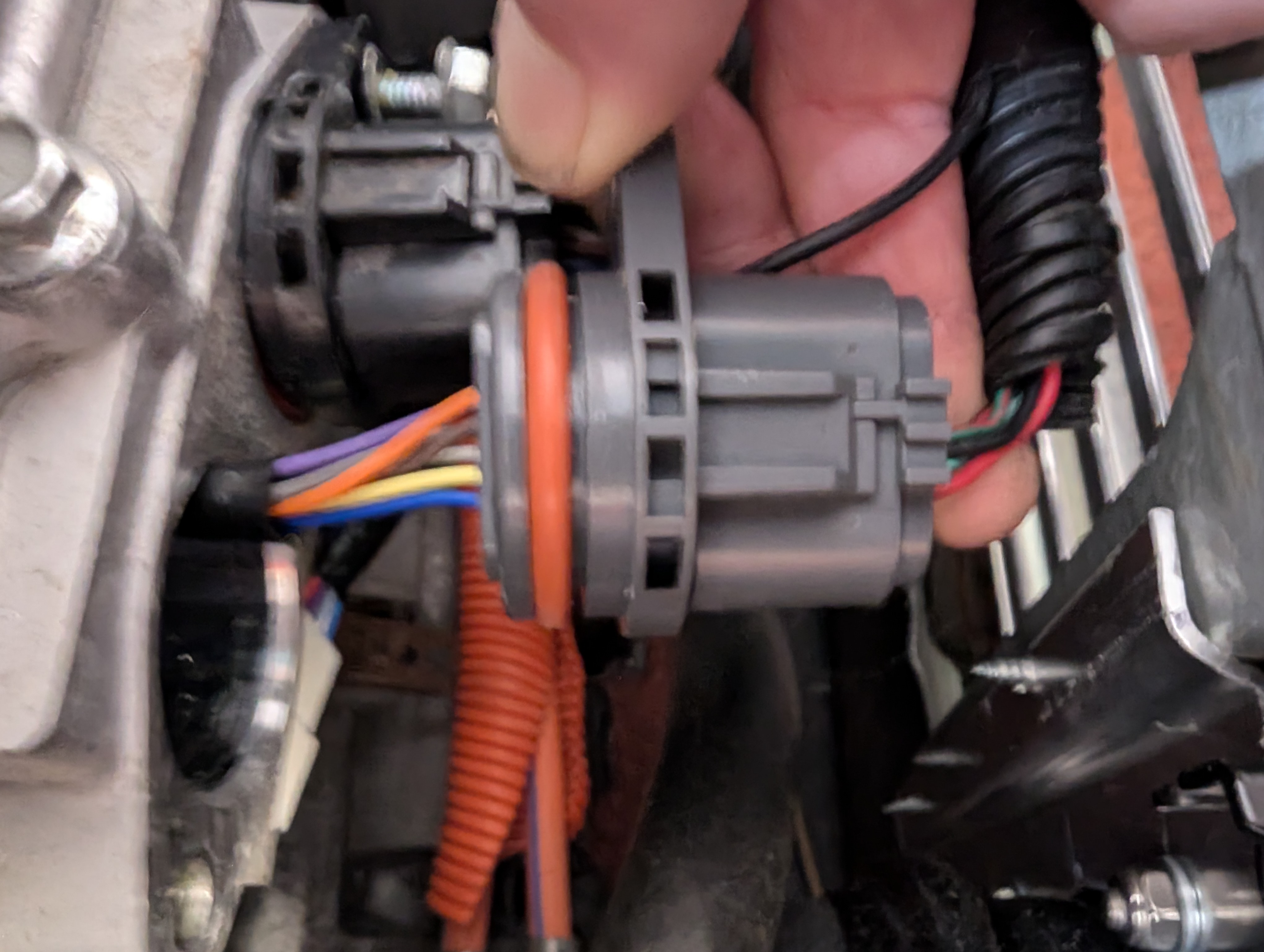

Here is the power and CAN connector from my inverter:
Outlander Rear Inverter
Pin Number		Loom Side`	Inverter Side	Payload
6			GREEN/RED	Black		CAN L
5			RED/BLACK	Green		CAN H
12			LG/B		Yellow		RSDN
4			BLACK		White		GND
13			RED		Blue		IGN POWER
Images of the power and resolver connectors which may be of use..
