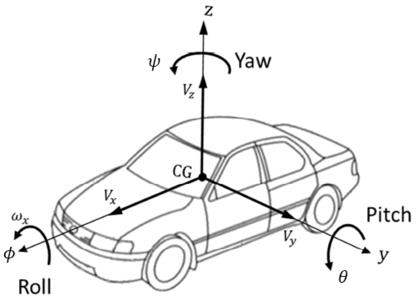

As for origin, if you are doing automotive cad look up ISO 8855 and SAE J670e, I use iso 8855.
This way it's oriented properly for say suspension analysis but check the tool you plan to use for which method(s) it's compatible with.
