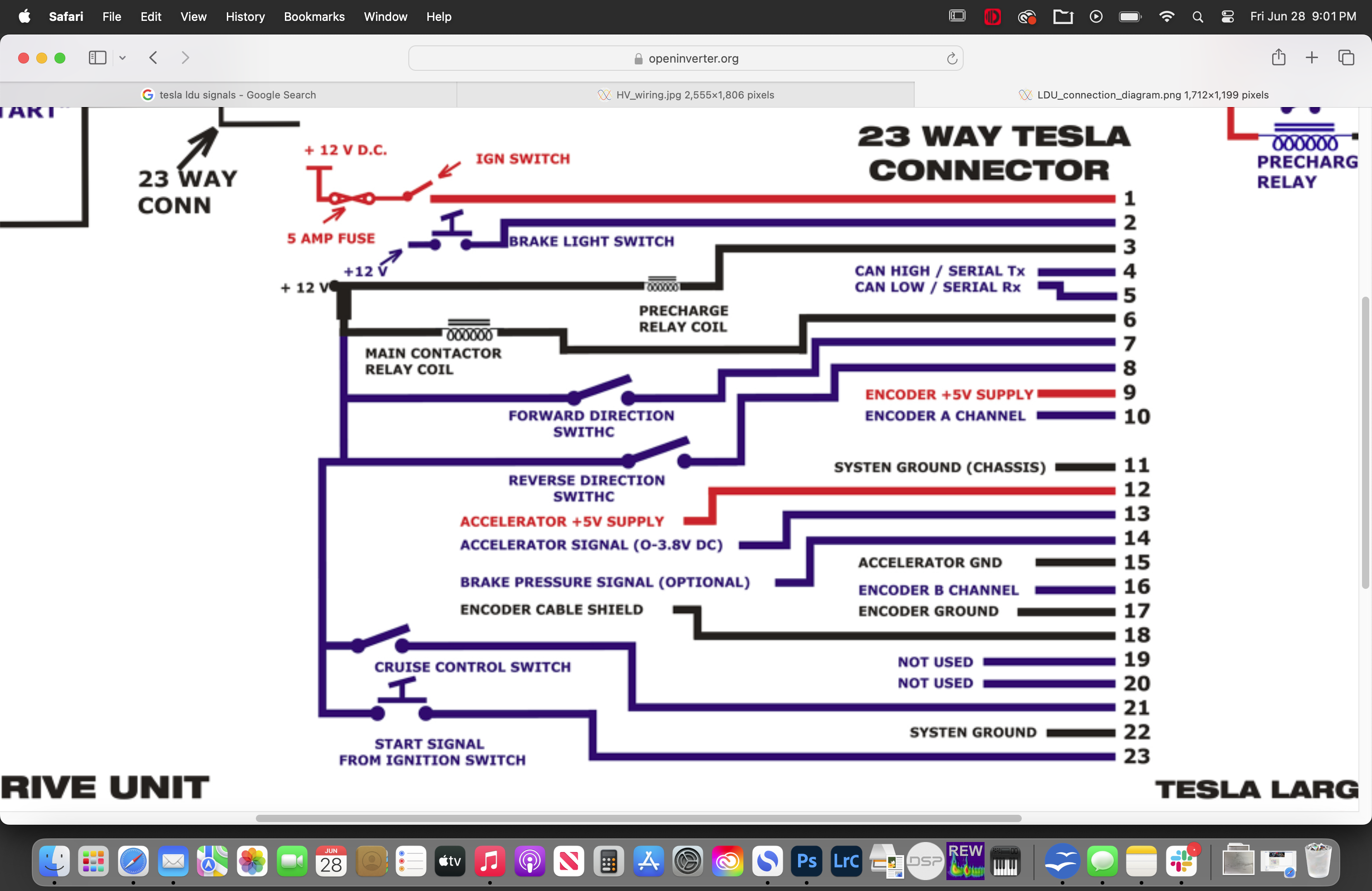

I'm just getting started with my project (Tesla SDU/openinverter board in a Fiat X19). I just received my motor and was hoping someone could point me in the direction of a wiring diagram similar to the one for the LDU on the wiki page here (shown below). I would like to make sure I am wiring up correctly for a LV test. I am not very knowledgeable about advanced electronics and can't read the diagram for the SDU on the page here. Thanks for any help!

Nice! Thank you so much!
