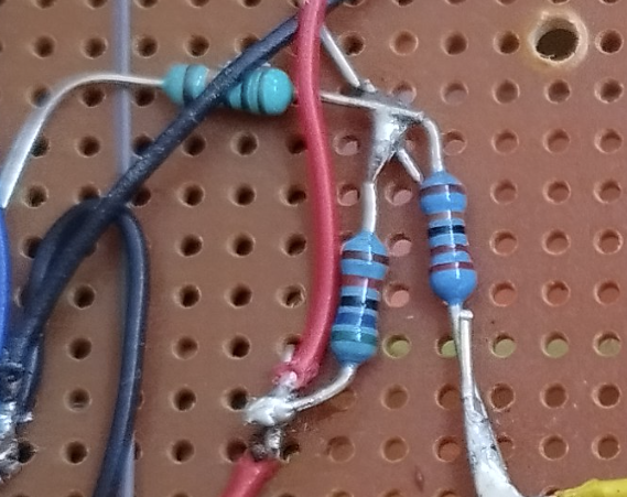

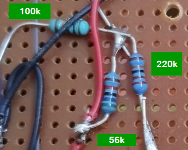

voltage divider
- 56kohm to 5V.
- 100kohm to ground.
- 220kohm to CP.
(The original schematic has 200kohm for R7, this would need a small adaption in the scaling factor and offset in the software.)

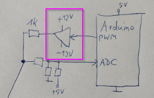

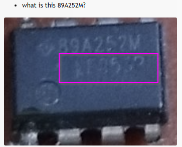

amplifier
is a LF353
The pin 2 of the opamp gets 2.5V from R8 and R9, 120kOhm each, between 5V and ground. (originally the R8 and R9 have 100k, but this does not make a difference)
The output of the amplifier goes via an 1k (R1 in the original schematic) to the CP.

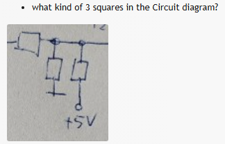

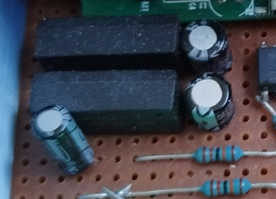

Hello, I have some question about this project.
  • what kind of cable that connect to PEV ? 3D printed module that plug into PEV charging port
  • what kind of capacitance you used in this project?
  • what kind of resistor in the picture?
  • what kind of this poti is?

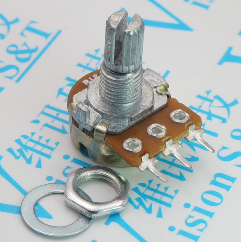

Is this one correct? WH148 side plug single potentiometer B50K three-pin 50K short handle 15mm horizontal

p477d343 wrote: Thu Jun 27, 2024 10:04 am what kind of cable that connect to PEV ?
This depends on your plans. For experiments, which just need the CP and PE line, any cable can be used. Just two single wires are fine. But in case you intend to run the high voltage and the CP+PE in one cable, you should use a cable which is officially certified for 1000V DC.

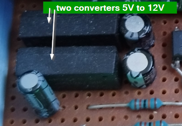

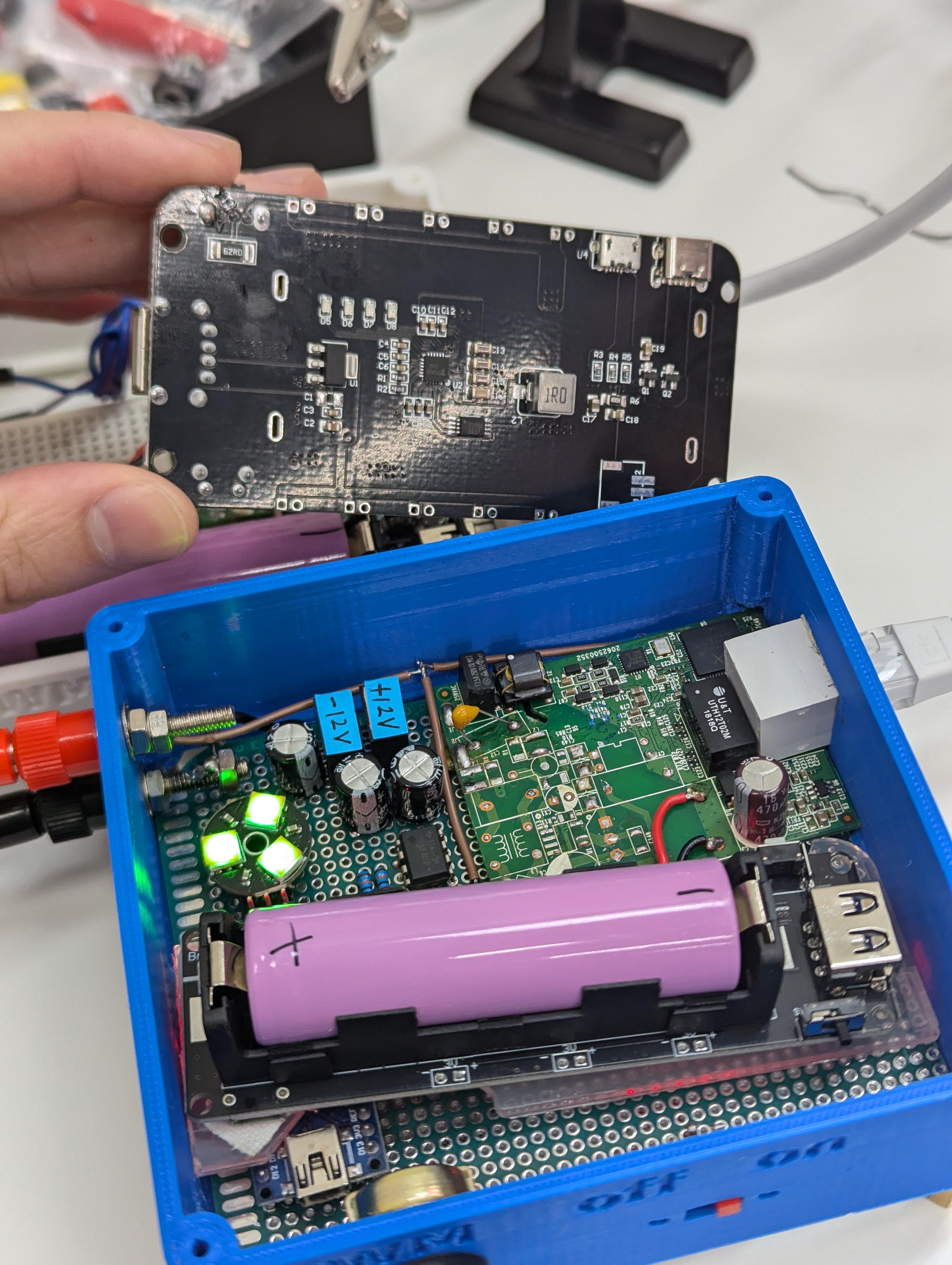

The power supply
5V comes from an USB power bank. The 5V feeds the Arduino, the potentiometer and the WS2812 LEDs directly.
For the amplifier we need +12V and -12V supply. These are created by two isolated DC/DC converters, something like B0512S-1WR3.
To smooth the voltage, there are capacitors on the 5V, 12V and -12V. Something like 100µF.

The Poti (potentiometer)
- is needed to allow the user to adjust the PWM duty cycle.
- gets ground on the "left" pin and 5V on the "right" pin.
- provides the variable voltage to the controller
- a resistance between 1kohm and 100kohm is fine.
- a linear characteristic is recommended (not logarithmic)
- physical size does not matter

Just another "me too" report, that I was able to communicate with a Tesla Model 3 2019 (Europe) via pyPLC.
My biggest hurdle was to get a proper 5% PWM signal on CP. Long story short, after I finally got my hands on an oscilloscope, it was clear that the opamp that I was using did not behave at all as specified; the slew rate was pretty terrible. After getting an authentic LF353 from Texas Instruments, the car happily communicates :-) So moral of the story relevant for this thread, don't buy a LF353 pack of 10 from Aliexpress :|
I'm using a slightly different variant of TPlink TL-PA4010P, it says v2.3. Thanks to previous posts in the AR7420 thread I was able to identify the correct pins (already contributed to the repository, see https://github.com/uhi22/pyPLC/blob/mas ... a4010p-v23 ).
Thanks for spreading all that knowledge!
