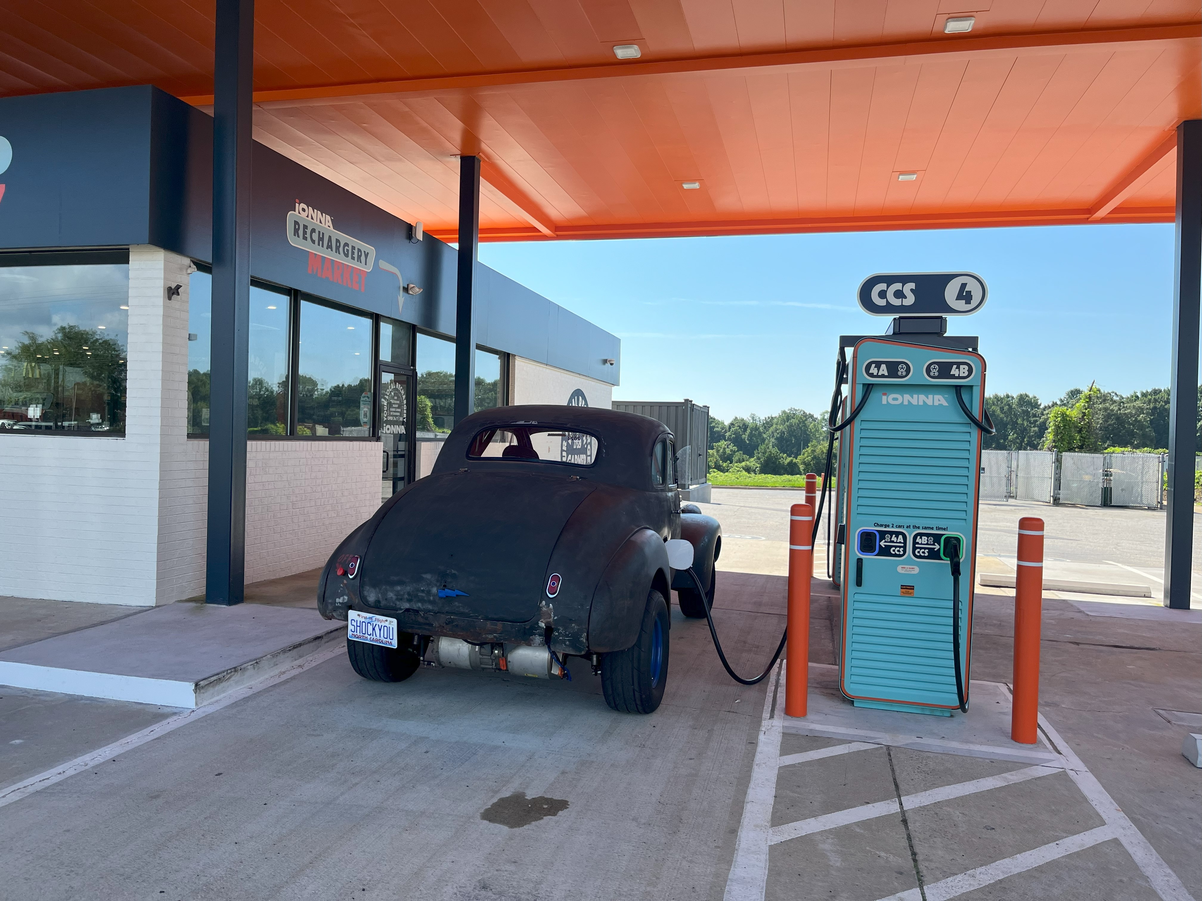

Posted: Sun Aug 17, 2025 11:34 pm
by P.S.Mangelsdorf
I finally had a chance to take the '40 to a brand new charging station that's only a few miles from me. This is from the new "Ionna" network, which is funded by a bunch of the major OEMs. They have a FANTASTIC concept, which is building out the EV equivalent of a gas station, primarily by buying rundown gas stations and converting them. So the stations are covered, well lit, with a lounge, bathrooms, and snacks (all accessed via QR code). They have CCS stations on one side of the building, NACS on the other.
The '40 charged flawlessly using FOCCCI.
