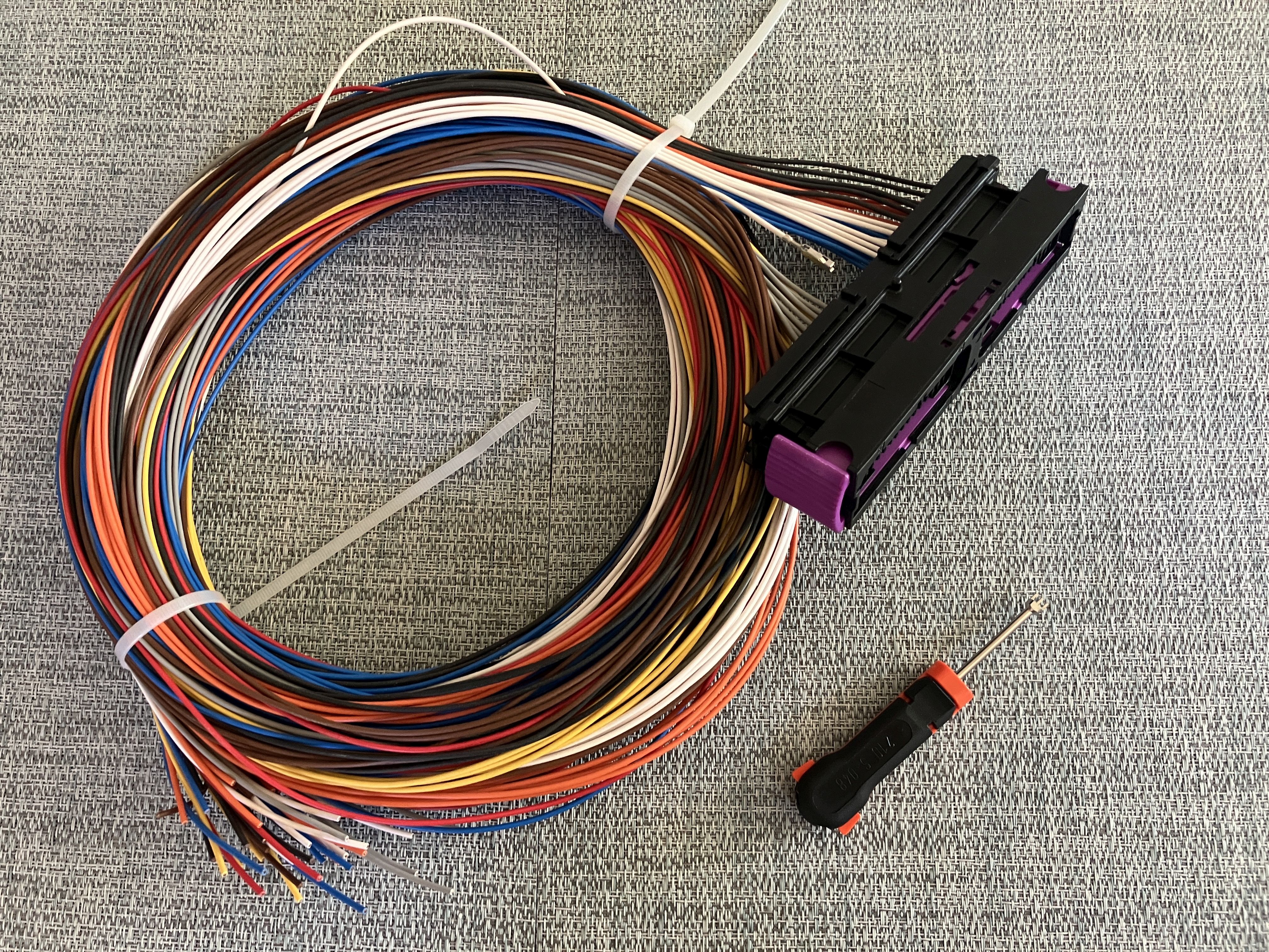

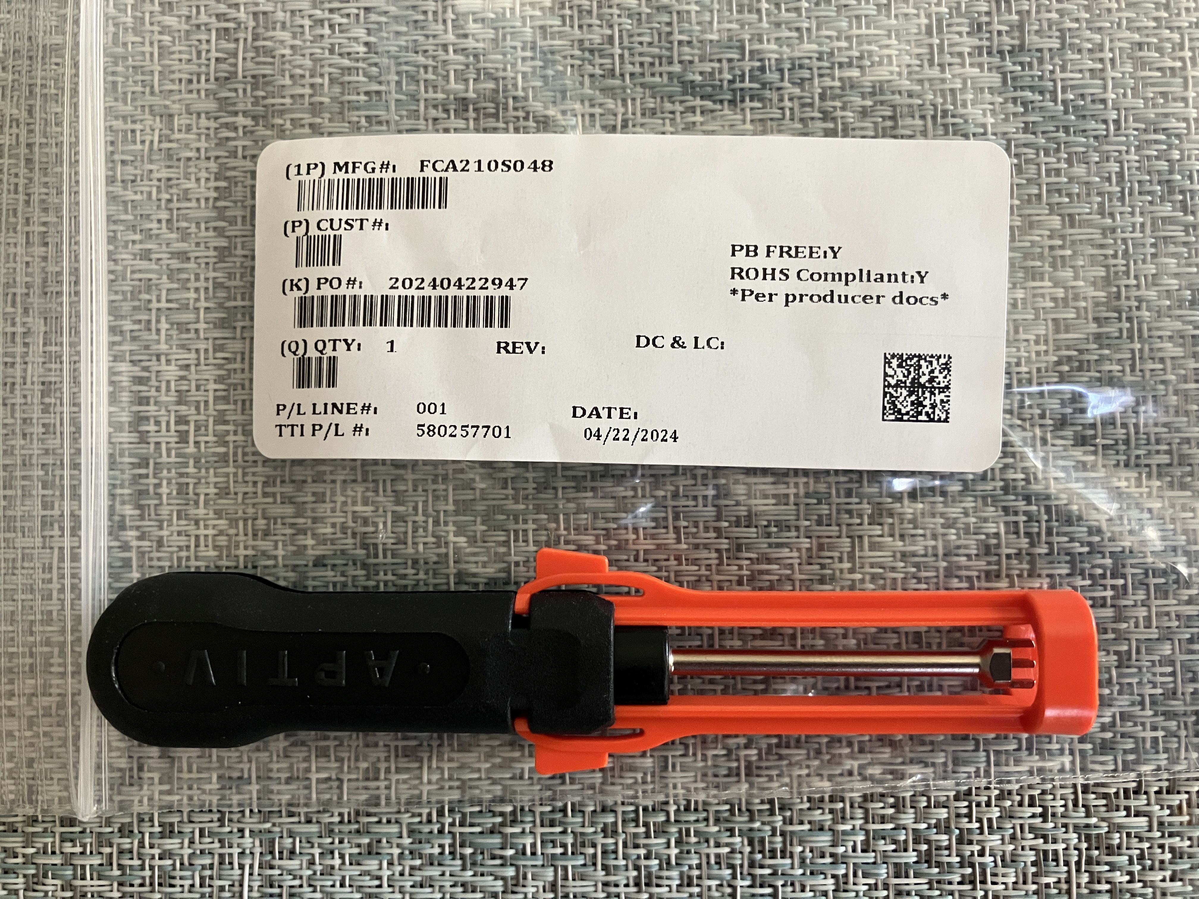

not sure where this belongs so dropping it here, hope it helps somebody out
REMOVAL TOOL FOR FEMALE TERMINALS
Manufacturer: Aptiv (formerly Delphi)
TTI Part Number: 210S048
Mfr Part Number: 210S048
Price: $65
Price: $65

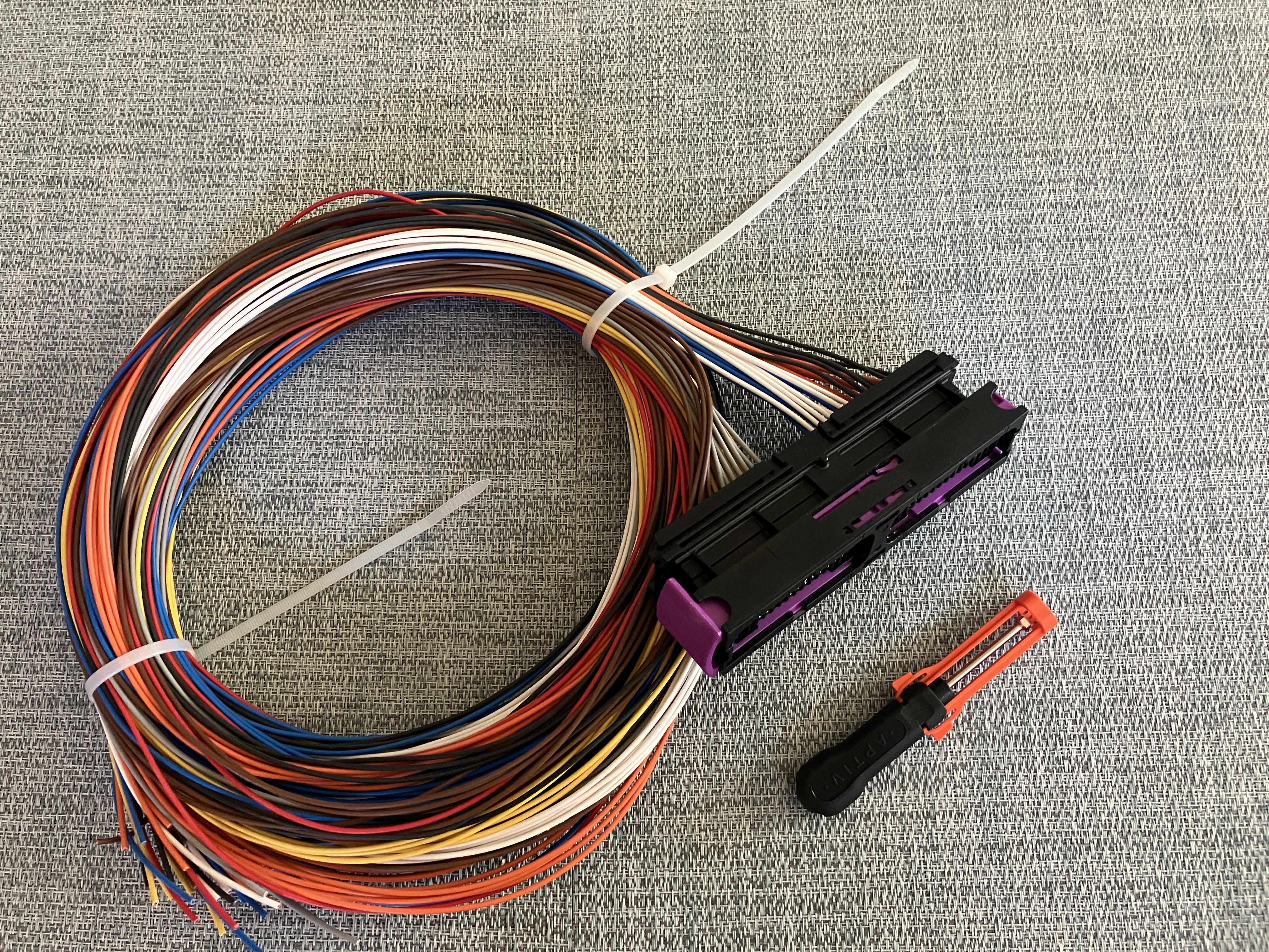

Re: ZombieVerter VCU Connector Depinning Tool
used for depinning this type of harness from AliExpress
the orange thing appears to be just a shield to either prevent the tool from getting damaged or you from getting cut, maybe

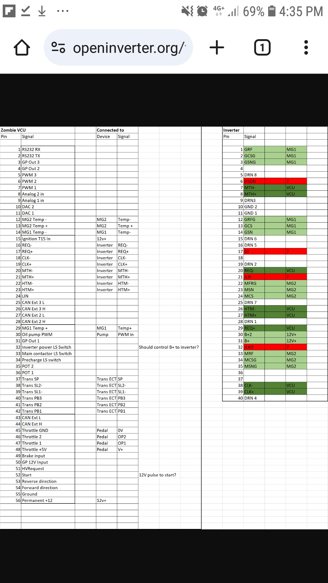

On a related track, pinout for the Zombie board, Mth, Htm, Req, and Clk etc. For use with Prius Nvw30 inverter,
Can you point me as where to locate this please.?
Thanks.
Thanks.

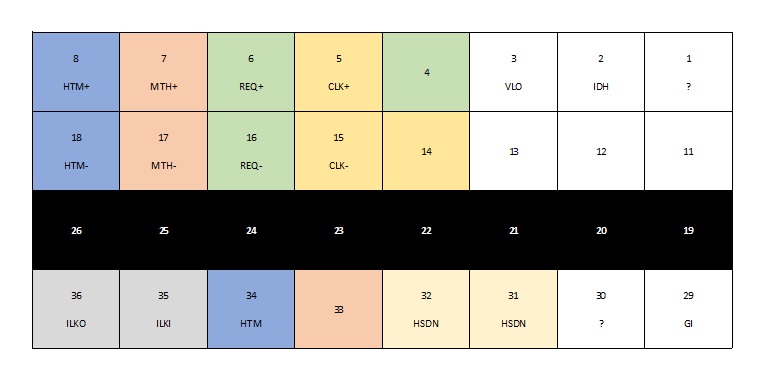

Woodfie wrote: ↑Fri May 10, 2024 4:11 am Thanks for info, have been removing some with less sophisticated jewelers screwdriver method.
Thanks.
it will be my next video, in the meantime please see if this thread can help
Prius Gen 3 Inverter Connector Pin Out Dumbed Down
Thanks for the link, Ots the Zombie pins am presently searching for..
Your videos are very helpful thanks, look forward to it..
Had figured there must be a diagram about, my limited searching ability has found this on an old post for gs450h,

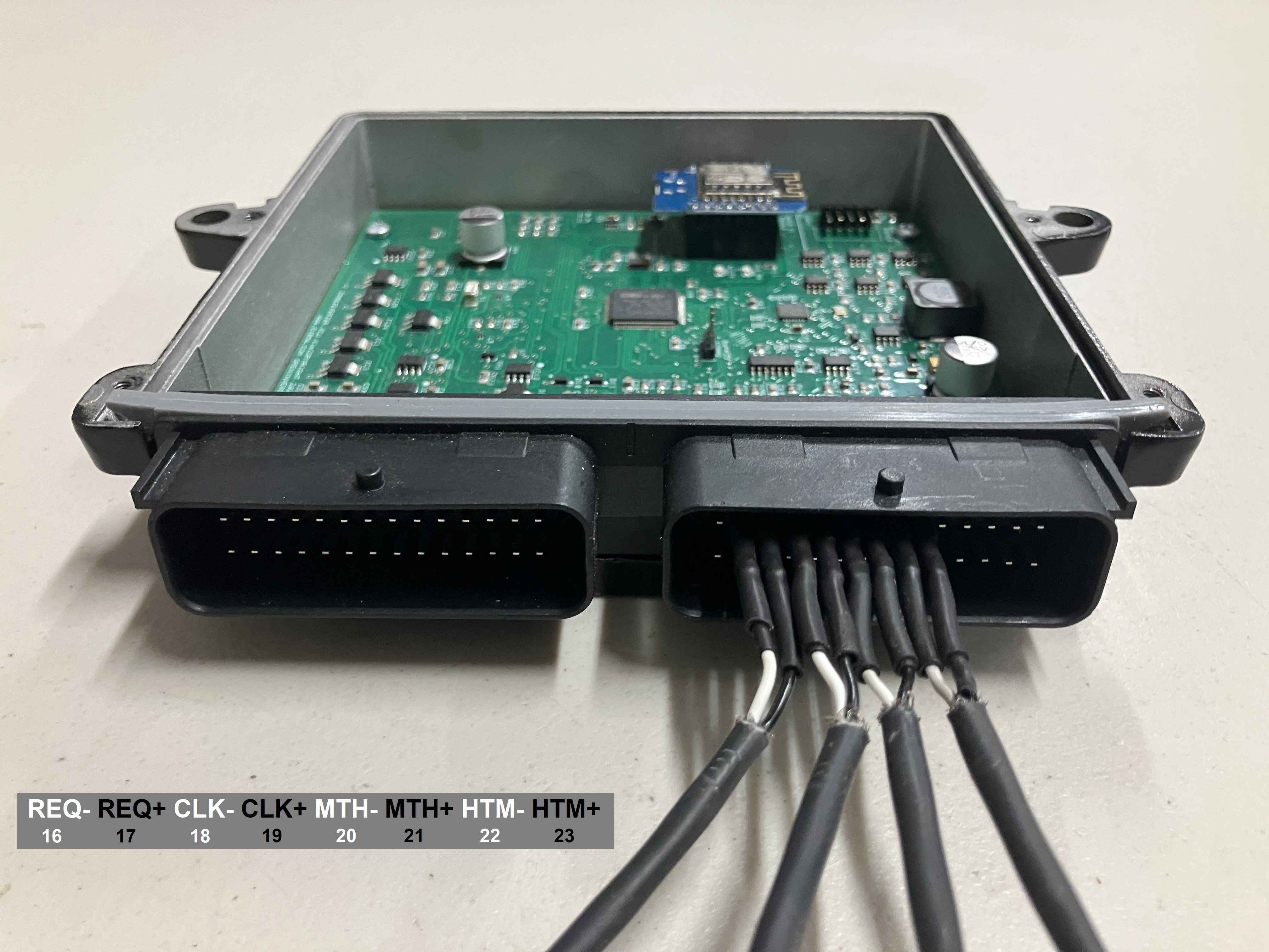

that looks similar to what's on the Wiki https://openinverter.org/wiki/ZombieVerter_VCU#Installation
all you need is the four pairs of wires from the Inverter to the Zombie, there are four sets of three wires shown in the diagram below because the third wire from each wire pair loops back to the inverter plug
Best to use the pinout from the wiki as I corrected the can and can2 positions. Older posts on the forum may have this incorrect.

seems like you guys are always a week or so ahead of me with your questions and the videos I am working on, lol, hope you find this video useful
ZombieVerter VCU Prius Inverter Connection
it's going to look like this for both the 3rd Gen Toyota Prius and Lexus GS450h inverters

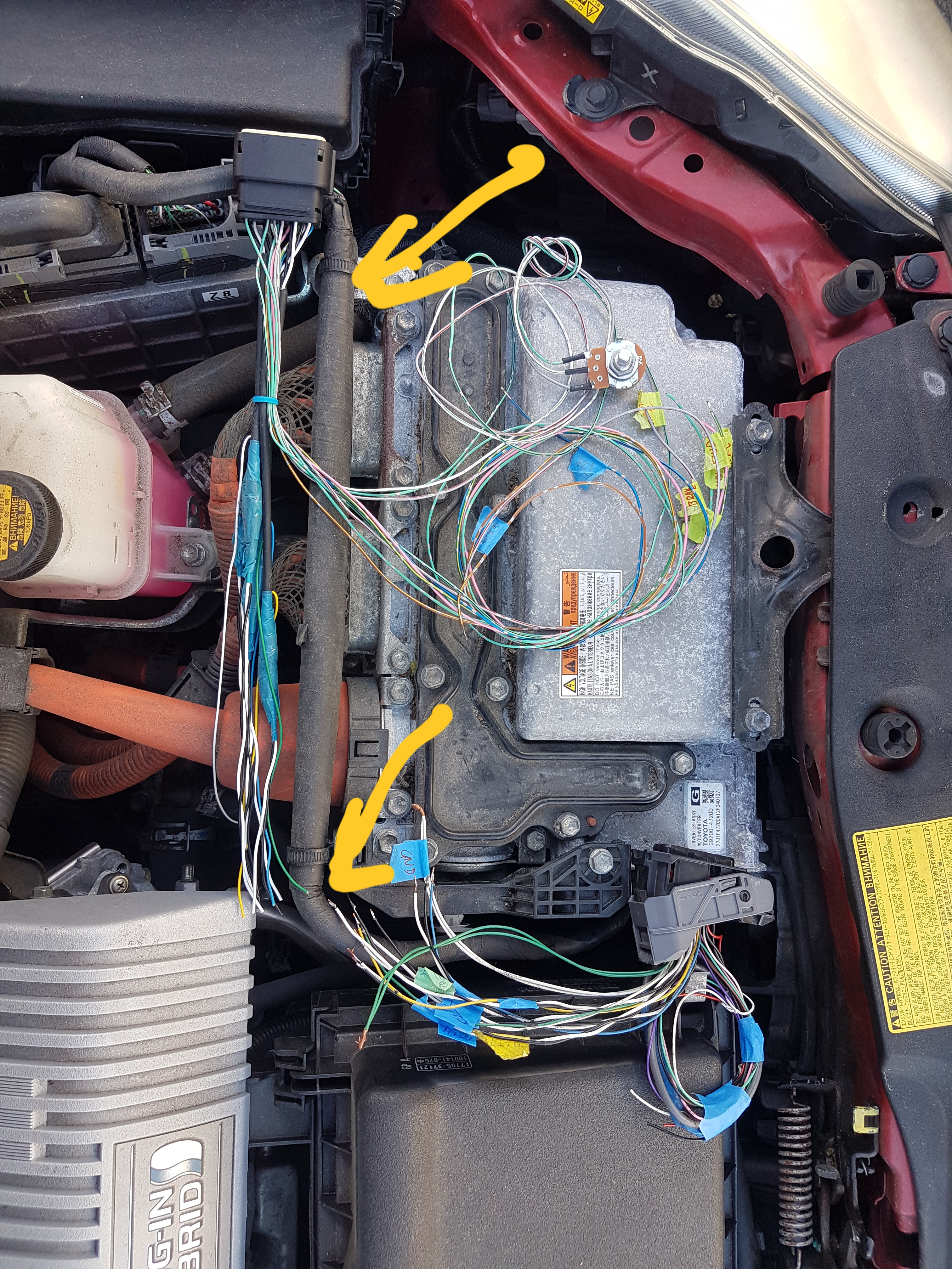

attachment=0]20240519_100543.jpg[/attachment]
Great presentation thanks... helpful to recall the "Unwrapping" of the communication 4 pairs etc.
Had made up a Test Loom some time ago in an attempt to connect the450h vcu to a Prius inverter..
This is being re purposed for Zombie vcu to Prius.
PICTURE is of cut test loom, laid over the mg1 and mg2 phase lines.
Interesting that the staggered joints to the shielded leads that head to the Toyota vcu, are directly over the motor phase wires.. Hence the extra shield that you found over the plastic protection tube..
Did you if find that extra shield, shown between the arrows ,
Question please ...
I think this was a copper wrap , So was connected to ground, or was it just floated..?
I haven't got another original loom to pull apart at present.
Also had yesterday cut the loom in a place, that is requiring remaking of custom screening ..
Oh well can't get it wrong all of the time, BUT do keep trying.
