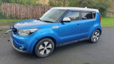

Hi folks.
As part of my Lotus Elite conversion project I had bought a 2014 27kvh Kia Soul ev as a parts donor as it was being sold for parts dud to a catastrophic gearbox failure.

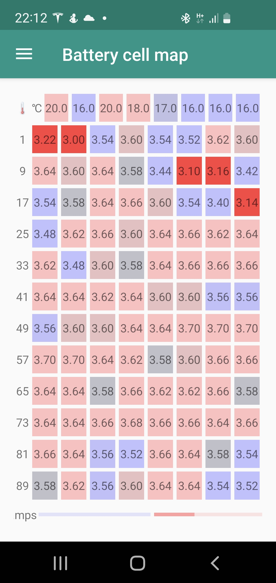

During me research on the kia canbus setup I came across a 2nd hand gearbox at a very reasonable price...........so..... having bought and fitted this the car now drives but the dreaded turtle mode is coming on. .using SoulSpy app I can now see I have 1 very sick cell and several more poor ones!!
My question is, does anyone know where I can source these E375 cells or 1 or 2 complete modules for sale ????
Anyone here got a battery they are breaking?
I'm based in Ireland but can arrange shipping from anywher (preferably within EU).
Thanks in advance for any advise or tips.

SoulSpy screenshot
SoulSpy screenshot
SoulSpy screenshot
SoulSpy screenshot
