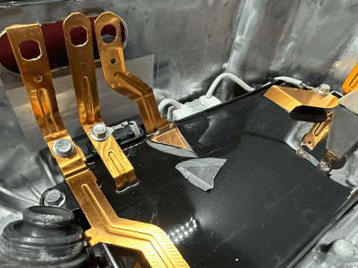

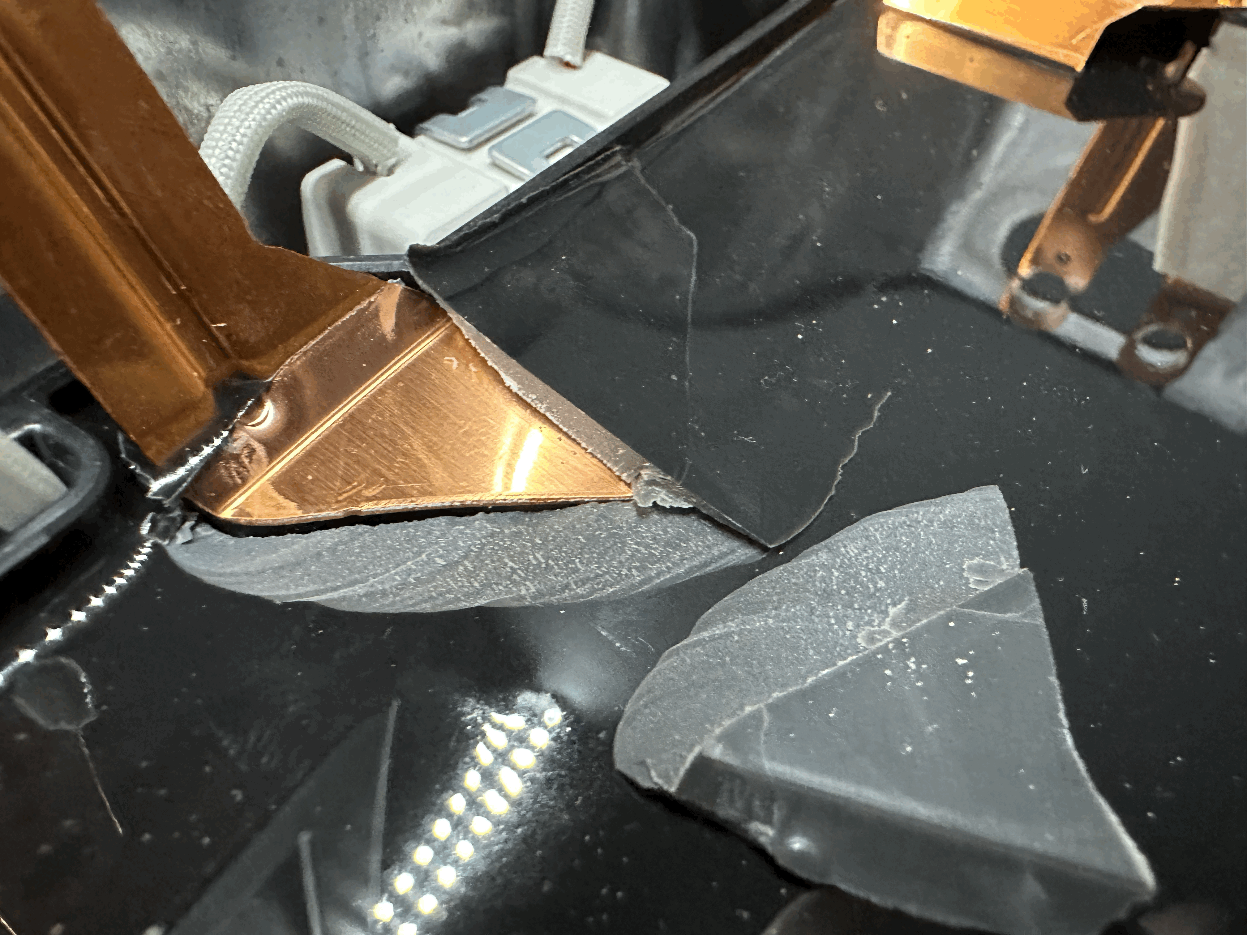

On a scale of 1-10 how much have I cocked up after getting over enthusiastic taking the case off?
It was £18, and 'not working' so can live with it if I've completed borked it.
Not sure if you can see the full damage, will that glue back on? Should I not attempt it?

One further question. The MG1 and MG2 current sense connectors. I've soldered them 'notches out' as per silk screen and wiki, but on the Toyota board they're notches in. So I have to turn the cables around to attach it?

If you're using v1c then current sense connectors need to be soldered opposite to how they are in toyota oem board. You just twist the cables a bit when connecting, no problem there.
