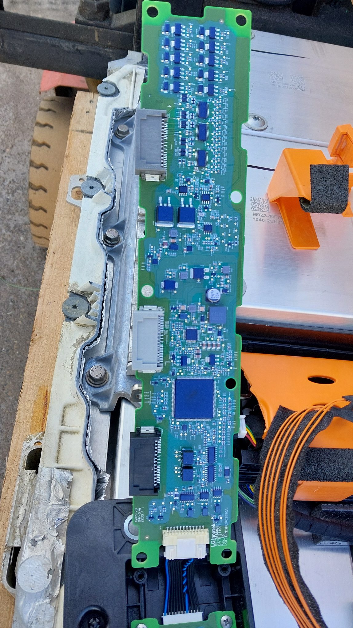

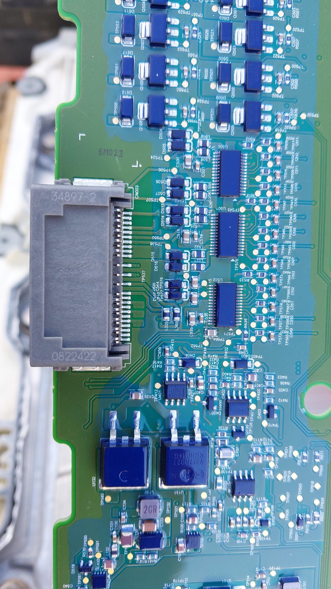

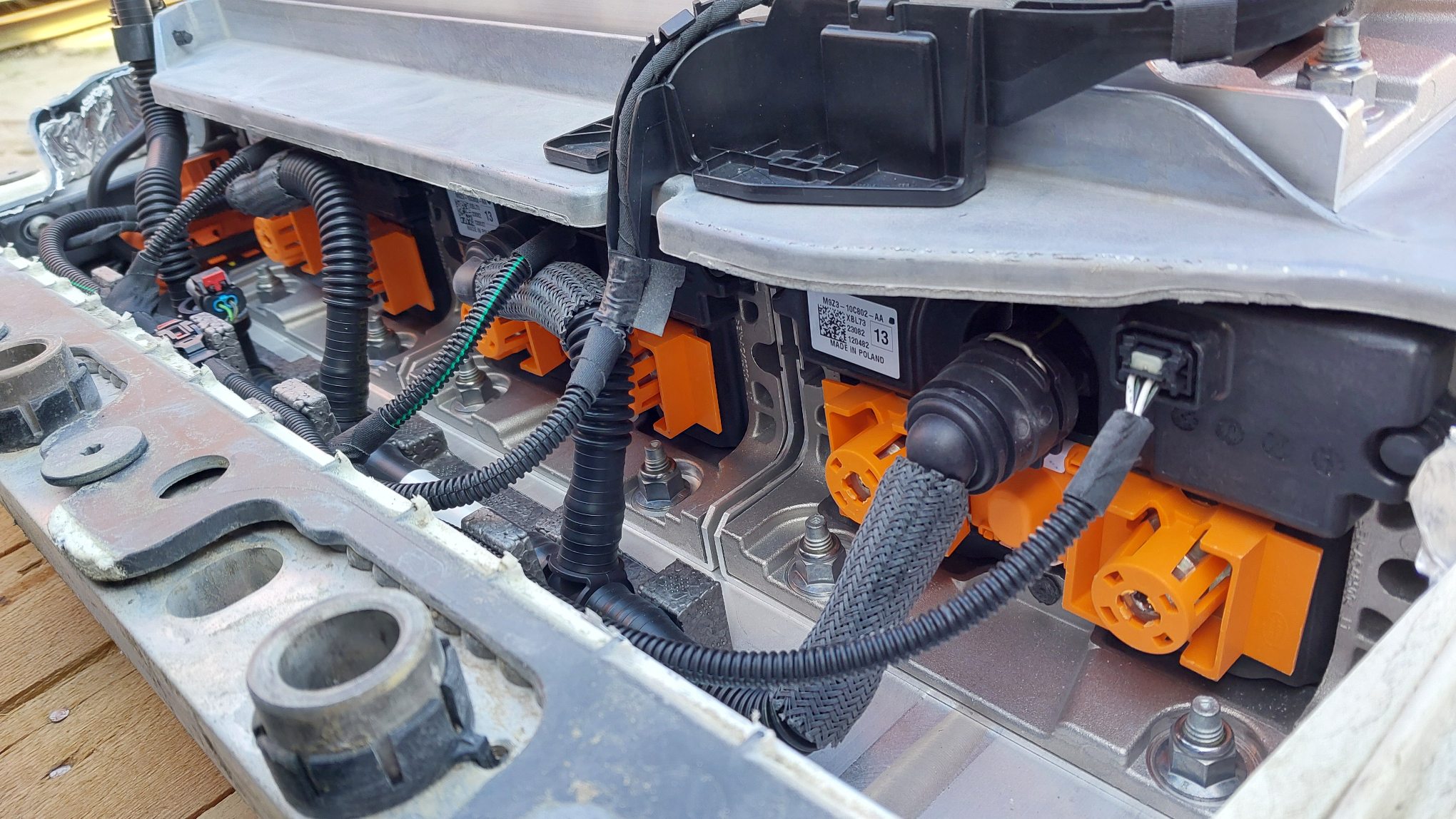

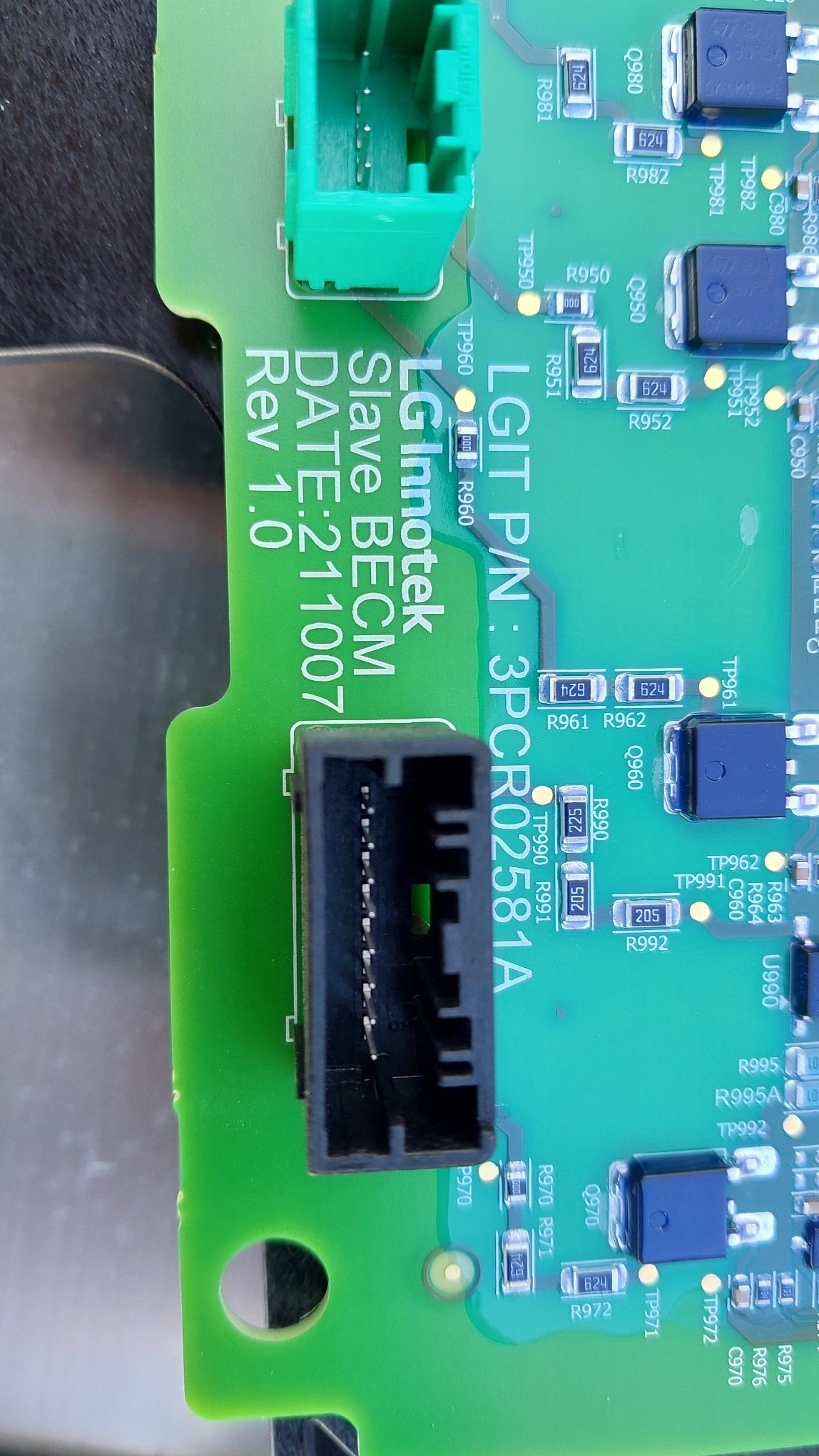

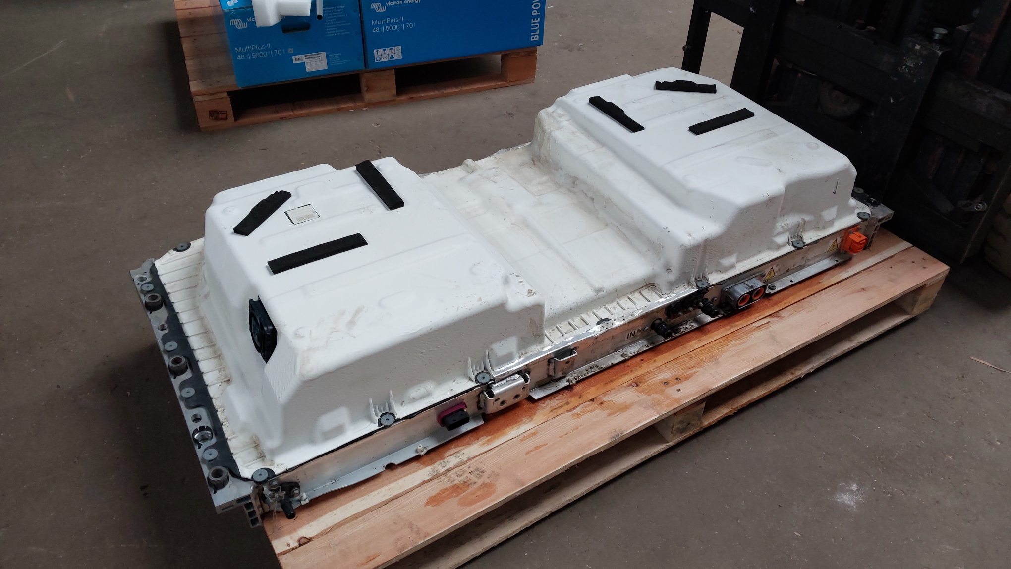

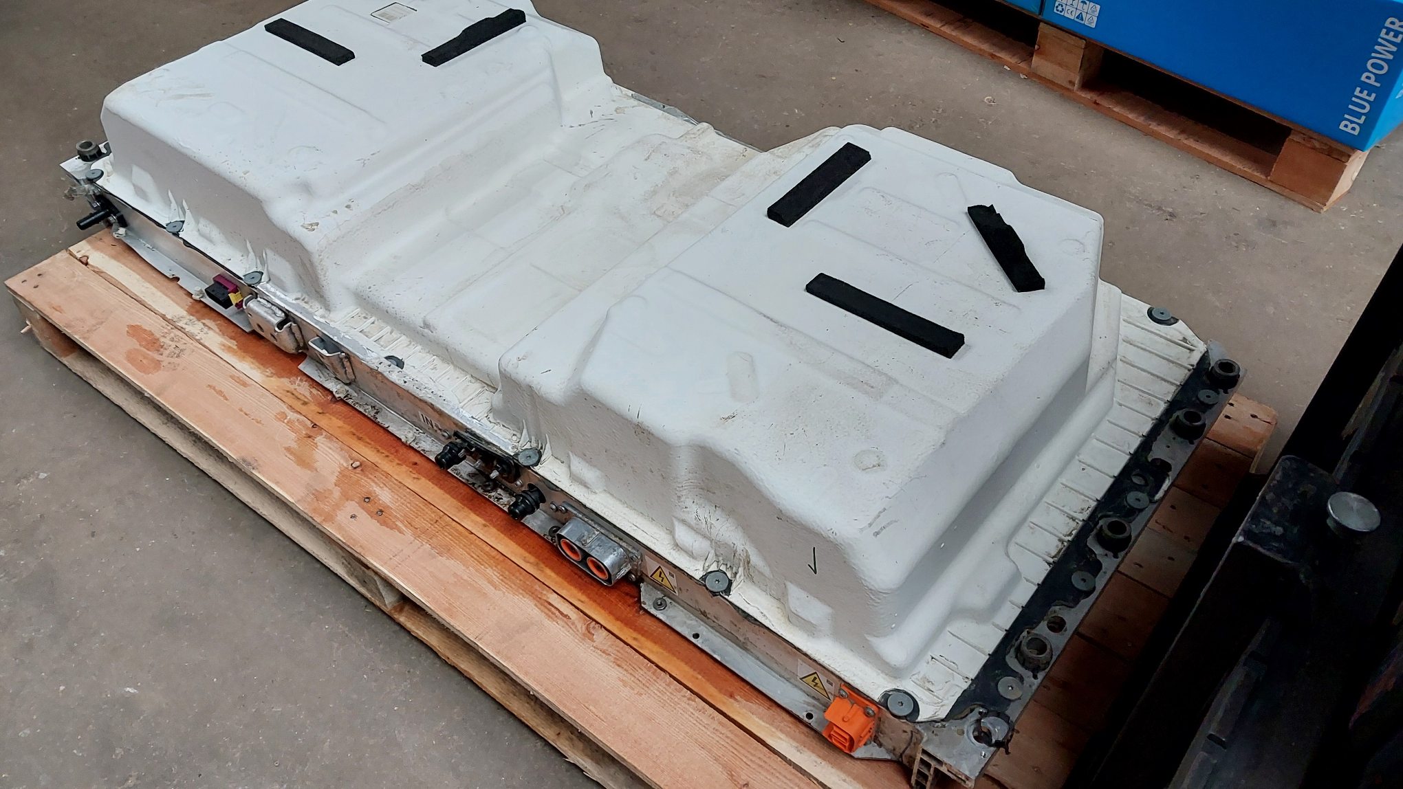

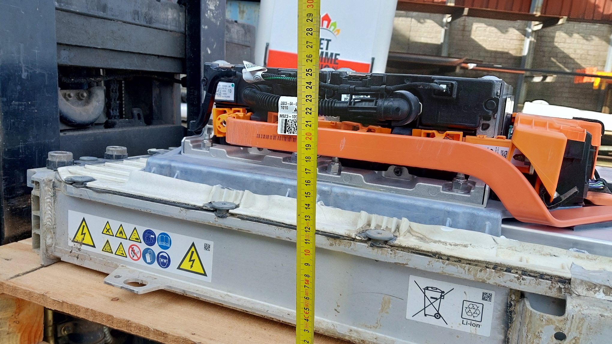

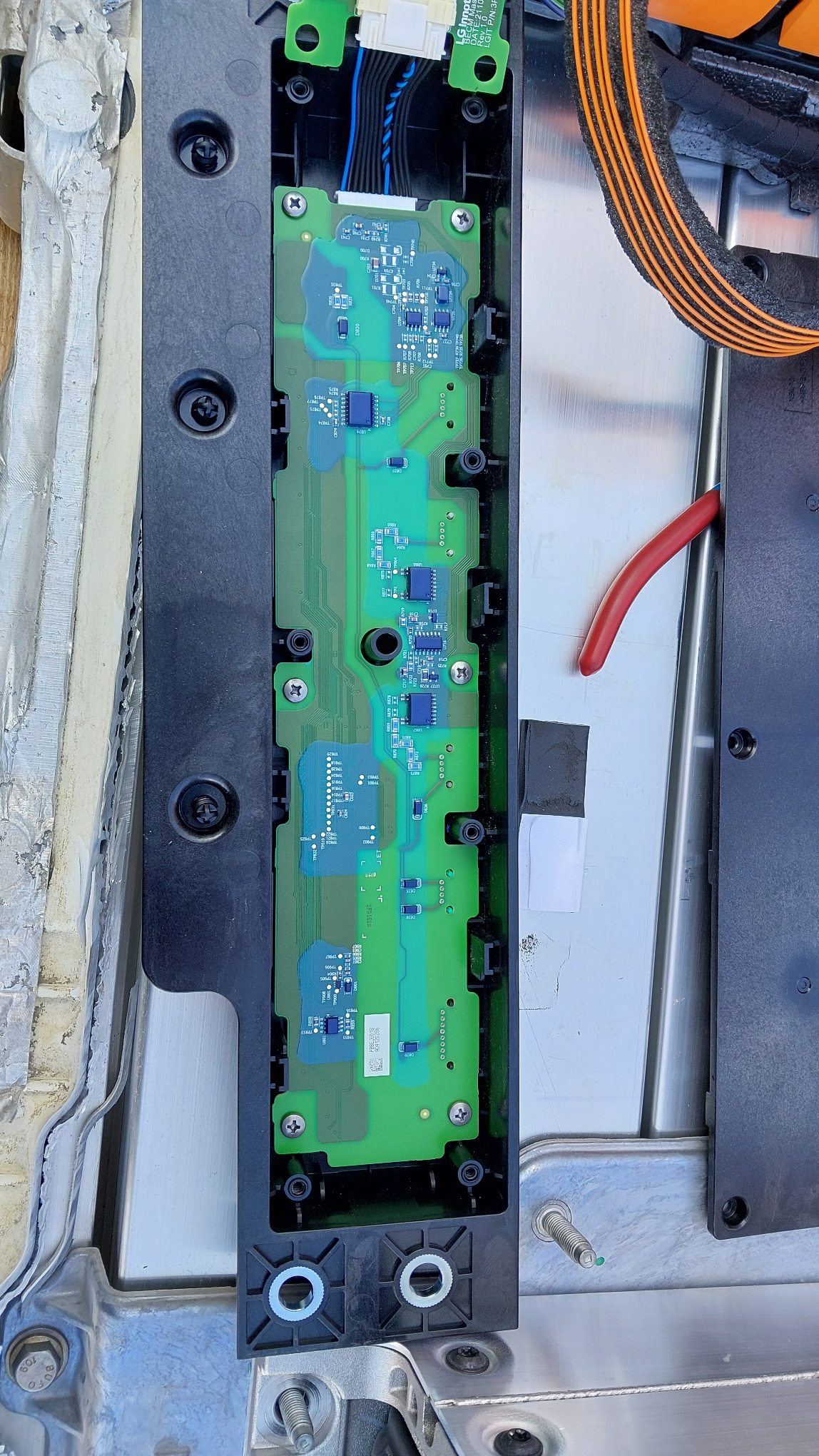

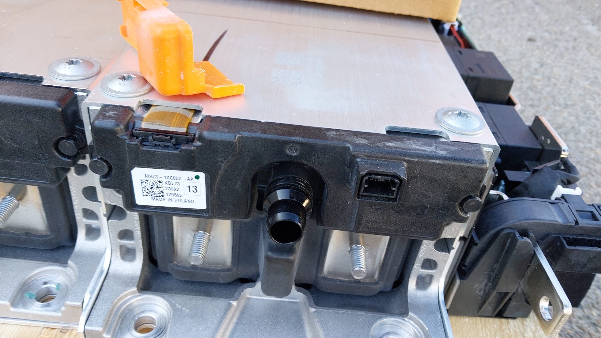

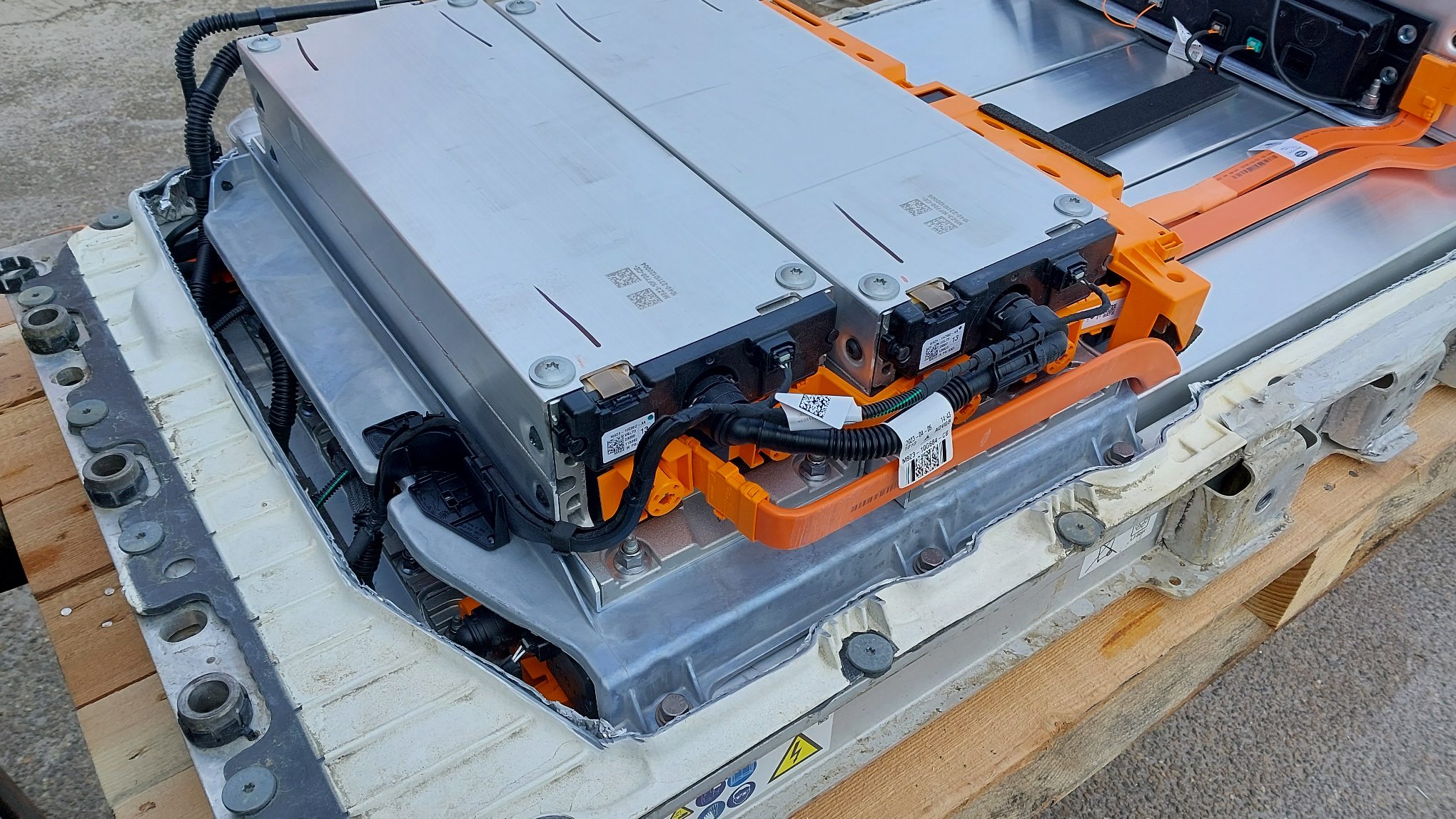

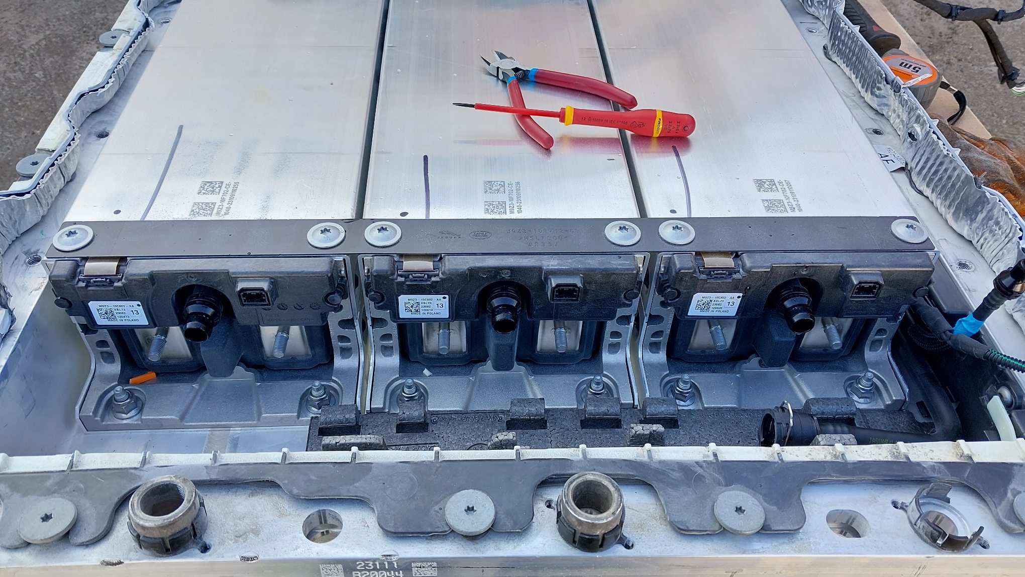

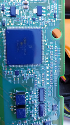

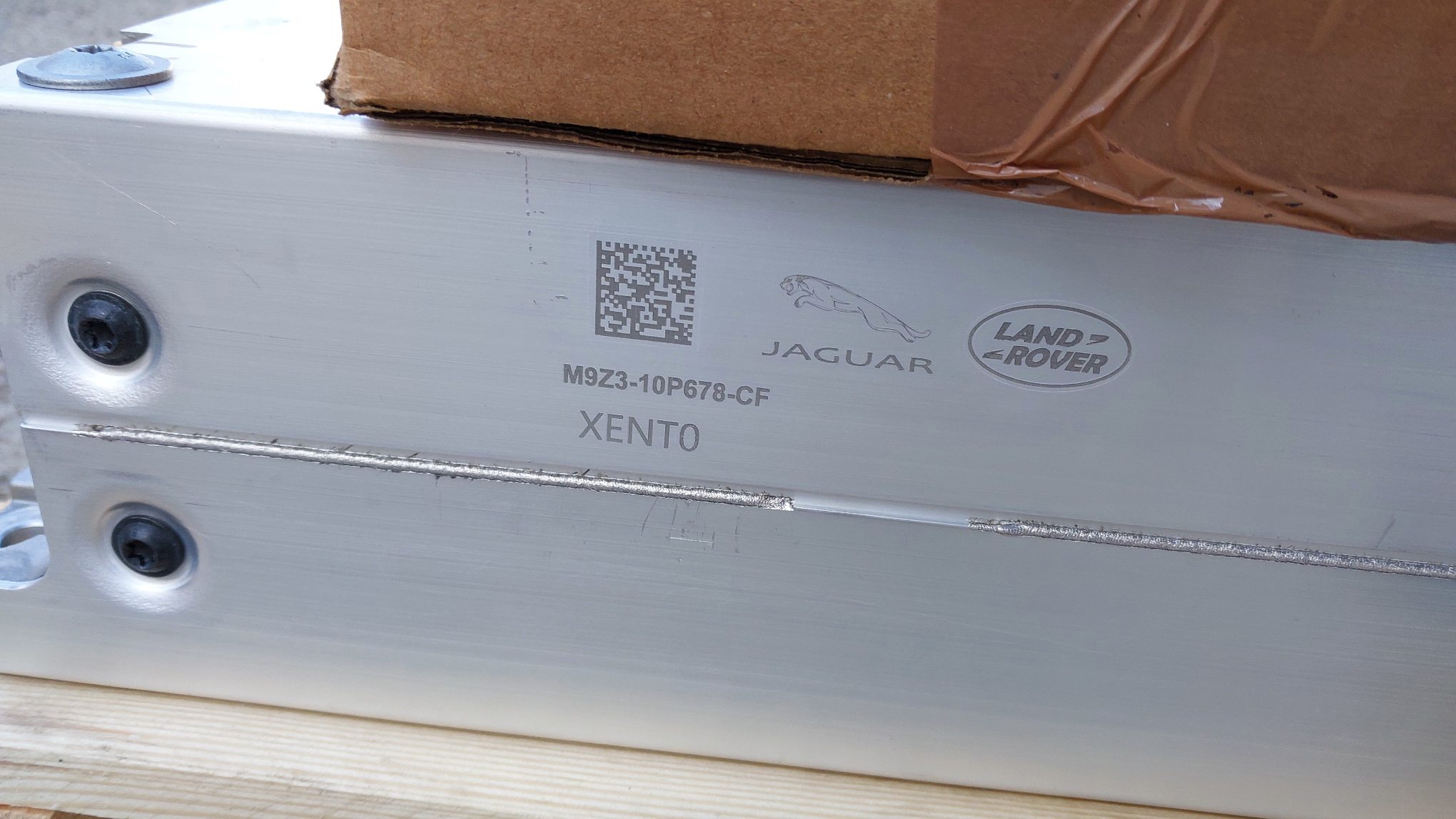

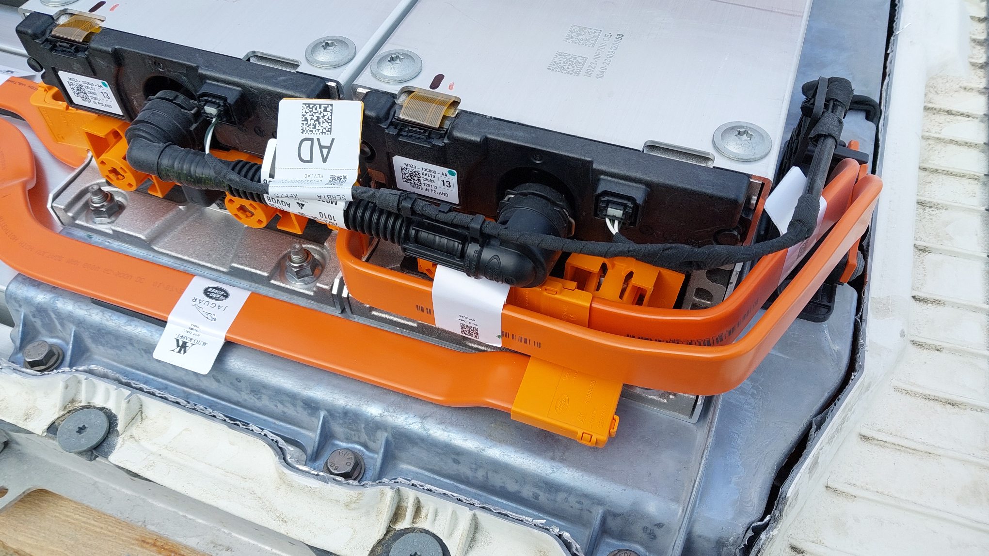

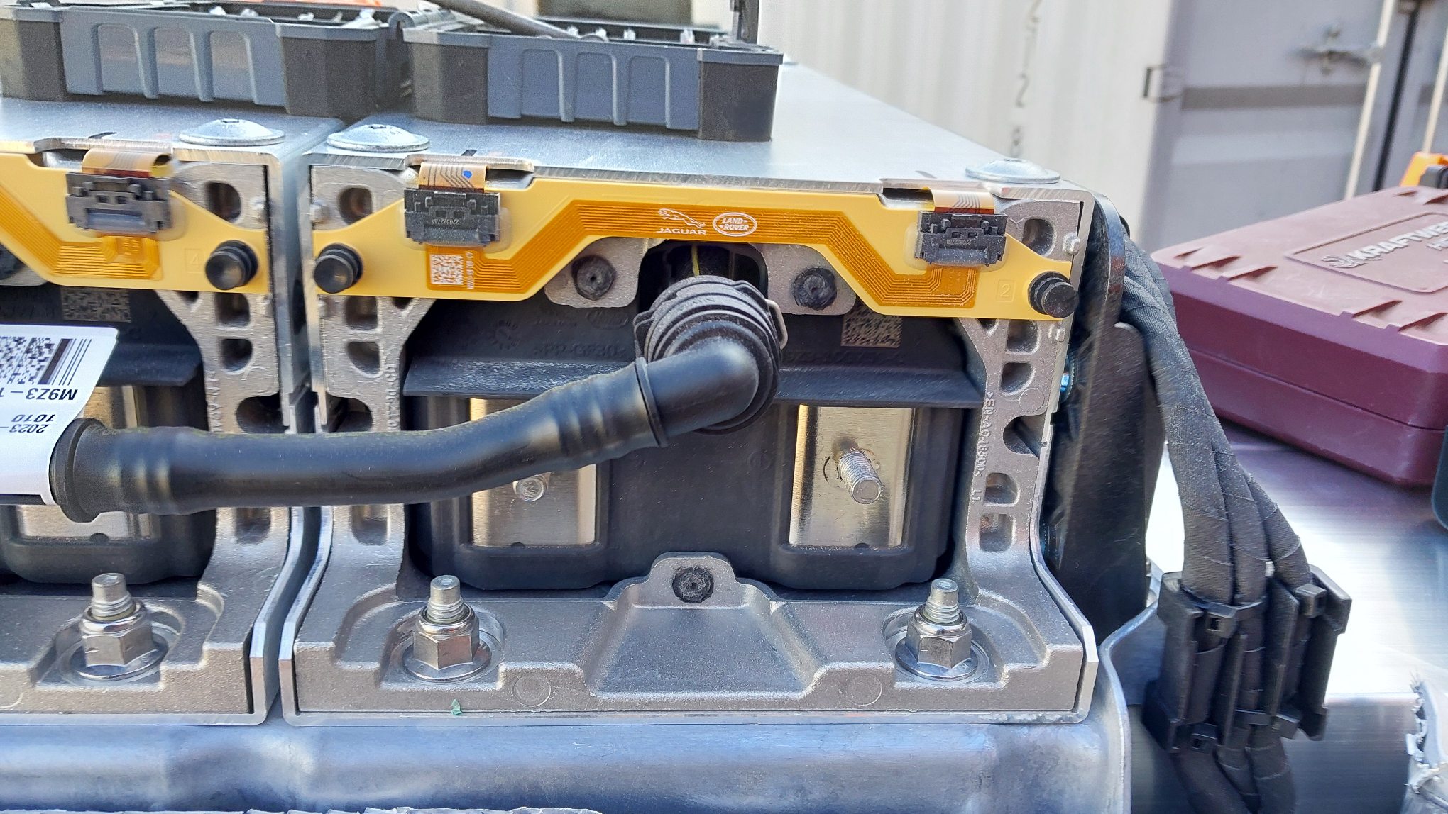

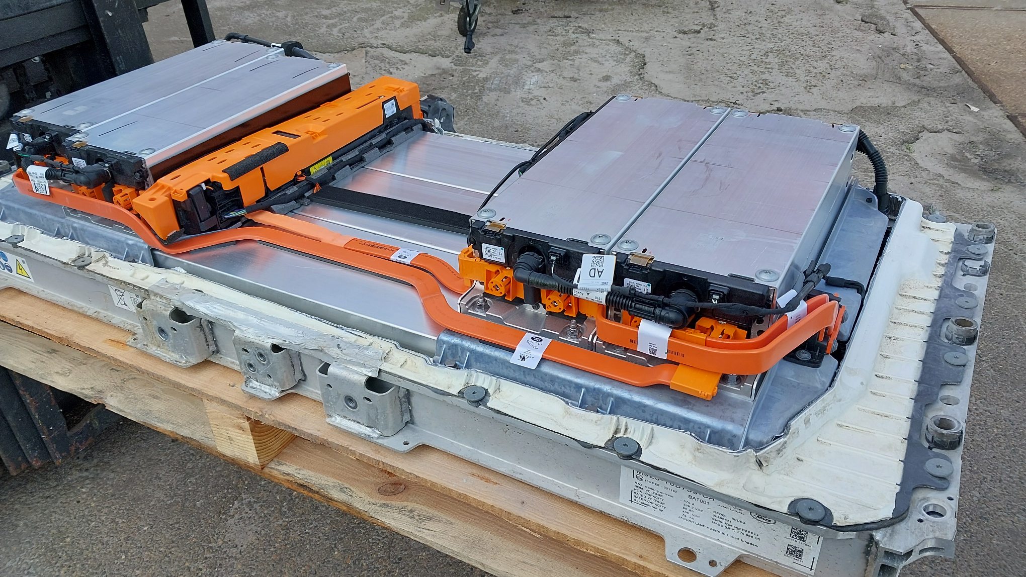

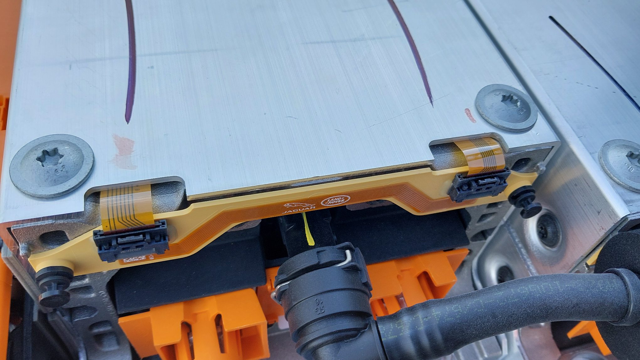

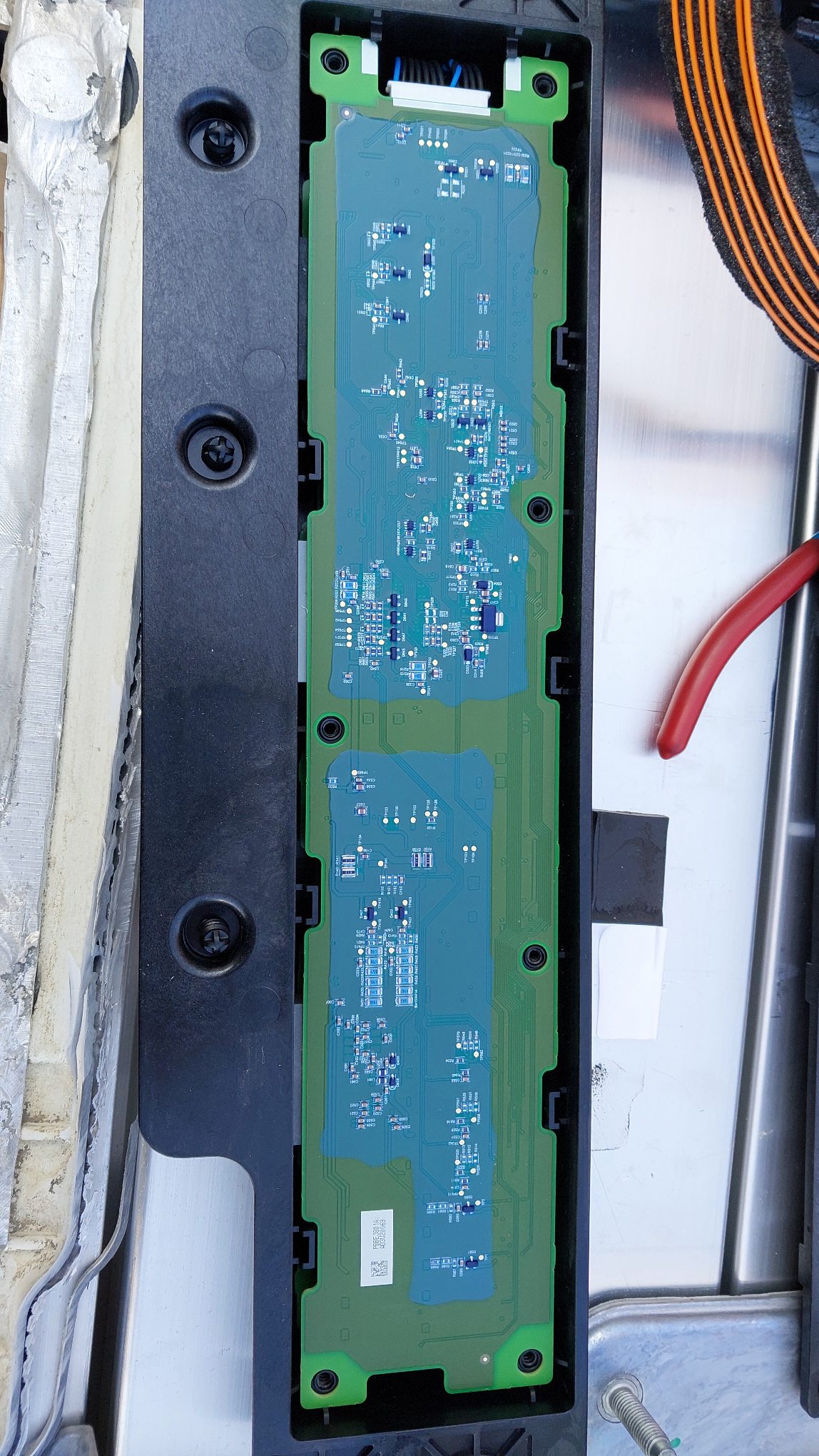

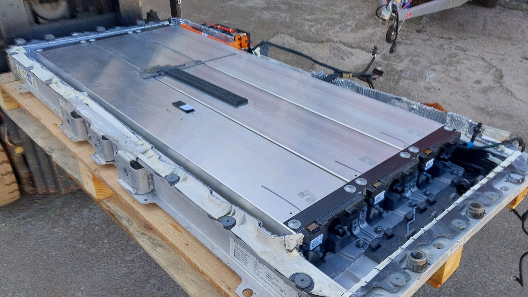

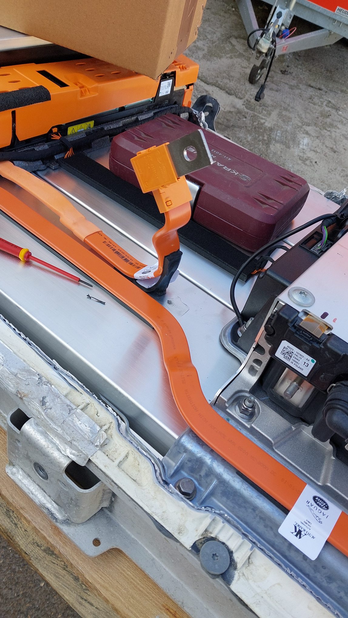

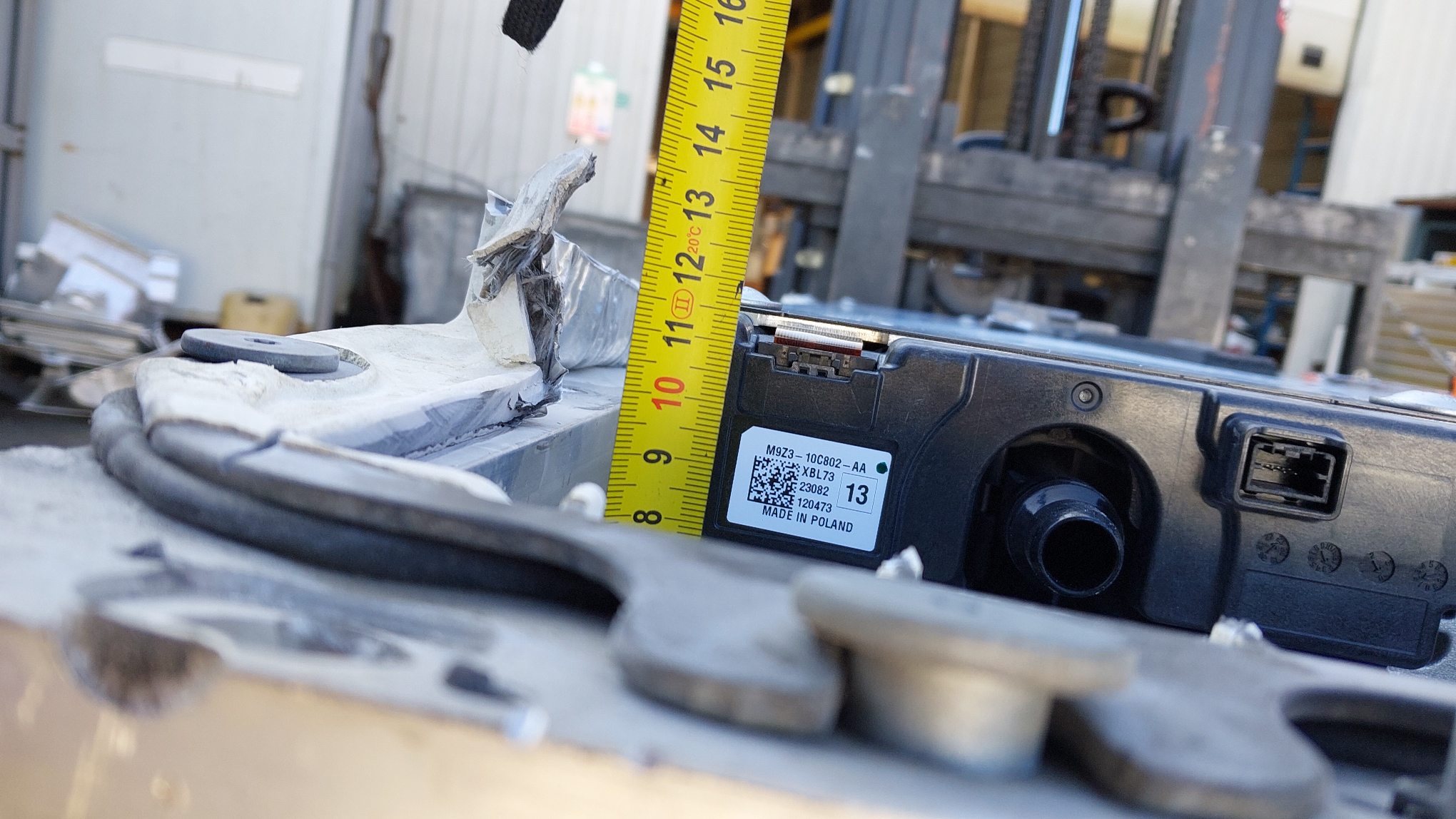

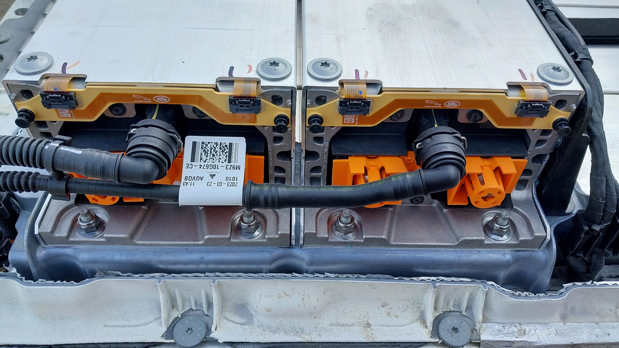

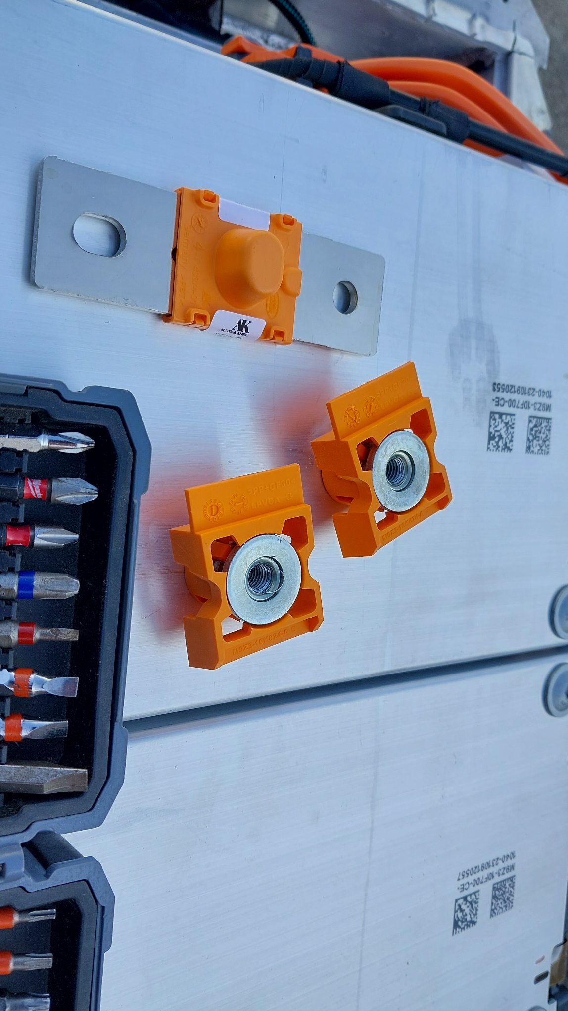

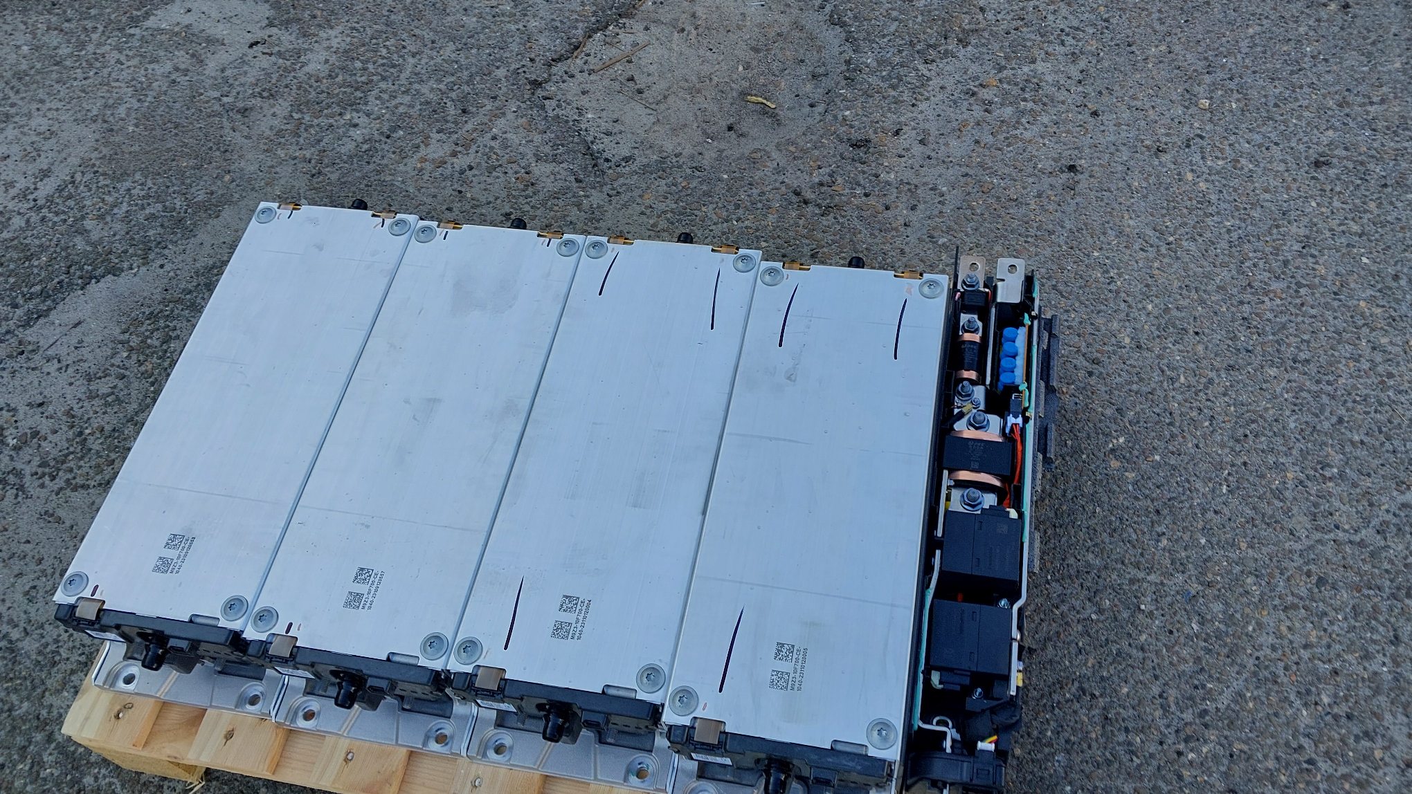

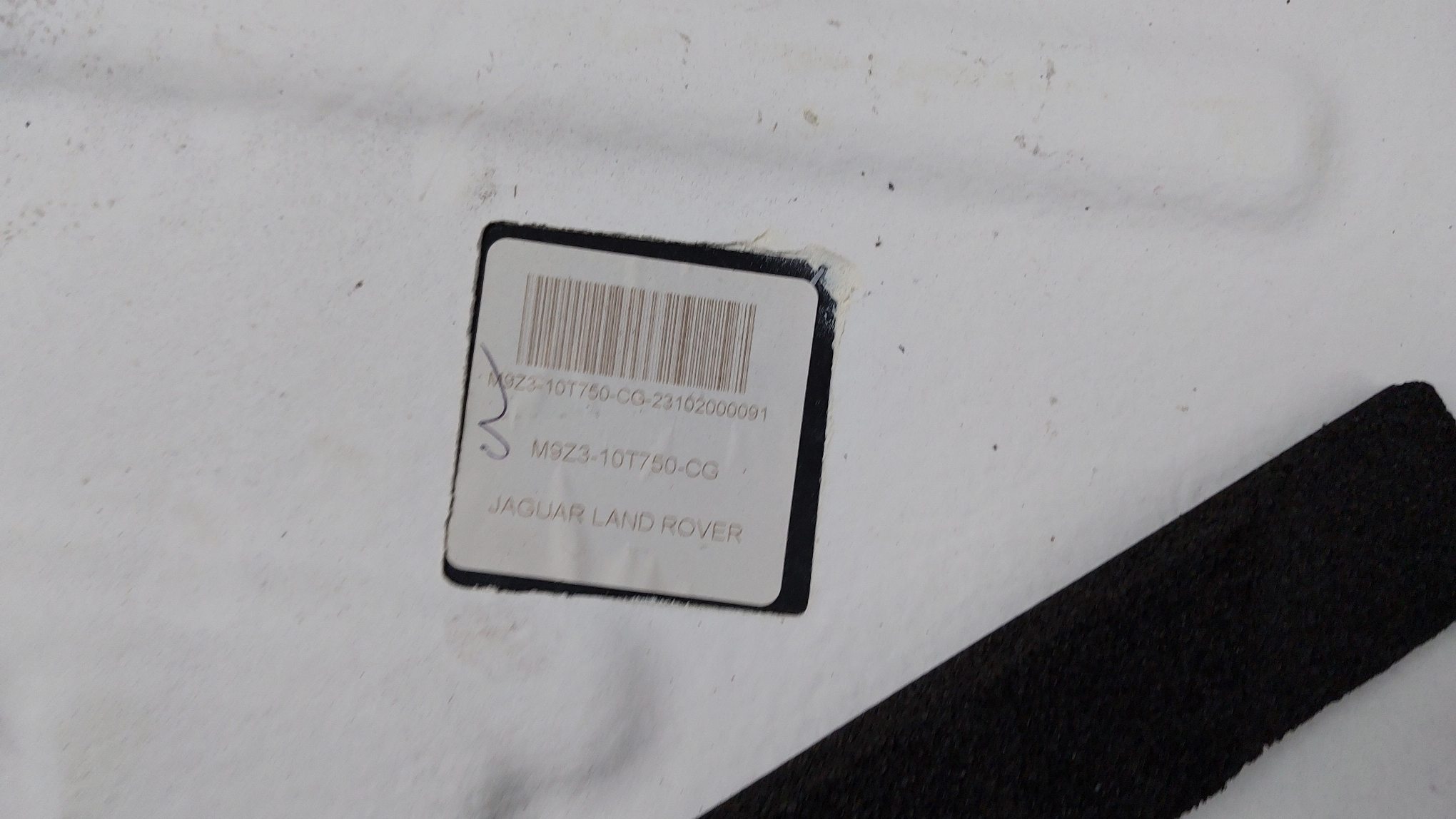

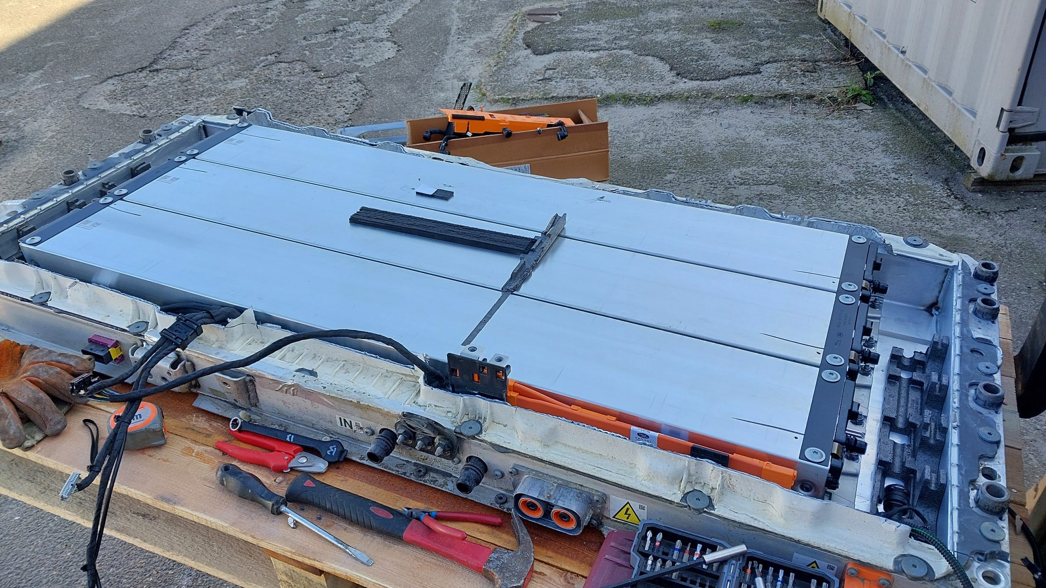

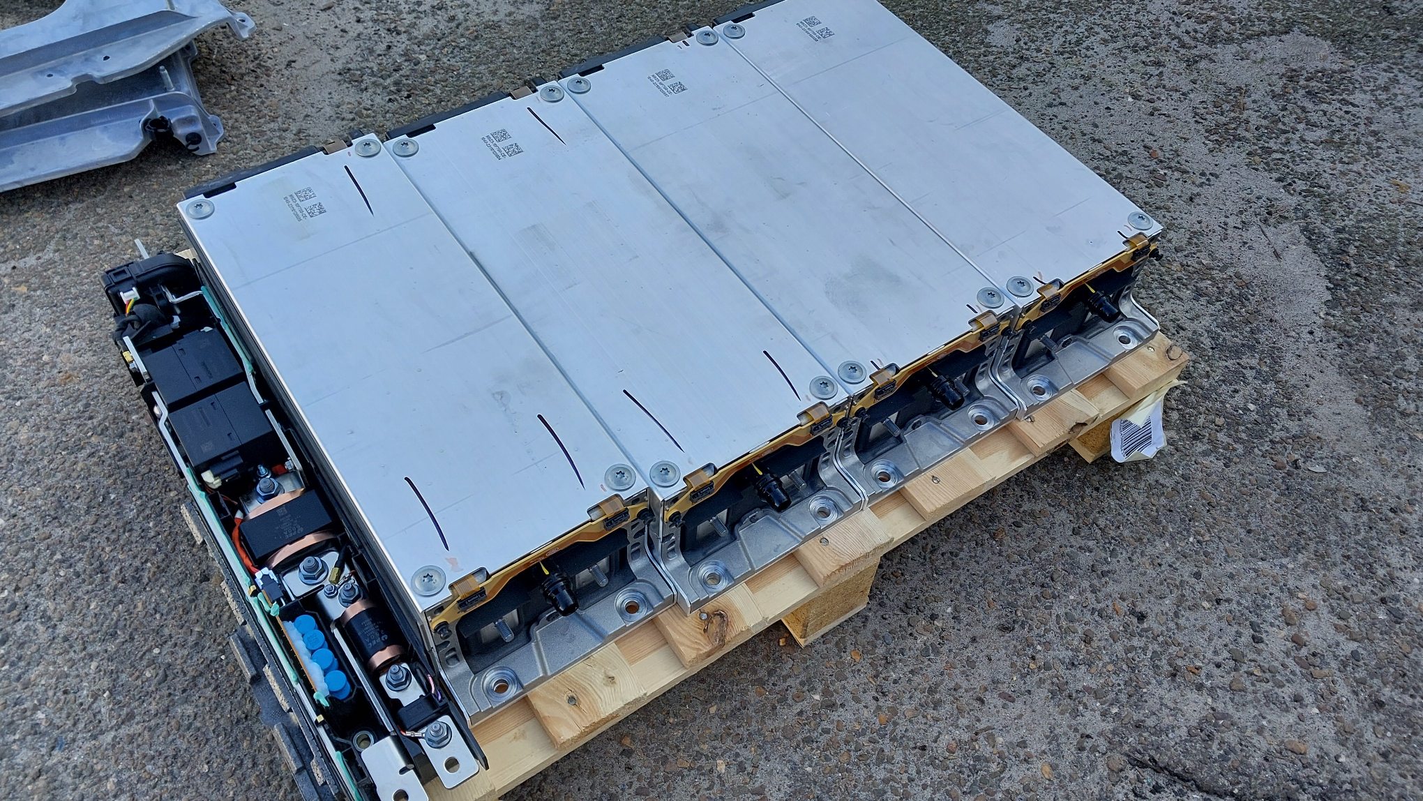

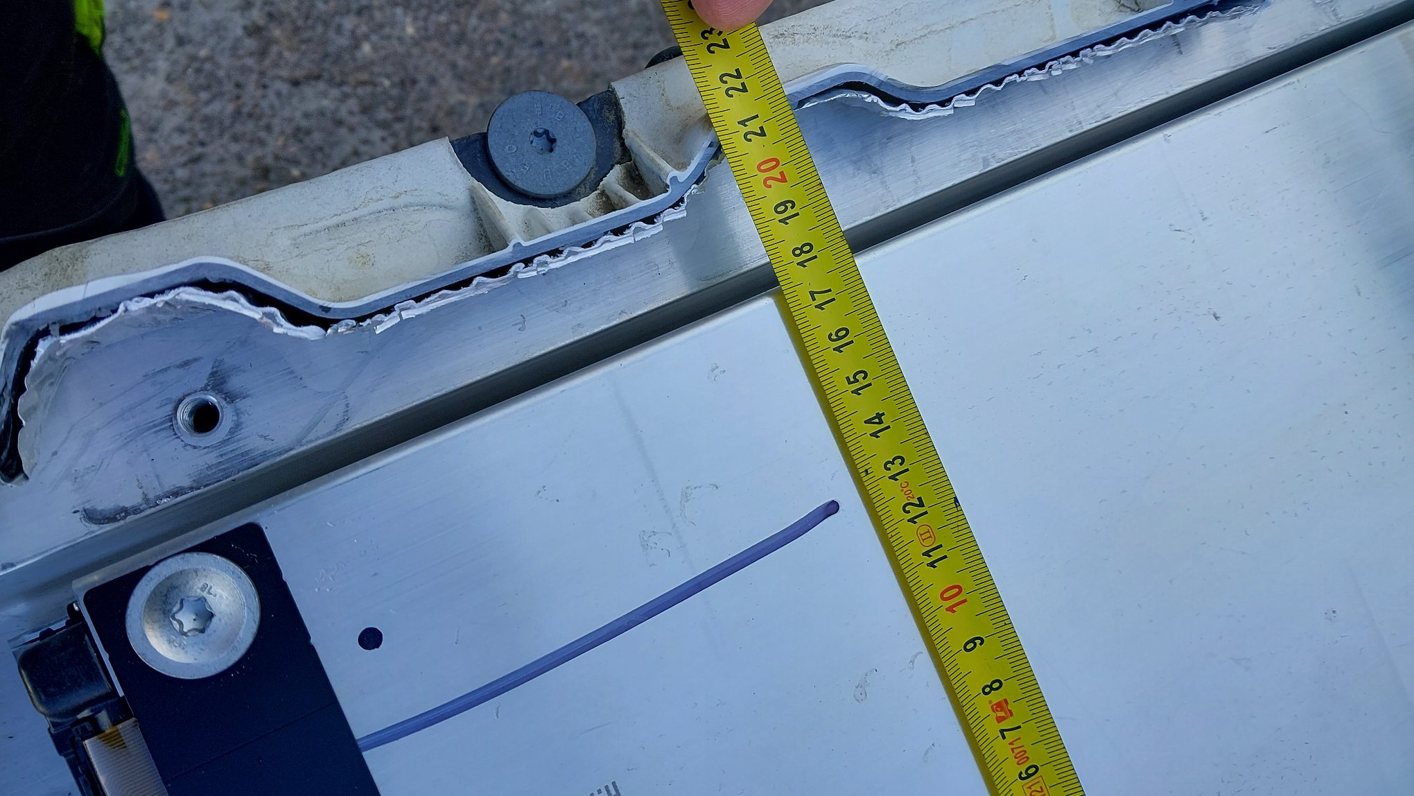

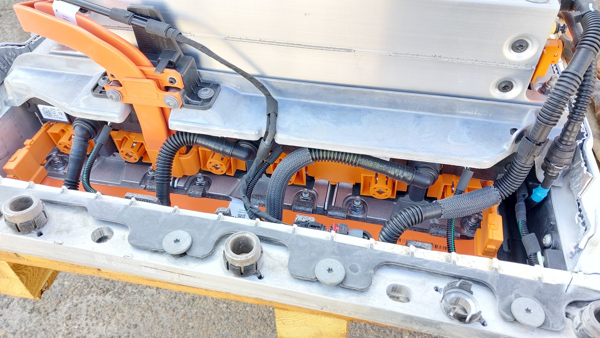

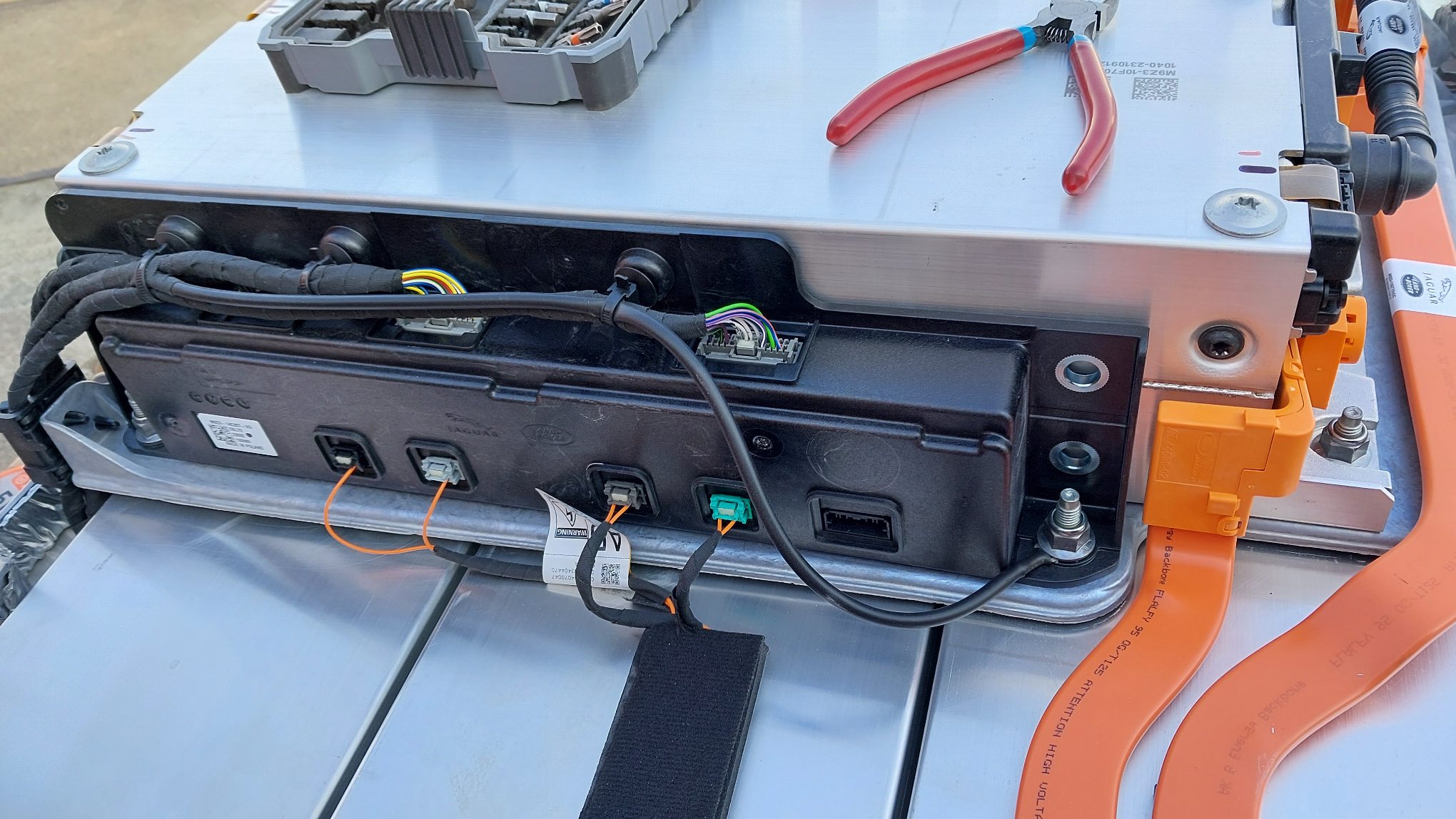

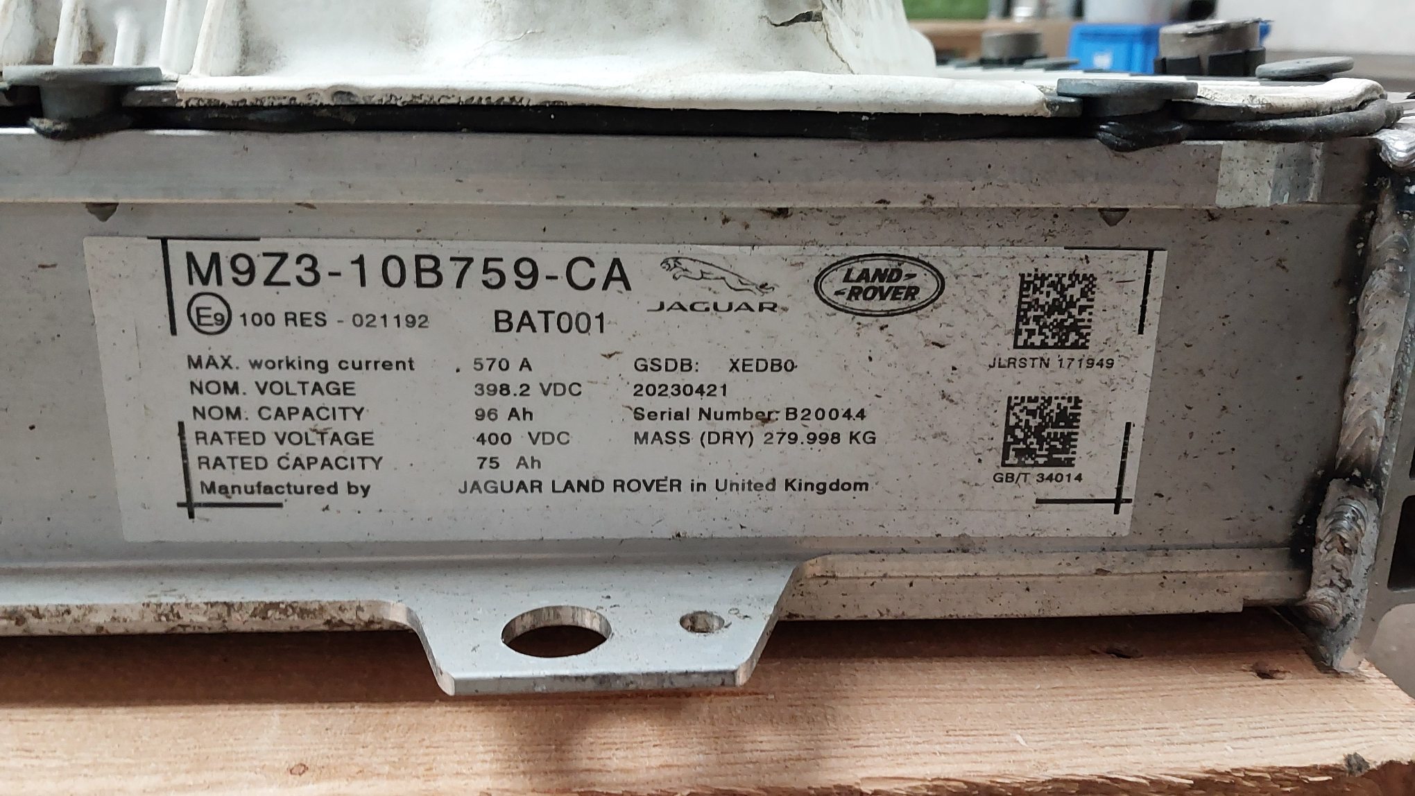

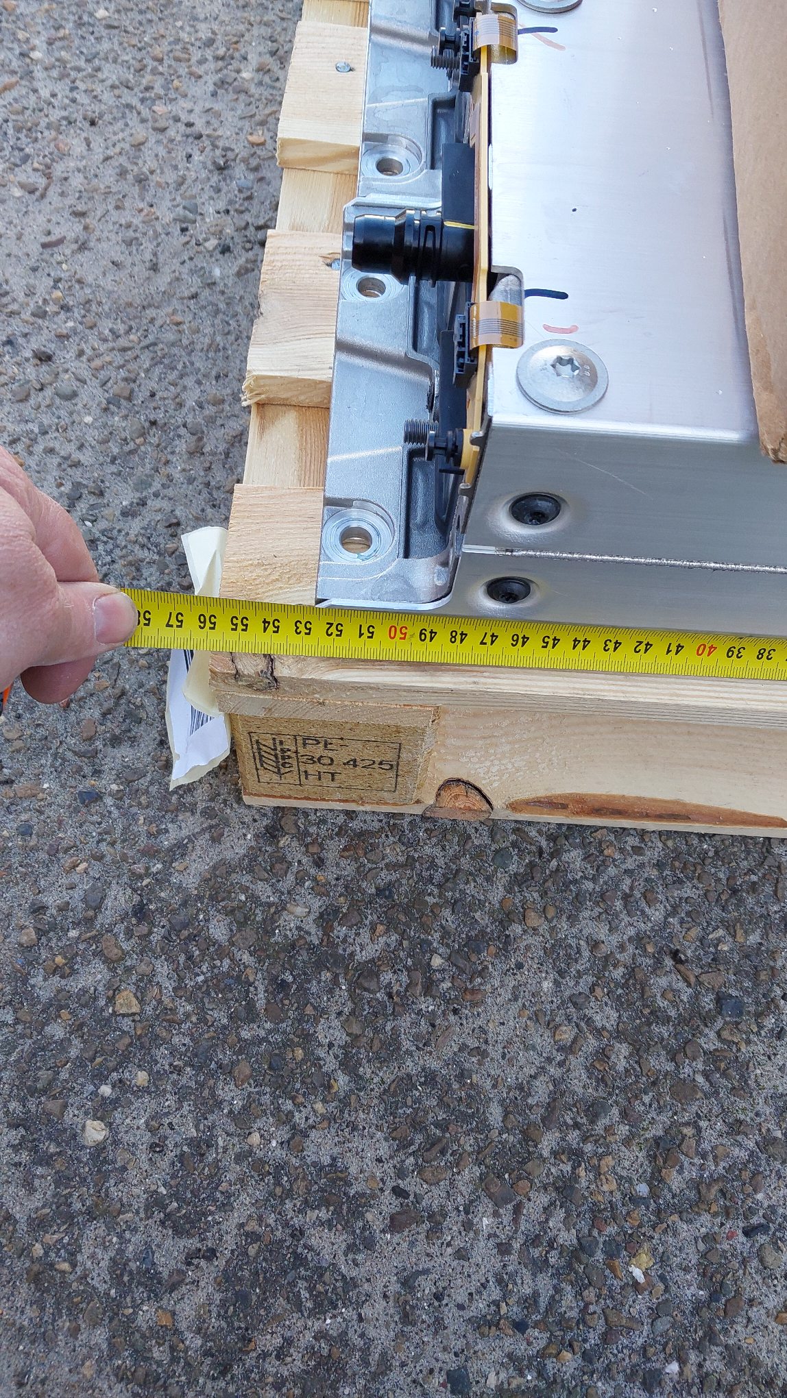

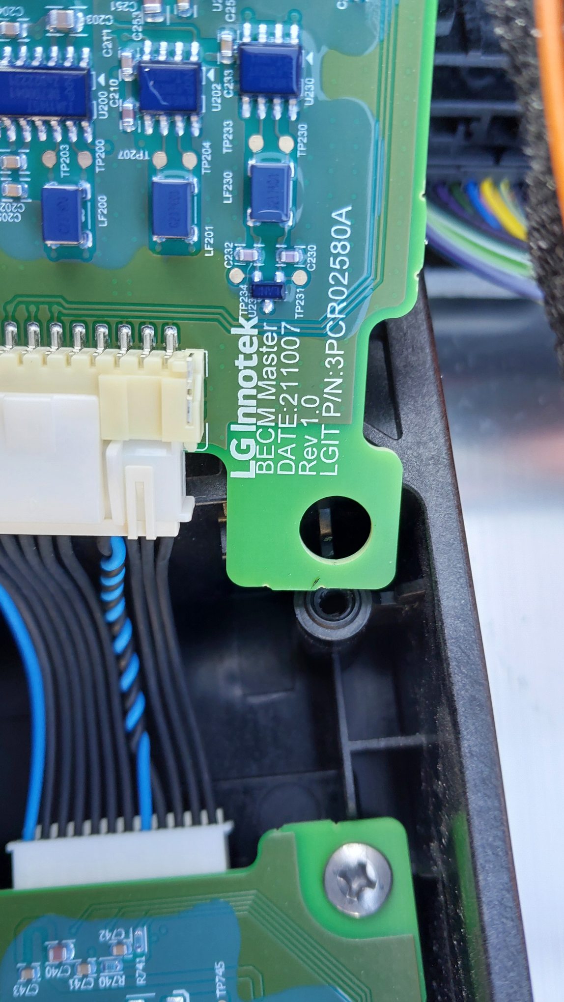

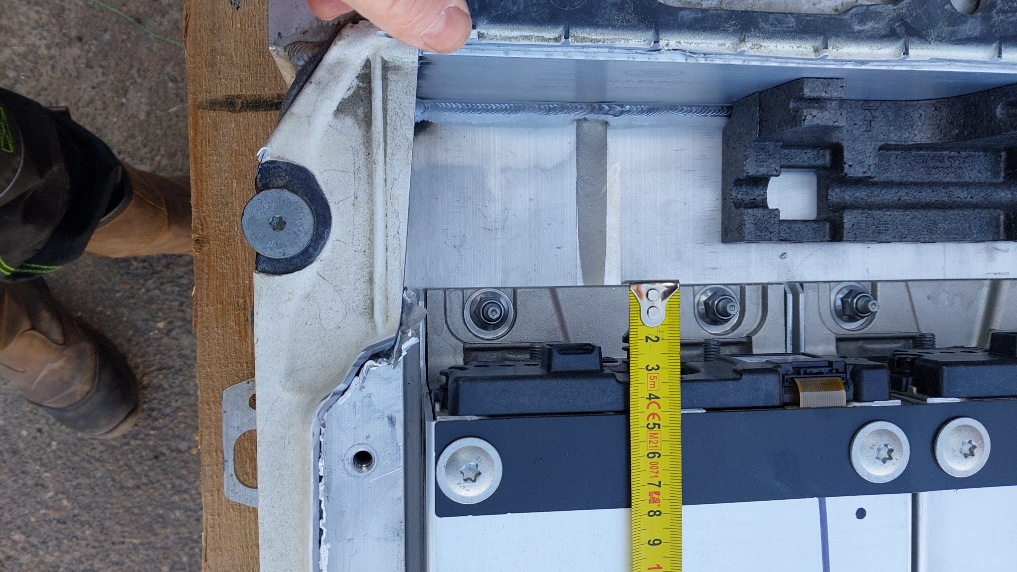

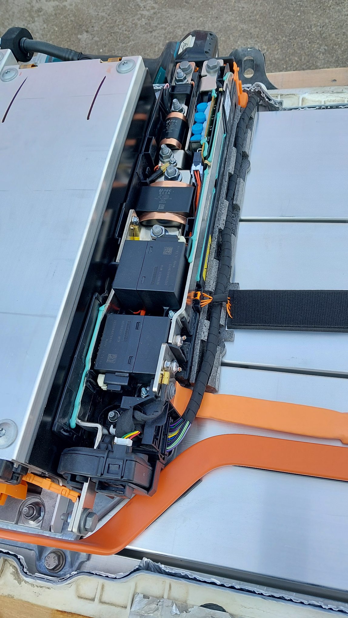

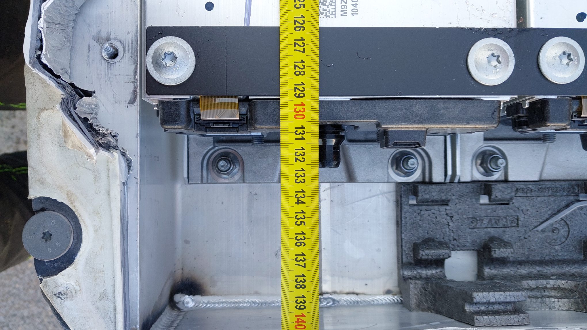

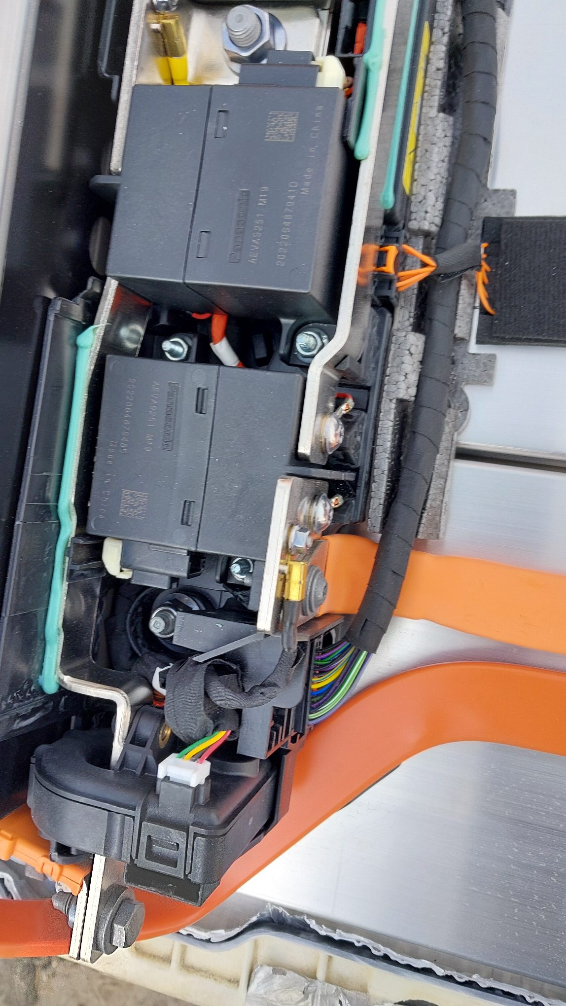

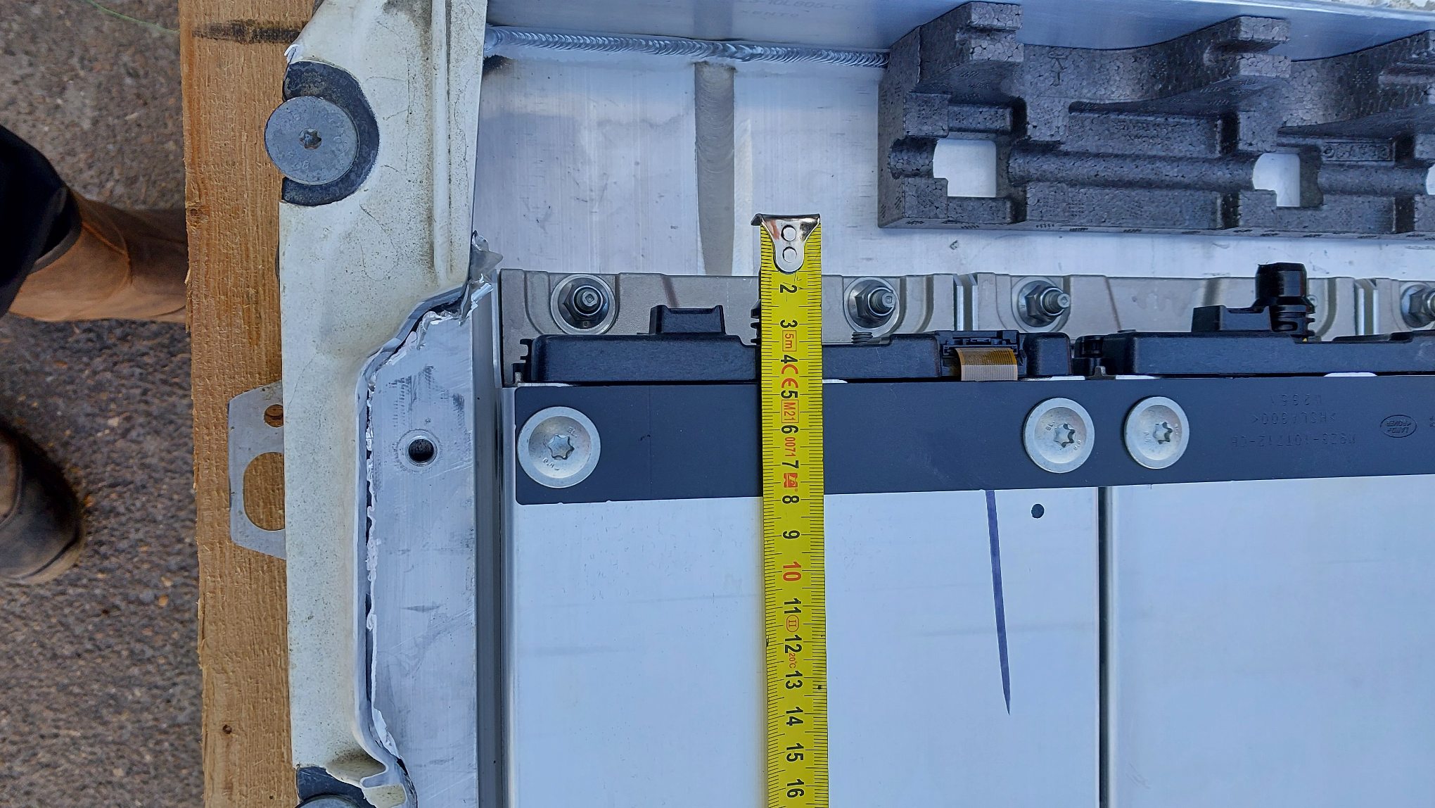

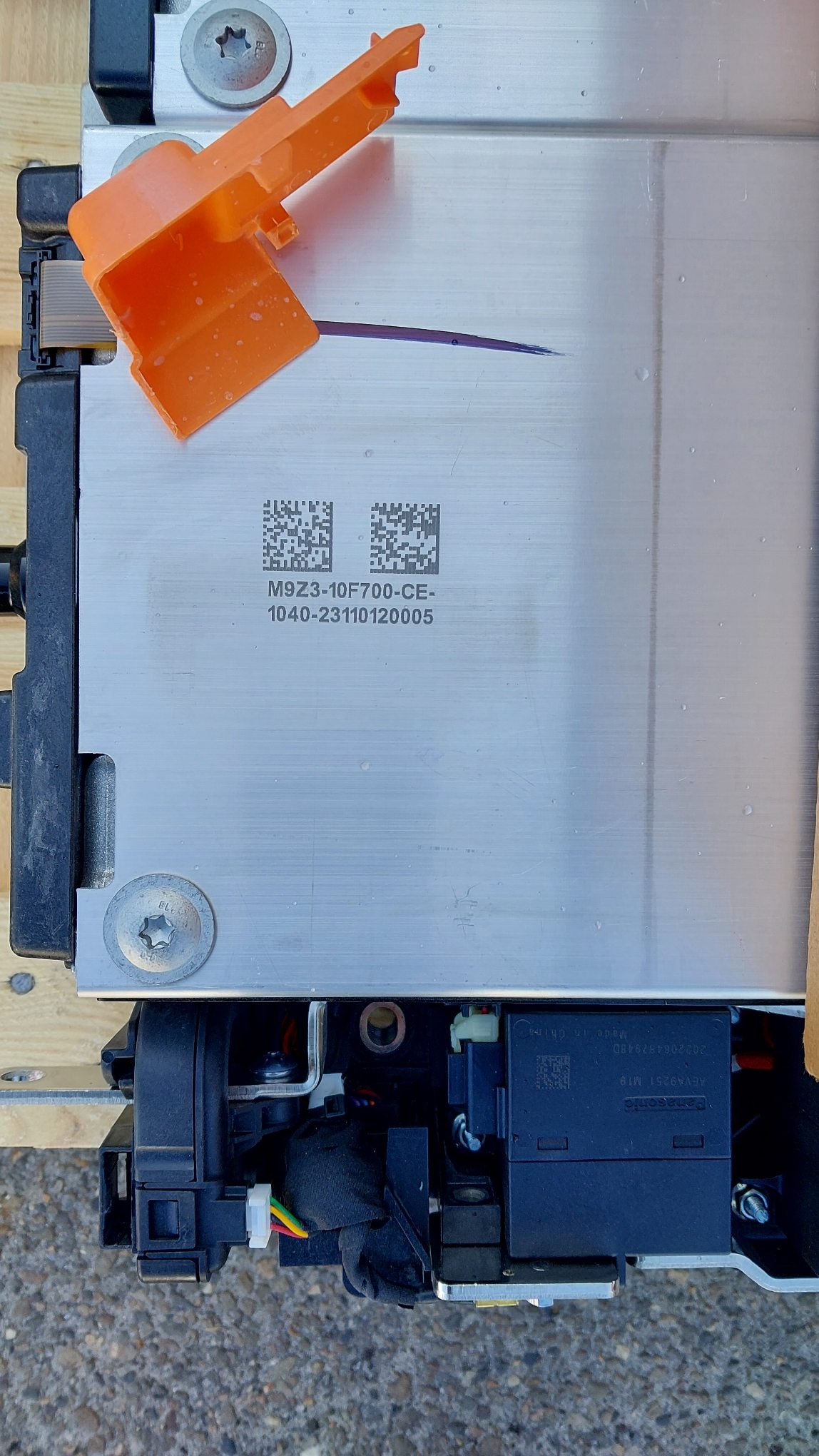

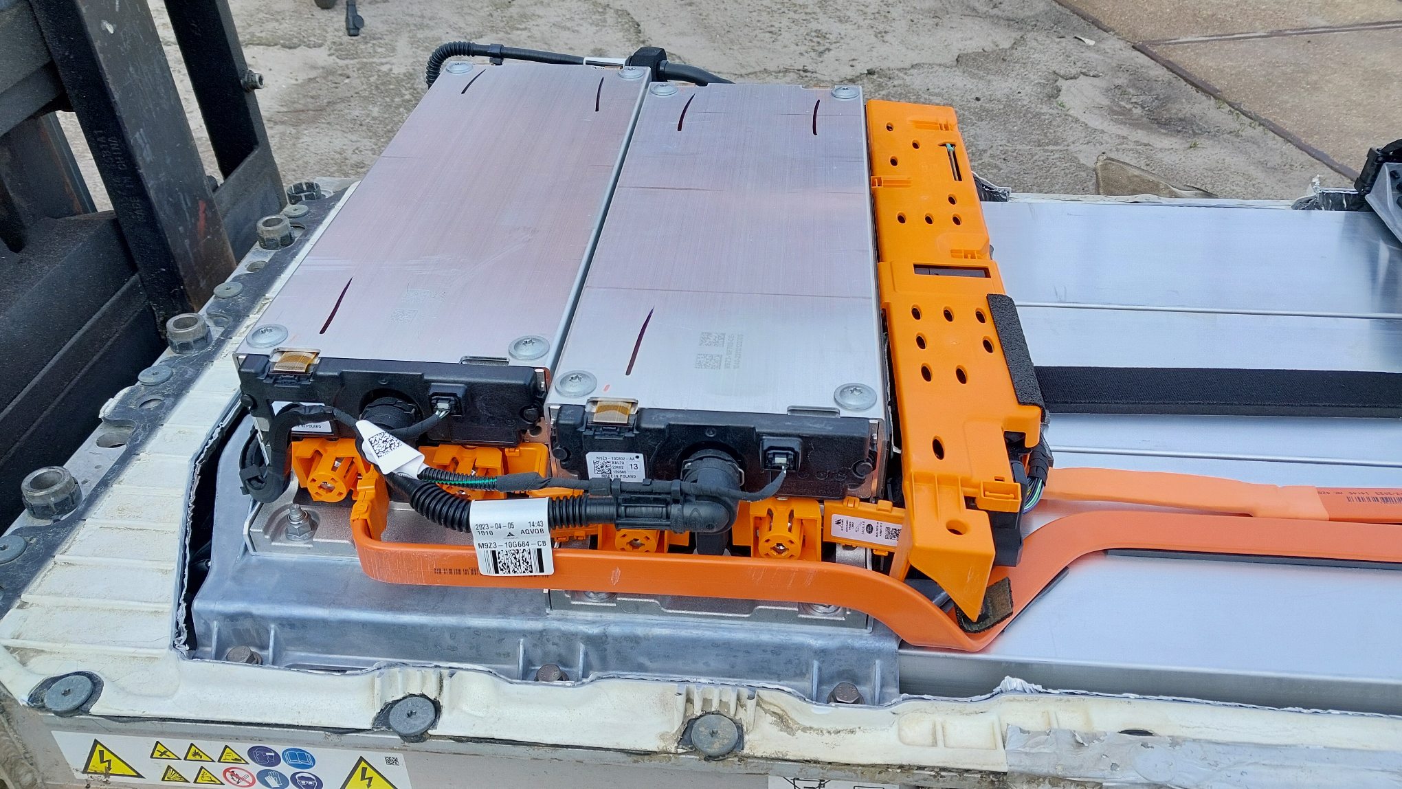

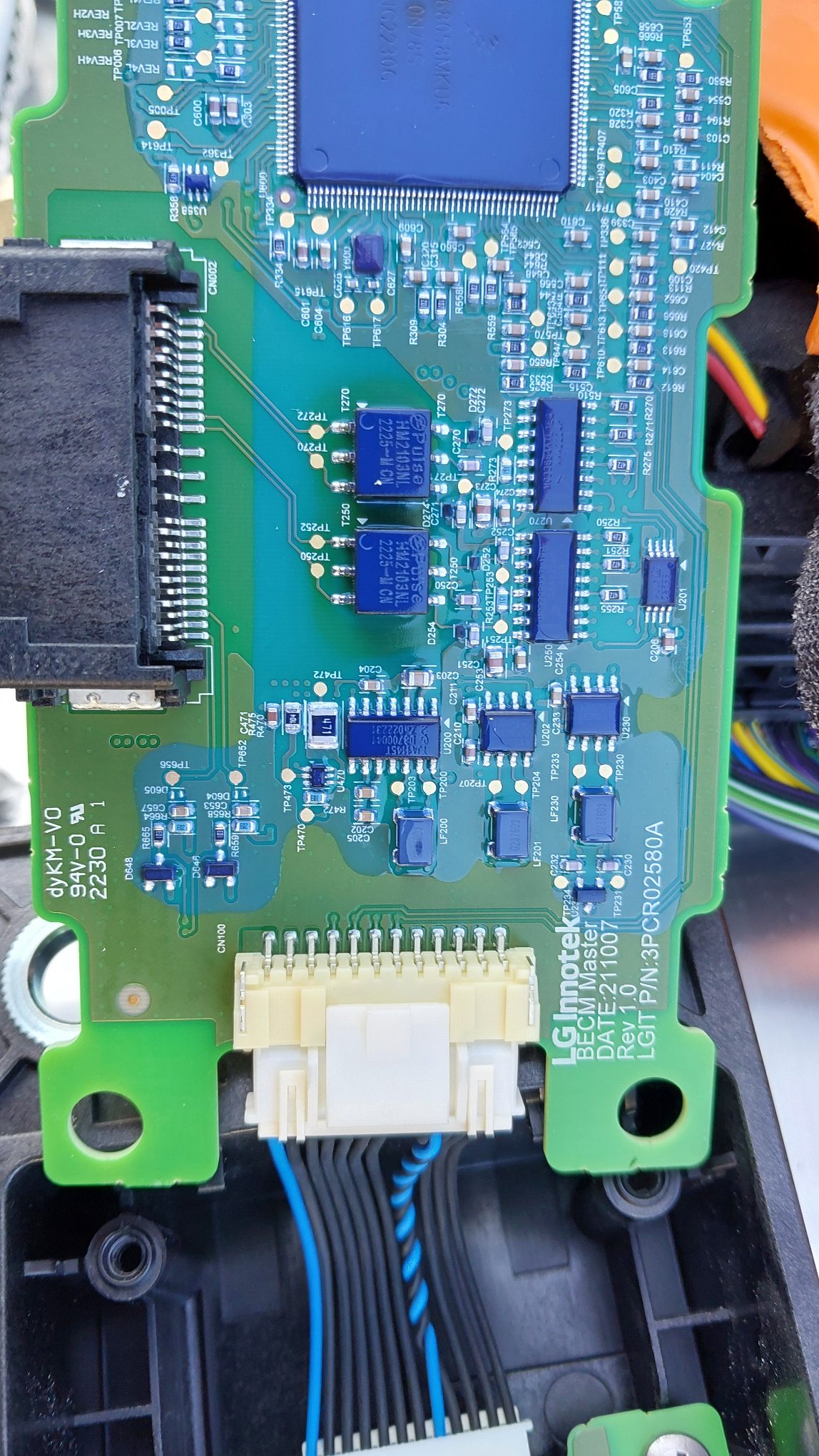

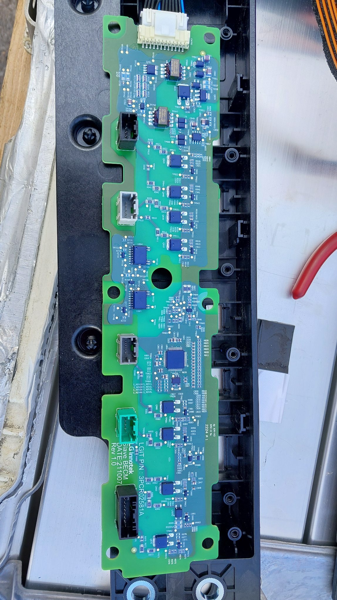

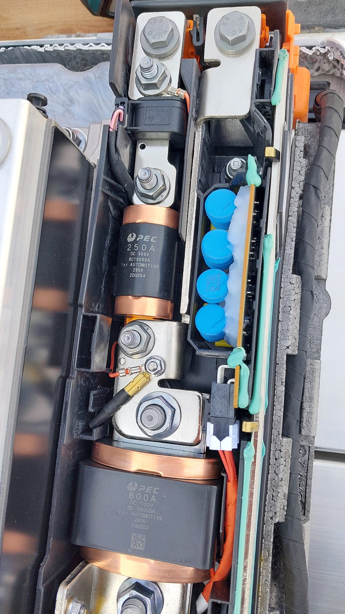

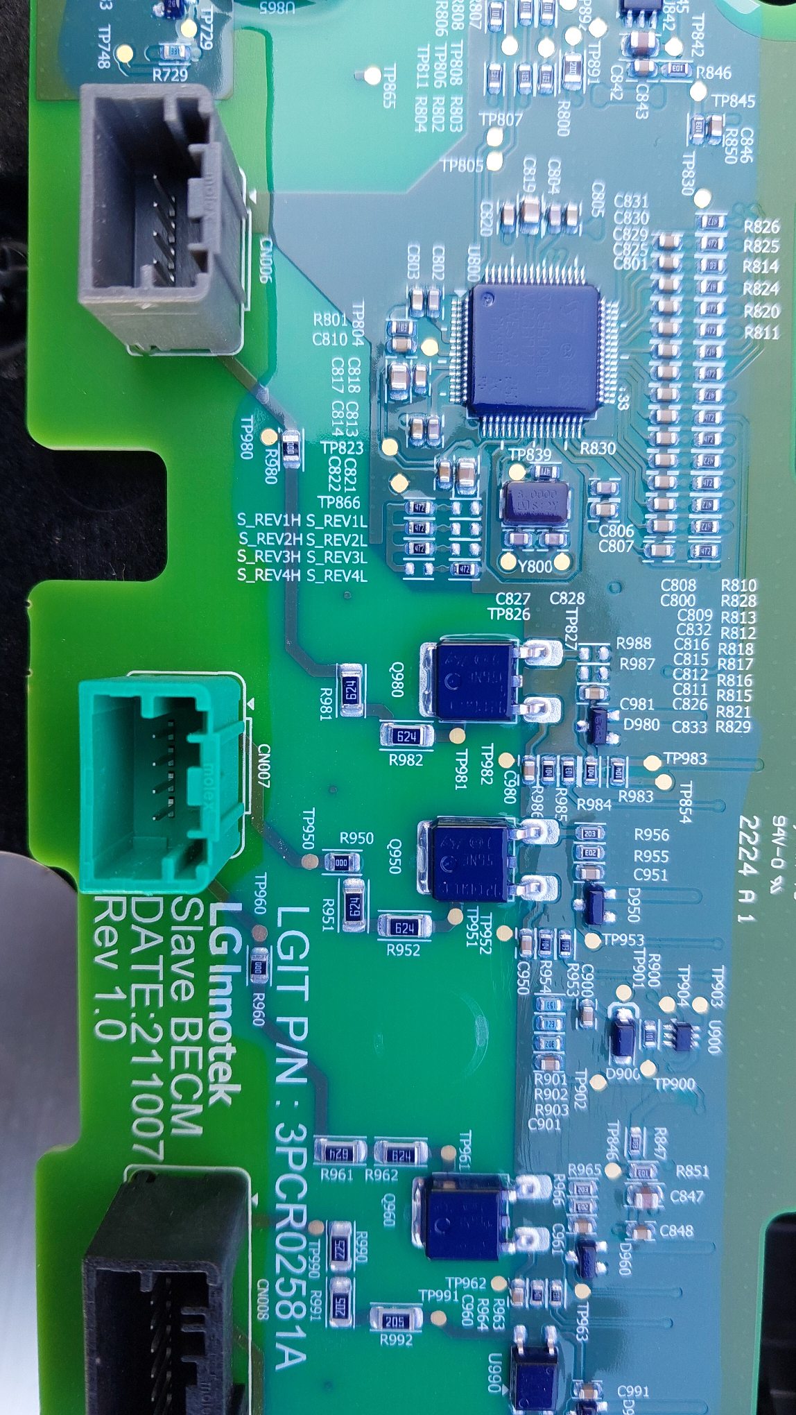

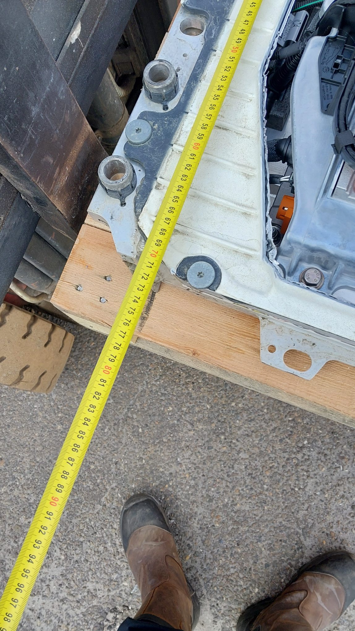

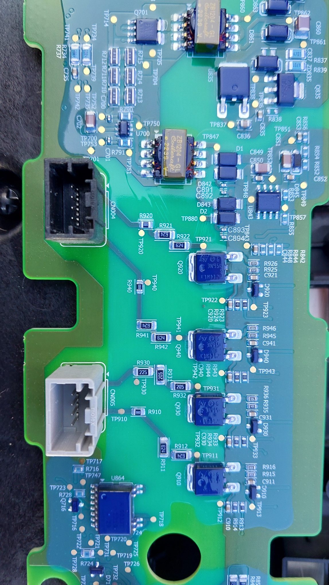

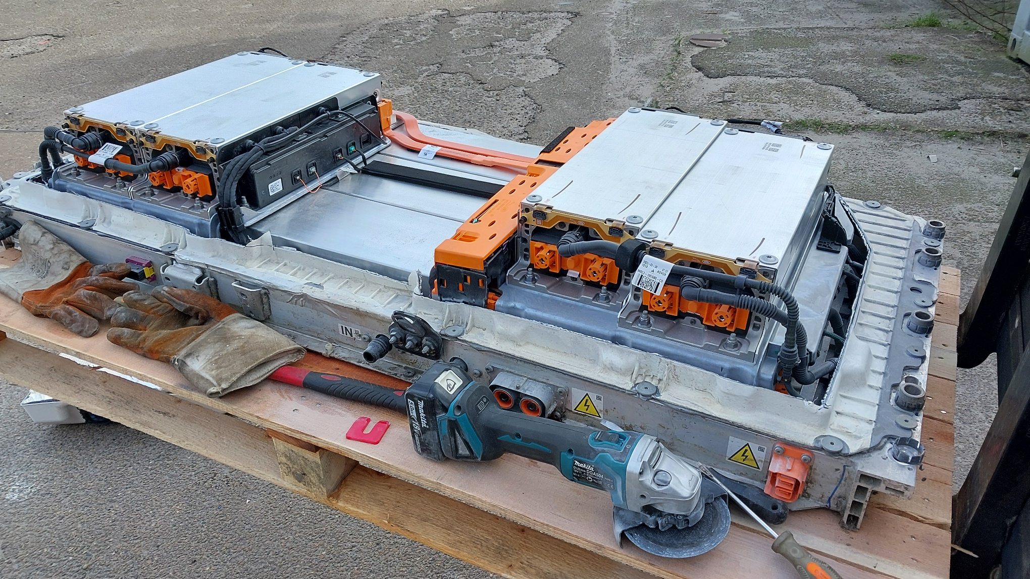

35 kWh PHEV battery with nice specs and great cooling to get to almost 6C discharge power
3 long modules, 18s each
4 short modules, 8s each

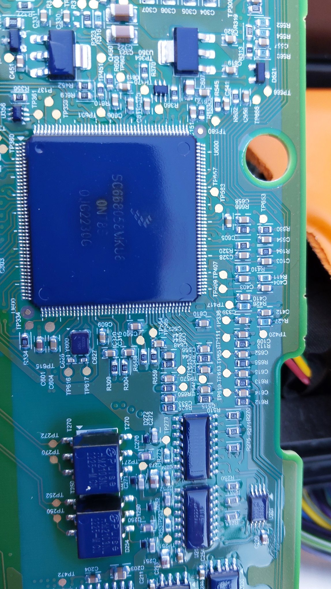

also each module is divided in two halves, but I don't know if the CMU's are capable of running two halves.

Tachopis
Posts: 55
Joined: Mon May 08, 2023 5:35 pm
Has thanked: 5 times
Been thanked: 14 times
Re: LAND ROVER RANGE ROVER P510E HSE - PHEV Battery
Post by Tachopis »
Hi boekel, did you move with this battery? BMS etc? They look amazing. I looked around in second-hand pages in the EU and they are quite expensive, probably because they are worth it. Thanks for the info, really well documented.
