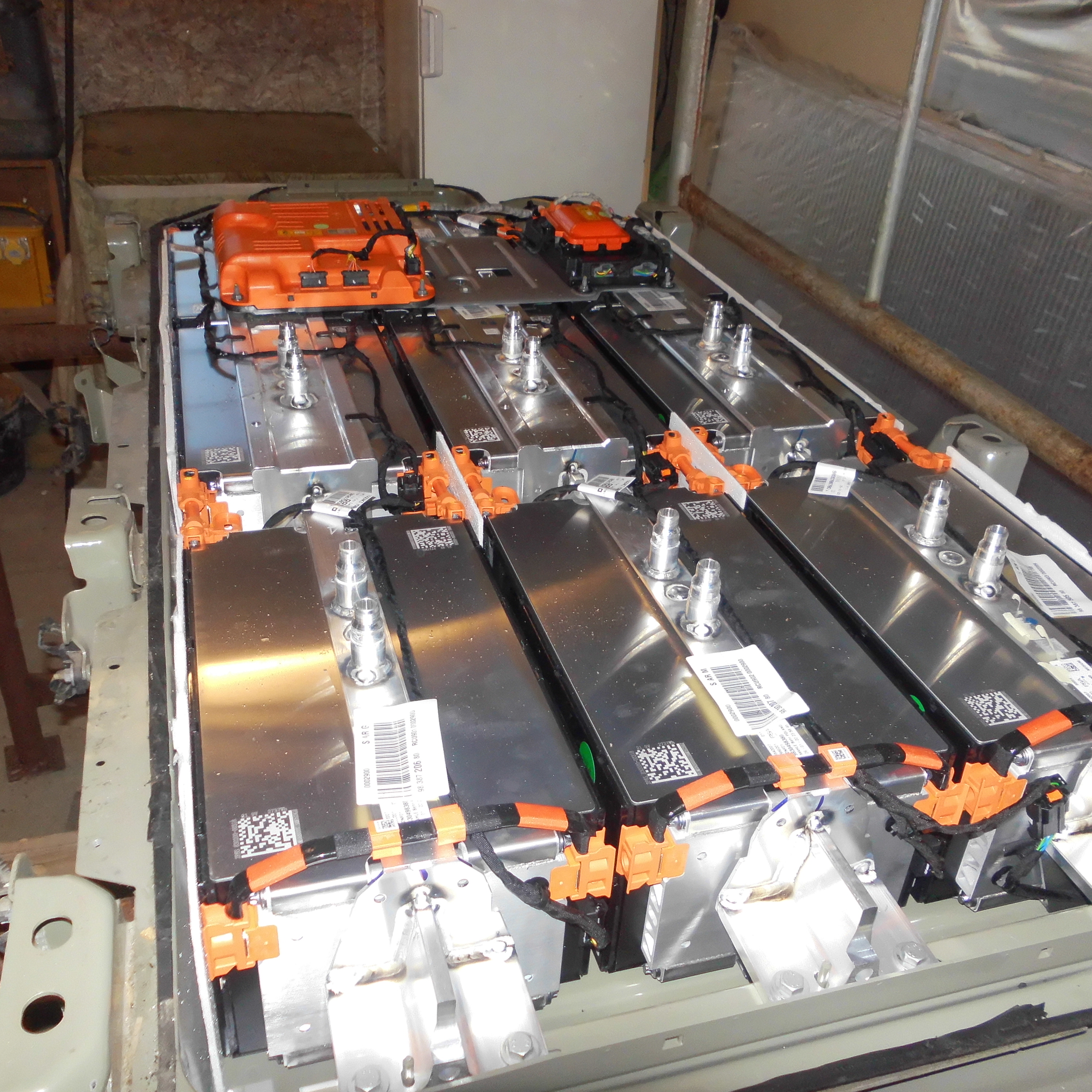

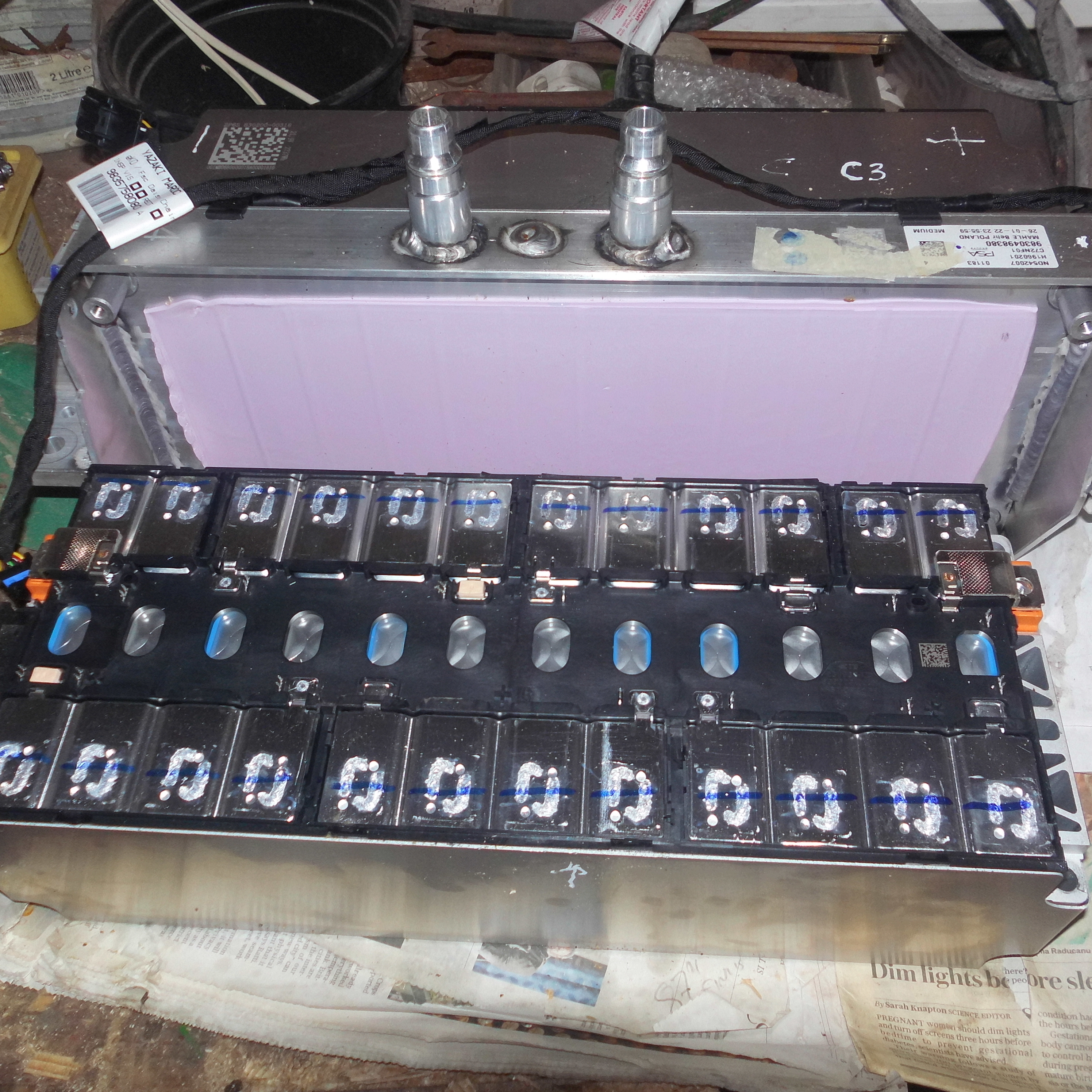

Hi, just joined you all. I live off grid in the UK (25 yrs with a 24KWh FLA set up using Outback inverter charger. 6.5Kw of PV and 3 Kw wind turbine. 24V battery) Also 10KVA gen set on Auto start.
I wish to double my battery capacity and upgrade to a 48 V system.
I have just purchased the complete battery and case from a 2022 plate Boxer-E with just 1000 miles on the clock.
I have dismantled the case and disconnected the modules. So I have 18 modules @ 44V nominal, Each module is 2 packs of 6s2p (in series) so effectivley 12s2p. Module energy 2.74KWh.
I wish for help in using these modules in the simplest and most reliable way. I am a long time user of Outback equipment, for it’s rugged build and reliability and simplicity and ideally would use their kitImage as I am familiar with their programming and menus etc.

Hello Jacob. Thanks for pointing out my error, caught by terminology. And thanks, I've found the upload as well. Each module is 6s2p 22V nominal. Each module is built paired up in its water cooling pack, so 44VDC, so 9 x pairs of modules is 400V as built.
So what I'm looking for is the simplest way to build a nominal 48V battery and can I re use the integral BMS board, and if so what else would be required, please?
Below is spec for the complete battery
51 KWh.
Pack voltage 400V
Capacity 127.5Ah.
Total cells 216
Battery pack 108s2p
Modules 18
Module energy 2.74kWh
Module nominal 22V
Cells in module 12
Module configuration 6s2p
Format Prismatic.
Cell chemistry Lithium ion NMC
Cell nominal Voltage 3.7V
Standard charge and discharge cut off V 4.2V/2.75.
Cell capacity 62Ah
Battery voltage before dismantling was 388VDC and individual cells measure 3.59

So I notice that the 9 modules are all connected daisy chain in series all the way back to the main control module. The daisy chain loom consists of only 4 wires . From this I deduce that the individual modules board must be doing the actual "work" ie balancing cells, etc and the 4 wires are (perhaps) supply power to the individual module boards (sub 9V) red and green/ and the 2 white wires are carrying signals either to or from the module and main control "box".
So simple (stupid) question. If reconnect the daisy chain back together on all 9 modules and reconnect to the main battery control module, will the cells be checked and balanced if required? Power to this main BMS is 12 Vdc from the main car battery?

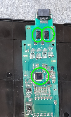

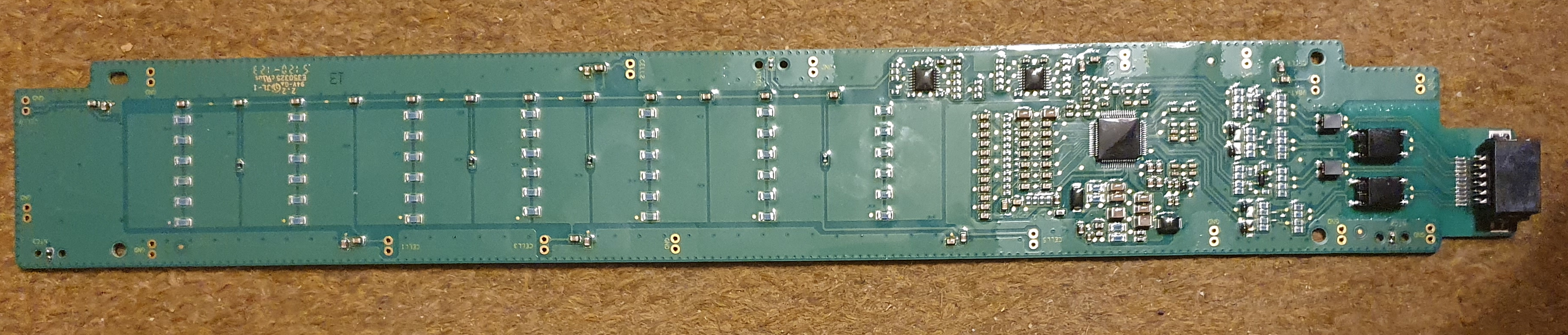

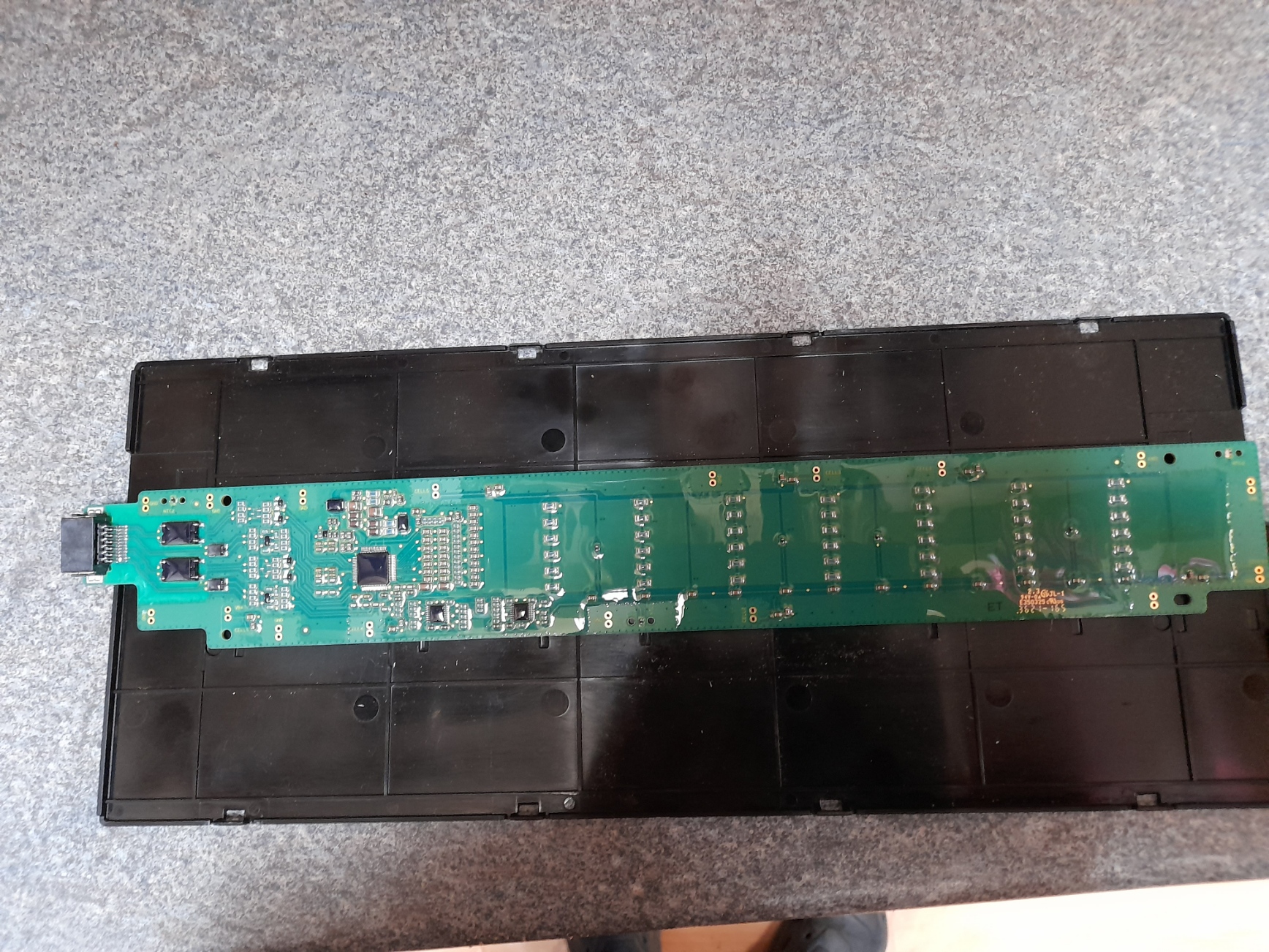

I guess that the board over the cell looks like this:
There are four wires between each module, but they are only communication (RX and TX pairs). The cells power the balance PCB.
It's possible to reconnect all modules (18) to the central BMS and to get cell data. Some people try to do this here:

Please get details of the chip, better picture and markings on it.
This looks like some ISO-SPI comms.

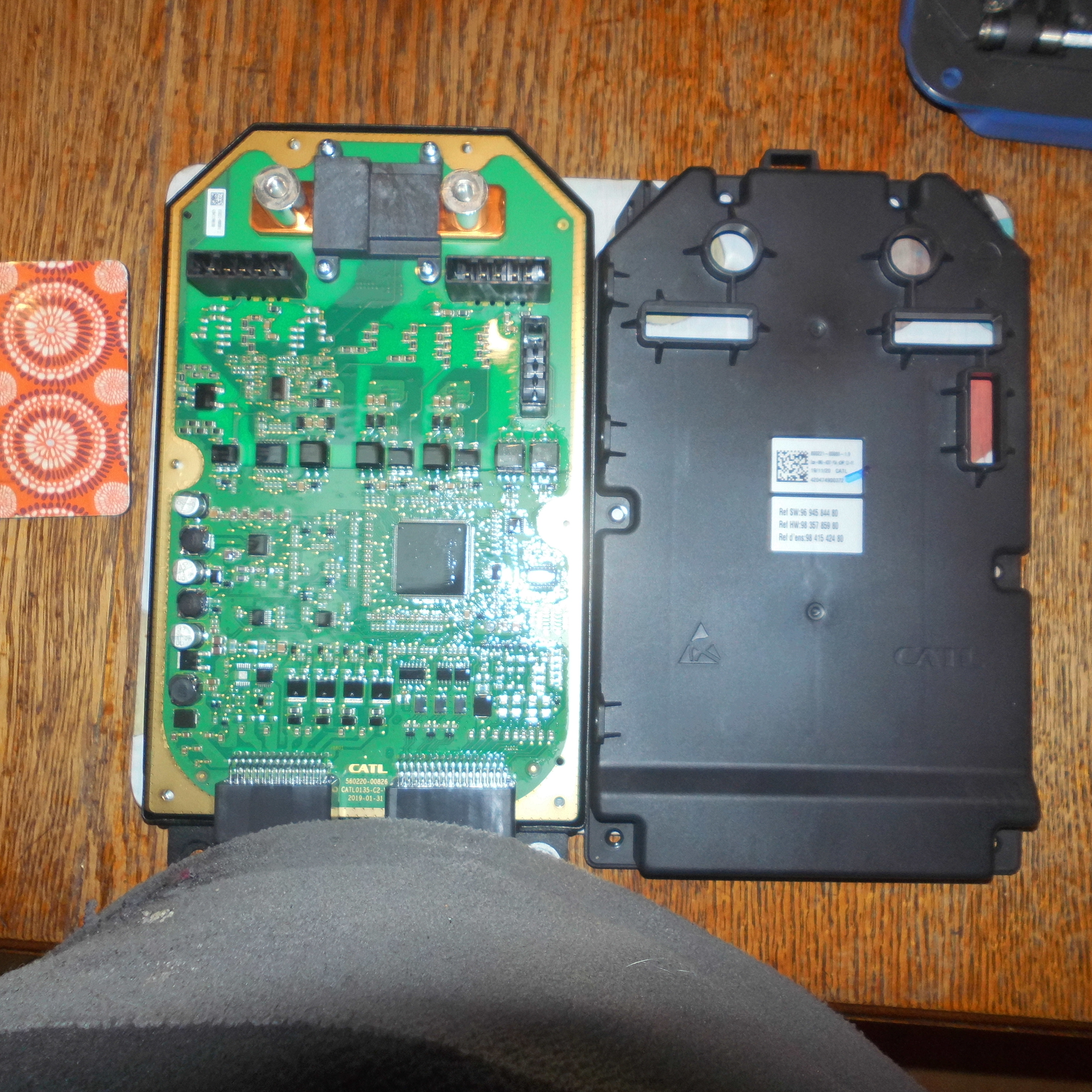

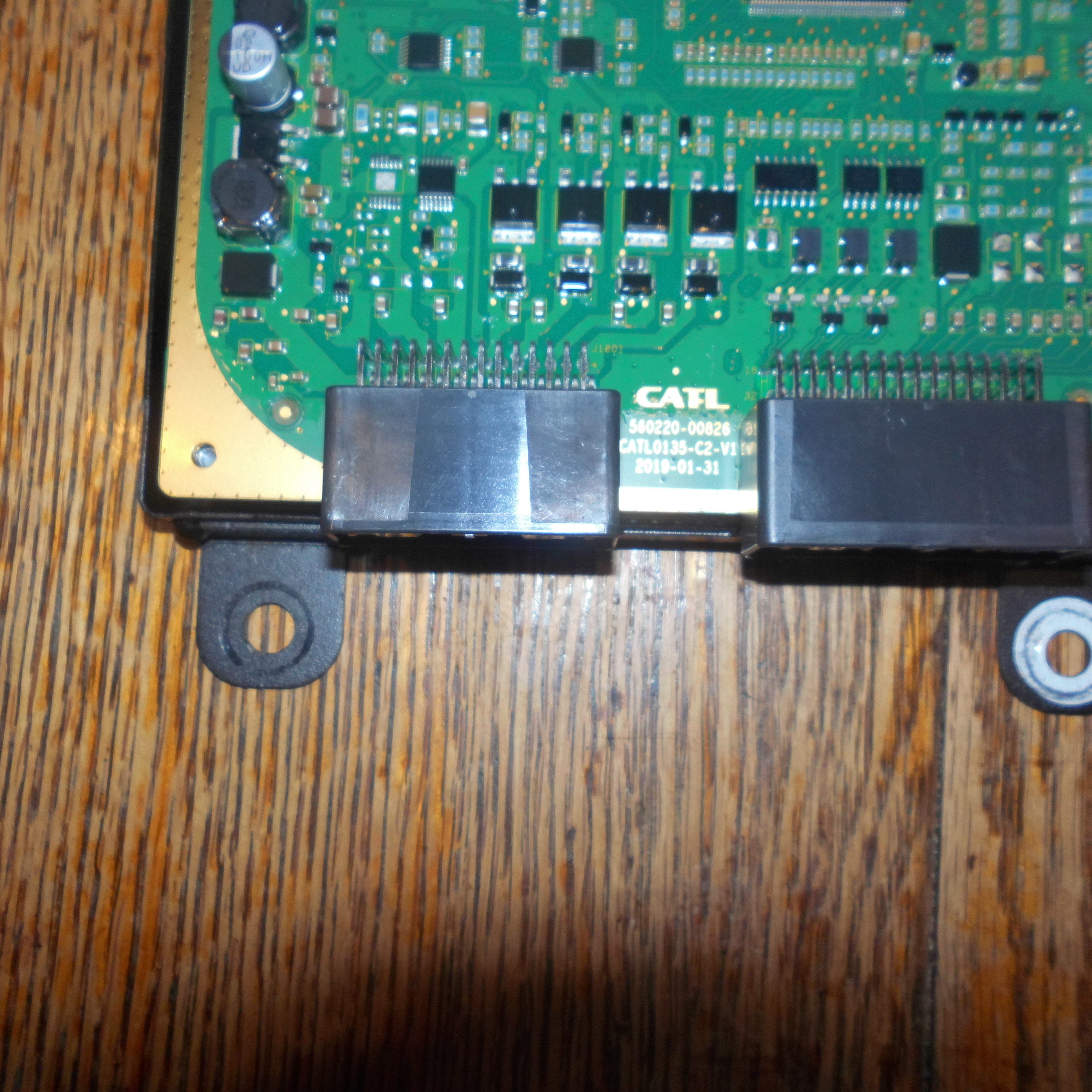

Hi Yasko, hi Tom. Thank you for your replies. Yes the board over the cells appears to be same/similar to the illistration you provide. See mine below. I have the complete battery pack with all modules and the wiring loom. The daisy chain terminates at what I assume to be the main battery control module. I have removed the cover. The main chip conveniently is marked with black text on black so I can't get a picture, no contrast. I have copied the marks as follows.
INFINEON. TRICORE
SAKTC 275TP/64F200 (WCA I think)
hard to read last line Infineon 14 84 62018.

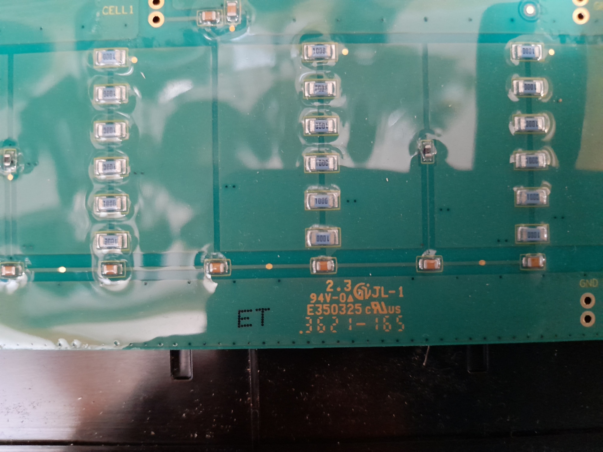

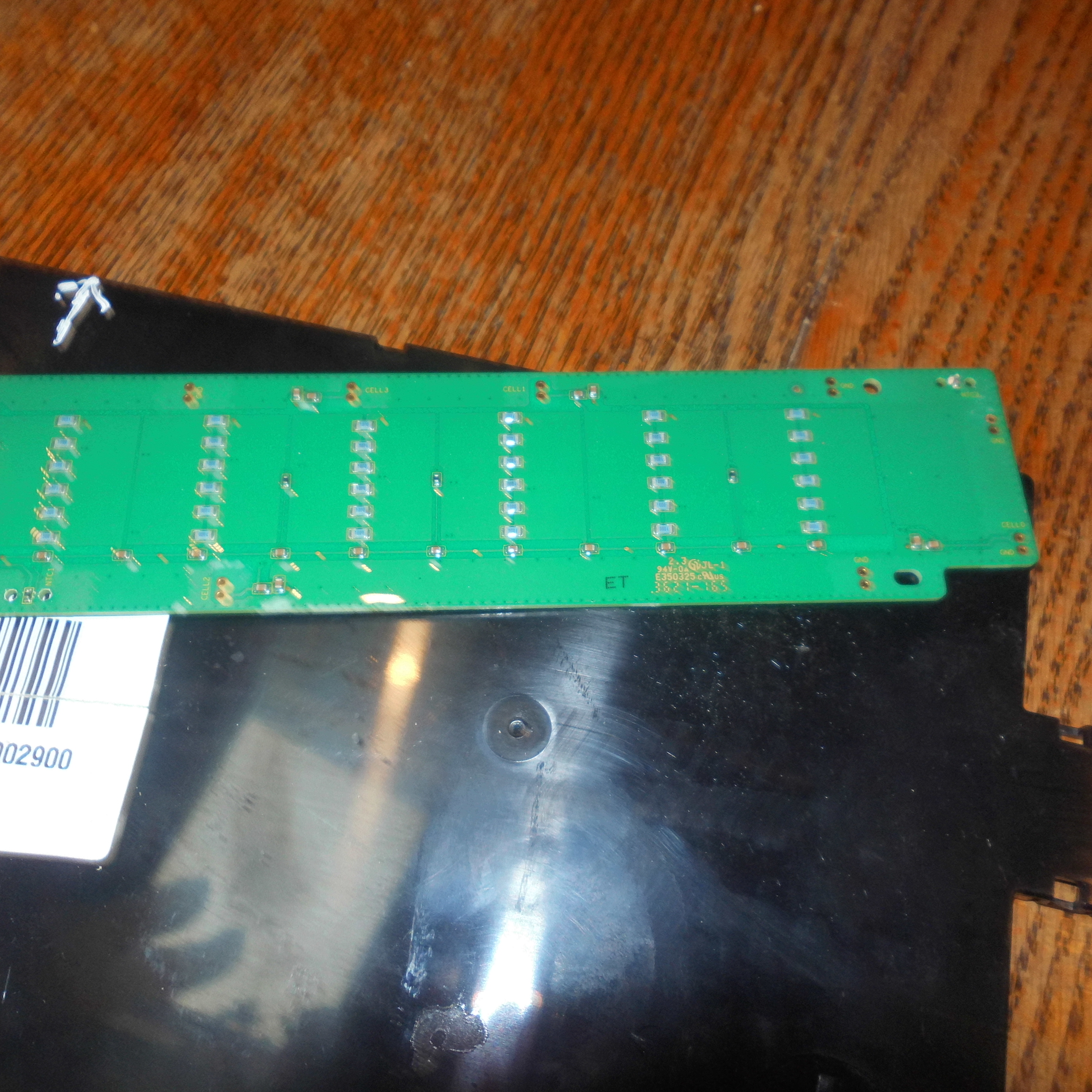

We want to IC markings on the module boards not the main controller.
uhi22
Posts: 1244
Location: Ingolstadt/Germany
Has thanked: 245 times
Been thanked: 684 times
Re: Peugeot E-Boxer NMC cells reuse modules.
Post by uhi22 »
These ones:

I'll try again but by eye, these 3 items appear to have no markings visible. They are coated with a varnish like treatment which renders them opaque. I will try to find some magnification device and come back with any info obtained. Thank you for your interest. Andy

So I thought an update on this project may be called for.

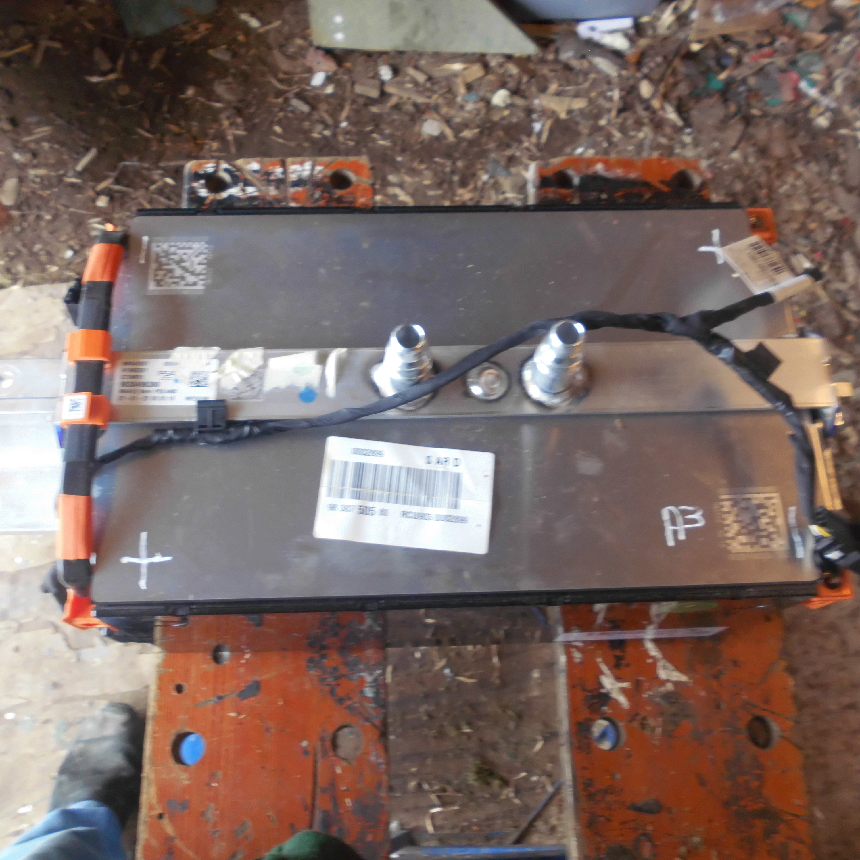

I'm pleased to report that I have commissioned my new off grid power system reusing the battery from a 2022 build Peugot 208e. The battery breaks down to 18 modules, each consisting of 12 NCM cells 2p6s. Nominal voltage is 22V and capacity of each module is 2.77Kwh. In the car, modules are built together in pairs. Each module has an on board managment chip which operates on a cell level, adjusting the charge rate balancing etc, each module also has a communication data 4 wire daisy chain, linking all 18 modules back to the main BMS. Alarm and temp data can also ultimatley turn off the main battery contactors. Because the on car bms is configured for 400V battery I had to source an alternative. I found a small manufacturer in Holland and after a couple of hiccups have the BMS in place and the parameters set for my requirments. Thank you Walter for your patience.
So I have built my battery by keeping modules in pairs giving a nominal voltage off 44V, theoretical max V 50.4 and min 39V. I have made sets of 3 in parallel to a bus bar which then links to the main 1000amp bus bar. I discovered that these battery voltage set points can be used with the Victron multiplus.II so I have a new 10000/140 unit on my power house wall alongside the battery bank.
andyoffgrid
Posts: 13
Joined: Sat Mar 09, 2024 9:46 am
Post by andyoffgrid »
]I removed the pairs of modules from the water cooling system. I then rebuilt the pairs. I used a piece of 3mm steel plate, placed between each pair of modules then used the plastic material supplied on each side of the plate. then I bolted the pairs of modules back together using 6mm stainless steel threaded rod with captive nuts and tightned the pair of modules together. Make sense?
The dimension of my pairs of modules as reassembled is 390mm long X 225mm wide X 153 mm high. I have 3 pairs of modules on each shelf. Although the shelving is chipboard each set of 3 pairs is in fact sitting on a section of corrugated steel so not in direct contact with the wood. The steel plate can dissipate heat therefore.
I have a 250amp main fuse in the system and never discharge more than 5Kw, normally less than 1Kw. I charge from the genny at a max of 5Kw. I have now got around 8Kw of PV panels, all on controllers and the wind turbine is capped at 3 Kw so I am not stressing the system. I discharge to 41V and charge up to 48V.
My battery as built, is inside a heated insulated wooden cabinet. There is a 60w electric tube heater at the bottom (on a stat set for 5@C. The generator is just outside the power house and I get some heat come through when the genny is running.
I managed to re use the original data daisy chain but due to the modules being spread out I had to make up some extension pieces. Watch out if you do this as it is easy to get the wires reversed. I have the wiring diagram on file.
I re used the contactors from the car battery (there are 4) and have one on the main battery positive and one on the negative so if the contactor trips the battery is totally isolated. Note I have not used any crocodile clips.
