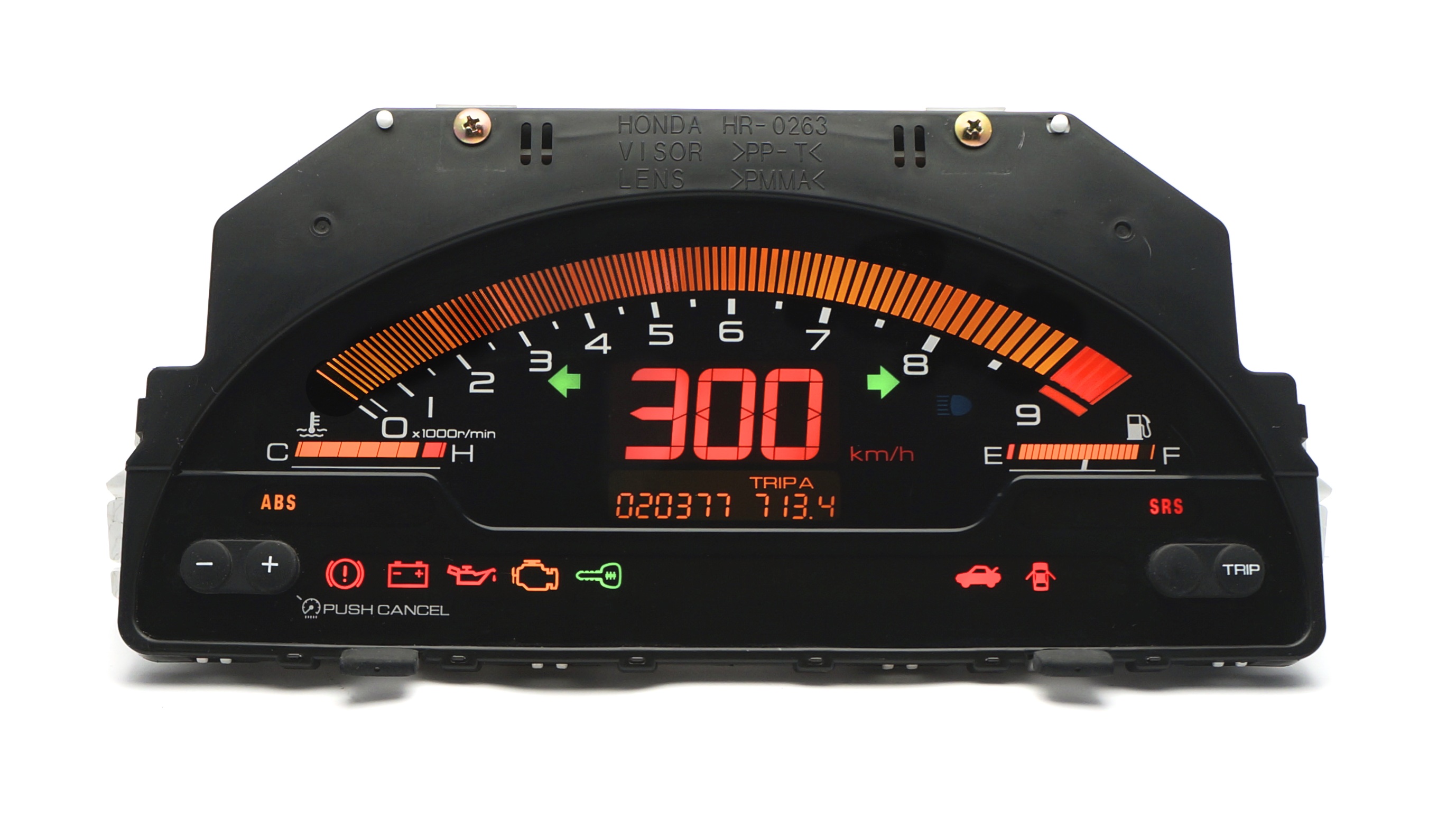

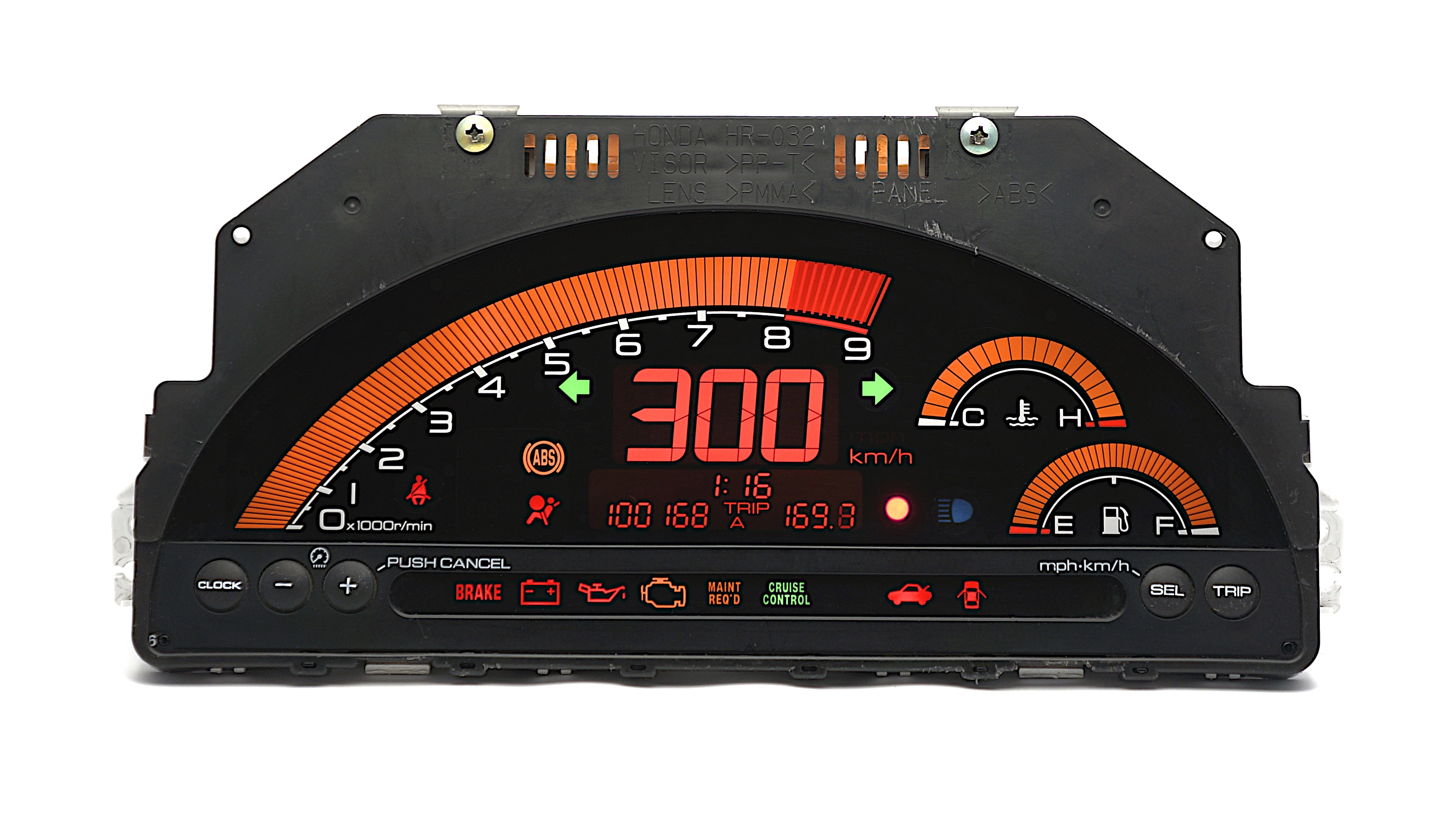

I’m at the point of integrating the Tesla SDU with the Honda S2000 electronics, specifically the dash cluster.
I’d like to display speed (of course), amperage (on the tachometer), state of charge (fuel gauge) etc.

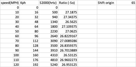

First step is converting the OpenInverter's RPM output to the S2000's Vehicle Speed Sensor. I haven't looked at what signal the OpenInverter board outputs but I expect it's a square wave based on the trigger wheel in the SDU (happy to be corrected).
The S2000 dash cluster accepts a square wave signal and counts the frequency. Surprisingly it doesn't seem to use a 0 origin but has an offset for about 100hz

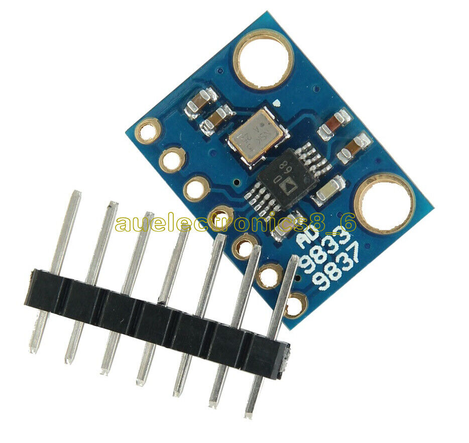

So I assume the task is to read one frequency and convert to another. I'm looking at an Arduino board to do the conversion. And I have seen boards like the AD9833 to generate an output frequency.
Not sure how to read the input at this point.

I've got the output side of the project working:
About to start work on the input (Canbus) side.

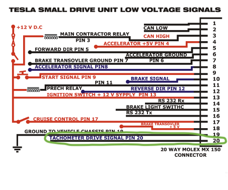

But anyone know what this is?

EVS2K wrote: Tue Apr 30, 2024 3:30 am But anyone know what this is?
It was never brought out to this pin. But it's not very useful anyway since it runs at a fixed frequency and variable duty cycle.
