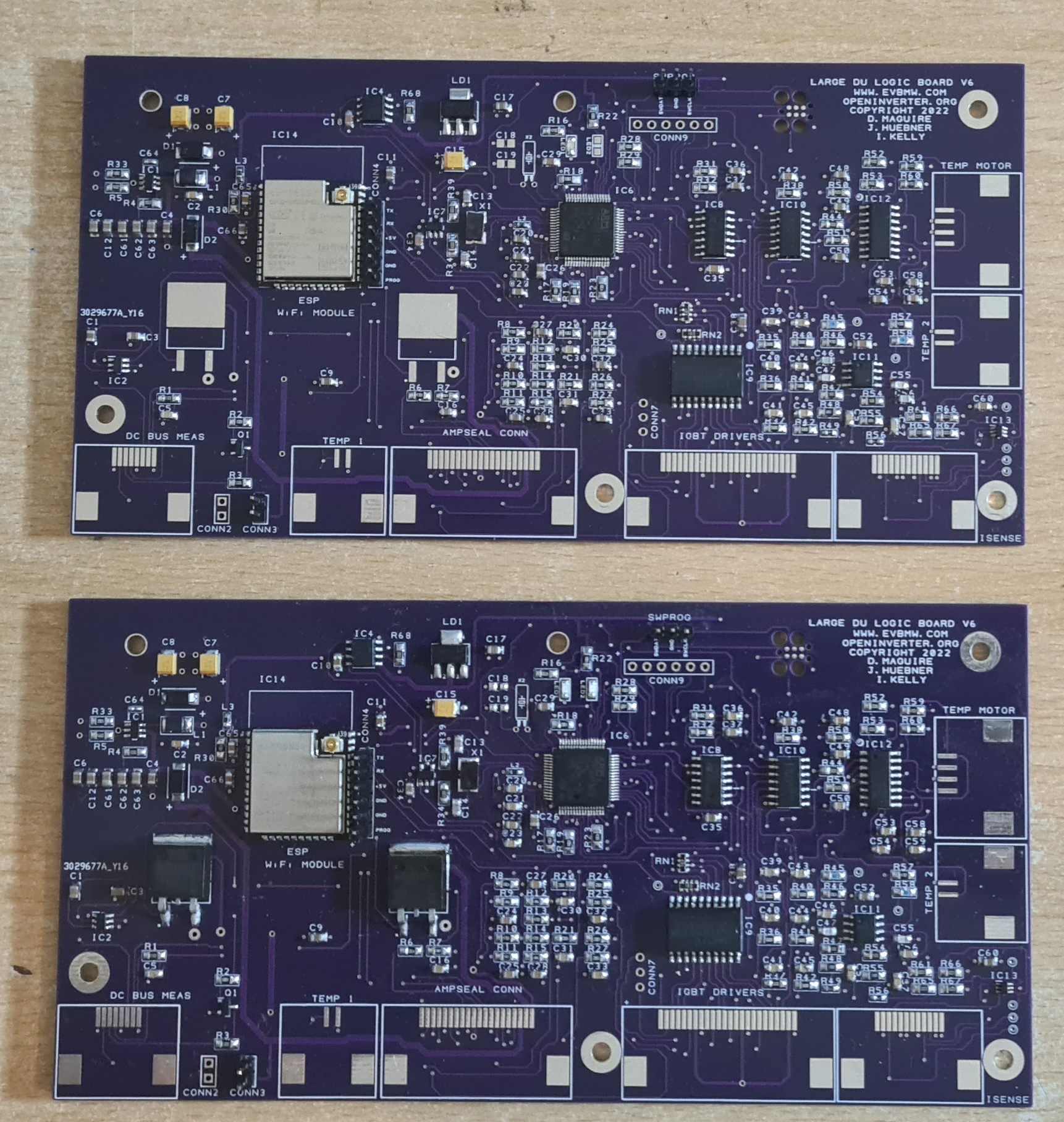

what am I doing wrong ??? ESP32 flashing
- Posts: 168
- Joined: Thu Dec 07, 2023 9:32 pm
- Location: Kosova
- Been thanked: 3 times

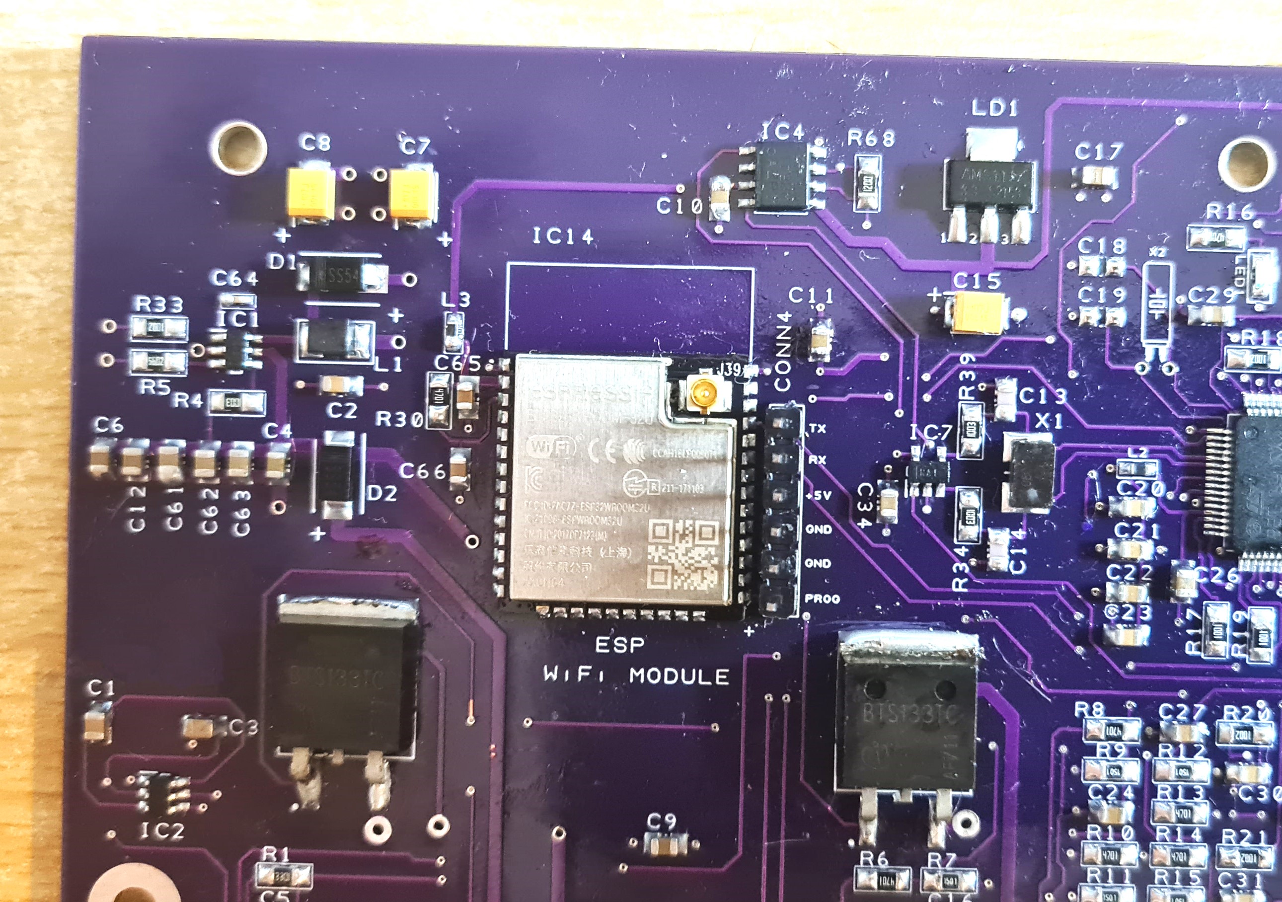

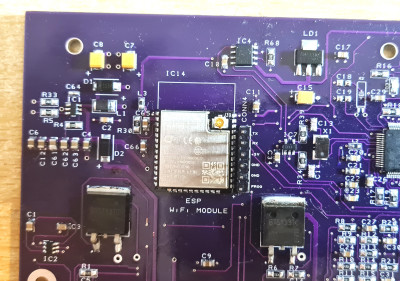

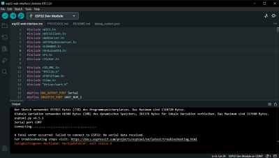

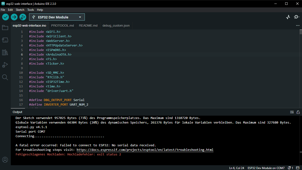

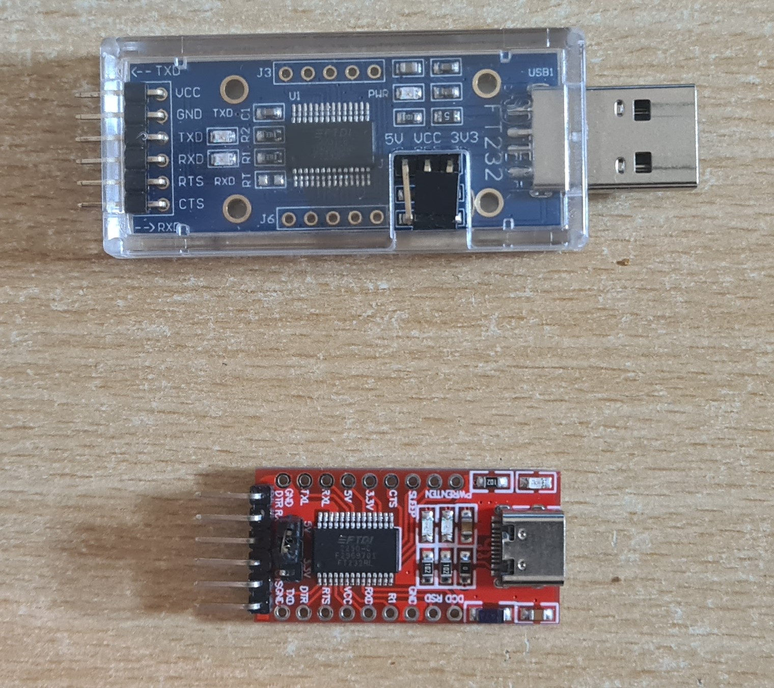

Hello, I soldered the V6 together myself just to learn, but I just can't flash the ESP32, TX to TX and RX to RX are connected, I also tested 2 different programmers, but nothing, what am I doing wrong ??? I also soldered 2 because I suspected I was using the wrong components, but same with the same result
- Posts: 6746
- Has thanked: 380 times
- Been thanked: 1570 times
Re: what am I doing wrong ??? ESP32 flashing
You need a jumper across PROG and GND. Also the STM32 mustn't be programmed or must be held in reset. Otherwise it blocks the uart

I measured the pins and got values like this,
3V3 Pin 3.281
EN Pin 3.280
IO0 Pin 3.180
TX Pin 3.68
RX Pin 0.0
5V Pin 5.3
The values are the same for both PCB´s
is that Ok ??

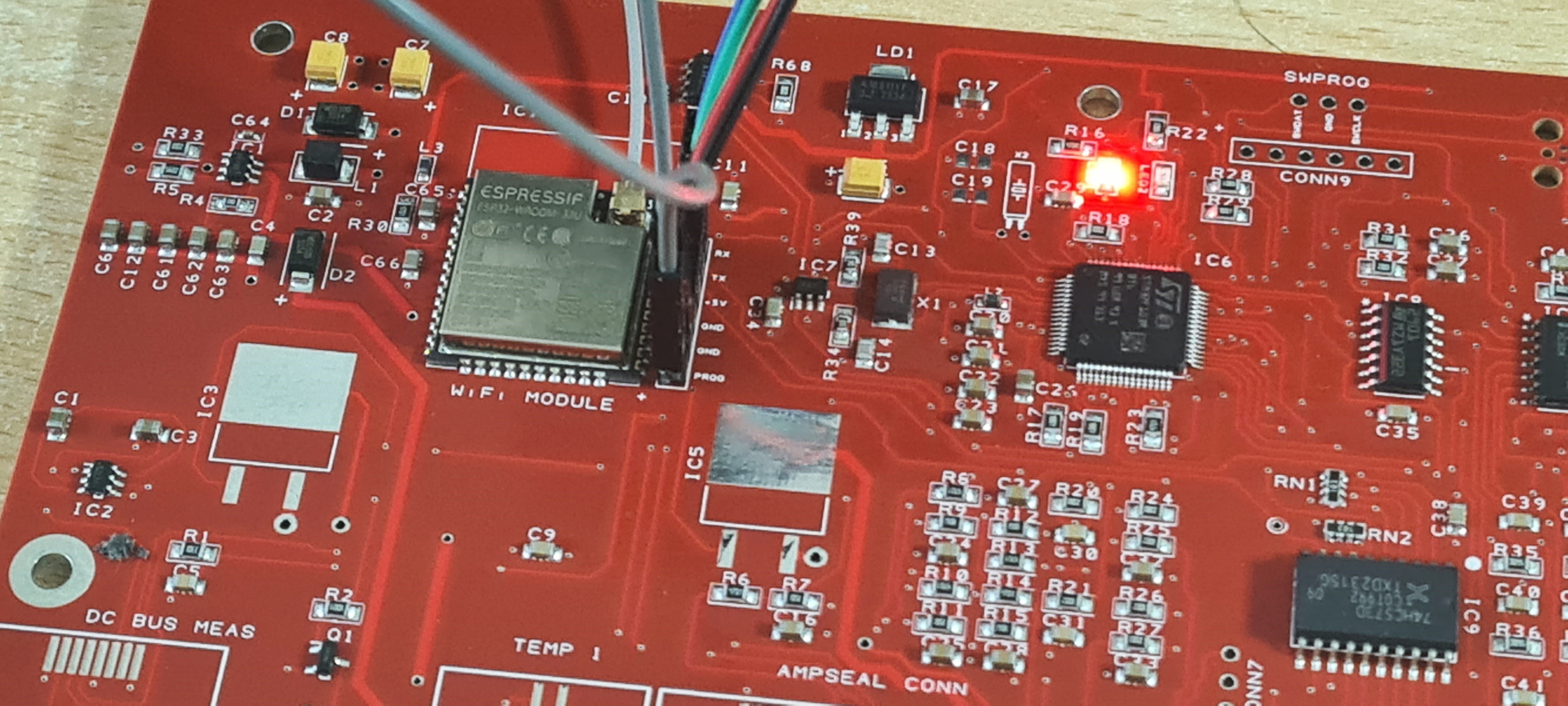

yes, my mistake, IO0 is 0.08v, but TX has 3.6v no matter whether with jumper or without jumper
I took further measurements
on a bare board with no components, Rx has GND that goes to pin PB11 on the STM32

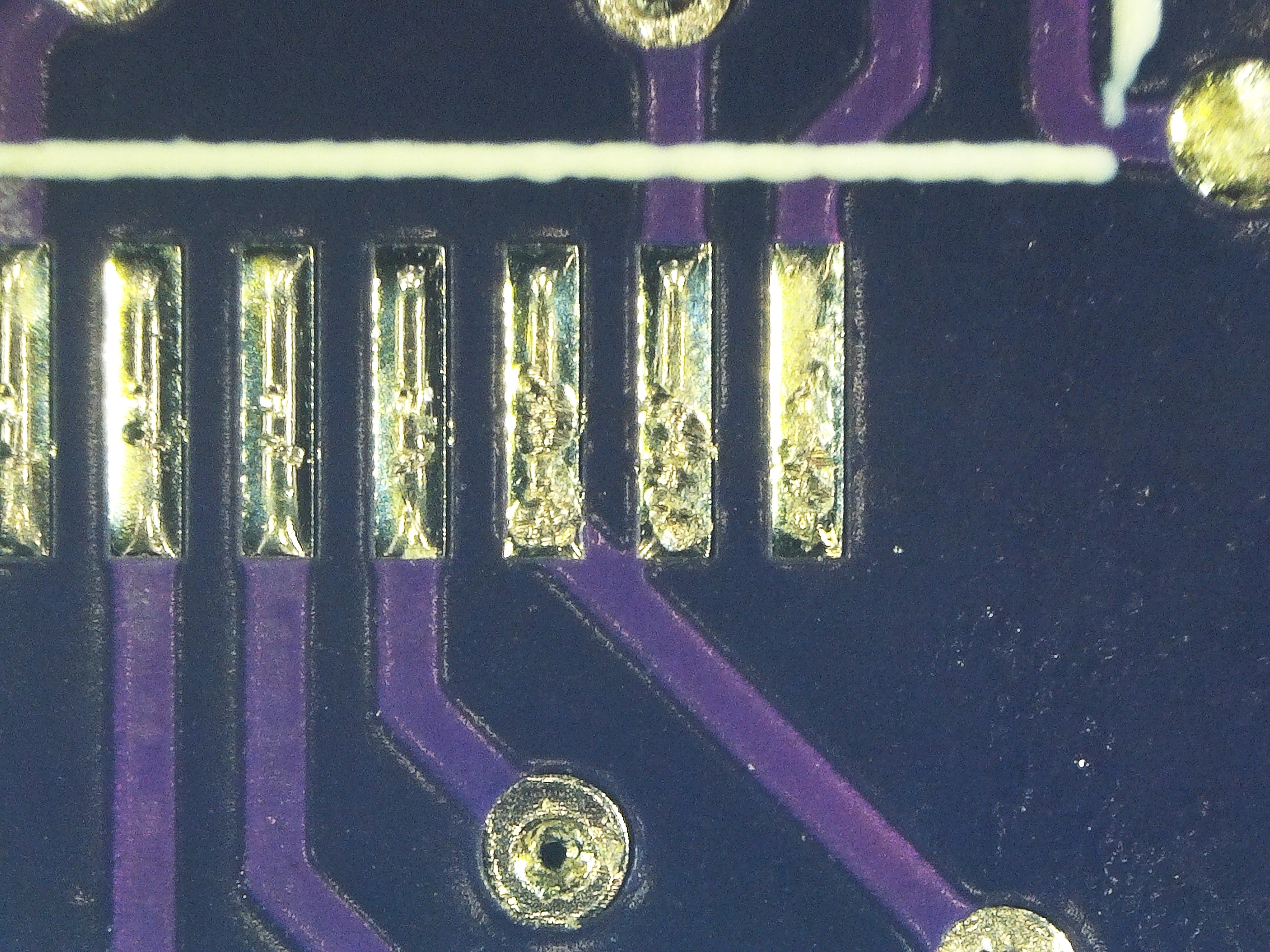

I found something, there is a bridge between the TX and RX pins on IC6, now I can flash the chip, but I don't see any WiFi
- Posts: 6746
oh that's evil routing. So jumper is removed, IO0=3.3V and no wifi?

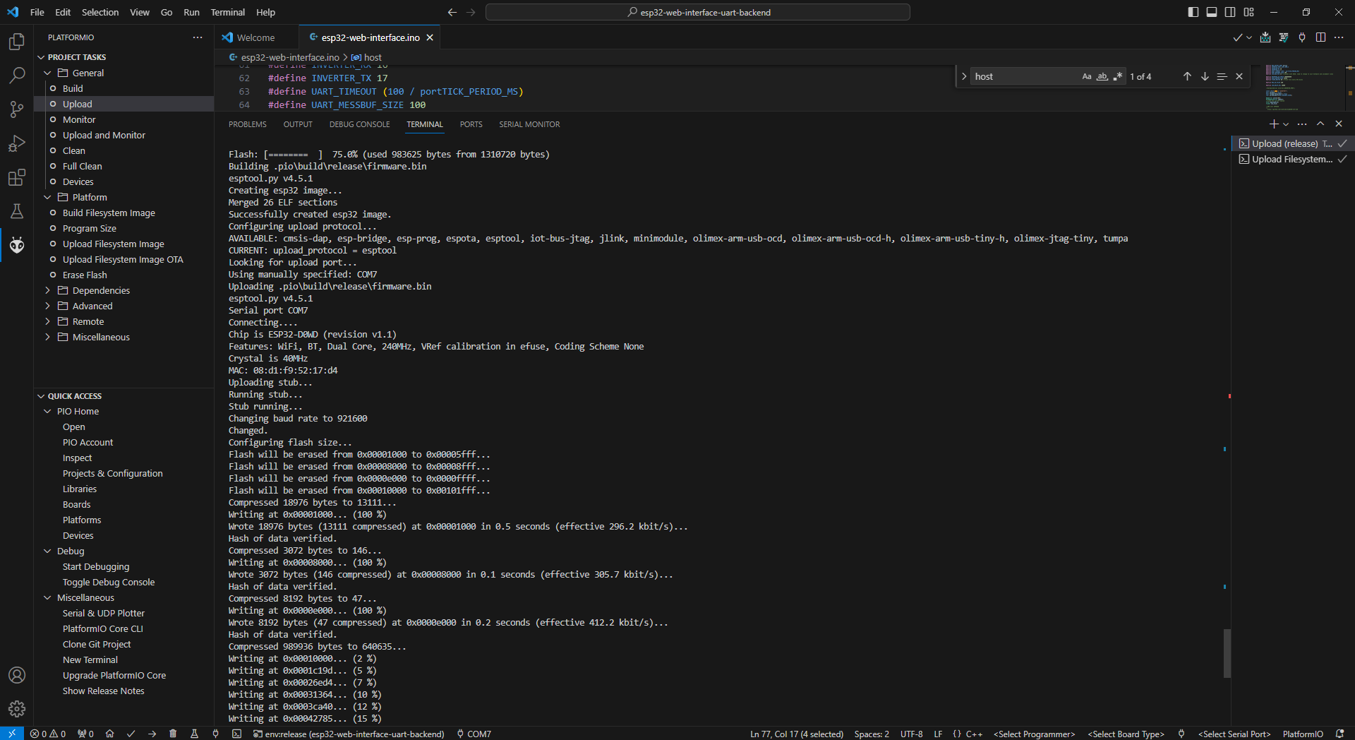

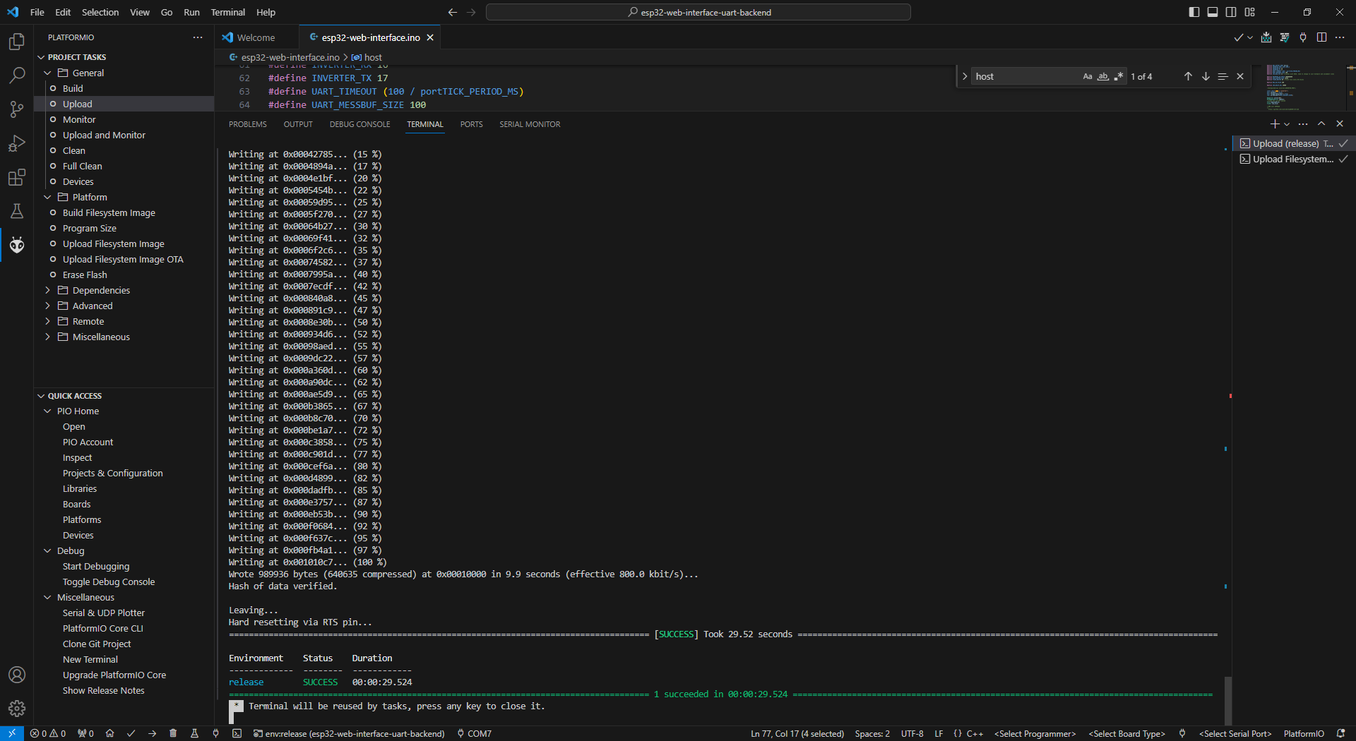

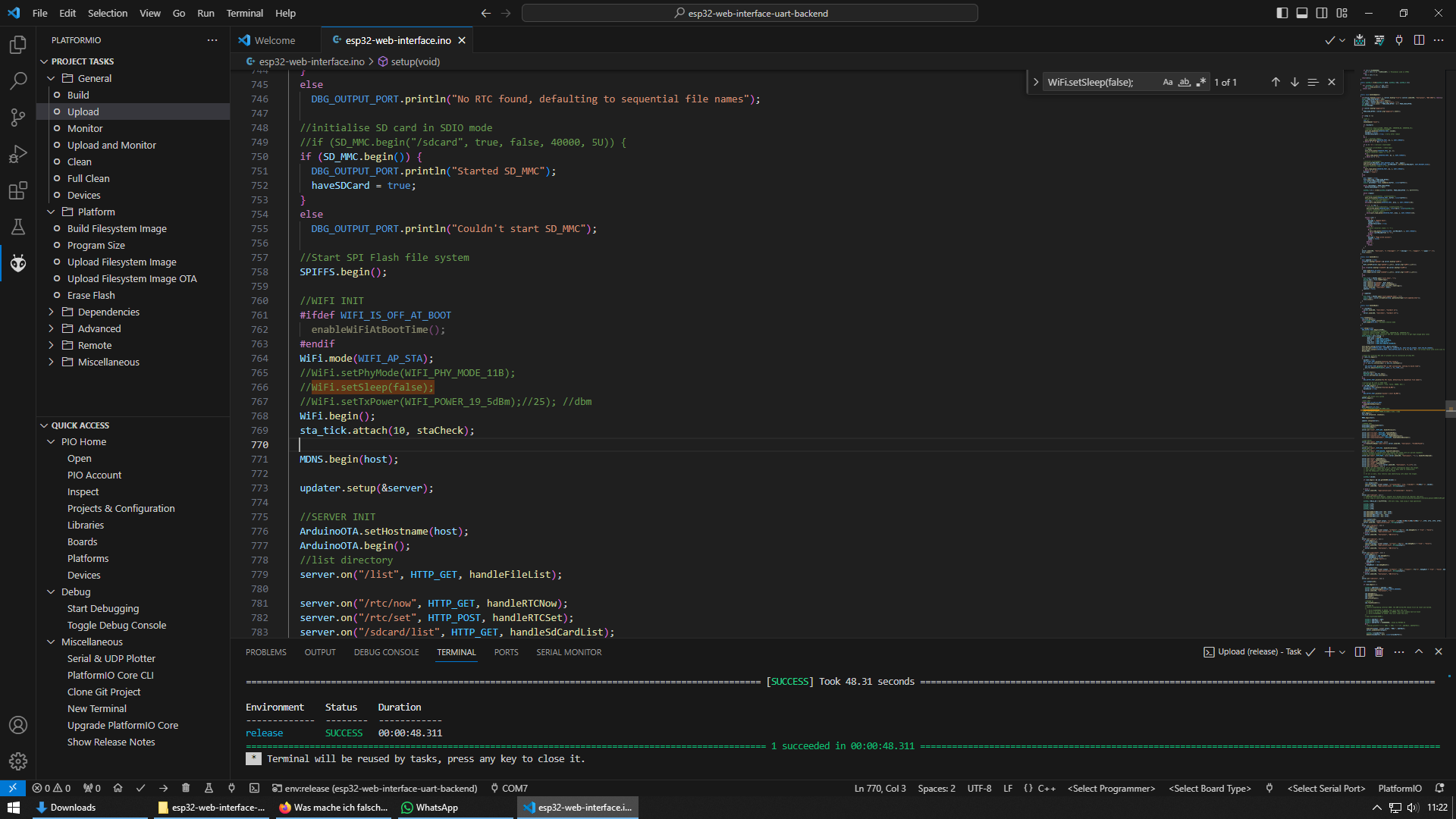

Hi, the module wasn't defective after all, now the wifi is also displayed, but I can only call up the wifi setting, it doesn't find all other files like index.html, I used the following, what could be the reason, and uploaded them I use platformio
The only thing I changed is the IP address, from to i used this repo, https://github.com/Bedz01/esp32-web-interface-port

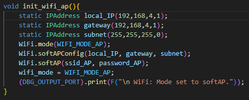

one difference between the two firmwares are these lines
WiFi.setSleep(false);
WiFi.setTxPower(WIFI_POWER_19_5dBm);//25); //dbm
Try removing them. Don't know why it should work on one module but not on another but you have to start digging somewhere

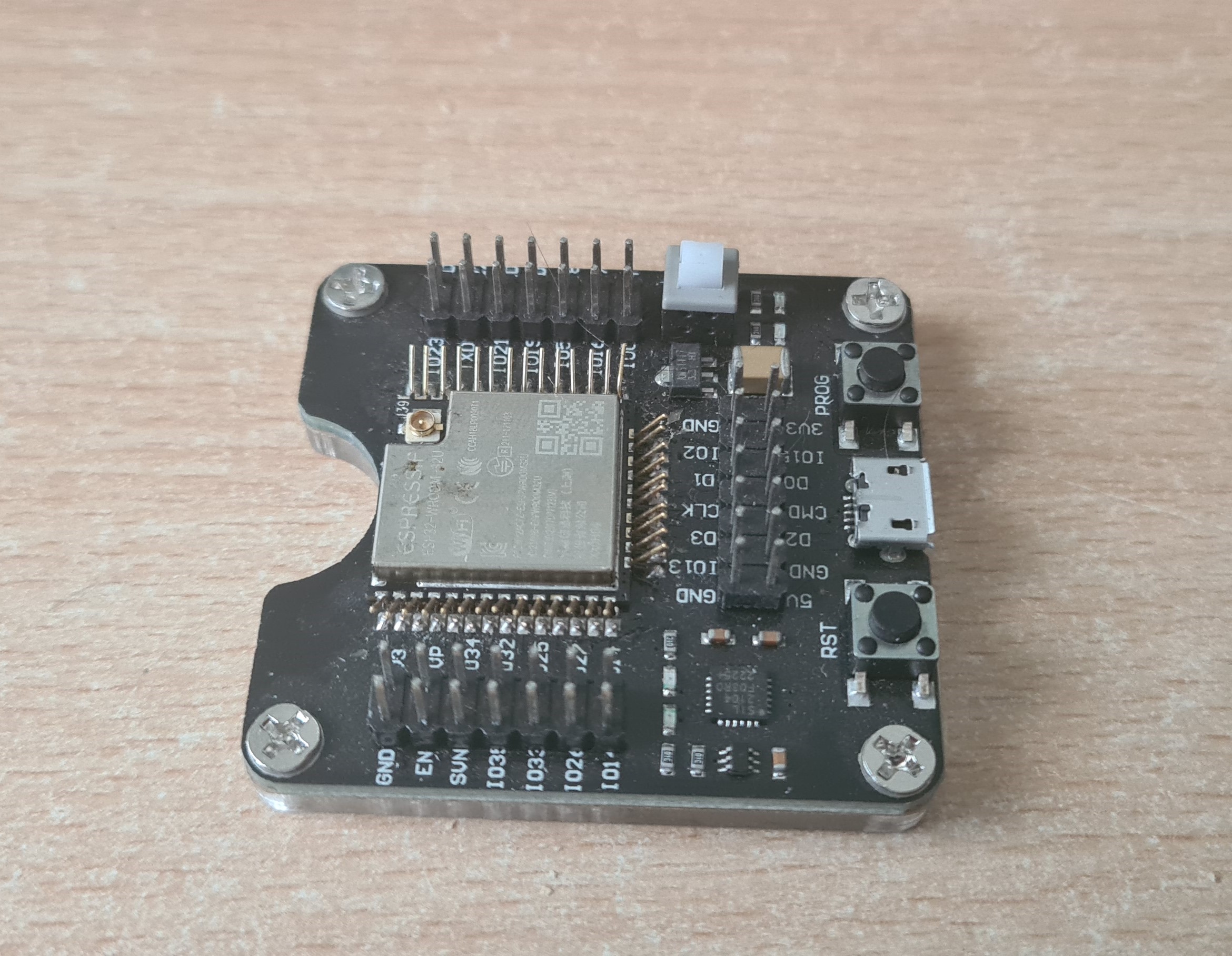

i have testit on a programmer, but the same

What does the console output tell?
