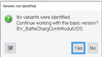

Ok have some sort of communication with ODIS. However it doesn't recognise it as a known variant.
With this my Mongoose is sending the following can ids:
The charger then replies with the usual can ids as above. This is on the hybrid can. Charger doesn't go to sleep with these IDs sending.

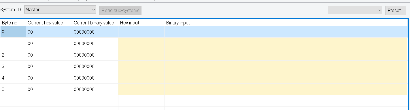

You could try to read the coding data with uds service hex 22 06 00. Does the ODIS show the coding data and maybe parametrization date? Does it show identification data like part number, software version?

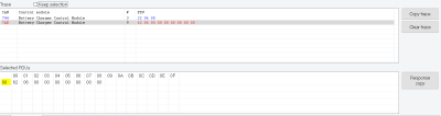

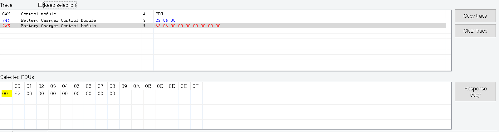

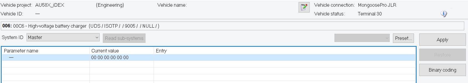

I think I managed to figure out sending that in ODIS, here is the response. I can't get much from ODIS at all, it can connect and pull some data, but nothing like coding parameters etc.

Re: 11KW MEB charger group hack
This means: the response of the "read coding 22 0600" is 6 bytes with value zero. Nothing coded. We either need a description, which is the meaning of each coding byte, or to read out a correctly coded unit, or, in worst case, just write random bits and see what happens.
Writing of the coding should be possible with "write data by identifier", in this case 2E 06 00 112233445566. Most likely needs some preconditions like extended session, security access and writing the workshop code.

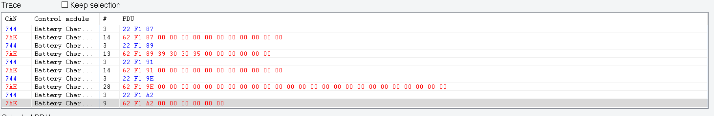

To find out what we are talking about, it could help to read some identification data from the unit,
22 F187: spare part number
22 F189: software version number
22 F191: spare part number of the hardware
22 F19E: identification for the diagnostic data base
22 F1A2: the version of the above
22 F1A3: hardware version number

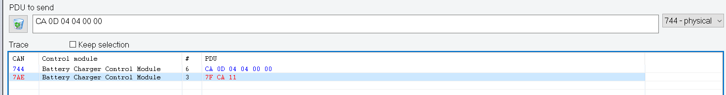

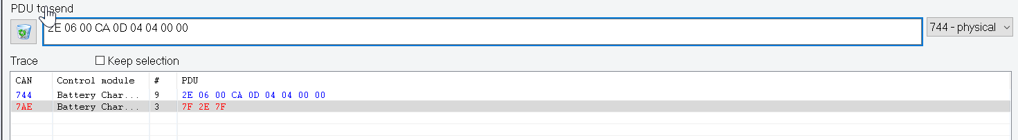

I also sent out the hex to change single phase charging to 32AMP and got the following reply

Re: 11KW MLBevo charger group hack 5QE915684BJ possible
Funny. These responses are definitely not from an official control unit of the VW group. Because: Sending "empty" responses for the basic identification data is a no-go. They normally spending a lot of effort to get each of these responses correctly filled, and if the service would not be supported, the control unit would need to send a negative response. But here we see positive responses, with just zero bytes. This looks like the manufacturer just took a VW group software, kicked out some content, but did not care for the now "unused" diagnostic services. With the data what we see, also ODIS/PIWIS I guess have no chance to see anything.
Regarding writing the coding string: You got a negative response. 7F means "negative response", for service "CA", with the negative response code 0x11, which is "Service not supported" (a list is available e.g. here: https://piembsystech.com/negative-respo ... -protocol/) This is normal, because the request was not like intended. The "CA 0D 04 04 00 00" is the coding data itself. To write it to the control unit, we need to use the command "write data by identifier", which is 2E, followed by the identifier for coding, which is usually 0600. So the complete PDU for writing the coding would be
2E 06 00 CA 0D 04 04 00 00
This normally (in the VW world) would return a negative response code like "service not supported in active session" or "security access denied" or "request sequence error". Let's see, what they kept from the original software...
[Edit] At least the software version is reported as 39 30 30 35, which is "9005".

Also after further messing around with ODIS I can send code strings to the charger on the usual coding window data in here will successfully be coded to the charger, well it looks like it works at least. However it is different to the other MLBevo chargers as we have previous seen in that it uses 6 bytes and not 8. So I cant send the same coding line as per the other threads.

And if you write any coding data, does it show up when you afterwards read it back using 22 06 00? Also after power-cycle? This would be a good sign, that the charger accepts and stores the coding data.
[Edit] The 7F 2E 7F means "negative response, the service writeDataByIdentifier is not supported in active session". This perfectly makes sense, because normally at least the extended session is needed to write anything. When coding via the normal ODIS way, the ODIS cares for the session (and tester present), so even better.

Unfortunately not, seems to read blank again after coding.

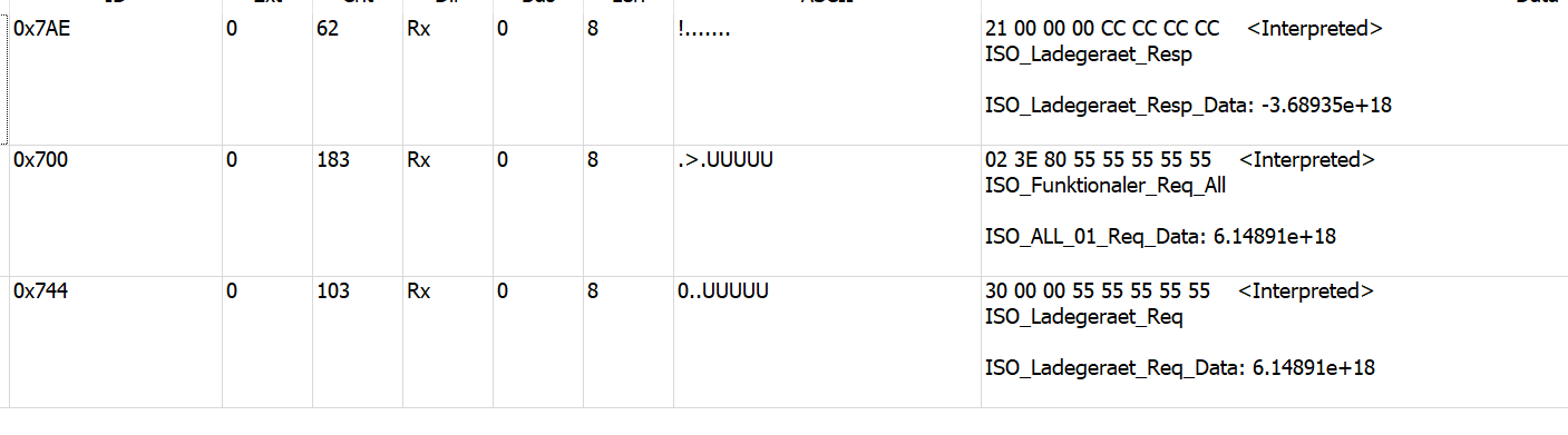

Maybe the ODIS does not even correctly write anything. A CAN log of the coding activities would be nice.
And maybe also the coding identifier (22 0600) is also only a "dummy" like the others, and the "real coding" is done on a completely different way.

Attached is a canlog of the coding process.
