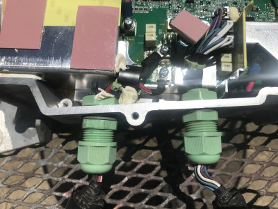

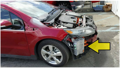

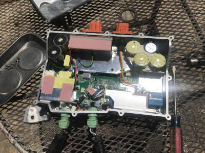

we ask how would one go about increasing the output voltage of the first gen Chevy Volt charger, from 420 VDC to 460 VDC ? tell me what do I need to solder unsolder etc, ha ha.

I'm not aware of any upper end wiggle room on these units. If you're trying to up the voltage on a pack that is being undercharged due to cell count, you could split the pack in half and charge each half? Some folks use two of these chargers in tandem.
