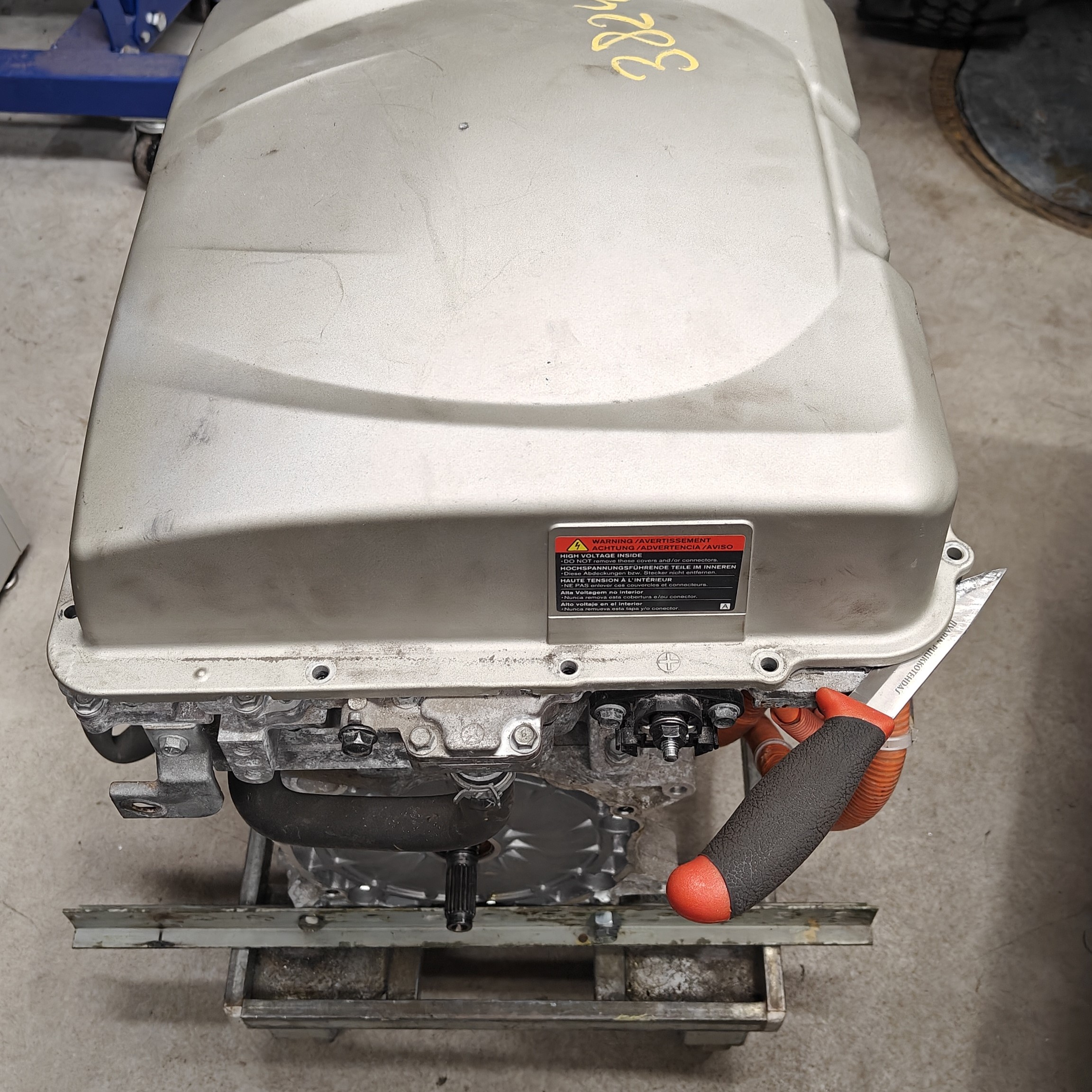

I cracked open the PDM to remove the AC comp cable. A nice tool to use in the opening is a cheap knife
Later I read from the Leaf SM that you shouldn't use a metal tool to scrape the sealant as it can (will) cause shavings that can enter the PDM :o

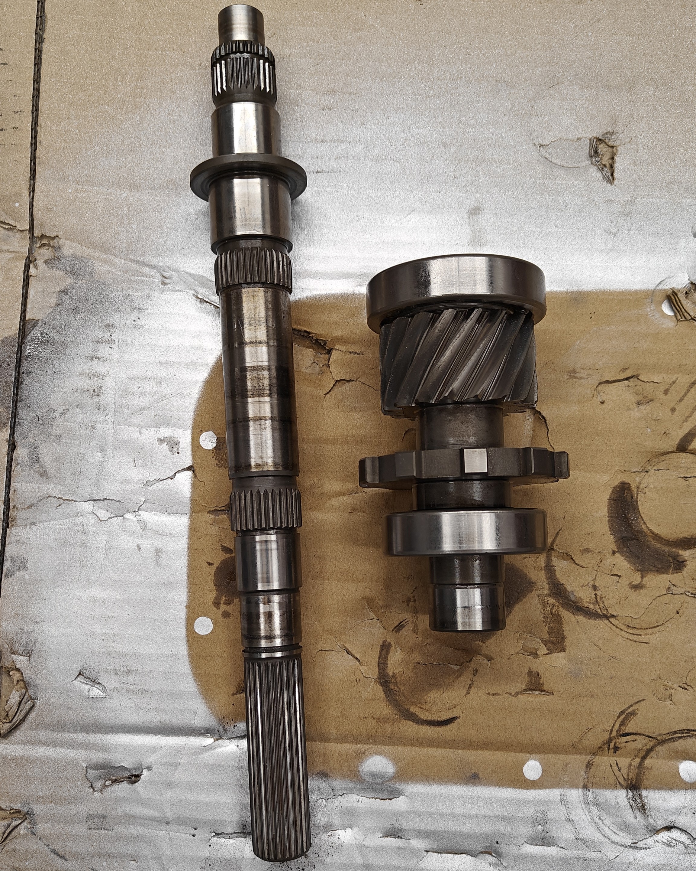

I extracted the Leaf reduction gear input shaft as it is useless for me in any other purpose than adapter building. I had a Suzuki transmission main shaft with the splined output that was the first thing I thought of for the other part of the adapter build.
The other day I remembered that I have laying somewhere in the parts bin this TC input gear that needs a dentist. This should be a more suitable blank to work on as it has the splined driveshaft flange end :)

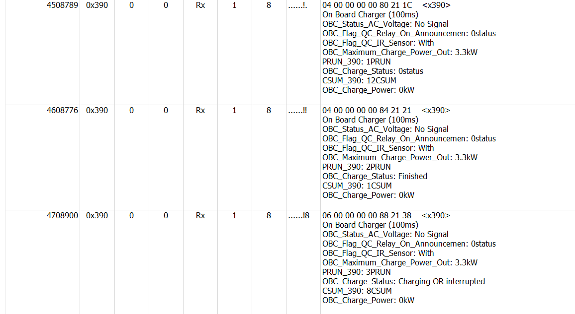

NEW ability unlocked, now I can CANtrace and decode with savvyCAN, this is really cool :D I use the AZE0 DBC by Dala
IF I'm quick, I can get the charger to click but no current. I may have found out the reason for no current, but at the moment don't fully understand what is happening.
The way I read this is that when the OBC wakes up, it's happy to output 3.3kW
This status shift realated to OBC bootup?
Zombie sends a charge power command, before there is AC voltage signal. Is this sensitive to the sequence of events.
Then there is AC status voltage, but nothing changes afterwards
Here's a CANdump of what I'm looking into at the moment. Here I have both the spoofing messages Zombie sends and the actual LeafLBC messages, but to me it looks like the OBC doesn't get upset because of all those LBC messages flying around. Thoughts and input are more than welcome :)
IF there would be a kind someone with a Zombieverter with Leaf stack and slow charging works for comparison a CANdump could be useful :) (of the process of plugging in the charger to a system which is OFF until the EVSE clicks and current flows)

This is still in quite raw shape, but since I have your attention now, maybe I can get some comments on how to make this better.
This is likely a result of my code botching, but something weird is happening when I have the system run mode (T15 active) and shut it off. It seems to want to jump to charge mode, meaning contactors shut off but then immediately it tries to go to charge mode. I have not looked into this properly yet.

There was a divorce this weekend! Didn't weigh the engine and transmission yet, but so far I've removed about 150kg of parts and this doesn't include the exhaust or fuel tank either.
Washed the engine bay, although it wasn't too bad, now at least it's nicer to fit the Leaf drive stack in.

Intermediate driveshaft would be close to 80 cm, I I'm not going to divorce the drivestack
Otherwise it looks that it would fit
Ok, not really...
I was secretly hoping that this would fit, but the PDM really is a chunk
Weighed the Leaf divestack, 104kg
