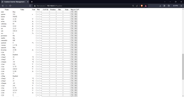

Hello. I cannot recall where this might have been discussed before, so apologies. I have the Gen 2 Charger with the V5 card. I am in the United States using a TYPE 2 setup with 240V input / 60A fuse.
When I plug in the charger all 3 banks light up.
However, on the params I am not showing any readings on C3, so I assume I am not benefitting from this bank of charges. I am getting around 11A from each of C1 and C2. Orion shows 21-22A. I assume if I can get C3 working I will get another 11A for a total of 33. Would love to get to 48A, but I recall people saying this is not possible with the V5 card.
Parameters
"idclim": 45,
"iaclim": 60,
"idcspnt": 45,
"chargerena": 7,
"udcspnt": 403,
"udclim": 352,
"timelim": -1,
"timedly": 0,
"inputype": 5,
"cancontrol": 0,
"enablepol": 0,
"idckp": 1,
"idcki": 10
I made good solders on the card, so not sure what else to troubleshoot.
Thanks!
Jsimon
