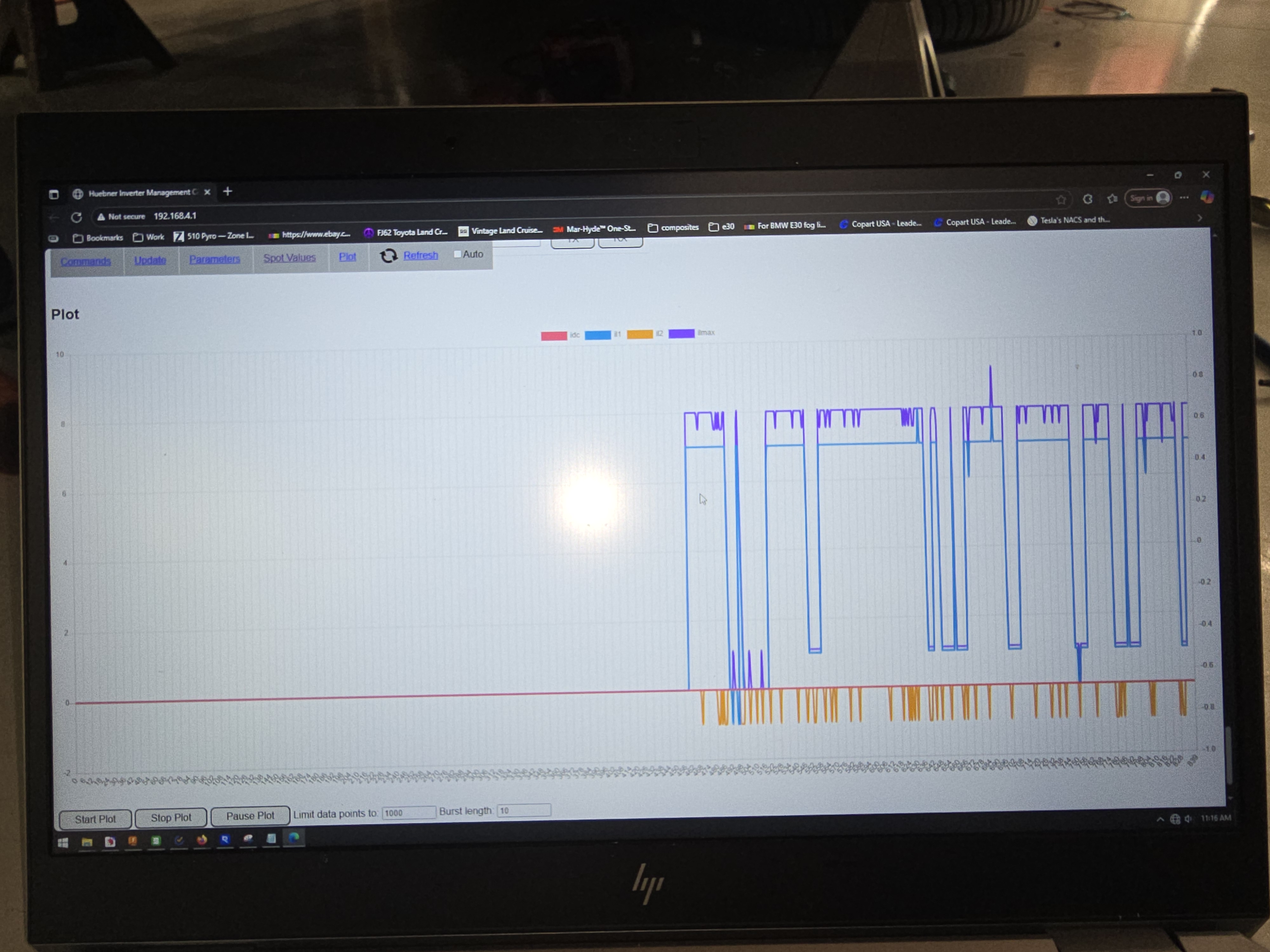

Graphed il1 & il2, il2 was responding to general noise and initial current, but il1 was flat/zero.

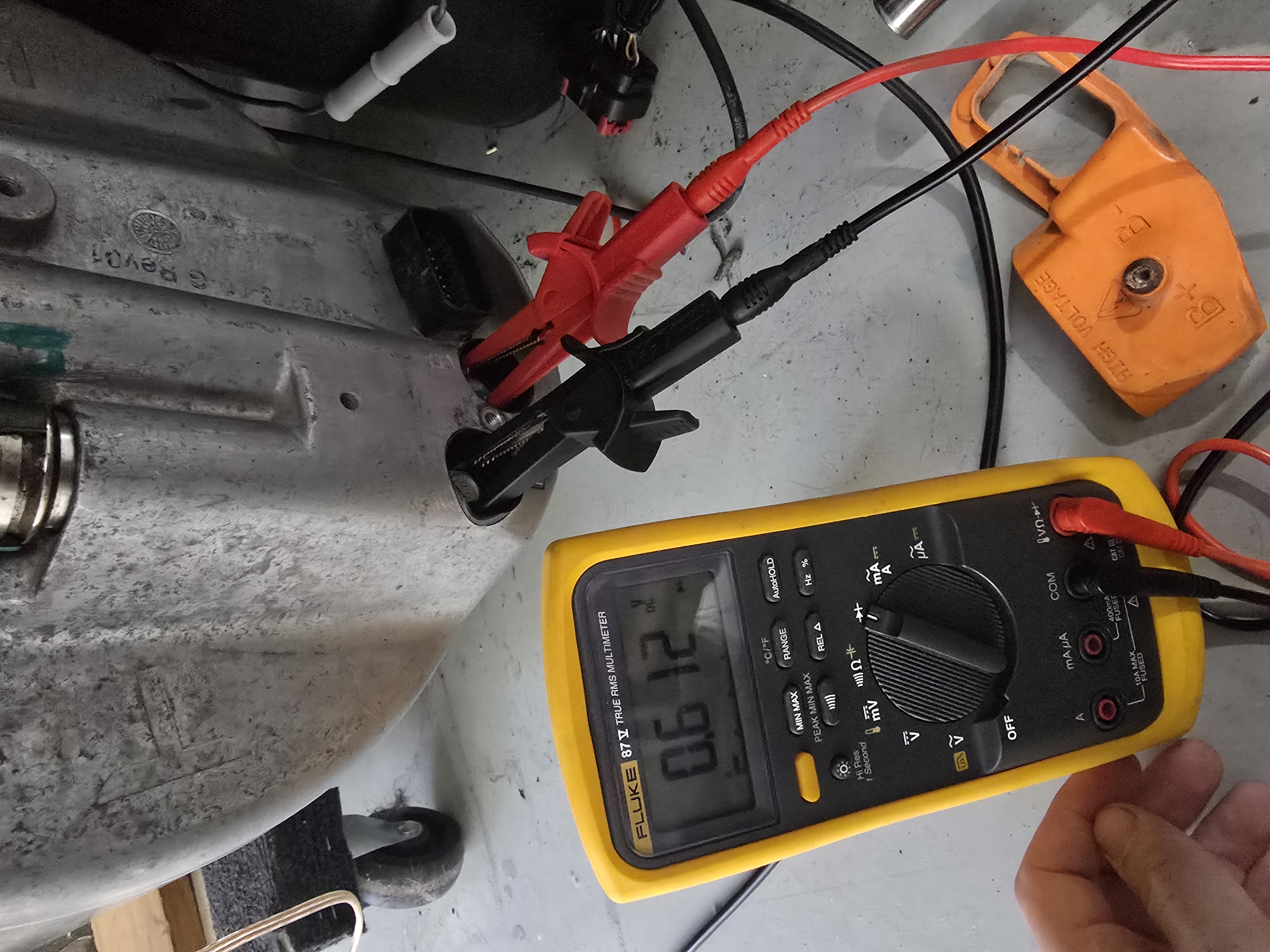

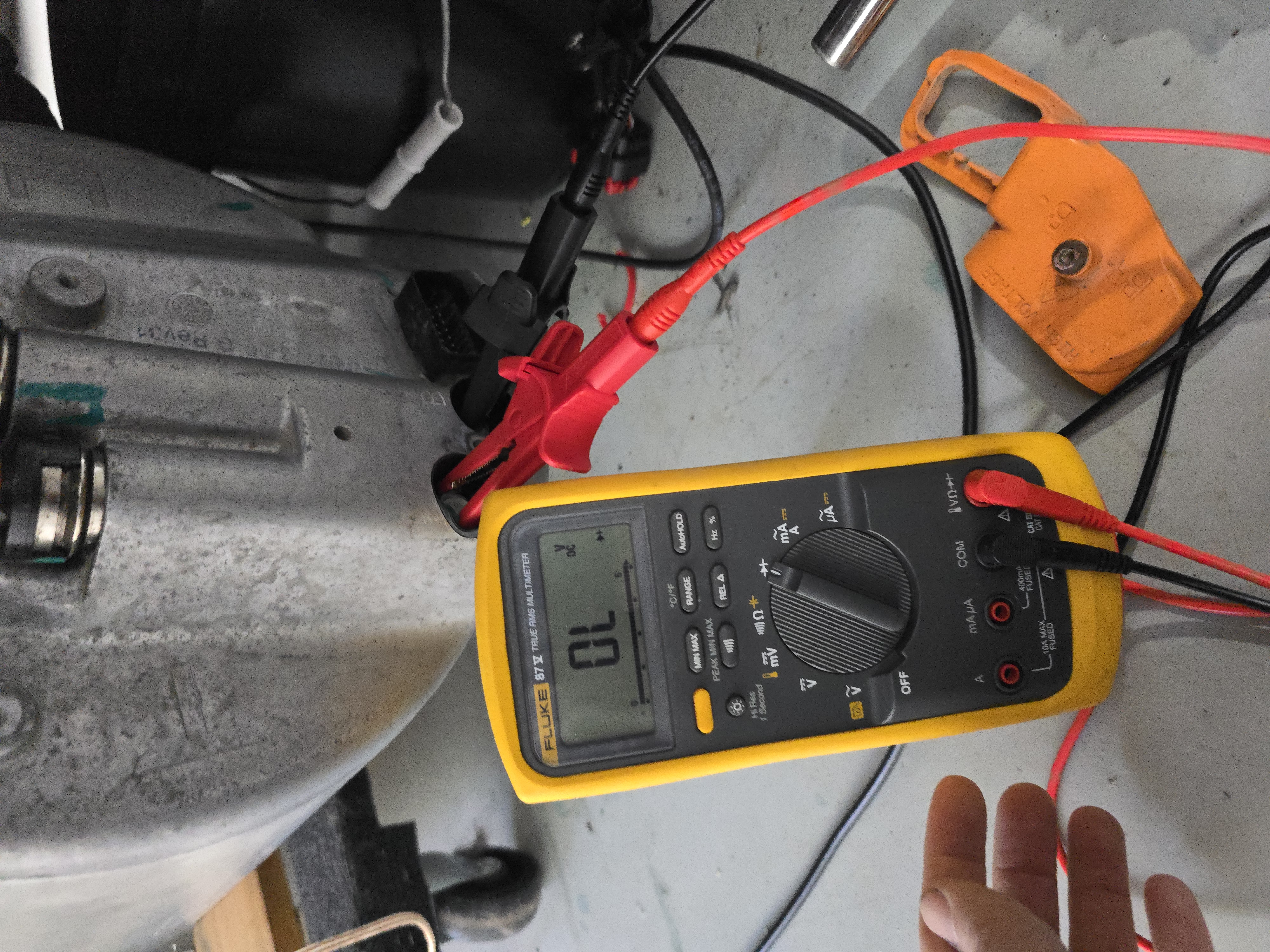

I ran the diode test and both motors test fine, I even confirmed on my bad motor that the test was being done correctly

with HV I see the same thing as OP when I map the IL spot numbers, just noise.
