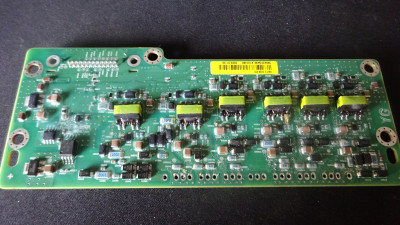

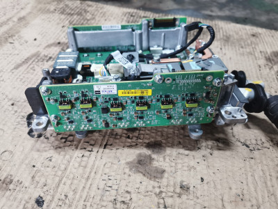

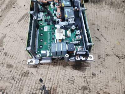

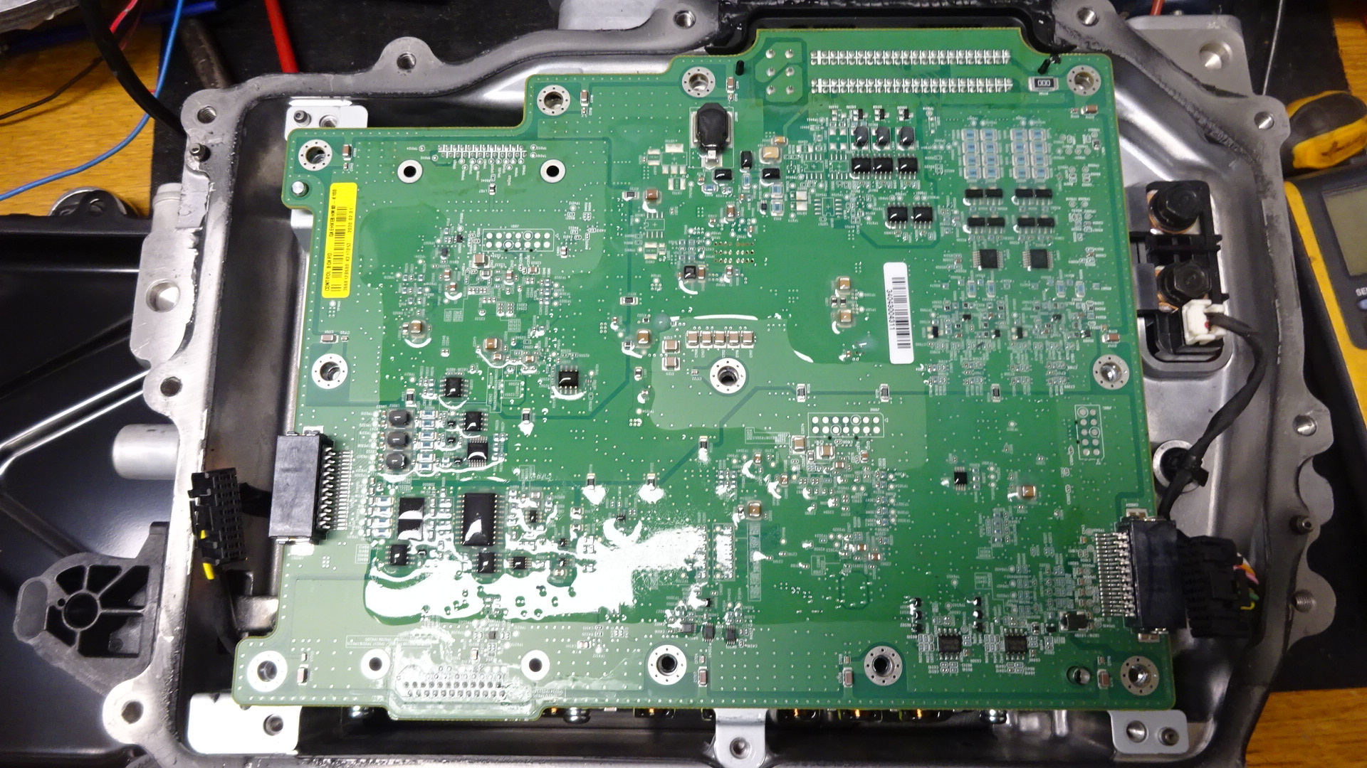

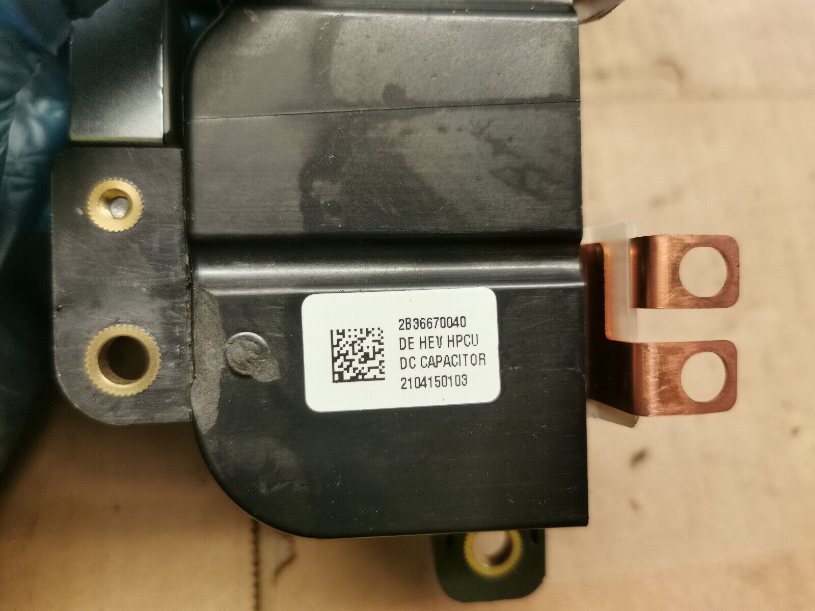

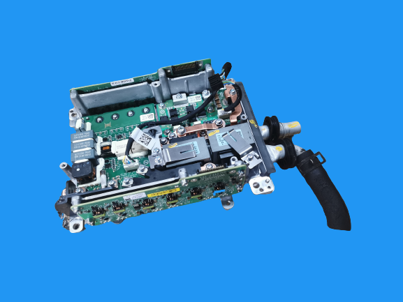

Hyundai / Kia hybrid inverter teardown

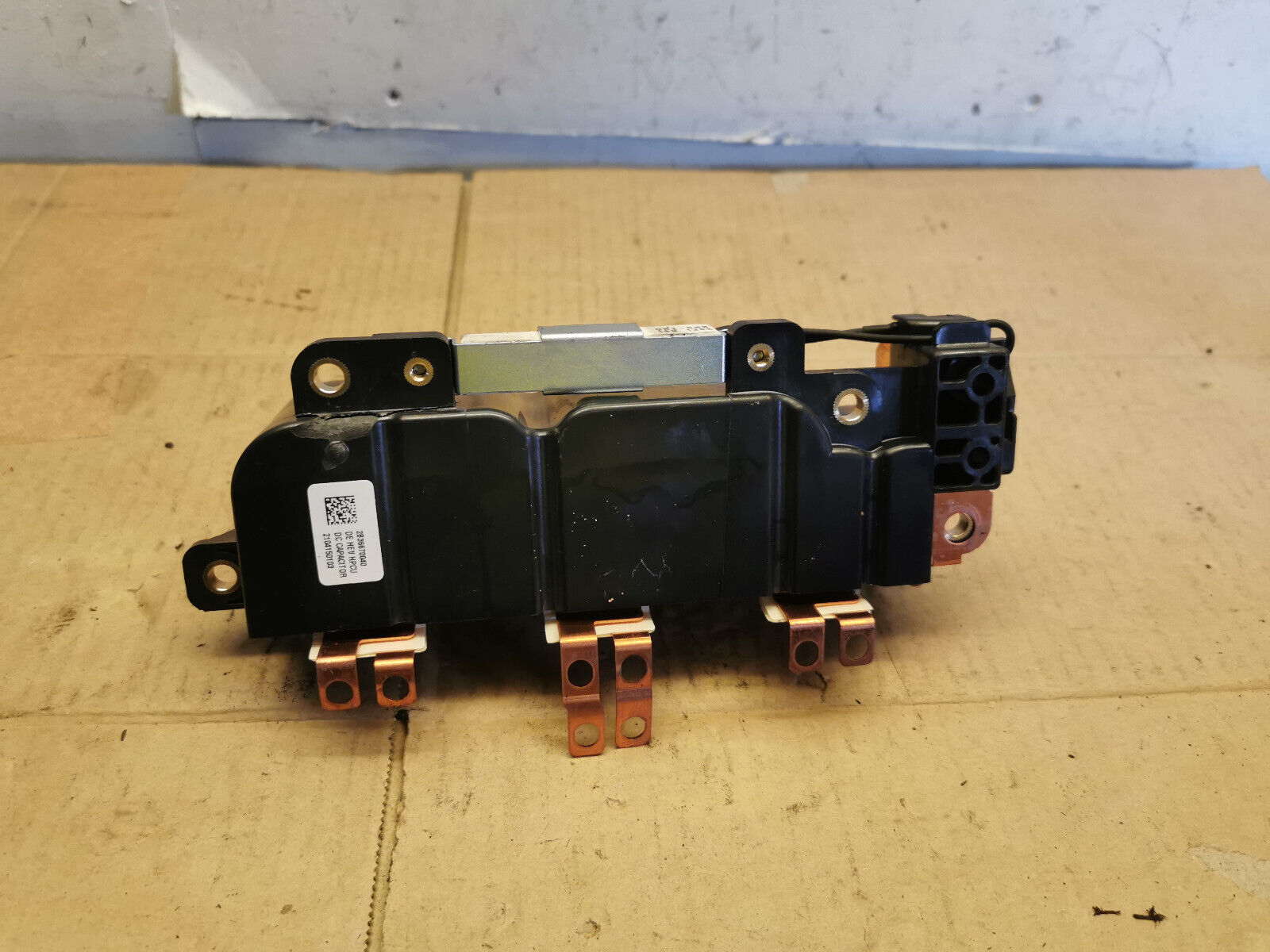

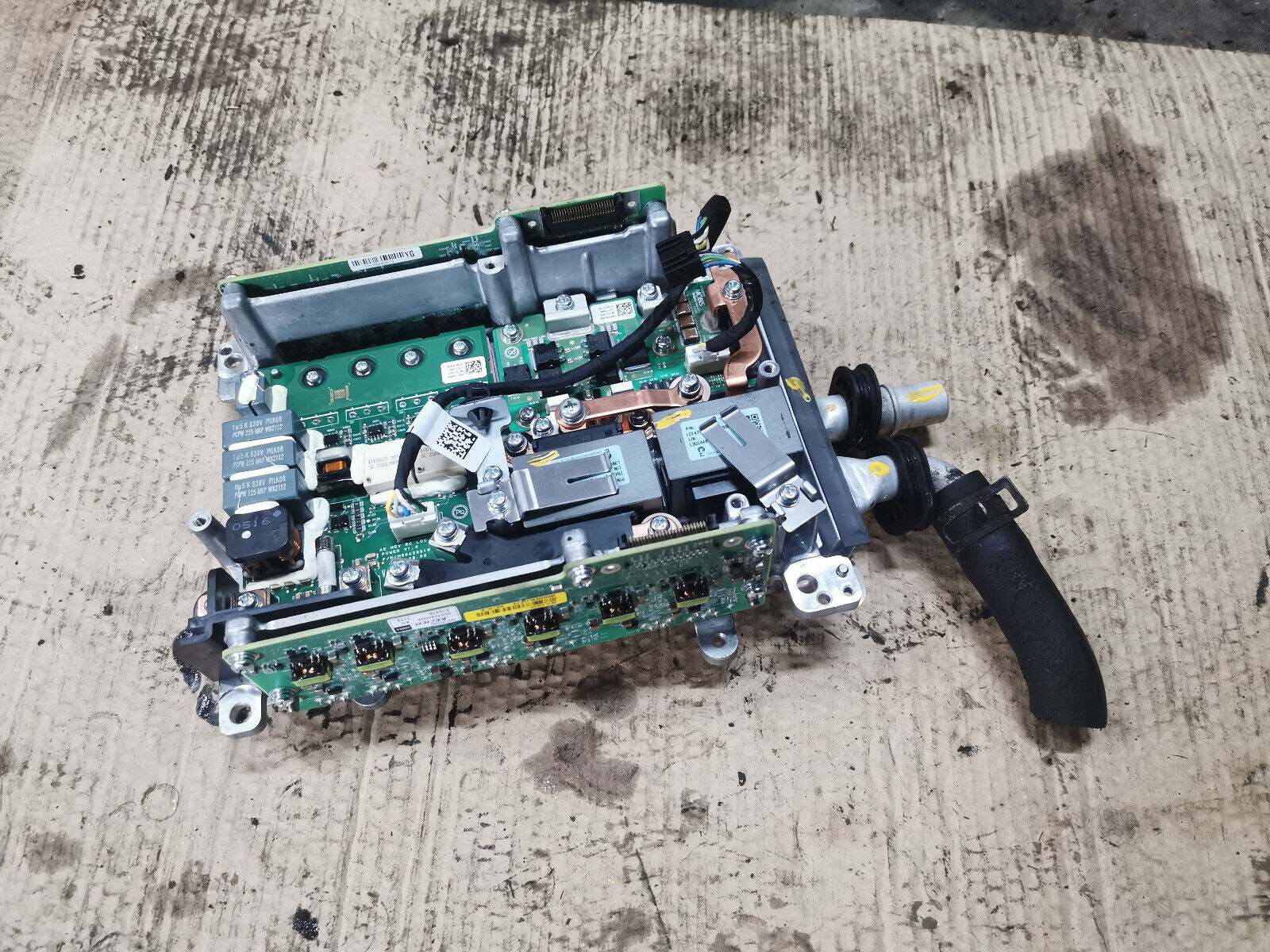

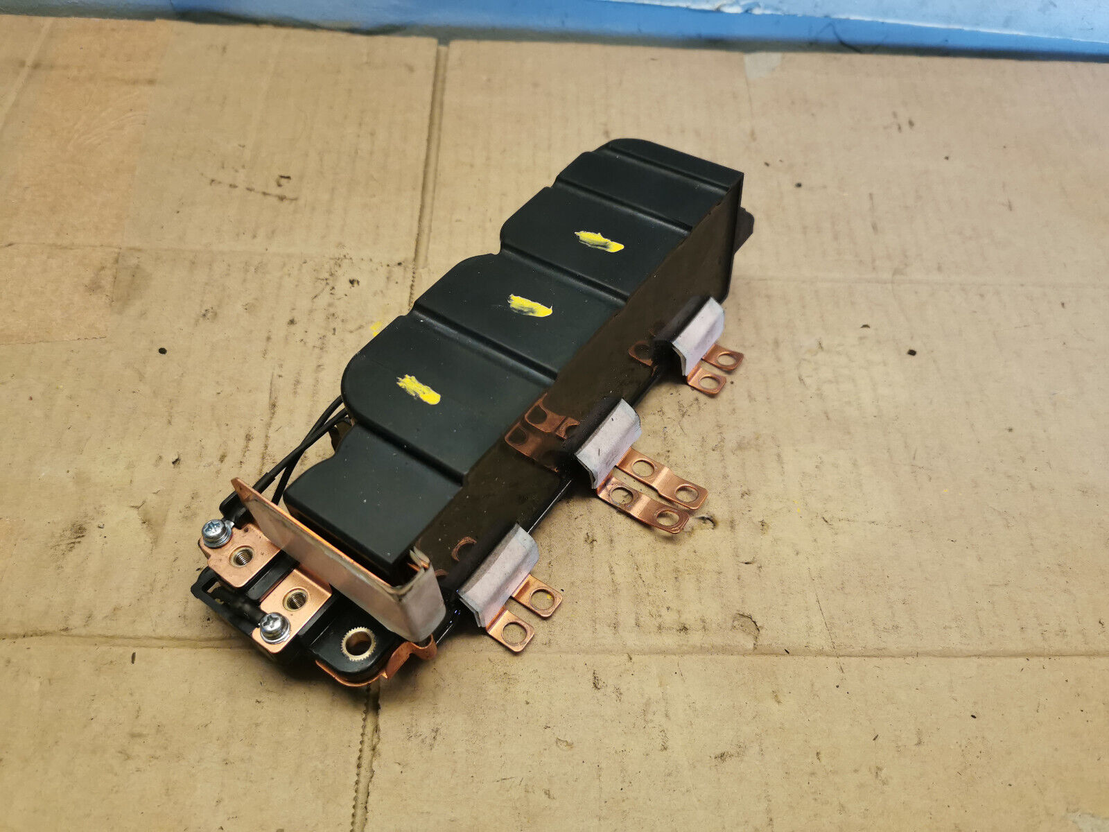

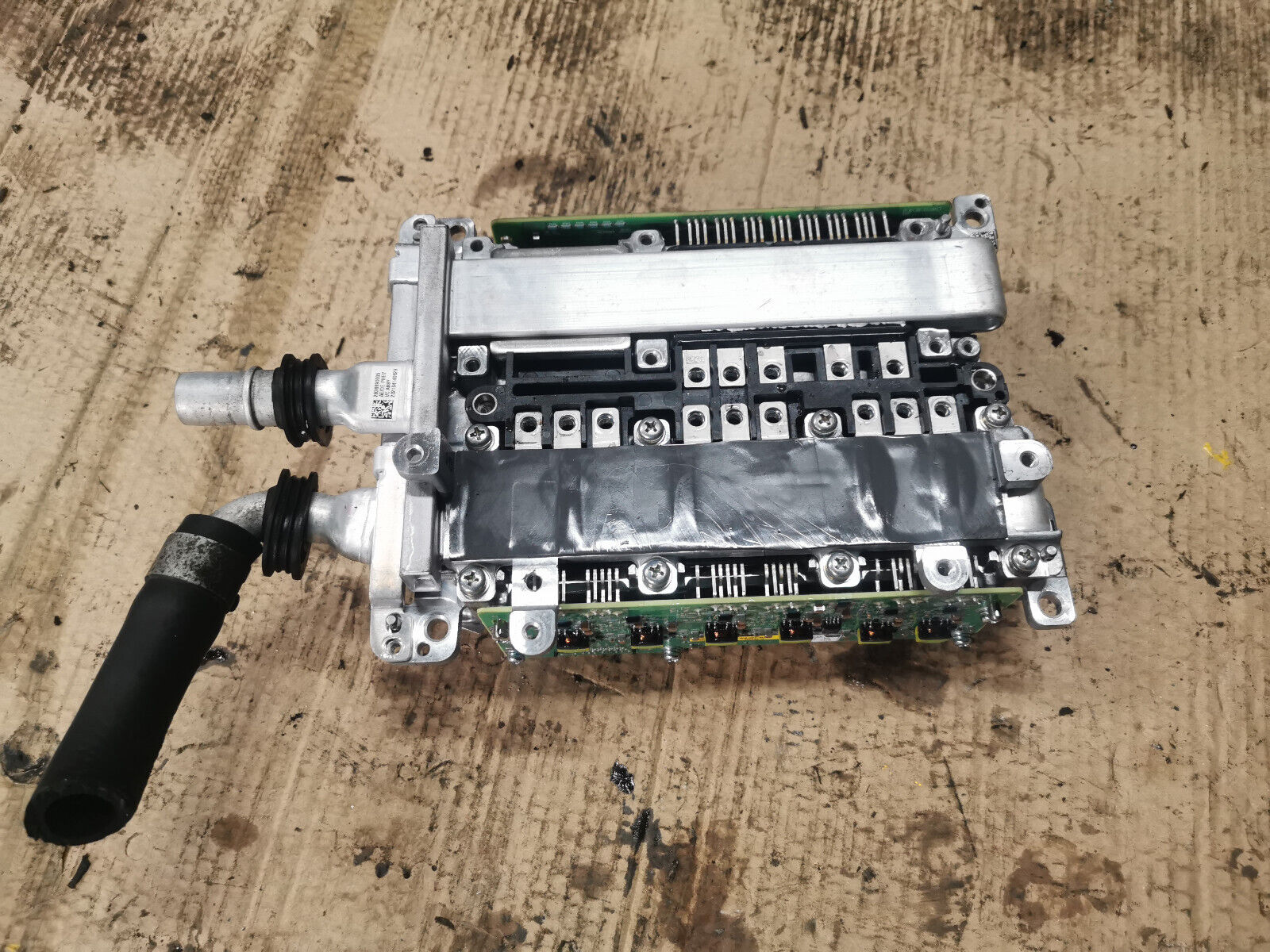

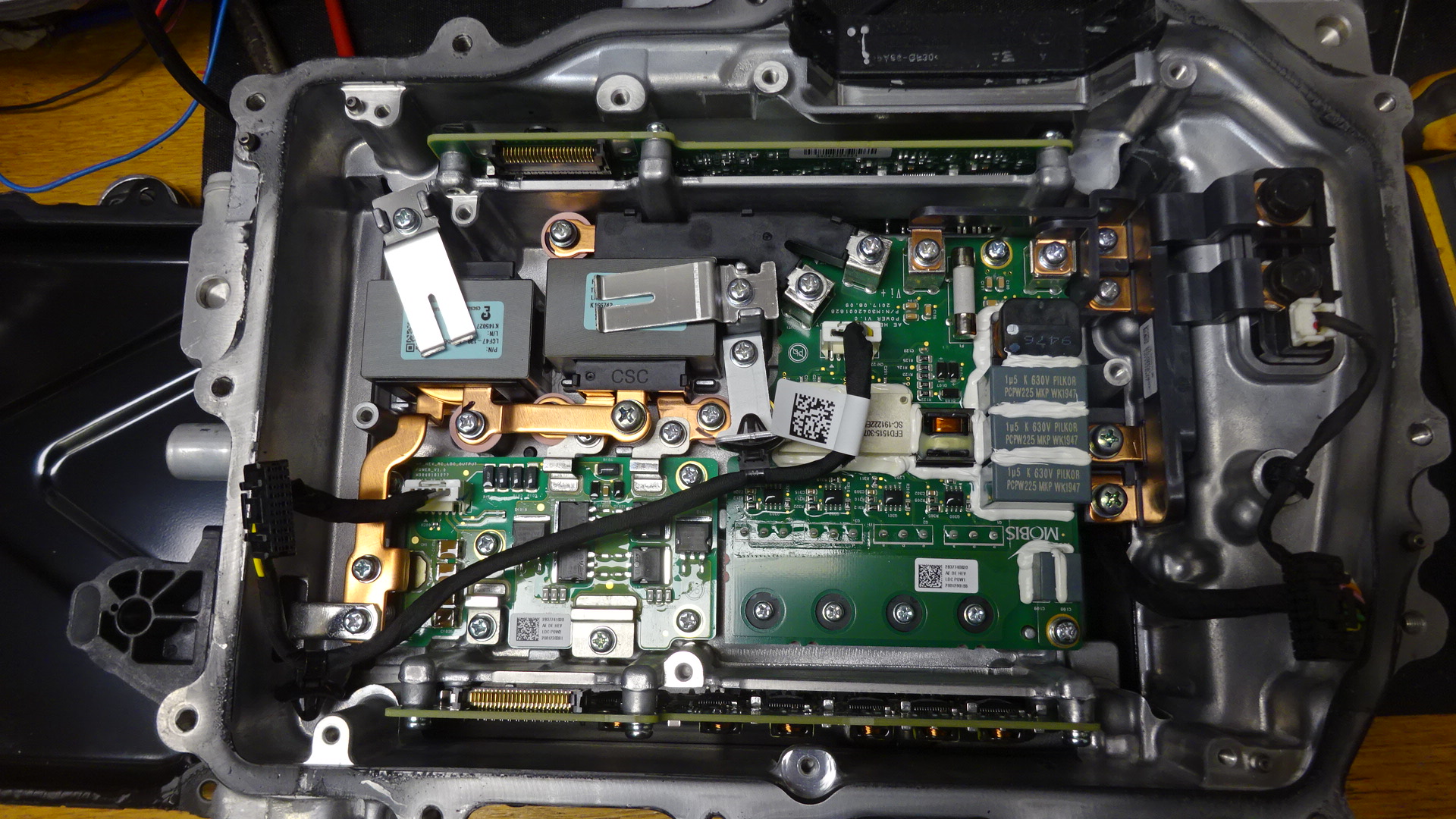

I thought this small and lightweight inverter might be of interest, especially for people making smaller EVs, this tiny inverter is a lot like the Toyota Gen4 it has a double sided cooled IGBTs and an integrated DC-DC and is capable of 35kw. I am yet to see what it spits out over CAN but I'm not sure it can be controlled with simple torque commands as it is listening to 3 can buses simultaneously to make its decision to provide toque to the two motor generators. It should be possible to make an adapter/ breakout board for openinverter. I have some photos of a unit stripped down even further that i found that i can post for this too.

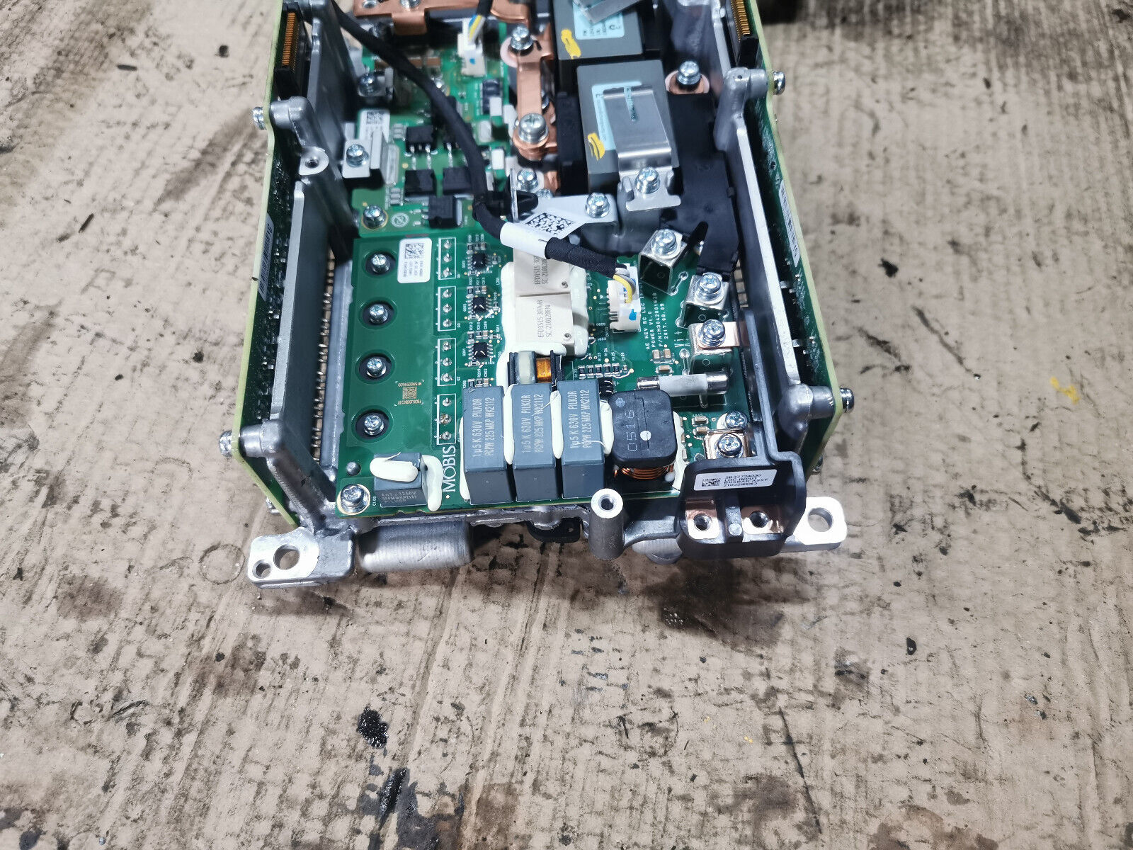

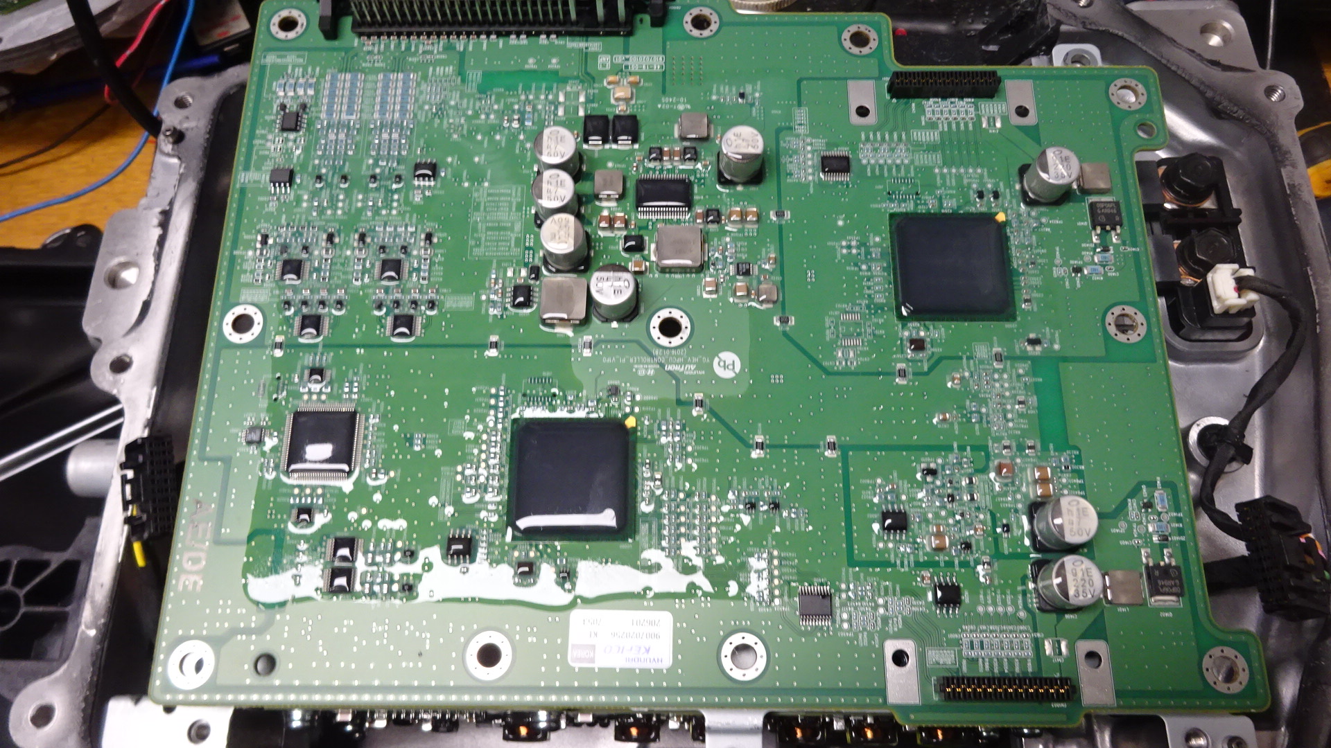

Re: Hyundai / Kia hybrid inverter teardown
I have found a set of buffers on the Main PCB that seem to drive the gate drive signals, am attempting to patch into them.
Also found 2 current sensors for each side that sit at 2.5v shame its not 3 because i have a Lebowski board i wanted to use with this and 2 are required.
Getting it working over can would be difficult as it has an immobilizer built in, I have the can frames it transmits and will post them here, my plan is to see if i can get it working with a Lebowski brain board or two as well as the DC-DC.
Creating a drop in board would be ideal but its a lot of work, it needs a controller for the DC DC on the mainboard which is bidirectional, correct me if im wrong but the DC -DC on the Prius board is just controlled by the atmega chip and it doesn't directly control the igbts?

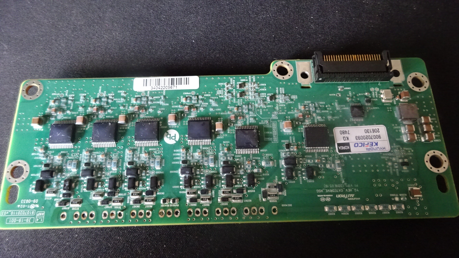

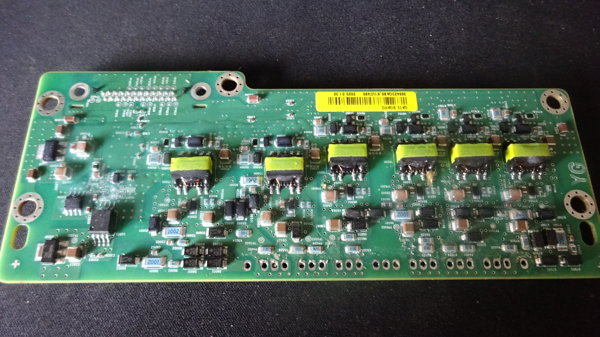

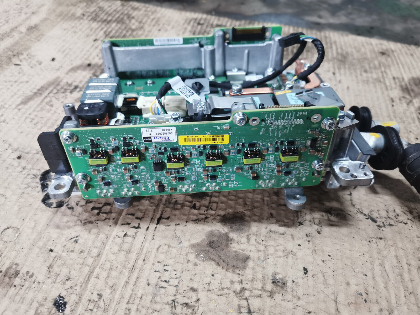

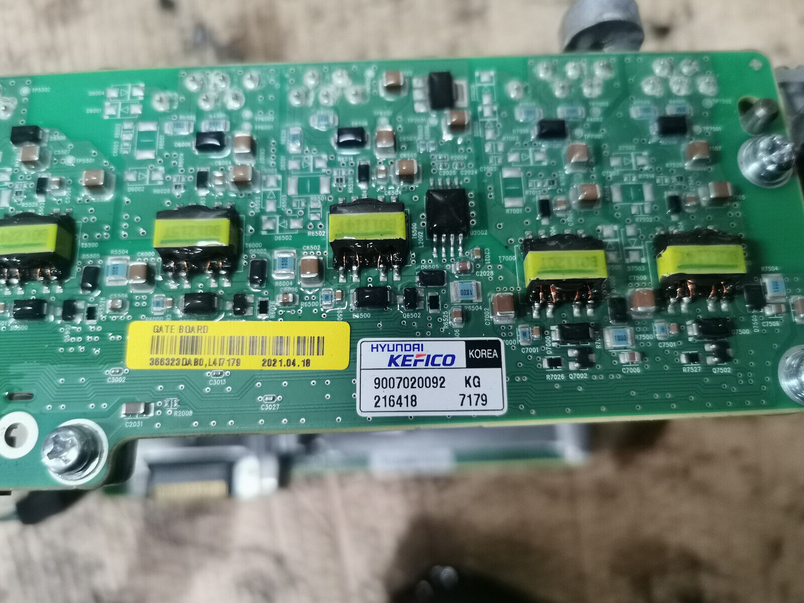

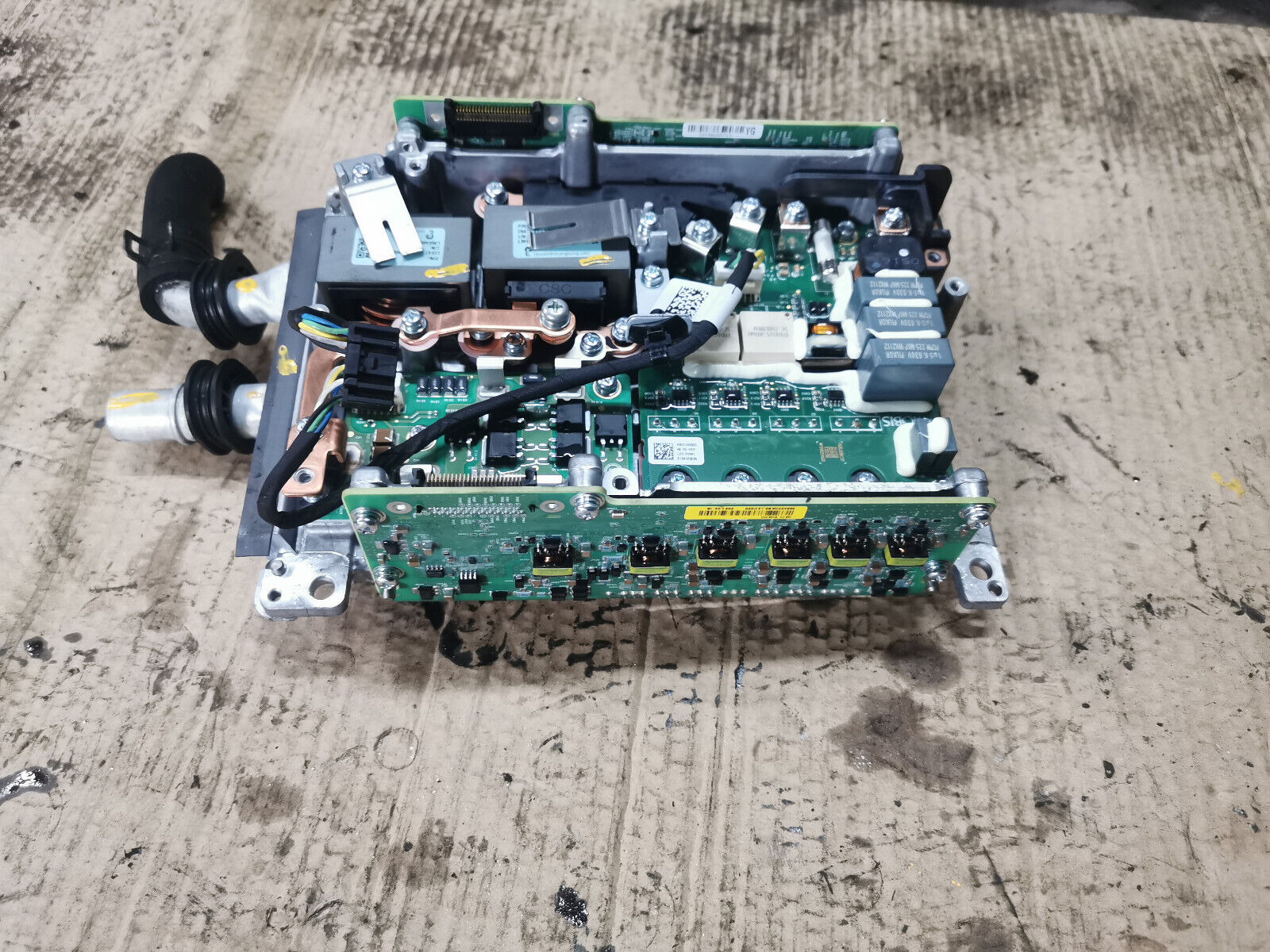

After some confusing outputs from the phases I decided to take the gate driver board off the IGBTS so i could see what was going on.
They are driven by 6X BM60055 gate driver IC's, and are driven in pairs high and low side so when IN1 is logic high on the low side IN2 will be logic high on the high side driver etc to prevent them both from turning on at the same time. They follow the truth table on the datasheet.
There is also a convenient ACPL-C87AT measuring the bus voltage
There are 2 current sensors per inverter section, the HSG uses a 300A LEM sensor and the drive motor uses a 500A
