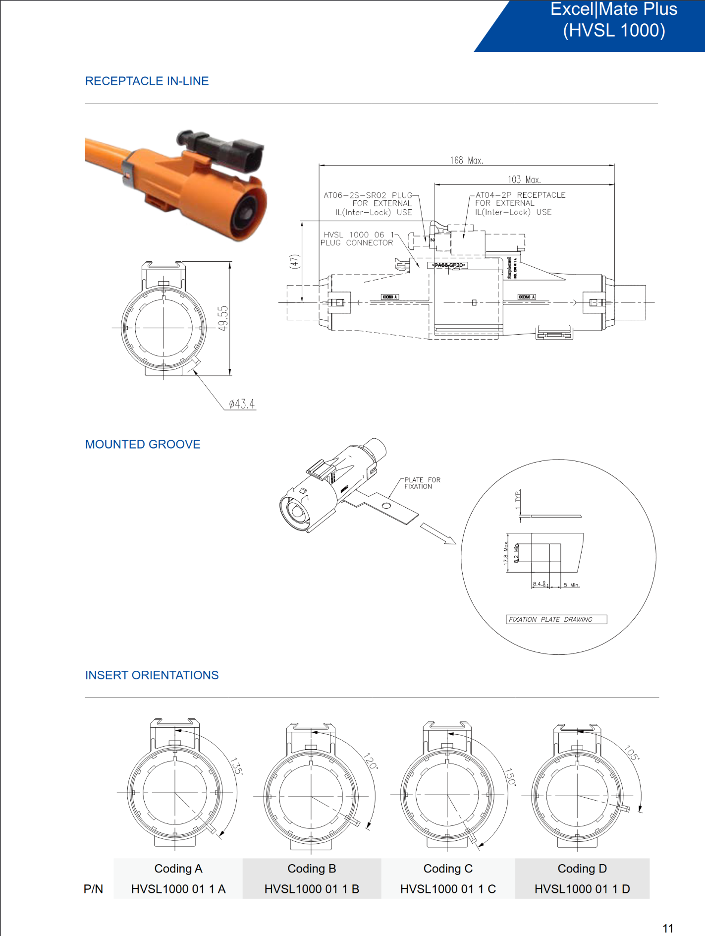

Amphenol HVSL 1000 do single inlines.
https://www.amphenol-industrial.de/de/a ... wFile/NjU=

Tom, while I knew that the HSVL line has 1-pole connectors, I had missed that -- buried in the catalog -- that the 1-pole connectors is their ONLY offering with an inline receptacle:
Amphenol HSVL 1000
Amphenol HSVL 1000
Amphenol HSVL 1000
Amphenol HSVL 1000
Amphenol HSVL 1000
Amphenol HSVL 1000
Their How to Order chart also lists 25-70mm² as options. That looks to be exactly what I'm looking for, and I thank you for the second look at that catalog. I spent many hours peering at datasheets and catalogs and missed it -- which is kind of what I figured I must have done.

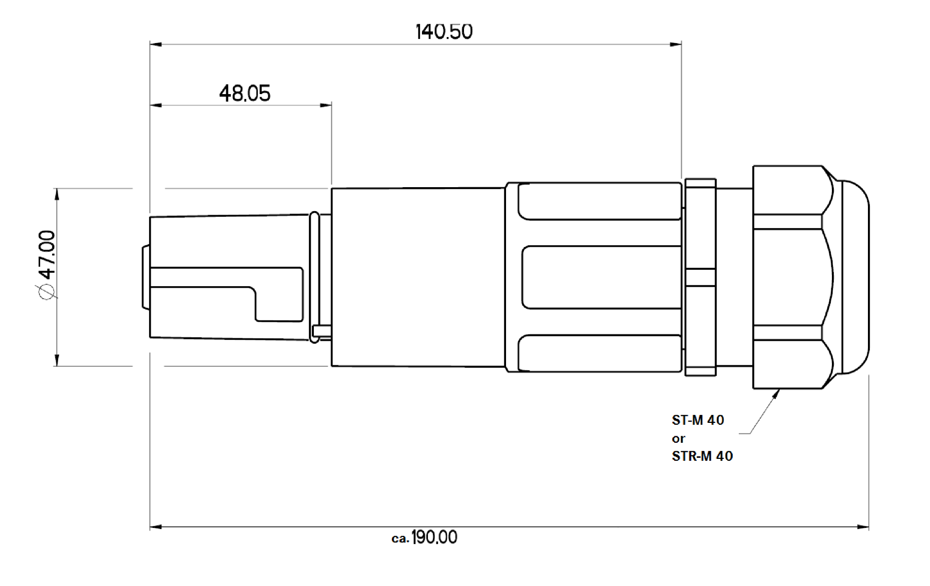

Thanks for suggesting the Lapp Epic F6/D6 connector. They do meet the criteria I stated above: 50mm², >125A, IP67, available*, and inline.
Lapp Epic Powerlock F6 & D6 inline wire-to-wire connectors
Lapp Epic Powerlock F6 & D6 inline wire-to-wire connectors dimensions
Without the glands on either end, assembled together these come to ~180mm (~7.25") in length.
Lapp Skintop Cable Glands dimensions
Cable glands' length are in addition to that. The recommended Skintop STR-M 53111450 (M40, cable range 9-23mm) is 43-52mm long (2"). Each. That brings each assembly to almost a foot long. I'm hoping for something a bit shorter, to fit at the top of a wheel well arch.
To un-mate them, ~50mm (~2") of linear cable movement is required. Not bad.
Those M40 cable glands are 56mm Ø (2.25" dia). Bulky.

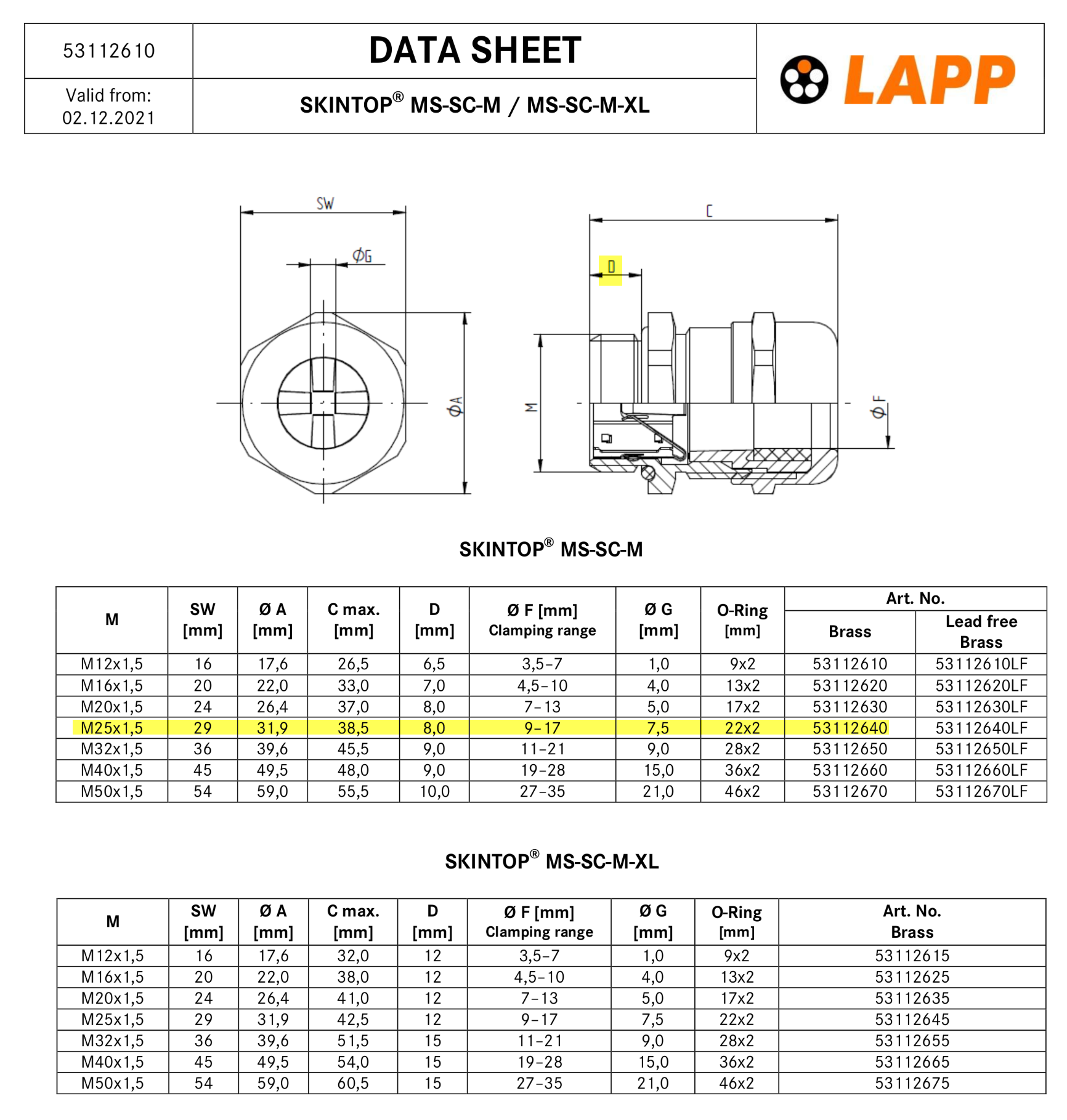

Tentatively, I've settled on Lapp Skintop 53112640 (M25, plated brass) for cable glands. Allowing for o-ring compression and tolerance error, each gland will consume ~10mm of threads from the coupler when installed.
Lapp Skintop cable glands MS-SC-M dimensions
That leaves ~16mm axial space in the coupler for a connection :(
The Klauke 126R/BK 50mm² butt splice you mentioned are 56mm in length.
The Molex 19215-0047 1/0 AWG butt splice that I stock are ~37mm in length.
It looks like I'll be making my own, longer coupling, perhaps ~75mm OAL -- around twice as long at the Fränkische unit.

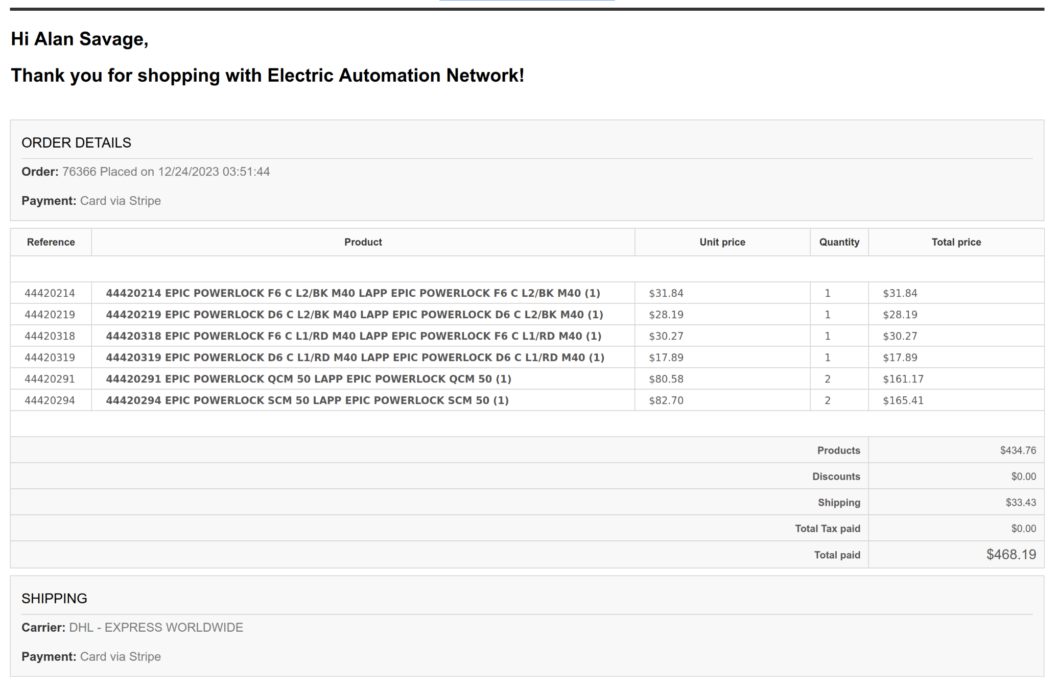

After much futzing about, I've ordered the Lapp connectors; the housings are inexpensive, but the crimp contacts are ~USD$80 each, x4, so the total is quite high. But I was not able to find suitable alternatives that didn't involve something even bulkier, and I do not have the room.
