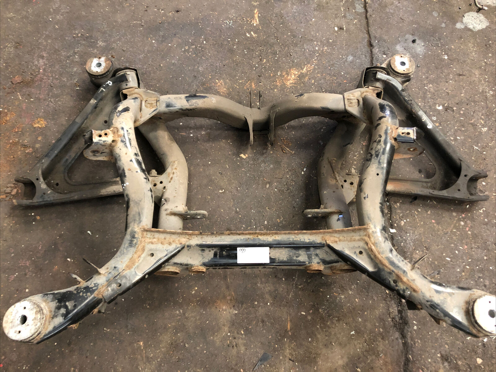

After looking for vehicles with matching PCDs and rear disc brakes with an axle that may be able to be swapped I've come across the VW Touareg (maybe the Audi Q8 also). An E-tron also seems to fit which might help with motor mounting....
Anyway, these are all rear subframes, would they be a suitable option for modification/swapping do you think?
I suspect not for a swap but modification potentially... Tracking width is also within 20mm which is nice.... I just need to work out how to add the leaf spring/dampener mounts.
They are also very cheap which is good.
Touareg
Etron rear axle (expensive)

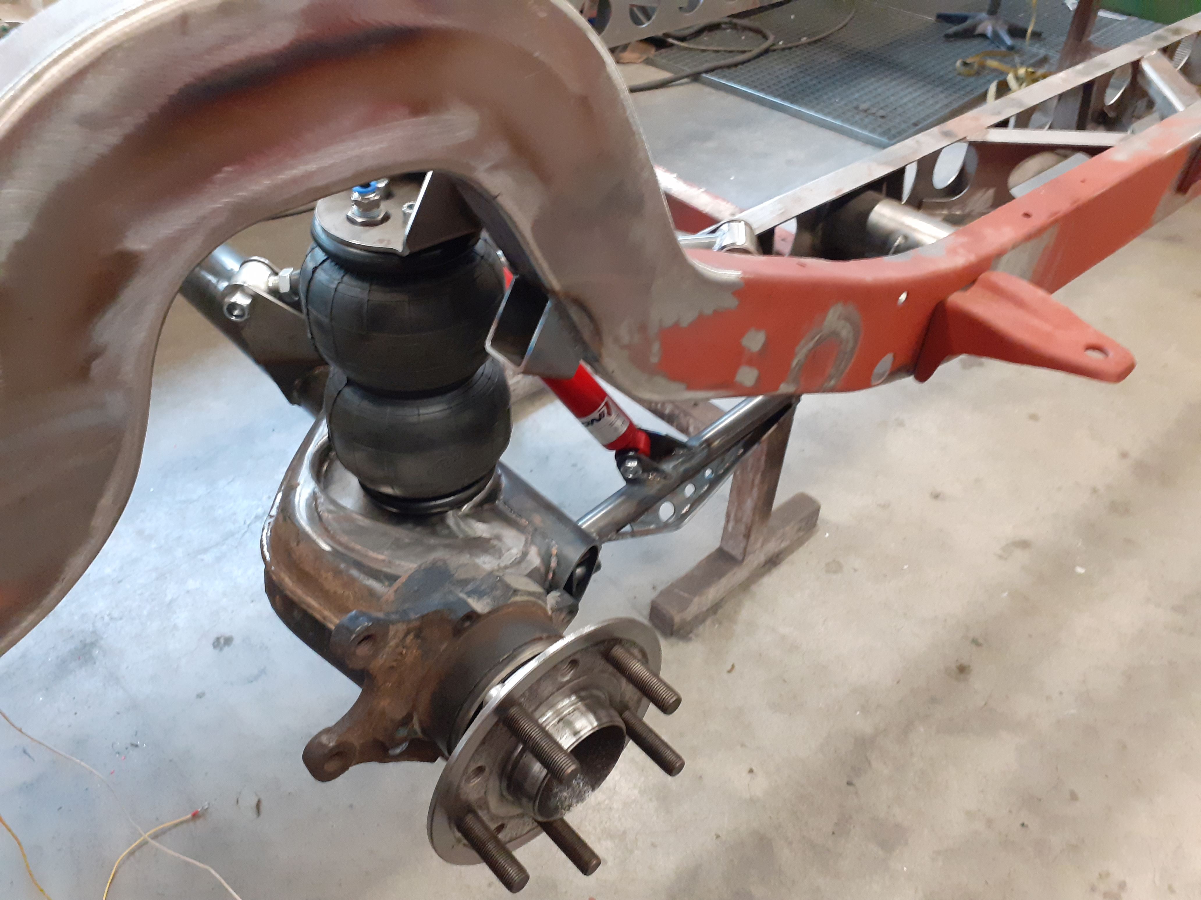

by muehlpower
I first fixed the two individual parts with a pipe and a threaded rod. This ensures that the wheels are straight afterwards and that the track width is correct. I also changed the attachment for the air spring, it would look different with a leaf spring. The welded tube has a diameter of 89mm and a wall thickness of 4mm.
