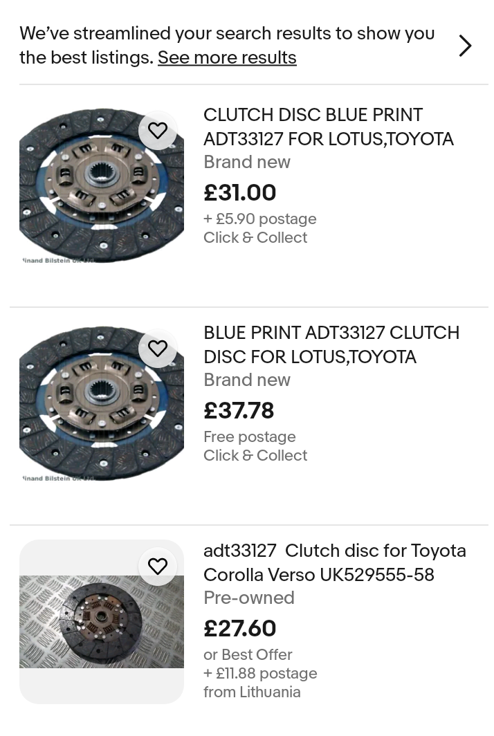

Re: gs400h and gs300h gear ratio locked and unlocked
Well £37 isn't going to break the bank , and compared to the various conectors, midpack disconnect, contactors, fuses you will need it will only be a drop in the pond
Luckily for me my daily work horse is a Toyota auris (dullest car in world but does job of car with very reliability) and the clutch bite point is getting near the end so I might get unlucky and need to replace it and I suspect I can add another part number to the list if that happens.
Oh cool the only ones i could see were £100+. Yeah i get that, unfortunately it's really hard to figure out how much all that assorted smaller stuff is going to cost so hard to budget for it. Oh nice, silver linings haha.rstevens81 wrote: ↑Wed Jun 07, 2023 5:44 am Well £37 isn't going to break the bank , and compared to the various conectors, midpack disconnect, contactors, fuses you will need it will only be a drop in the pond
