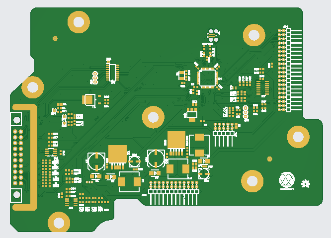

So now I can design a replacement pcb and get on with the project 8-)
Re: XC90 inverter teardown and reverse engineering
Posted: Wed Jan 17, 2024 9:31 pm
by manny
After a couple of long nights V1 board is done
:D looks similar :D
Posted: Wed Jan 31, 2024 8:25 am
by manny
PCB are here!
After desoldering two DC-DC converter boards for parts and transferring them to the new PCB. The power supply whas tested before I placed the other components. The 5V line whas 1.25V at first power up. The LM2596 I got is the adjustable type and not the fixed 5V one. :?
Added a couple resistors for now. It will be replaced at some point.
The inverter uses a 15V feed so I changed the DC-DC converter from the original design to a more powerful one.
This DC-DC converter is powered from the 12V instead of the 5V like it is in the original design. So I replaced it for a sepic type so it will work from 5V to 32V.
First problem: The capacitors are to high so the pcb dose not fit in the inverter housing. Will find some lower ones.
but first more testing to find out if there are more problems.
It looks a lot better than the prototype :D

OI replacement PCB V1.1
Posted: Sat Jul 13, 2024 8:54 pm
by manny
Made a revision on the PCB there where a couple of small errors pin swaps etc.
Bigger problem whas that the board did not fit in the inverter. Caps and inductors for the 2 DCDC converters where to tall.
Replaced the LM2596 and XL6009 for parts with a higher switching frequency. With a higher frequency the passive components can be smaller.
Used a MP1584 for the 5V supply and a mt3608 for the 15V supply, Did not go with a sepic converter for the 15V supply this time. There is no need for running this controller on 24V or something.
Added a opamp circuit for the PT100 temp sensor in the motor. And changed the layout for the inverter temperature.
Added connectors for the HVIL and connected it to the E-stop input.
Removed a contactor output and used the pin for ground for the resolver excitation signal. to make the wiring simpler.
Moved some of the mounting holes. They did not lined up perfectly on the V1 board and still don't :| But the holes a oversized so it fits fine.
Have to change the code for the temp sensors.
The design is not final but this is good enough to get the project running.
