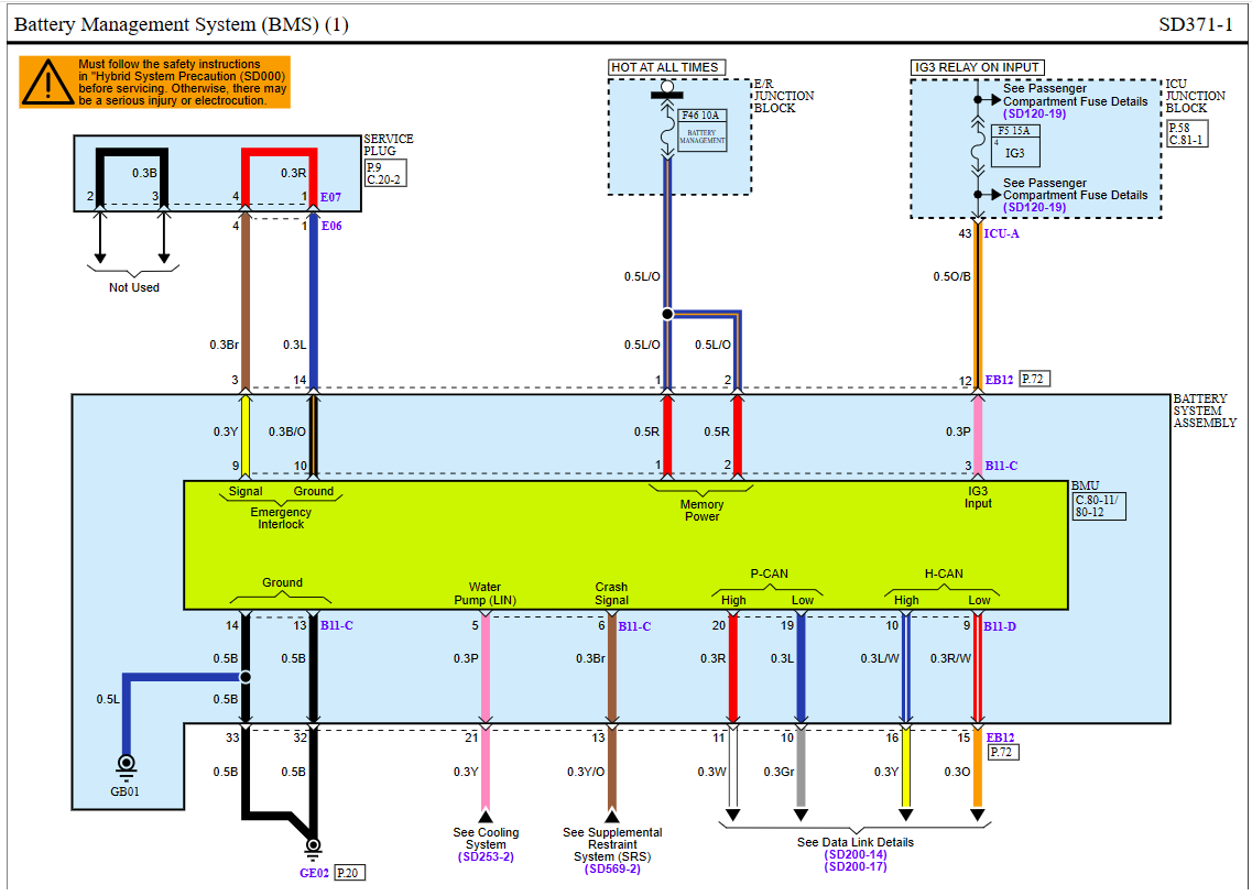

Hello,
i recently bought temporary battery (37501-CL500) for my ev conversion and i'm trying to close contactors. EB 12 connector has similiar pinout to other models and i managed to read some data via OBD II. PIDs are the same as in other models, for example: https://docs.google.com/spreadsheets/d/ ... 1176199607.
When i play can log from Hyundai Kona, UDS ReadById 101 byte 53 which is ignition state, and probably HCU ready, MCU ready, etc changes to correct value but contactors remain open. Additionaly 0.5 s after turning ignition on BMS fault appears which means CAN bus is innactive. According to service manual HCU has to send command to close contactors on H-CAN. Unfortunately i can't find on the internet any log from this bus, even from other models, or from KIA, only from P-CAN and others.
Has anyone tried using this battery, has can logs, or is able to record them?
You can find my logs and SavvyCan script to read diagnostic information here:
https://github.com/maciek16c/hyundai-sa ... ev-battery

I got it working. There are probably still few warnings but i can charge and discharge it.
There are 4 frames needed:
BMU closes contactors automatically with request in frame 0x200 or 0x2F0. If you want to run battery using this script don't connect anything with high capacity (inverter) to battery output because it doesn't measure voltage after contactors, only uses CAN messages to get this voltage, and could close main contactor with very short precharge.
I have also added support for this battery to zombieverter VCU: https://github.com/maciek16c/Stm32-vcu
For easier use i connected both CAN buses together
- 0x523 - ignition and inverter status
- 0x2F0
- 0x2A1 - inverter voltage
- 0x200

- Can you confirm you are connecting straight to the BMU (no other devices on the PCAN bus) and by only sending a 200 frame, you get your contactors to close?
- Would you mind sharing your CAN logs? It may help me finding out why it works on yours but not on mine.
- proably a dumb question - you do mention H-CAN. How is HCAN connected to EB12?

I only had BMU connected. All 4 frames (200, 2F0, 2A1, 523) are needed. When trying to close contactors i didn't look much into messages coming from BMU, i used uds.js script to see diagnostic information. You should see ignition state changed from 0 to 00000100 when 0x523 (0x60, 0x00, 0x60, 0x00, 0x00 , 0x00, 0x00, 0x00) is sent. Plausible inverter voltage has to also be sent, it should try to do something (precharge) even if it's 0V. If it's incorrect BMU shows 403V. To run battery using my script (bateria.js) you have to set kl15 and enable_send to 1, set voltage and set contactor1 to 1.
I added 2 can logs:
I added 2 can logs:
- ładowanie-krotkie.csv - charging battery using outlander charger - i sent fake inverter voltage using savvycan because precharge isn't needed in this case
- Uruchomiony falownik.csv - Battery controlled by zombieverter, sending true inverter voltage to battery

I recorded can communication from Santa Fe HEV. There were many differences in frames between HEV and PHEV but fortunately all 4 required frames were present, just with different data.
Can you read inverter voltage reported by BMS? Can you change this value by manually sending can frame with different data?
All interlocks have to be shorted (battery output, charging input ...) Does your battery have service disconnect? If not you could try finding interlock in EB12 connector by finding pin with 3.3V and connecting it to gnd via resistor (1 - 10 kohm). If voltage drops it should be input and can be kept shorted.

I have actually managed to get what i presume is the precharge relay to pull in for just a few seconds, but it only seems to happen on start-up using message 0x200 and it wont go any further that that at the moment.
I think all the interlocks are shorted, I can find only one on the battery on the service disconnect.
The frame for inverter voltage is present from the inverter and I have tried setting it to 0v or the battery voltage.
I have also tried editing your script to include the extra messages.
It could be that the HPCU will not pull the contactors in because it does not receive the codes from the immobilizer, its showing a DTC which seems to be something like this.
Im not really all that great with programming or working with CAN there may be something im missing.

Precharge relay working is a really good sign. Contactors are controlled by bms, not by HCPU. HCPU only sends signal to turn on HV. BMS doesn't close main contactor and opens precharge after 0x200 because inverter voltage doesn't rise fast enough. Try manually sending inverter voltage high enough for example 0x2A1 0,0,0,0,0,0,0xFF,0. Remember to not connect bettery output to inverter when you try it.
Since you can view diagnostic information using elm327 send this frome using savvycan with 10ms trigger and change data to see how reported voltage changes. You don't have to send other frames while you try it.
When precharge fails you have to disconnect ignition and try again
