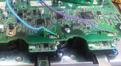

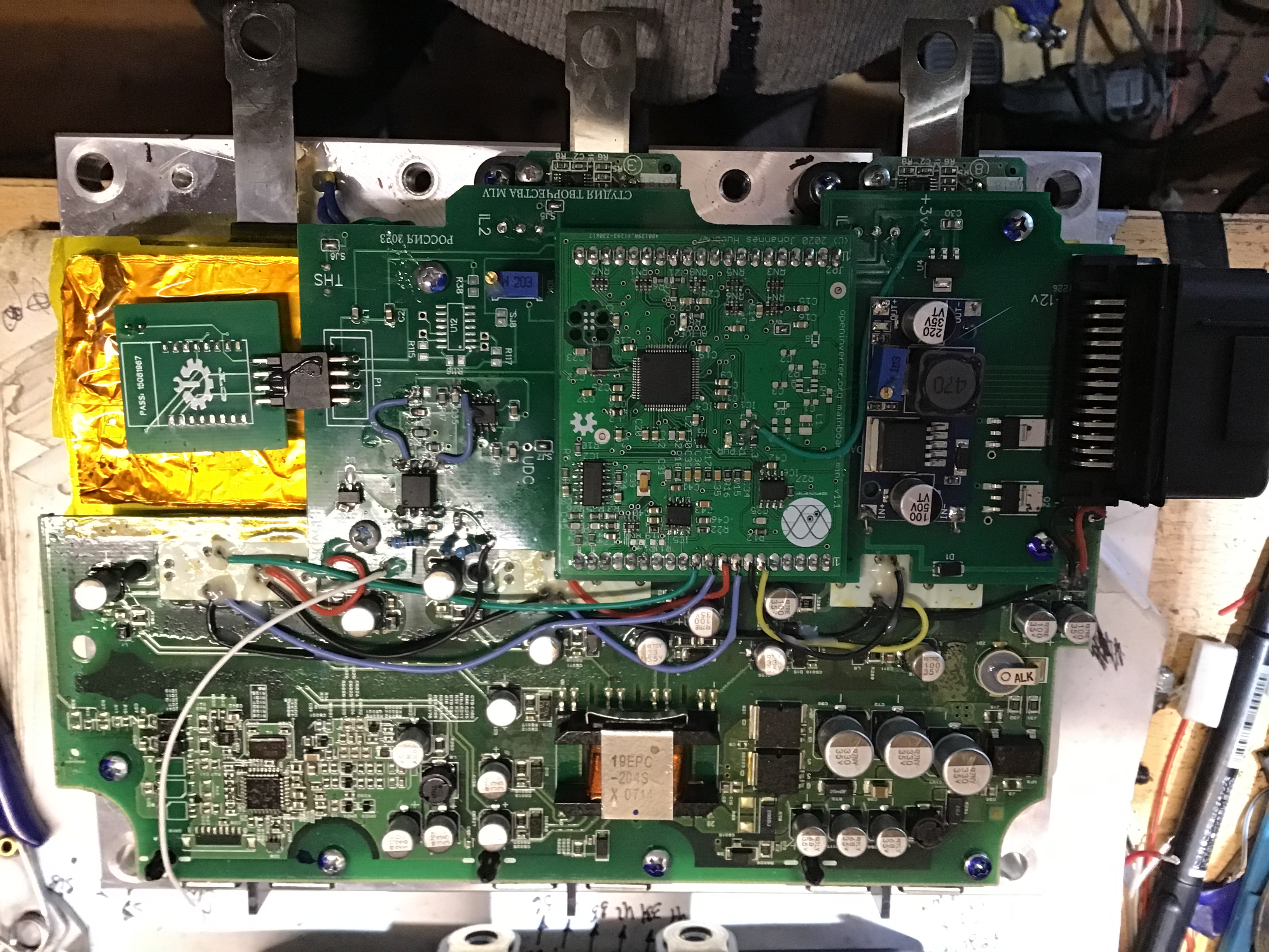

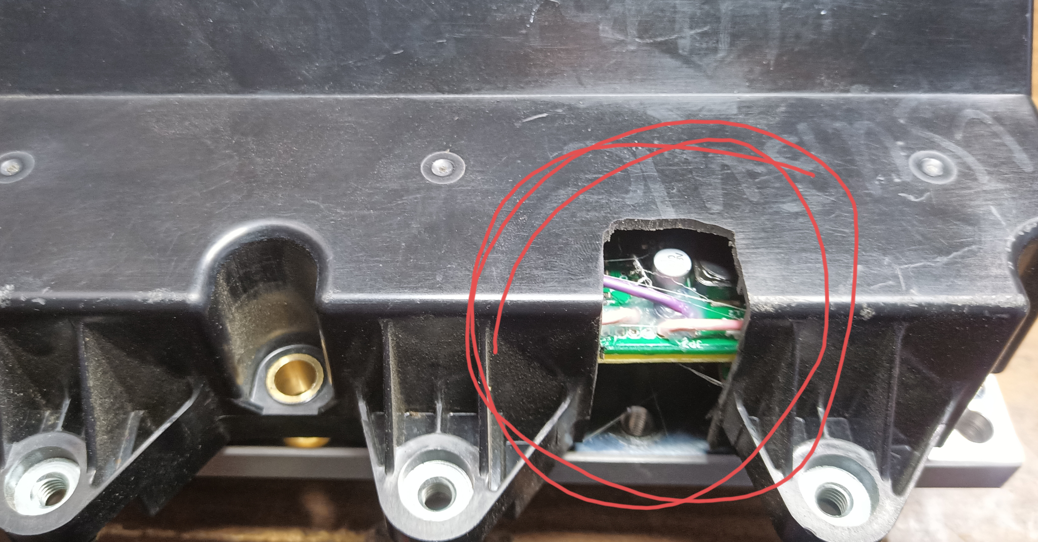

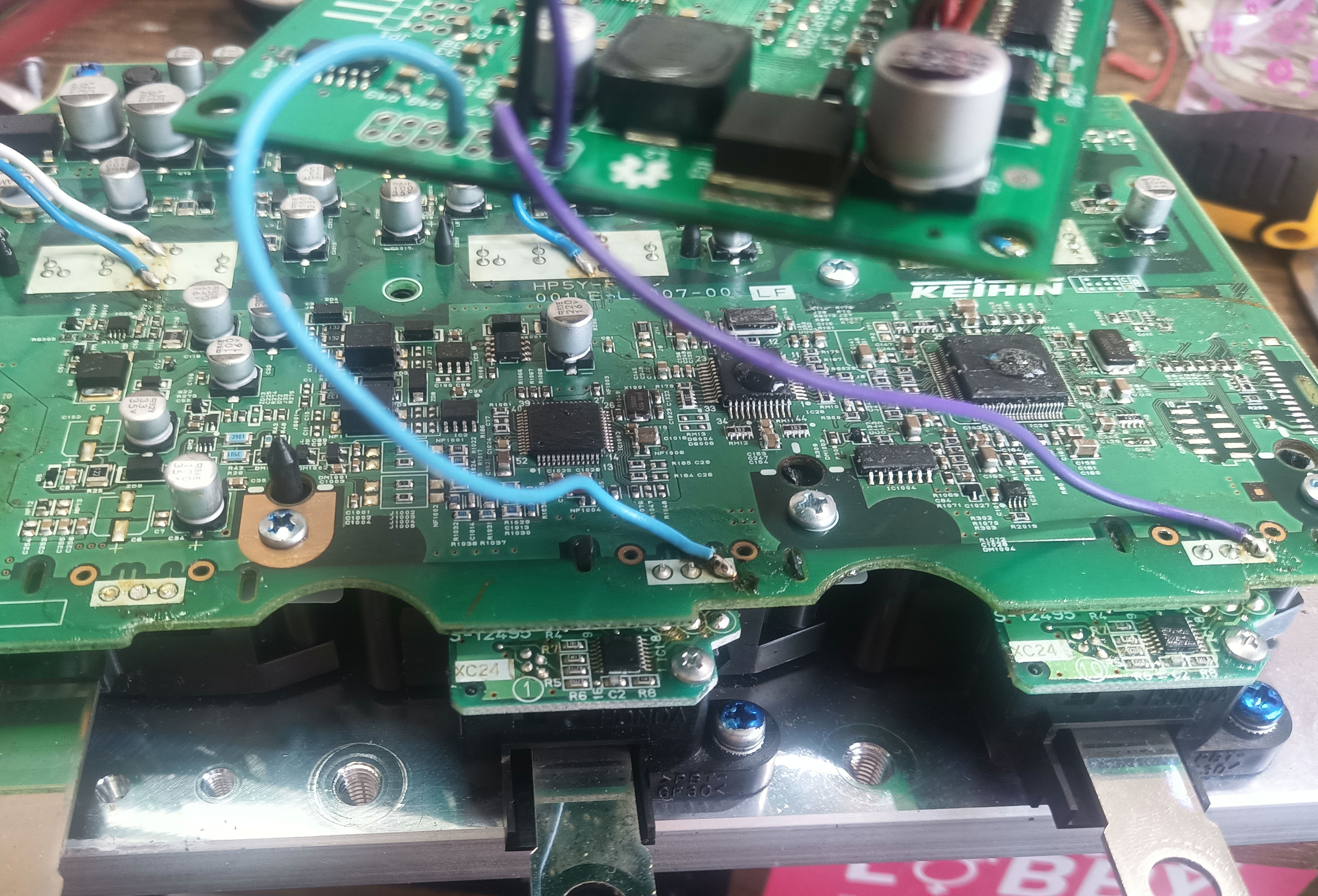

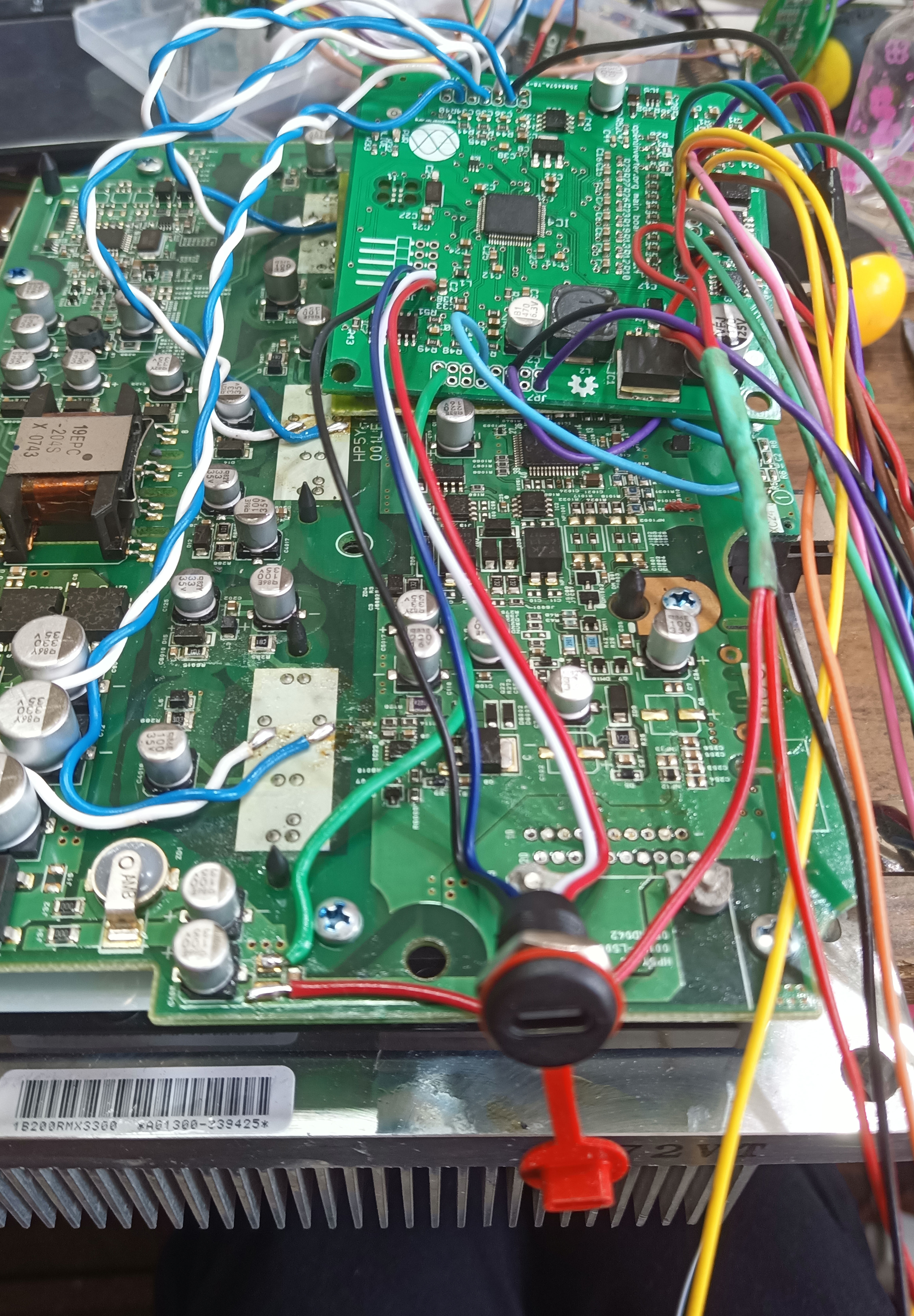

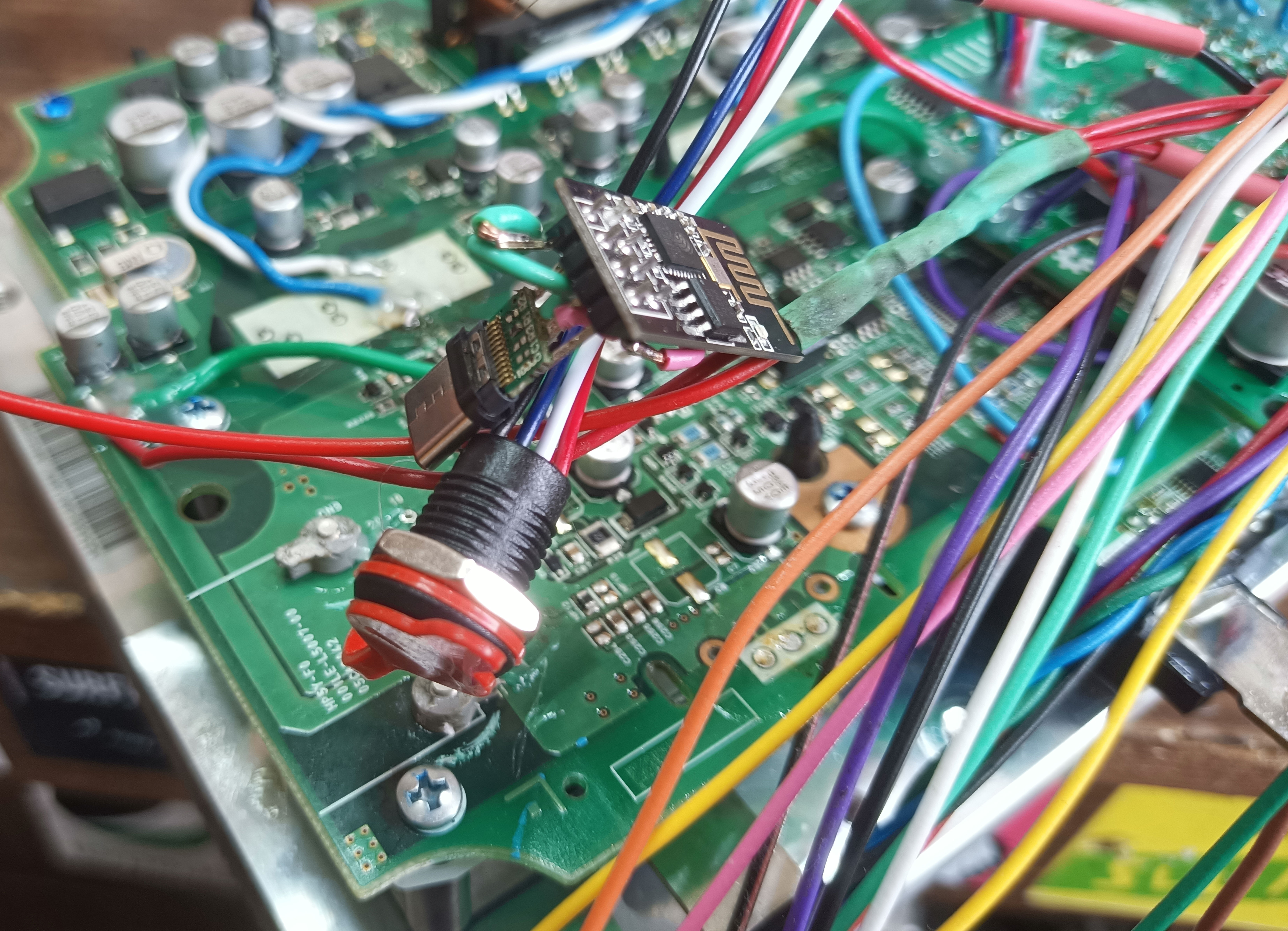

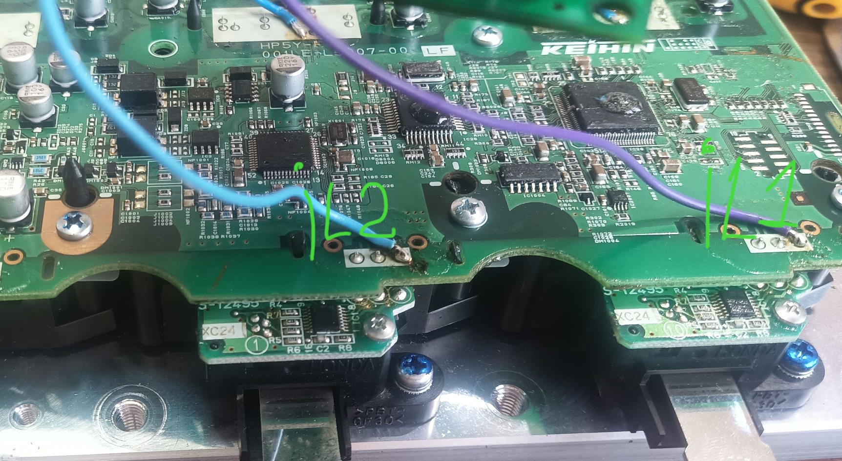

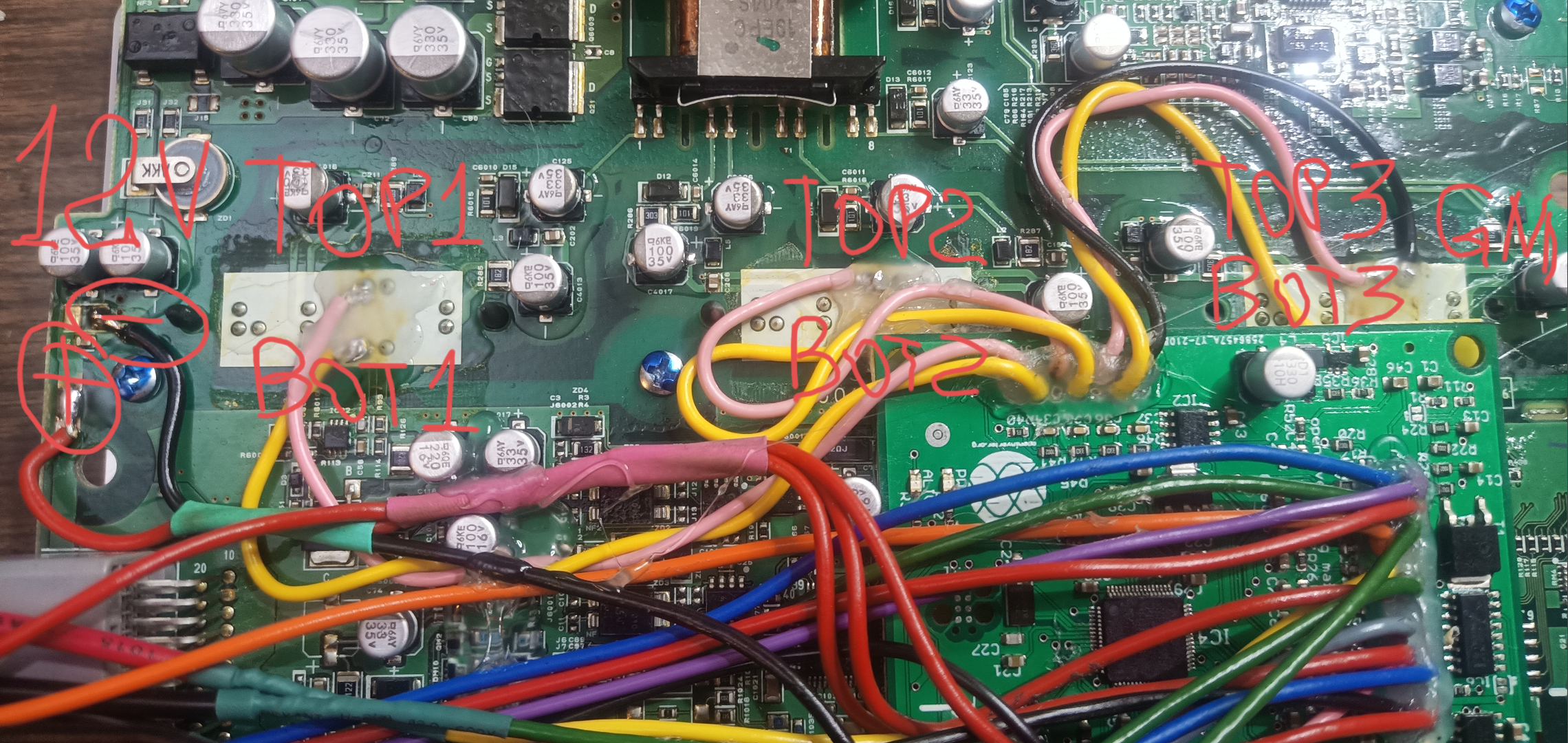

there is only one wiring for connecting current sensors (they receive power from the native board of the inverter), and only two wires for each power module to control the PWM relative to the total GND, + two wiring for 12 volts of the native board. this is enough for high-quality operation of the inverter.

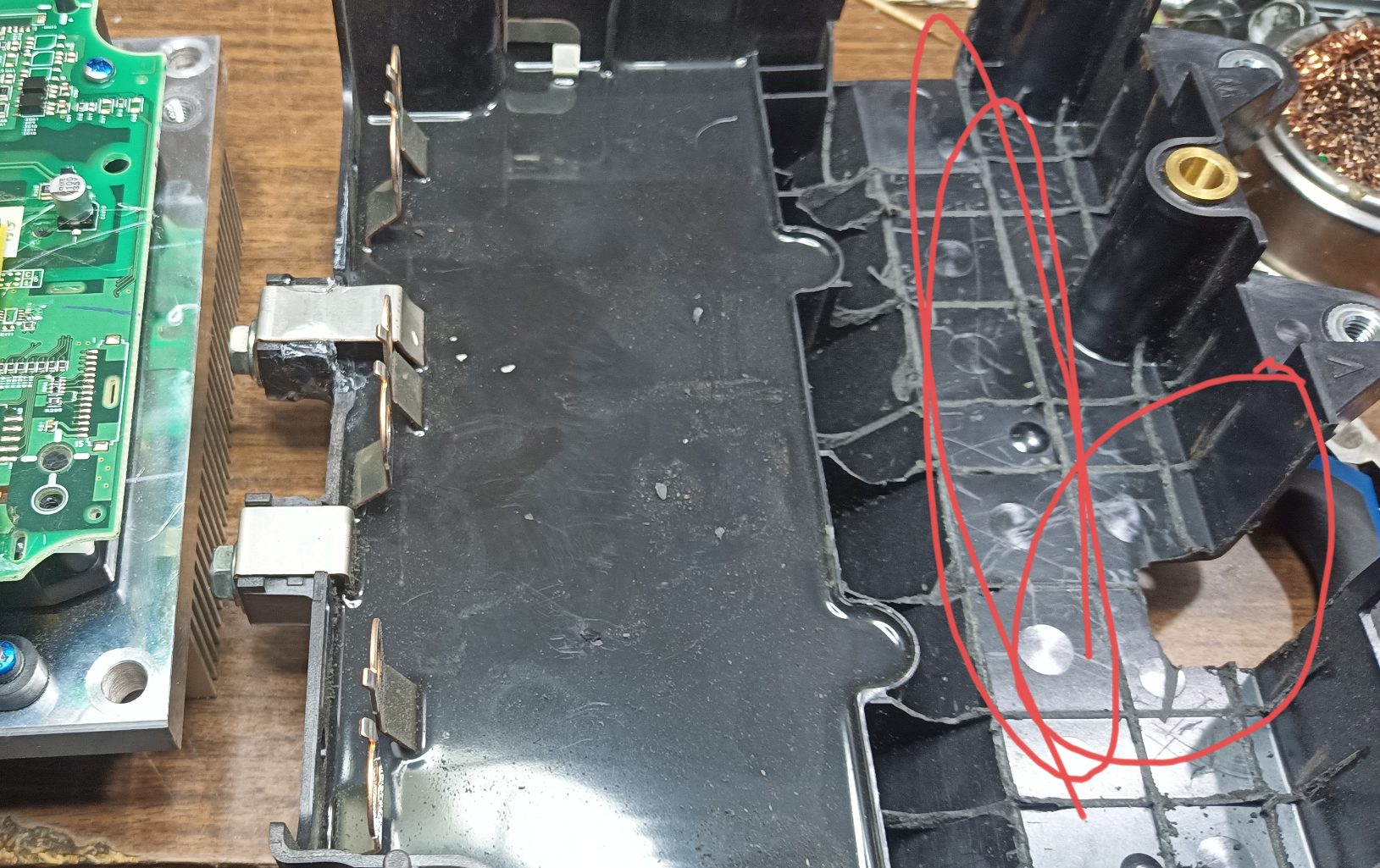

I also make an external Wi-Fi module using a sealed type-c connector for this, and I completely fill the inverters with a special compound, which makes them protected from immersion in puddles))

Ryclanmoto wrote: Sat May 20, 2023 1:59 am Good afternoon, could you tell me where what is connected to the Honda inverter, where is which wire? thank you in advance
with this connection, pinswap=4 (pwmout13)
il gain = 4.1
evil neodymium :twisted:
