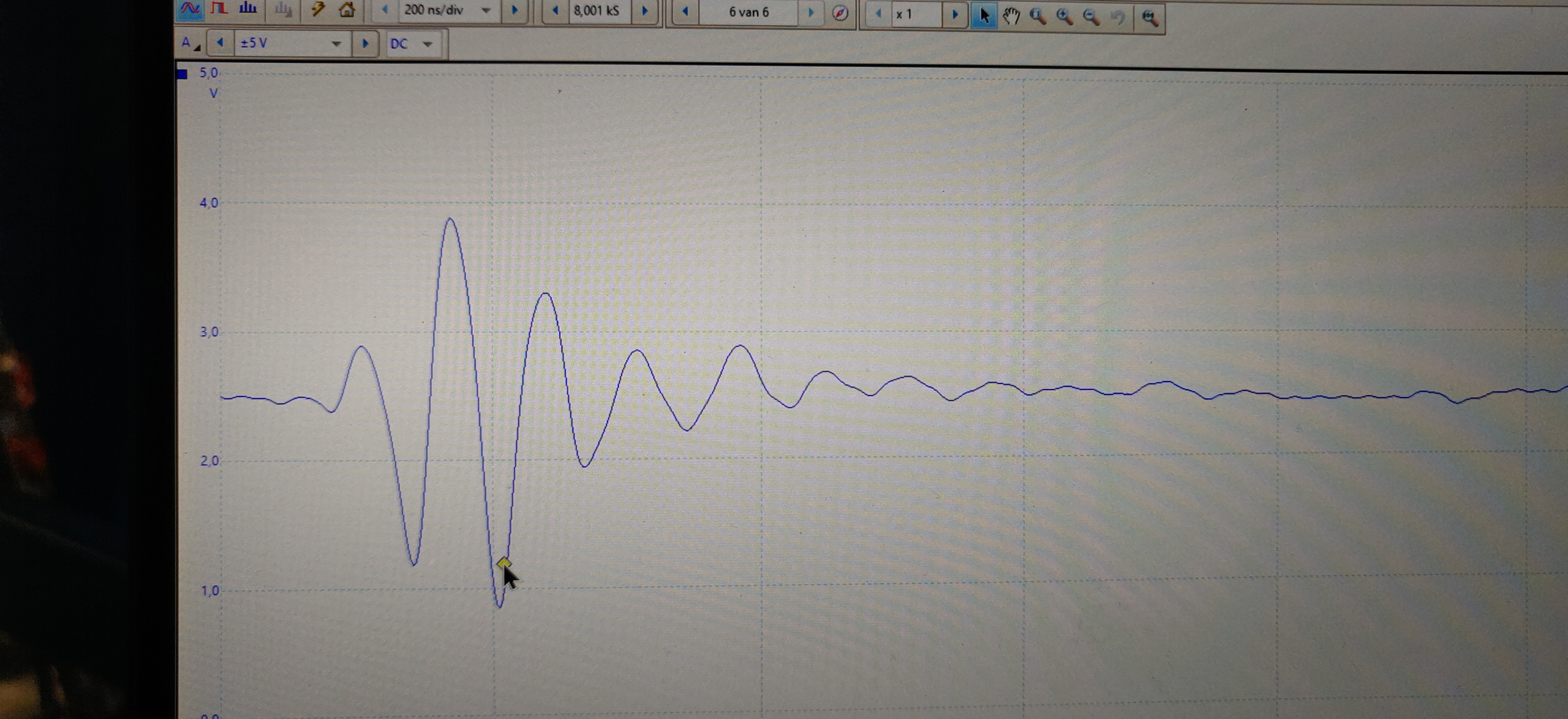

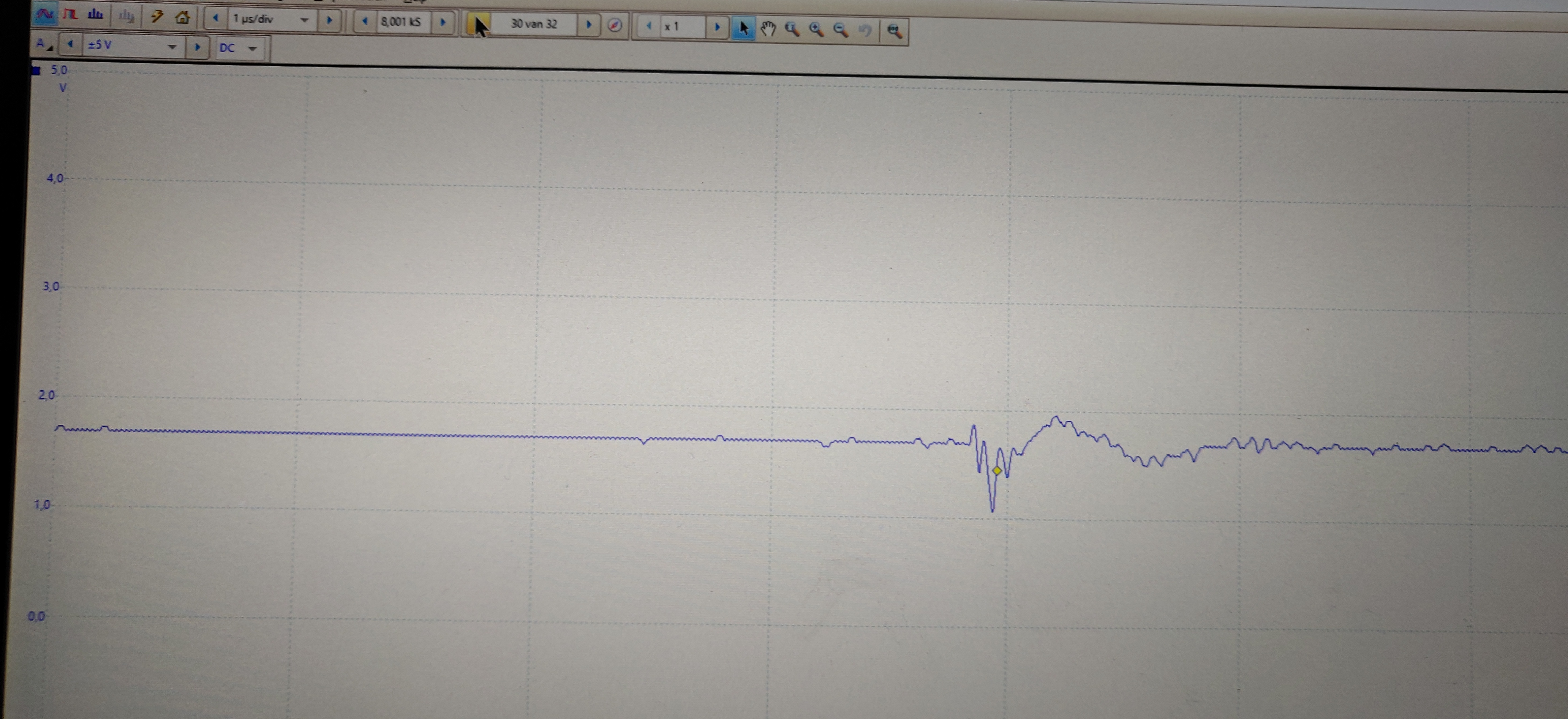

thank you for the tip, I have double checked and PWM 1, 2 and 3 are connected correctly and I have double checked the operation of each stage with a function generator and the high and low side respond as they should. the current sensor is on phase 1 and 3, so i have pwm swap 2 and 3 enabled. but the only setting i got the motor running was current sens swap, so that was very strange of course. so the next thing was to check with a scope on the current sensors and i think i found something! there is quite a spike on the output of the current sensors when the pwm signal goes on and off, that pulse is just a few volts! even behind the small low-pass filter on the pcb, it passes.
the first picture is from the signal direct from the sensor and the second is behind the low pass filter and resistor divider. So I think I'm going to replace the sensor wiring with shielded wire first. and otherwise possibly an extra low pass filter, but of course I can't filter too much. what would be a good suggestion for the cutoff frequency? 44khz or so?
edit: these scope images were made with the inverter in manual mode, Iq and Id at 0

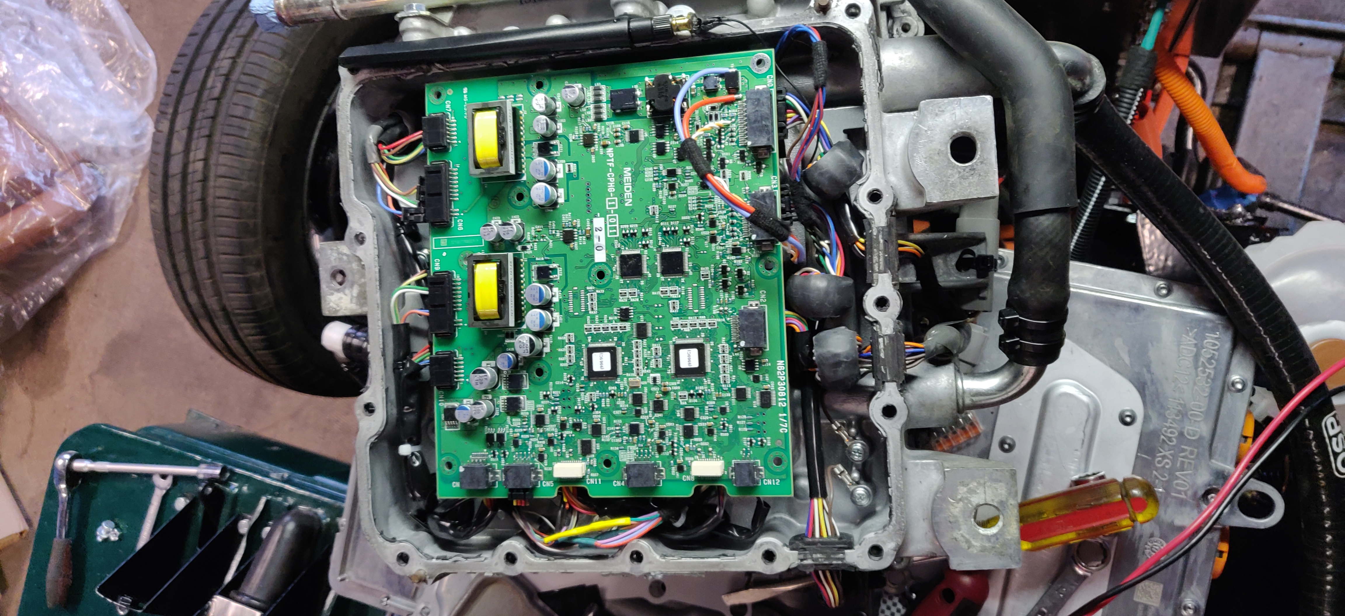

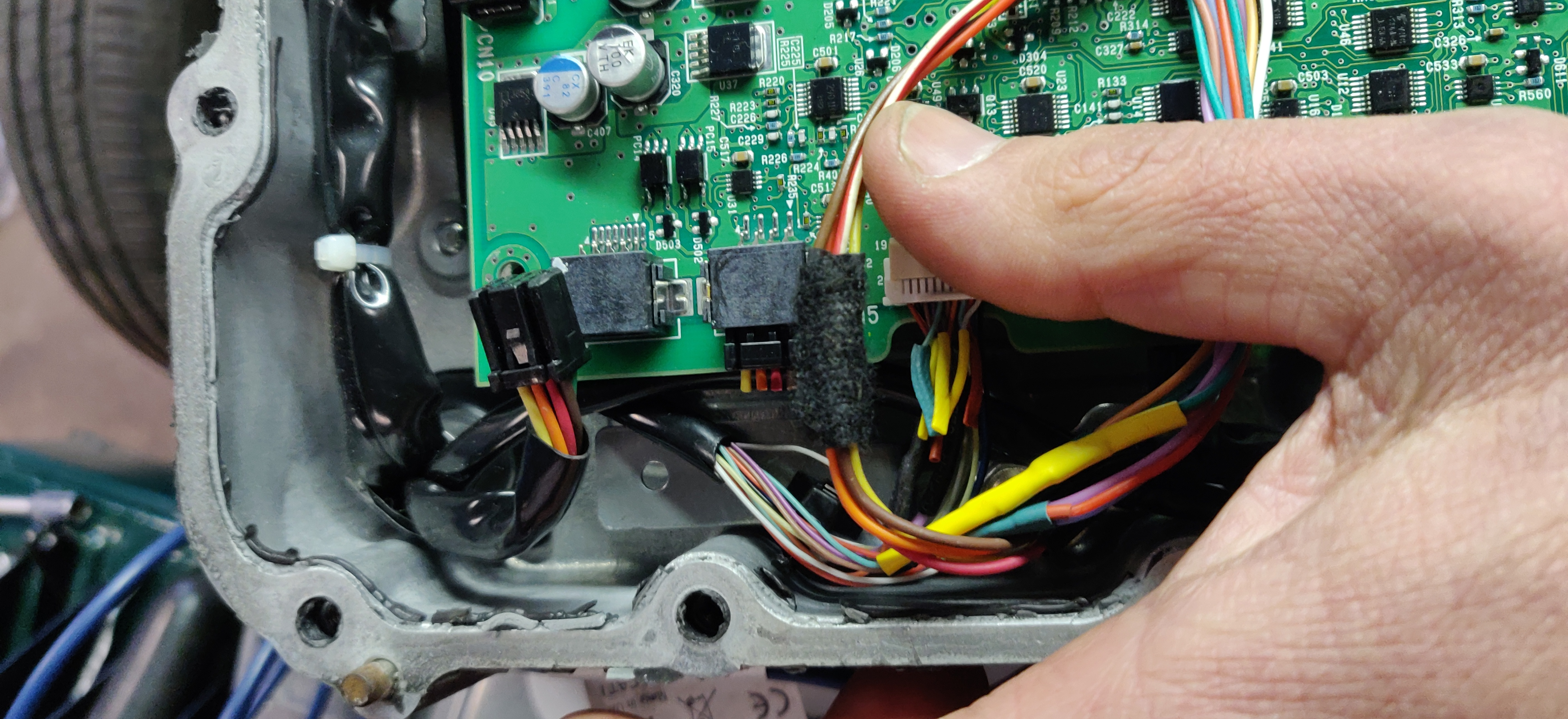

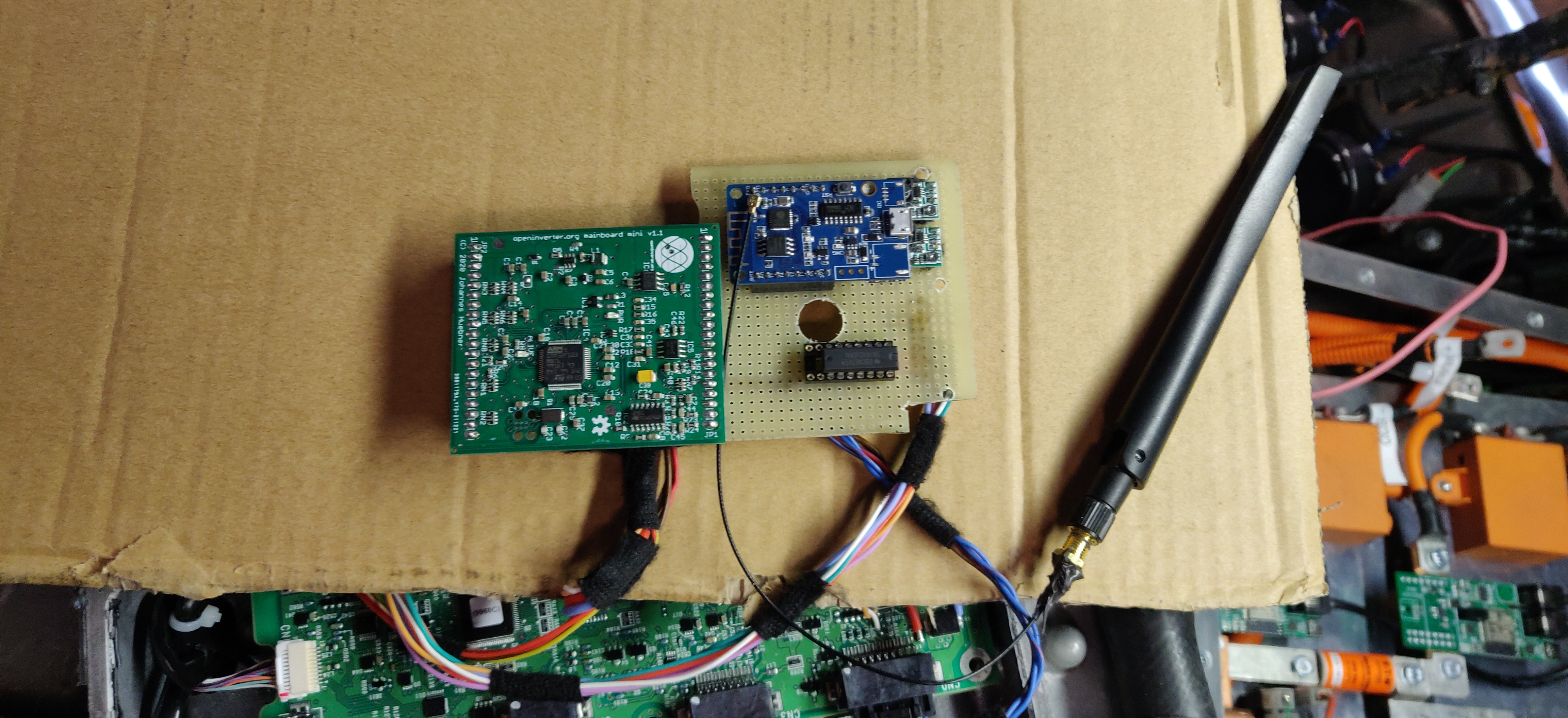

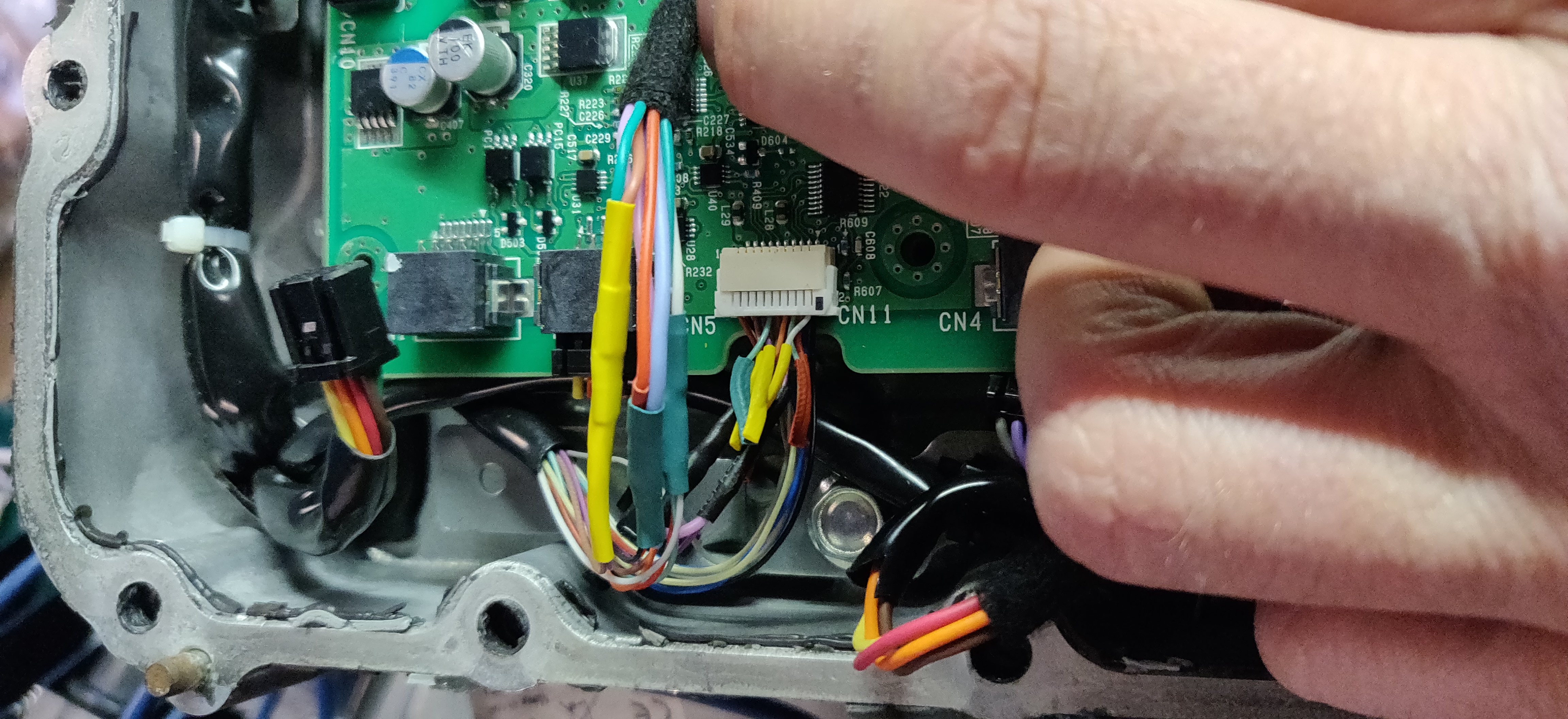

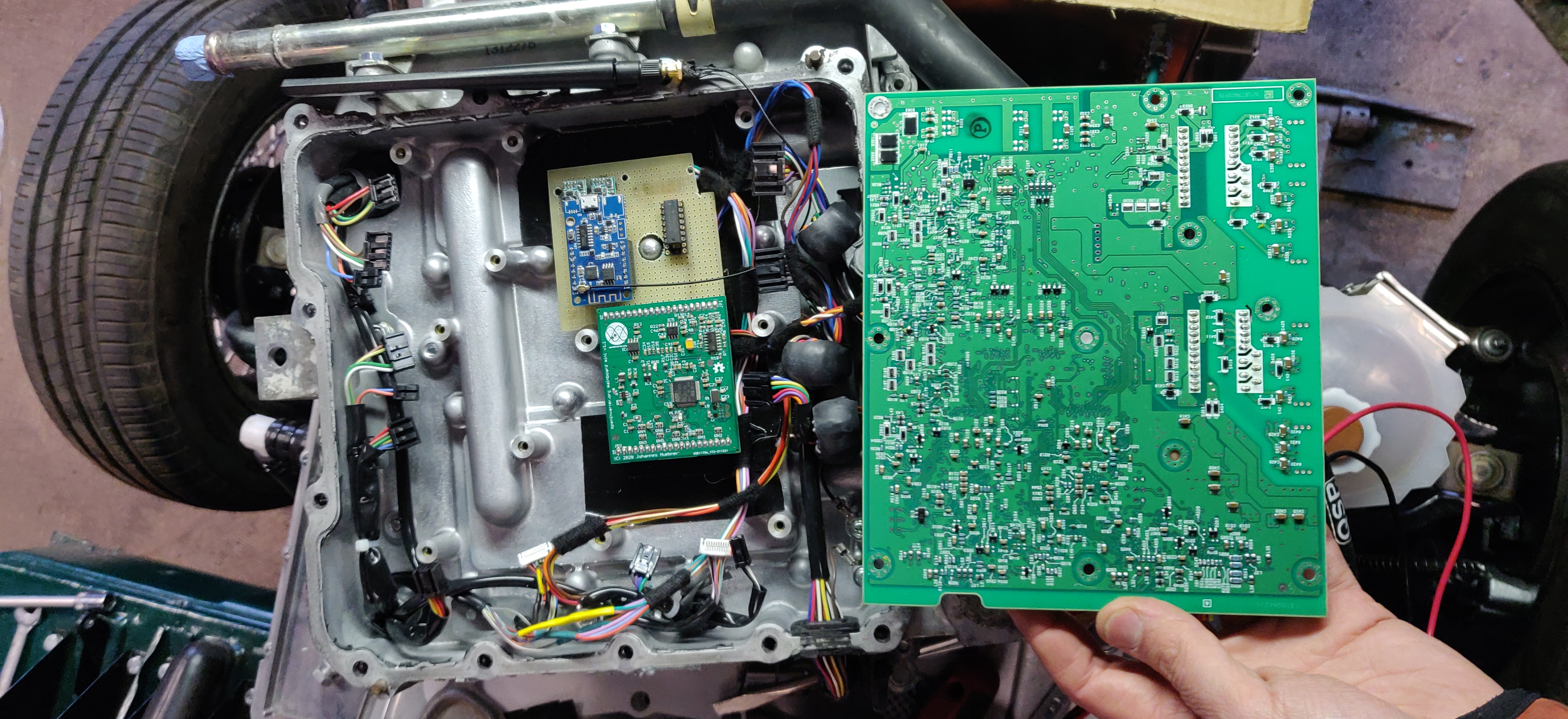

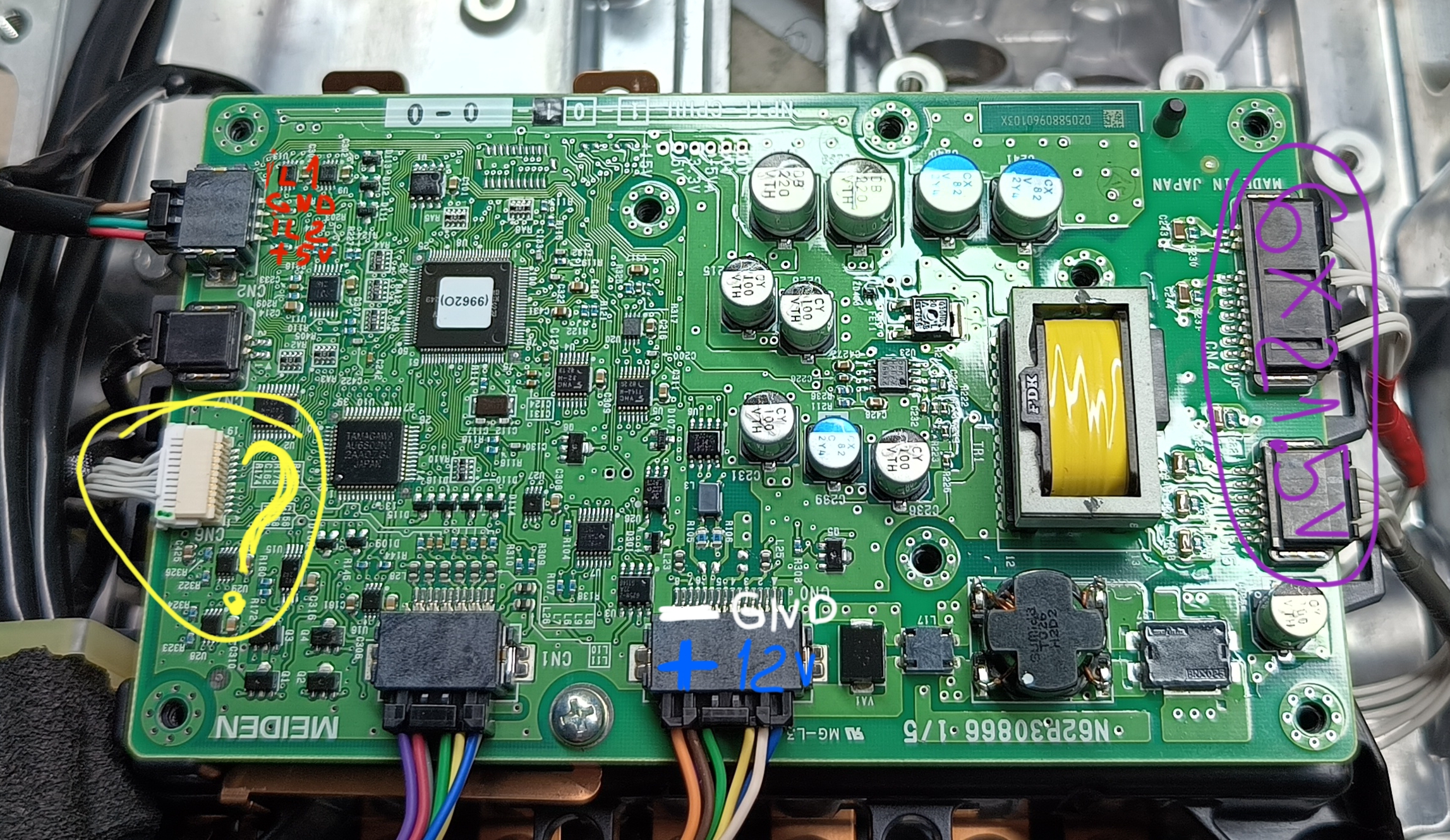

And because I still have the inverter open, I was able to take some pictures of course.
as said it is an open inverter mini, esp8266 wemos and 2x a 5 volt buck, one for the esp and one for the gates

Very neat, I like the external antenna to get the WiFi signal out the box!
Any pictures of the rest of the conversion?
Edit - once you've got it all working are you going to put some hot glue/silicon around those soldered joints on the Mitsubishi pcb to give the wire a bit of support?

as I understand I can make a low pass filter, the spikes I'm dealing with now are in the Mhz range, and as I remember correct the filter on the board is 55khz or so. strangely enough, it still comes through a bit. so if i am going to make a pre filter at 20 to 40 khz i think the signal that is left is good enough for the controller to respond to. because that spike is of course the pulse that triggers the hardware overcurrent. what would be your opinion on that? I did not have this problem with the Opel inverter, but it naturally has other current sensors. I have not known the signal from the Opel sensors, I could test to see how they respond.
with the opel inverter I did have the problem of oscillating the current, wouldn't this also have been the basis of that problem?
and bigpie uses the prius inverter with other current sensors and he does not describe these problems, would those sensors already have some output filtering perhaps?

At MHz frequencies it might be due to RF pickup or ground noise on the scope probe, you need to be pretty careful to get accurate measurements at high frequencies (difficult to comment without seeing the measurement setup). A low pass filter at 20-40kHz should be ok but it does all increase measurement delay which could make control loop stability worse.
If those pulses are real then they are very likely to be triggering the over current. I suppose the ideal would be to have heavier filtering on the feed to the over current comparator, not sure how easy that would be to arrange on that board though.
Bigpie does still get occasional trips although with the Prius inverter it's handled differently (no over current comparator on the OI board, all done by the Toyota driver board). We have a few ideas what may be causing them but nothing conclusive. Also when we tried high speed logging the current waveforms were a little odd at times, never really got to the bottom of that either.
Edit - if you use silicon on the wires make sure its the proper electronic grade stuff (the acid produced by the normal stuff while curing can corrode circuit boards). I usually use hot glue as it's quicker to set and a lot easier to remove if you need to rework it!

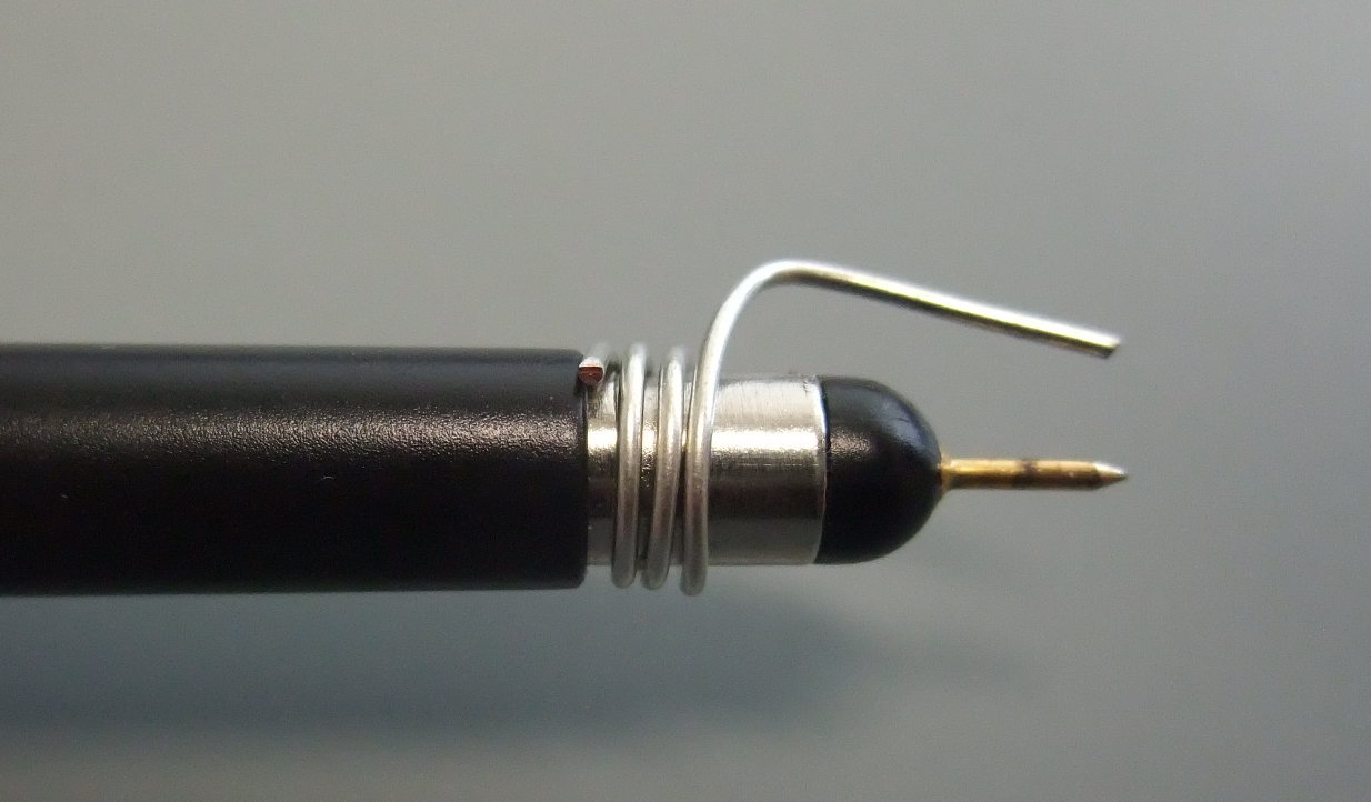

Just is case you are not aware of it the below is the best way to reduce the noise pickup when using a scope probe to measure a signal on a PCB:
Just remove the probe hook adaptor and the normal flying ground lead (which acts as an antenna or mag field loop at high frequencies) and replace with a small coil of solid core wire wrapped round the exposed scope tip earth connection. To measure find a PCB ground point near to the signal point, adjust the end of the wire to suit and press the wire to the ground point and the scope tip to the signal. With care you can measure pretty tiny signals in the presence of large amounts of noise.
High quality HF scope probes usually come with better versions of this (usually with insulation to reduce risk of shorting to the exposed ground).
Always use the x10 probe setting too!

I am well aware of how to measure higher frequencies. with this measurement I had a short ground loop and after the filter on the open inverter mini the signal really looks different. but I also don't think that the sensor is causing these pulses but that the problem is in the wiring. it always surprises me that shielded cables are not used when switching high currents so close together. but since everyone seems to do it that way and not really being warned about it, I thought it wouldn't be too bad then. perhaps I should also use an impedance resistor, since the input on the openinverter mini has a very high impedance. I'll check the datasheet to see if it says anything about that. and maybe I can measure the impedance at the original controller. if the spike is caught in the wire, that will also make a difference of course.

As a last resort you could do more low pass filtering. Be aware you likely need to retune syncadv so the motor doesn't run away at speed. And like Pete says, phase margin suffers but may not be an issue.
Nissan also don't use shielded cables for the current sensors, they are about 10cm long. No issues there, but shielding is certainly worth a try.

Thanks for the probe tip, I was already familiar with it. good thing you brought it up. it also seems strong to me that such high frequencies are transported by such wiring installed in this way, so it must be absorbed in the wire itself. I'm going to try shielded cable tomorrow with correct impedance at the input. if we have tackled this problem, we can move on to the other problem if it is still tare.

That makes a pleasant change, I've lost count of the number of professional electronics engineers who didn't know it
Agree that shielding will do no harm and is always sensible. Was the current input on the original board single ended or differential?
Edit - wondering whether it's a ground loop issue rather than radiated??

the original current sensor is single ended, the ground is connected about 1 cm from the ground pin of the openinverter mini. unfortunately it only has 1 ground pin that is quite far away from the analog inputs. I could possibly solder the ground of the current sensor directly to the openinverter mini as a last solution. I'll let you know how it goes tomorrow
edit - there is no ground loop in the current sensor part

I'm assuming that the supply/ground to the current sensor is coming from the Mitsubishi logic board?
Wondering whether the switching transient generated during the PWM transition is causing the logic board ground to move which is coupling onto the current sensor via its power supply and then coupling onto the signal to the OI board.
What is the ground connection between the Mitsubishi logic board and the OI board like? Would it be possible to reduce it's inductance/impedance at all?
Edit - just seen your edit, please ignore if not relevant!
Re: Mitsubishi Outlander Front Inverter running openinverter, overcurrent issues
No the current sensor is completely disconnected from the original controller. Sensor has one ground and that is connected about 1cm from the openinverter mini ground pin. 5 volt is coming from one of the 5 volt buck converters in my board, couple centimeters away. I use a split copper wire as a ground in my board. The power from the Mitsubishi controller to my board is directly from the 12 volt input. And only one thick ground between them. The pwm signals are opto couplers inputs and all the supply for that is coming from my controller.
Pete9008
- Posts: 1801
- Has thanked: 102 times
- Been thanked: 350 times
That all sounds good, as you say ground loops shouldn't be an issue there.
Guessing it must just be capacitive coupling from the bus bar, it will be slewing by a few hundred volts so not that surprising. I think most OEM inverters rely on sampling at a quiet point on the PWM waveform. Unfortunately OI doesn't do that due to complications with the way the resolver is driven. I did have a look at changing it but there were too many issues associated with backward and hardware compatibility so gave up on it (details somewhere in the simulator thread). Still plan to implement it on my install though. That being said I'm not aware of it causing any issues on other installs.
Will be interesting to see if the oscillation persists once you have this inverter set up and working. I see something very similar in the simulator and am keen to know whether it occurs in reality too.
Yes I'm also very curious to see if the oscillation is there or not as soon as I solve this issue. Keep you posted.
Thanks for the help for now, very appreciated
