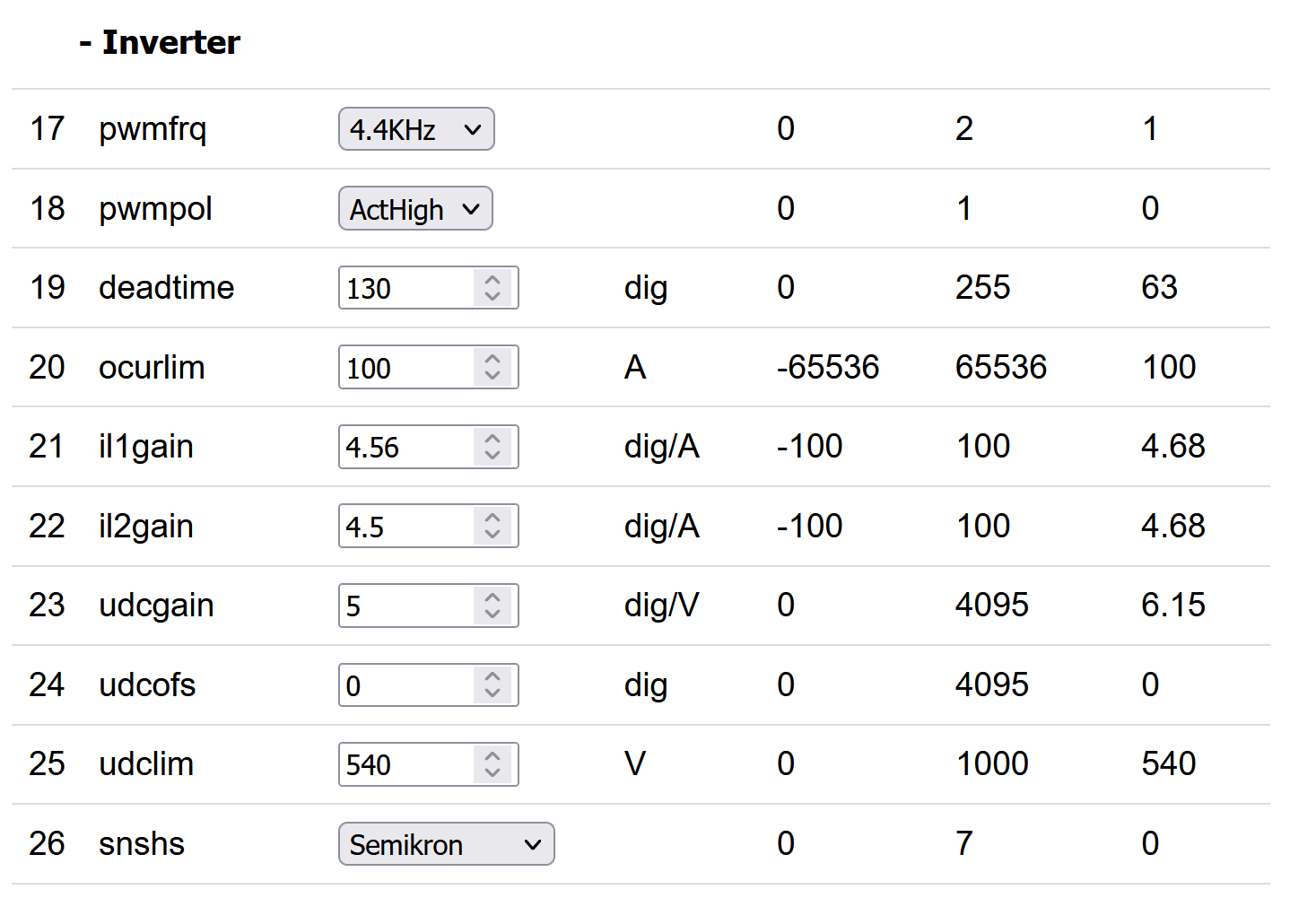

For the next step we installed the 5.20 sine f/w and set inverter the parameters as per the wiki:

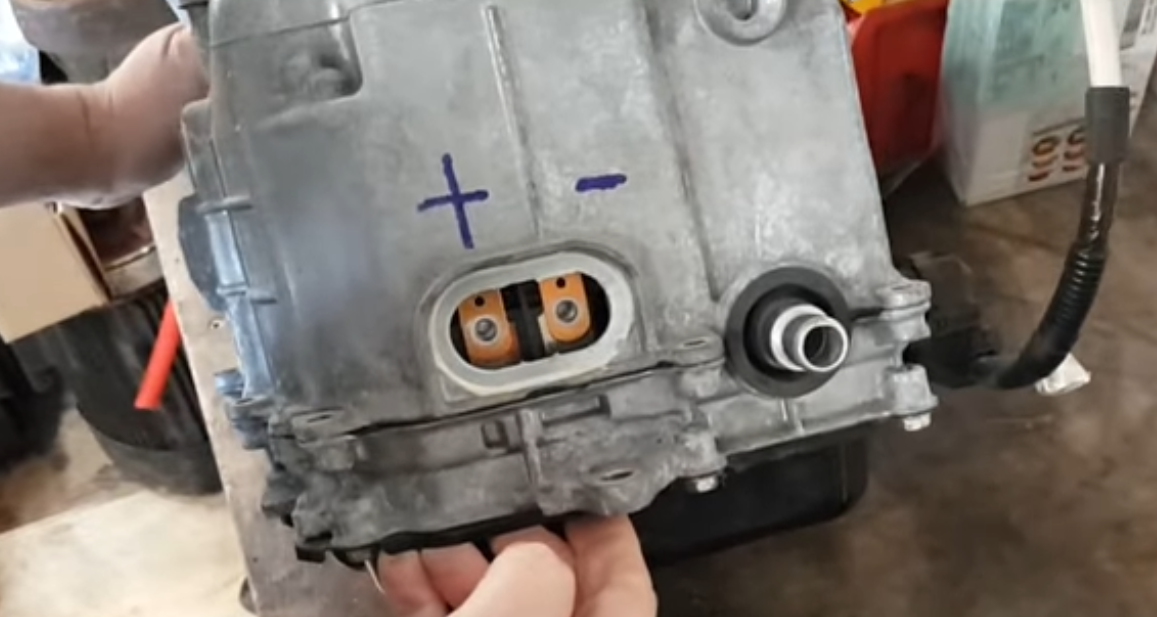

The Outlander motor / gearbox was connected to MG2, a 12v supply to the inverter Pin 1 and Pin 3, and Pin 11 to GND, and we used a 12V 5A regulated power supply to the battery input terminals as per Damiens Gen 3 instruction video:
When we start the inverter in manual mode, and set fslipspnt to 10 and ampnom to 100, the motor vibrates, but doesn't spin.
The log file looks like this:
So the question is what have we missed / are we doing wrong?
Is there any more information I can supply to help with trouble shooting?
