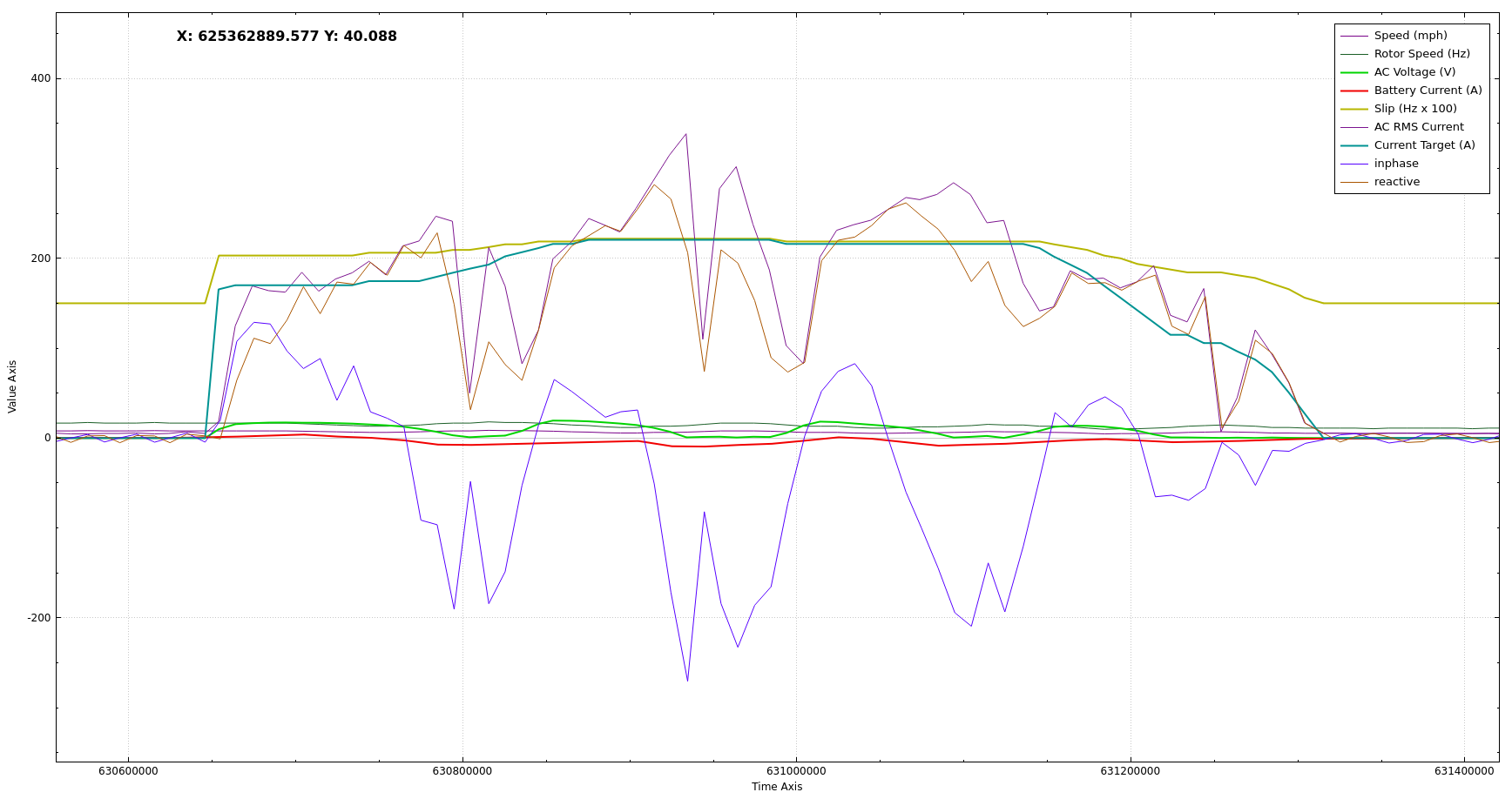

I loaded the inphase and reactive current logging firmware into my car today and went for a drive. Here are some results.
Hard acceleration 0-60
Steady driving 50% current
Very low speed creeping
Regen (selected by changing slip direction with selector while rolling)
Some of this data makes a lot of sense to me. Some of it less so :)

Interesting results but I must admit I'm struggling to see where you are going with this (which is why I haven't commented previously).
As far as I can tell you have invented a new and novel way of measuring the real and imaginary power going into a 3-phase motor?? ;)
The transforms look like they are working well now.

Pete9008 wrote: Fri Feb 10, 2023 3:34 pm Interesting results but I must admit I'm struggling to see where you are going with this (which is why I haven't commented previously).
You are correct that I have no idea where I'm going with this, but I'll try to explain how I got here!
At the moment, we generate three phase voltages at a desired frequency, and I wanted to work out how I might get from that starting point, to instead directly controlling current.
The first question I had was how the phase currents differed from the phase voltages. It seemed that the best way to represent this was with two-dimensional plots. Then, rather than having to plot two-dimensional voltage, and two-dimensional current separately, and try to compare them, I decided to rotate the current measurement by the voltage angle to create a two dimensional plot that directly represents the two-dimensional difference between commanded voltage, and measured current.
On the topic of current control, when it's time to make my three sine waves into current targets rather than voltage outputs, I hoped this data might give me clues about how best to modify the voltage and frequency outputs to achieve a desired current. The obvious approach to current control is still to measure each current, then output a voltage correction on each phase accordingly, but I wondered if this might offer ways to make the same corrections but in a rotating reference frame with much less gain.
However, while this isn't really what this thread was supposed to be about, but I got super interested in this real/imaginary power plot, for a couple of reasons, most notably because if there is an optimal balance between real and imaginary power, I thought I might be able to adjust slip automatically to achieve it, giving optimal results at any speed without the need for manually configured slip limits.
Ultimately, I feel like the more ways I find to examine the data, the more I will understand the operation of the motor.
Pete9008 wrote: Fri Feb 10, 2023 3:34 pm As far as I can tell you have invented a new and novel way of measuring the real and imaginary power going into a 3-phase motor?? ;)
Yes, this is probably an unnecessarily obscure way to measure this, rather than just multiplying the voltage and current on each phase. It's just where I ended up when I started trying to look at current in the rotating reference frame.
I found a couple of papers on controlling induction motors on the basis of real and reactive power:
https://digitalcommons.lsu.edu/cgi/view ... ool_theses
https://www.researchgate.net/profile/Re ... ion_detail
Ultimately, these seems to be a correlation between slip, and the ratio of these currents, so understanding how they behave may be beneficial. I don't believe this necessarily helps with the problems I was trying to solve though. Just an interesting tangent!

catphish wrote: Fri Feb 10, 2023 4:02 pm On the topic of current control, when it's time to make my three sine waves into current targets rather than voltage outputs, I hoped this data might give me clues about how best to modify the voltage and frequency outputs to achieve a desired current. The obvious approach to current control is still to measure each current, then output a voltage correction on each phase accordingly, but I wondered if this might offer ways to make the same corrections but in a rotating reference frame with much less gain.
I can't help but think that this is the way you will end up doing it. Which reference frame it is best/easiest to do it in is a very good question (and I haven't a clue)!
catphish wrote: Fri Feb 10, 2023 4:02 pm However, while this isn't really what this thread was supposed to be about, but I got super interested in this real/imaginary power plot, for a couple of reasons, most notably because if there is an optimal balance between real and imaginary power, I thought I might be able to adjust slip automatically to achieve it, giving optimal results at any speed without the need for manually configured slip limits.
Doing something just because it might help understand the system is an excellent reason in my book :)
catphish wrote: Fri Feb 10, 2023 4:02 pm I found a couple of papers on controlling induction motors on the basis of real and reactive power:
With zero (unachievable) slip the Iq and Id you calculate are actually correct for the rotor field. As the slip increases the vector rotates and more current appears to be transferred from d to q. So, as you say, the ratio could be thought of as a way of measuring slip.
Very interested to see where this ends up going.
EDIT - just twigged what the ripple on the Iq and Id plots is, it's the 5th harmonic distortion isn't it! That would mean that if you use Iq and Id in the control loops it should still eliminate the harmonic content (and avoid the three individual phase current controllers from fighting each other which is something that's been bothering me). I think you may be on the right track here :)

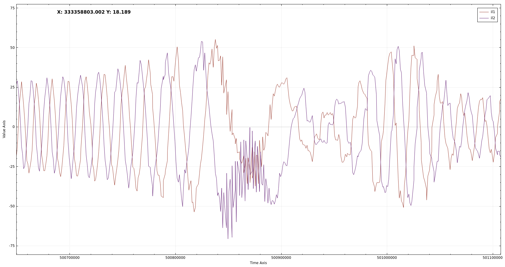

Here's my initial attempt at realtime per-phase current control: https://github.com/catphish/stm32-sine/ ... #L86..L118
Here's what the result looks like on the bench at low frequency:
And high frequency:
And here doing a sudden direction switch (peak target current set to 50A):
High frequency oscillations can be seen when operating at low frequency. Clearly some more work is needed, but it's looking promising so far.
Edit: Just to clarify, waveforms aside, the motor appears to run perfectly / smoothy but with no load, this is only a very rudimentary test.
Edit2: It's worth noting that I've increased the frequency the calculation runs from 4.4kHz to the full 17.6kHz. I wonder if it would be worth doing the same on my main current control branch.

I think tomorrow I will re-run this test with an oscilloscope attached to the current sensors so that I can see what the waveform really looks like (ie better than 1ksps resolution). I will also look at plotting the voltage output for comparison.
It seems my gain is probably a bit too high, hence the oscillation, but I suspect this may actually be improving high speed performance as the overshoot becomes "predictive" at higher slew rates.
