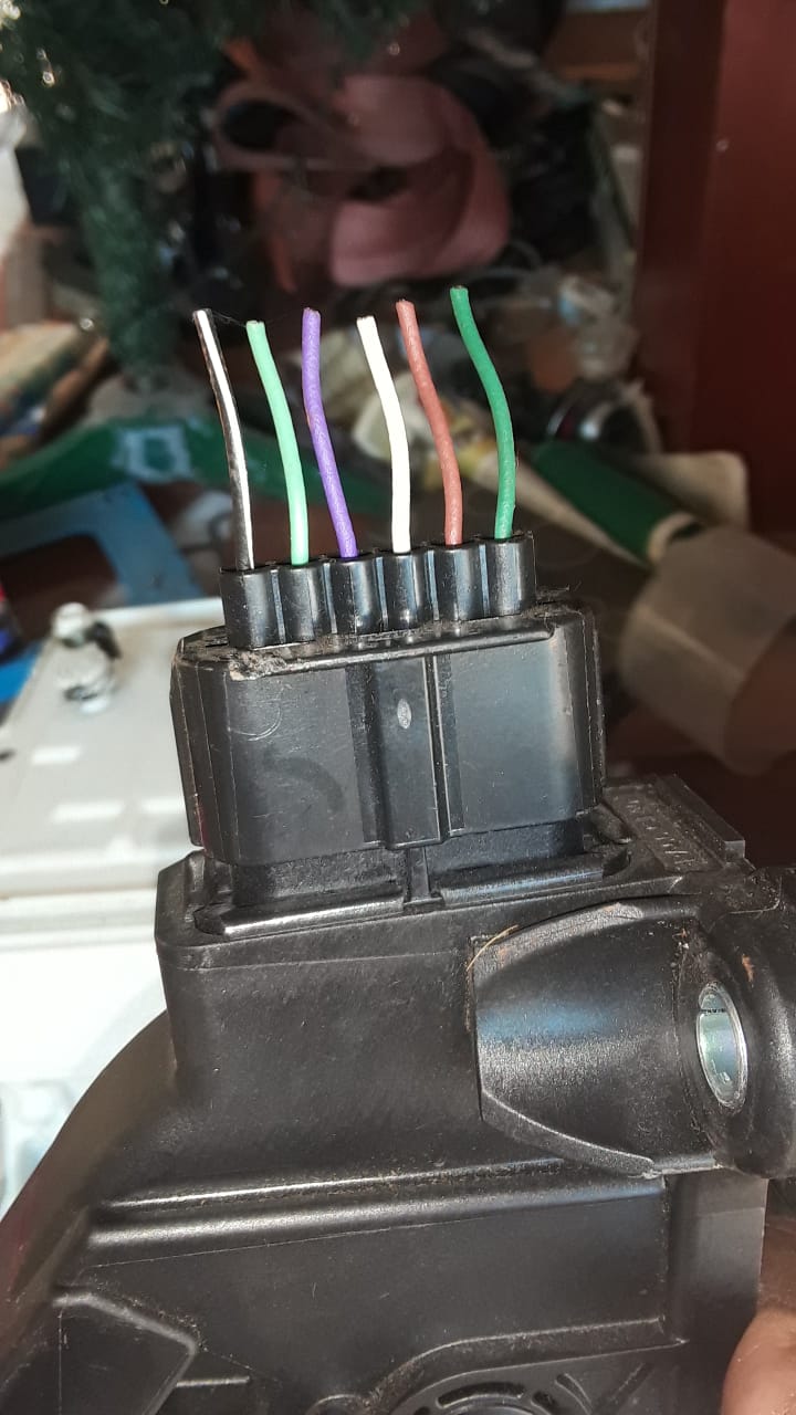

Does anyone know what the 6 wires on the Mitsubishi Outlander accelerator pedal do?
I need to connect to ZombieVerter.

There is a link to the full workshop manual:
http://mmc-manuals.ru/manuals/outlander ... dex_M1.htm
Scroll down to
Circuit diagrams >
electric motor control system>
page 7
