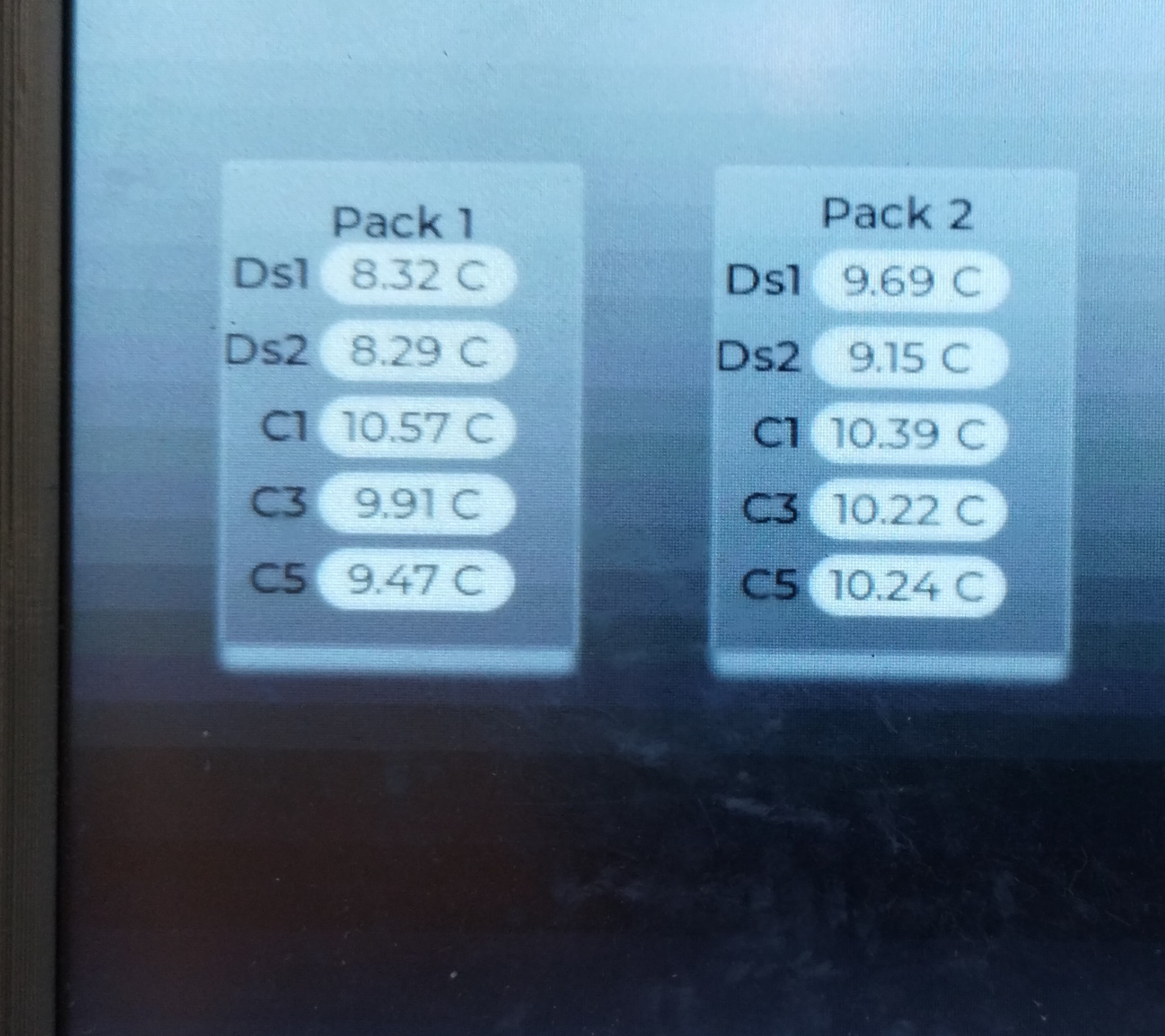

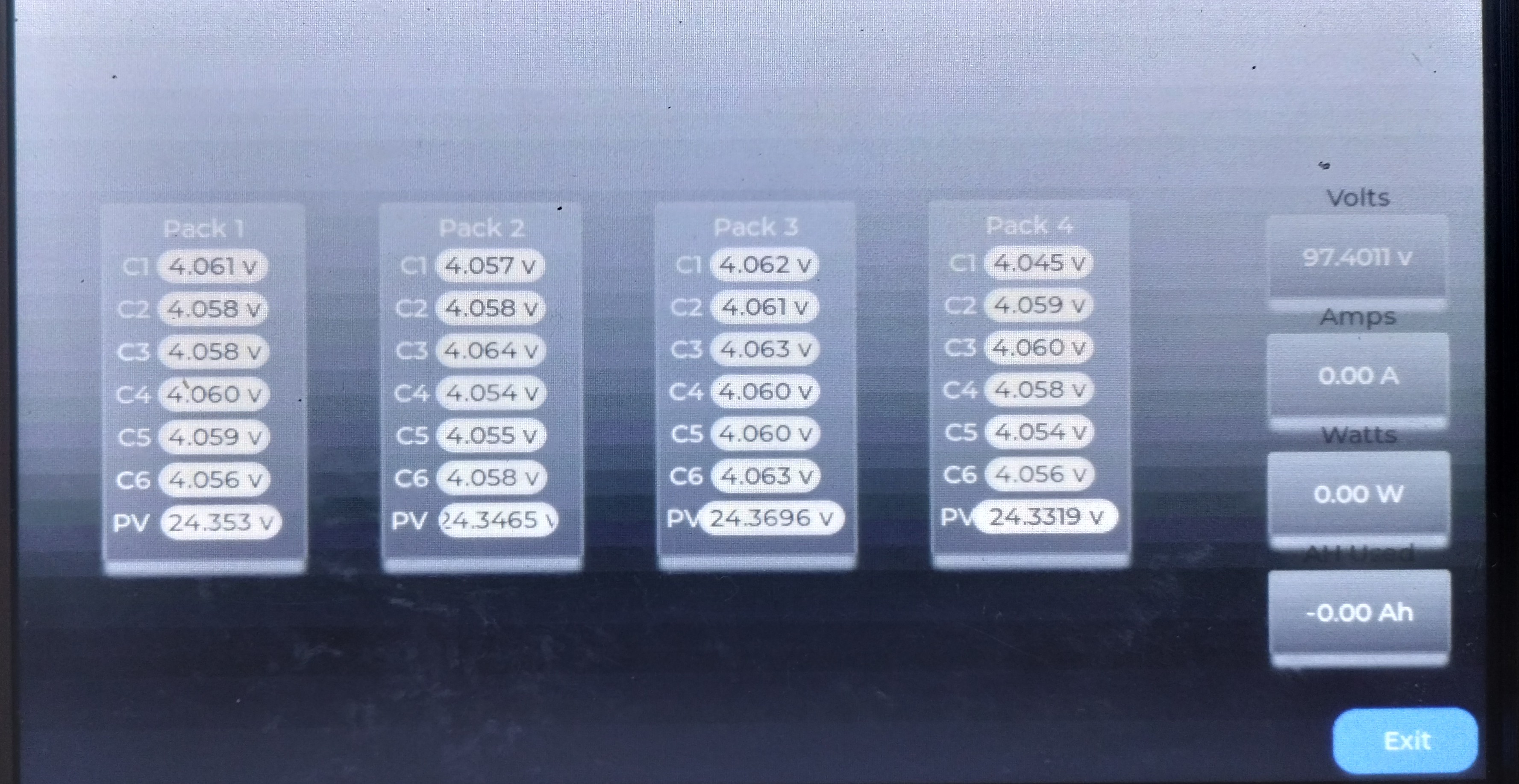

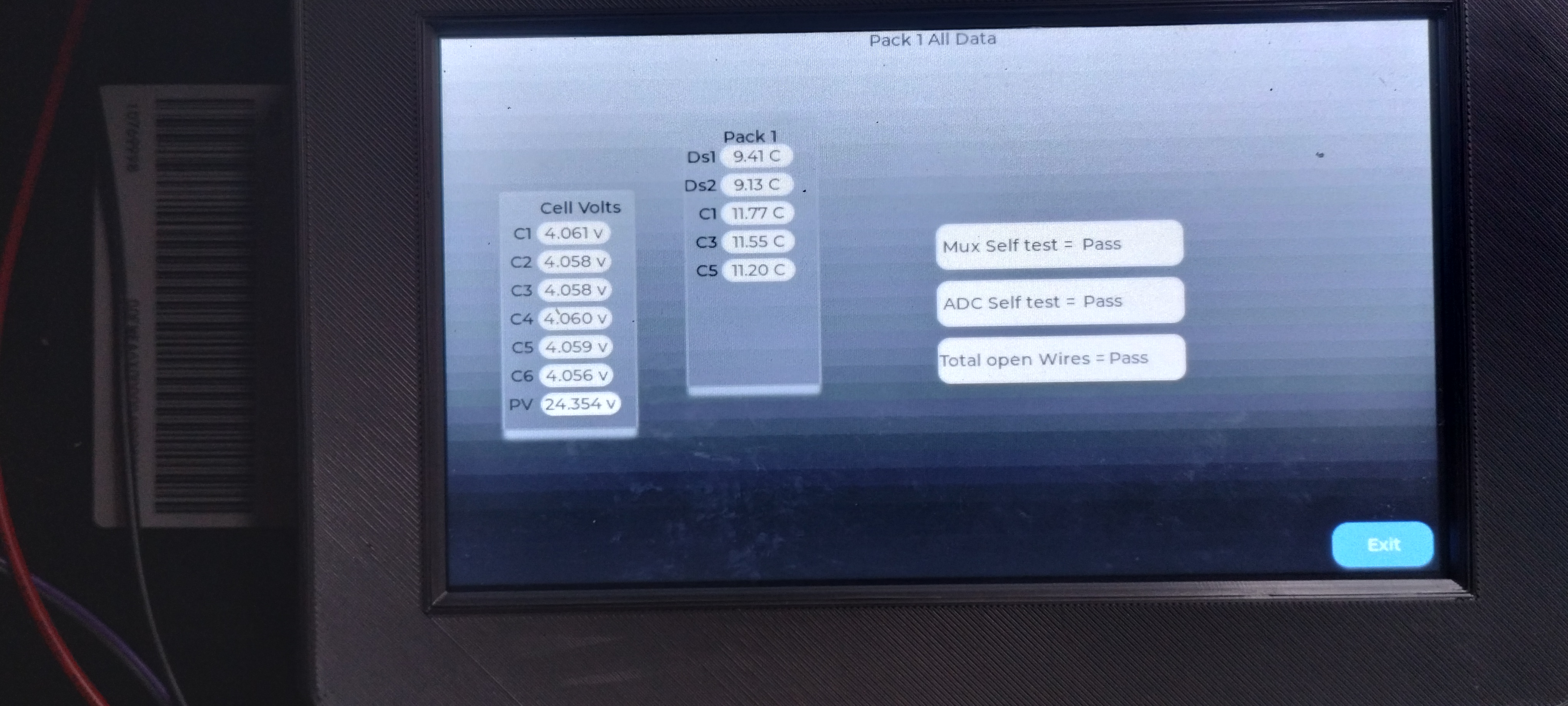

Thanks for this info, I'm sure it will be useful, I hope to include on the software I have written so far in platform io. Here are some pictures of my BMS unit so far, still a working progress.
The cell voltages
Cell temperatures
And the self test of each BMS
And the result
The graphics needs more aligning etc , but it gives u an idea of what I'm building 😁

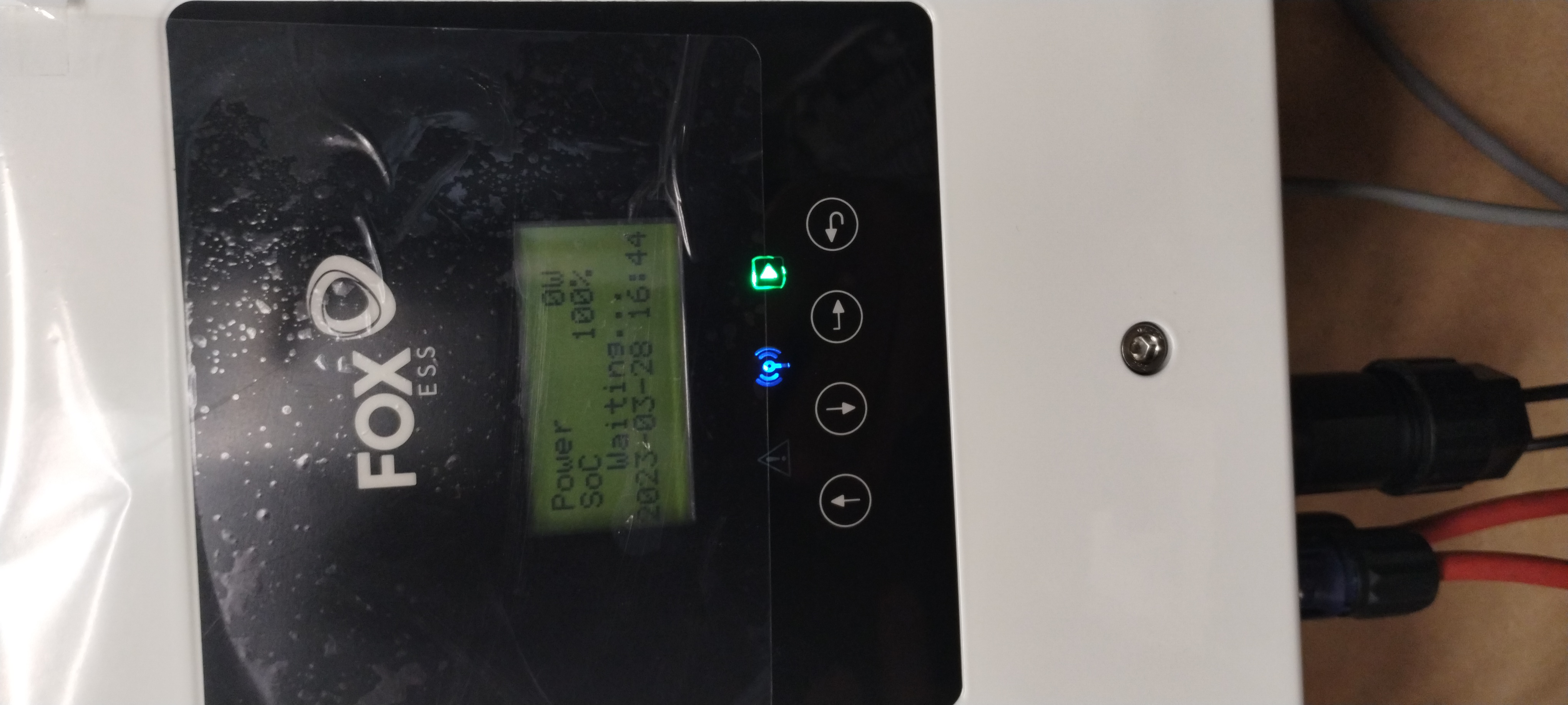

hi,
I bit the bullet and have purchased the fox H1 6kw inverter, I have it wired in my garage with the mains and batteries and my BMS controller, also with the current probe on the incoming mains so this thinks the garage is the load just for test purposes only. I have 4 mg zs modules wired to the inverter and is all powered, If I trip the AC to the inverter quite happily runs off the batteries and reports grid fault as you would expect.
I have written the Can bus code to follow the response frames as on the rand12345/ solax_can_bus data. The inverter powers up and the warning light is no longer flashing, reports SOC of batt at 100% but the green indicator is flashing and inverter reports just Waiting and never gets any further here is a sample of the data on the can bus
23 Receive 23:03:17:106 Data frame Extended frame 00001871 8 01 00 01 00 00 00 00 00

this is the reply my BMS is based on
ID b0 b1 b2 b3 b4 b5 b6 b7
0x1872 slave_voltage_max max slave_voltage_min min charge_max max Discharge_max max
0x1873 pack voltage voltage current current capacity capacity kwh kwh
0x1874 cells_temp_max max cells_temp_min min cells_mv_max max cells_mv_min min
0x1875 int_temp int_temp 0x01 0x00 0x01 0x00 cell_voltage_min 0x00
0x1876 0x01 0x00 cells_volts_max max 0x00 0x00 cells_volts_min min
0x1877 0x00 0x00 0x00 0x00 id 0x00 byte1 byte2
0x1878 pack_voltage_max max 0x00 0x00 wh_total wh_total wh_total wh_total
Any suggestions or help appreciated :)

Oh some pictures
And what the inverter is showing, the green light is flashing

Posted: Tue Mar 28, 2023 6:34 pm
by woleg
Ok, there's a few scaling errors in your can bus data and a few other things.
https://i.imgur.com/ytaXUM1.png
0x1873 "Voltage" is scaled wrong. It's decoding at 10x your actual voltage so correct that with * 0.1
Don't send 0x1881 and 0x1882, those are to do with initialisation.
0x1877 is missing, this contains the firmware versions of the supposed BMS master and slaves.
Use this calculator to work out your can frames. https://github.com/rand12345/solax_can_ ... ox-BMS.ods
Then take a look at the example Solax and Fox (pretty much the same) tables for examples of 0x1877 frames.

Re: Fox ESS H1-5.0-E ~33KW Peugeot E208
Posted: Tue Mar 28, 2023 8:27 pm
by Kevin
Wow that worked , didn't have full time to test but could hear the contactor in the inverter a 60s timer and doing several other tests then powered up, but I forgot my garage is on a 30ma RCD and when the inverter cut in this tripped, but the eps cut in so think it's working
Will have to remove RCD as it's not recommended in solar inverter installation or at least a 100ma one, thanks again for your help, and yes I will help anyone who needs it.
