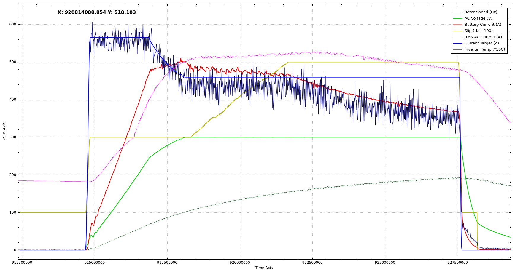

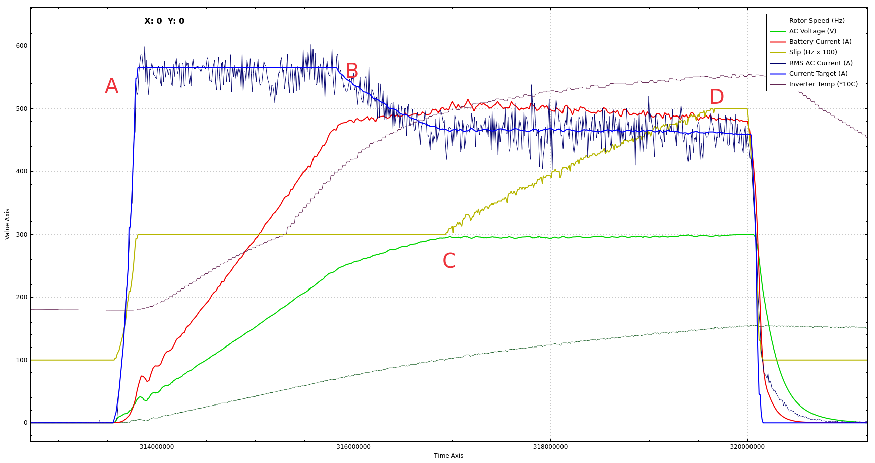

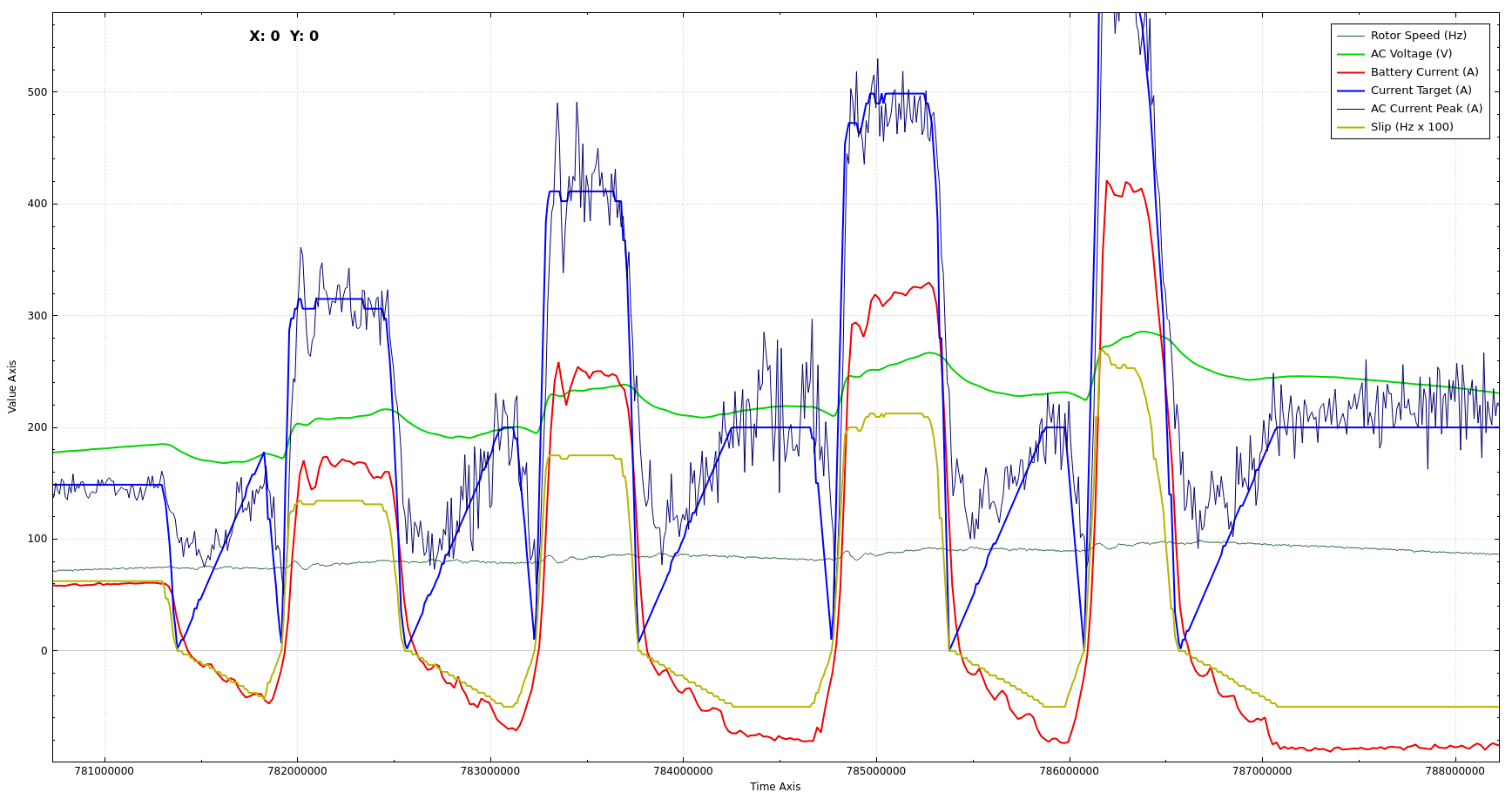

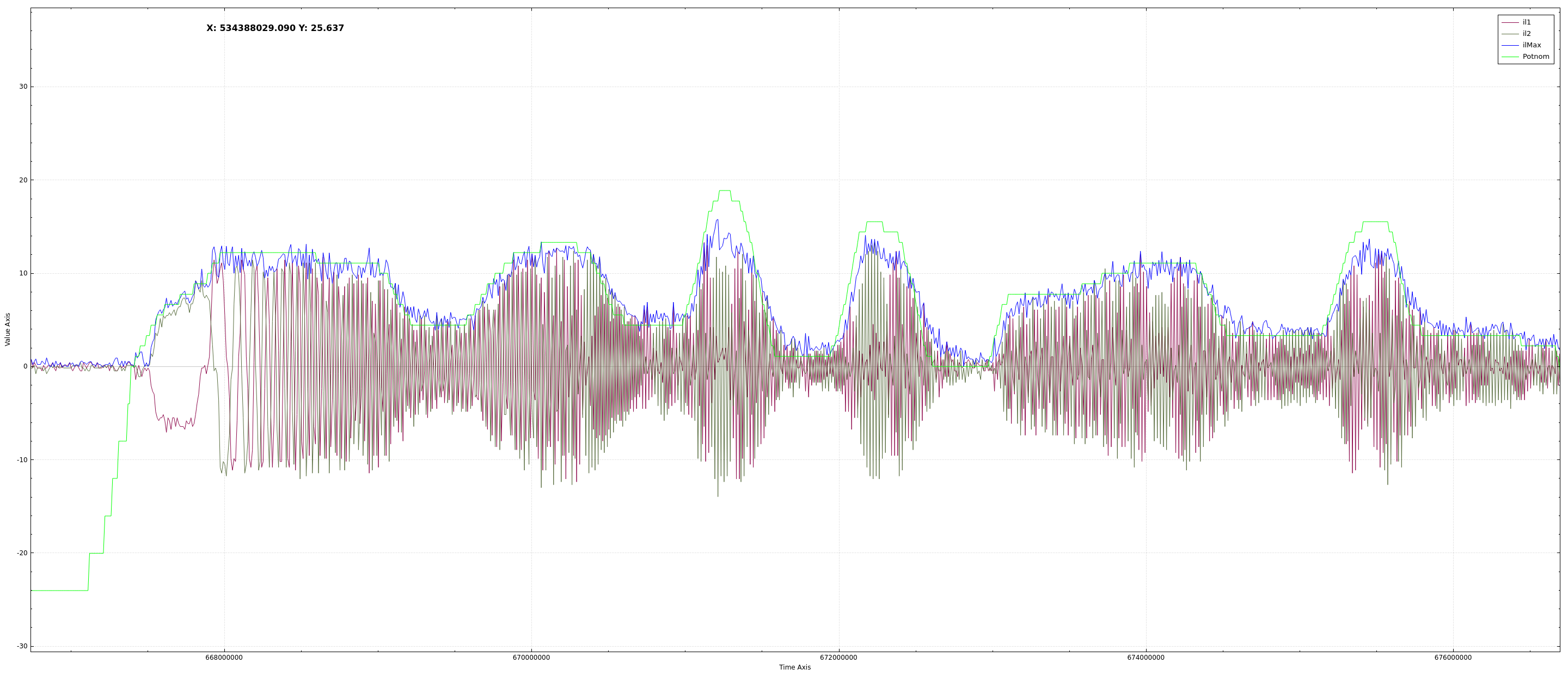

Here's a couple of graphs of the algorithm in action. The bottom graph shows acceleration. I find it very interesting how this clearly demonstrates the expected V/Hz curve with automatically determined boost. The other shows steady state.

Looking good, very interested to see how you get on with this but afraid I can't help as I know nothing about induction motors (except what I've learnt from your posts )

I tried something similar (thus the existance of ilmax) couldn't get it to work, decided V/Hz was good enough and gave up. So glad to see you picking this up again

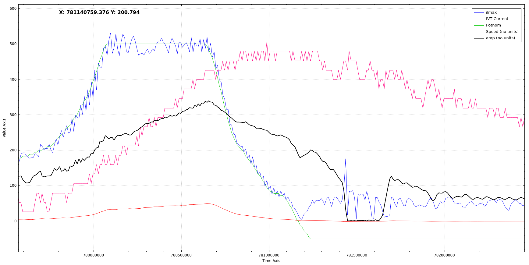

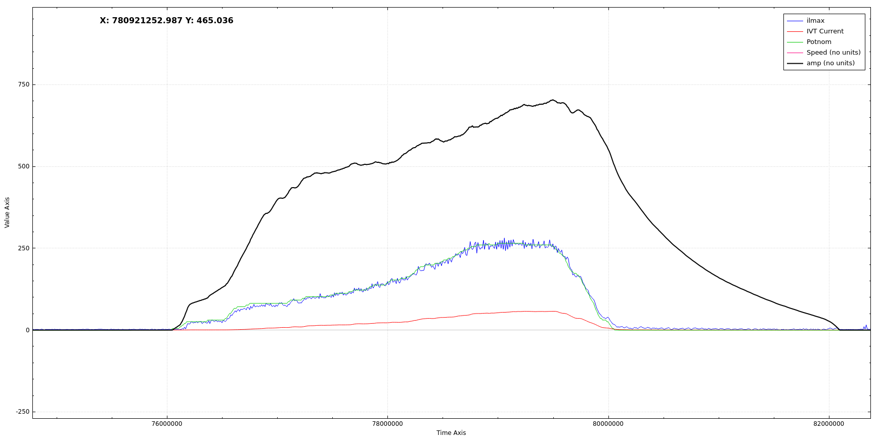

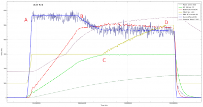

Here's another example of what this code does. This is ilmax following potnom. Throtcur is set to 1A per 1%.
I think I'm now at the stage where I'm ready to test this with a bigger motor.
Latest code, fully annotated: https://github.com/catphish/stm32-sine/ ... d93364c11b
As the graphs show, regen current seems to overshoot its target a bit. I suspect this is because the rotor speed is dropping so quickly. Hopefully in a real vehicle and with careful tuning of the loop, this effect won't be too noticeable.

Looks good
Couple of questions - Is the motor changing direction in that second plot but not in the first plot? Also is there a max current limit set that stops it following the higher potnom values?
- catphish
- Posts: 955
- Location: Dorset, UK
- Has thanked: 94 times
- Been thanked: 179 times
Re: Current control of induction motors
In these plots, the motor is always spinning in the same direction. When potnom is less than zero it is doing regen. Currently it has no concept of "negative" current, so it just matches positive current with (negative) requested regen.
The reason the current sometimes couldn't reach the target is because the motor was spinning too fast and the voltage was already maxed out. Later, I will add code to increase slip above its normal target once there's no more voltage to give. (ie field weakening).
Right now with no load on the motor it can do 0 to 100% speed and back to 0 in a fraction of a second if I request full torque.

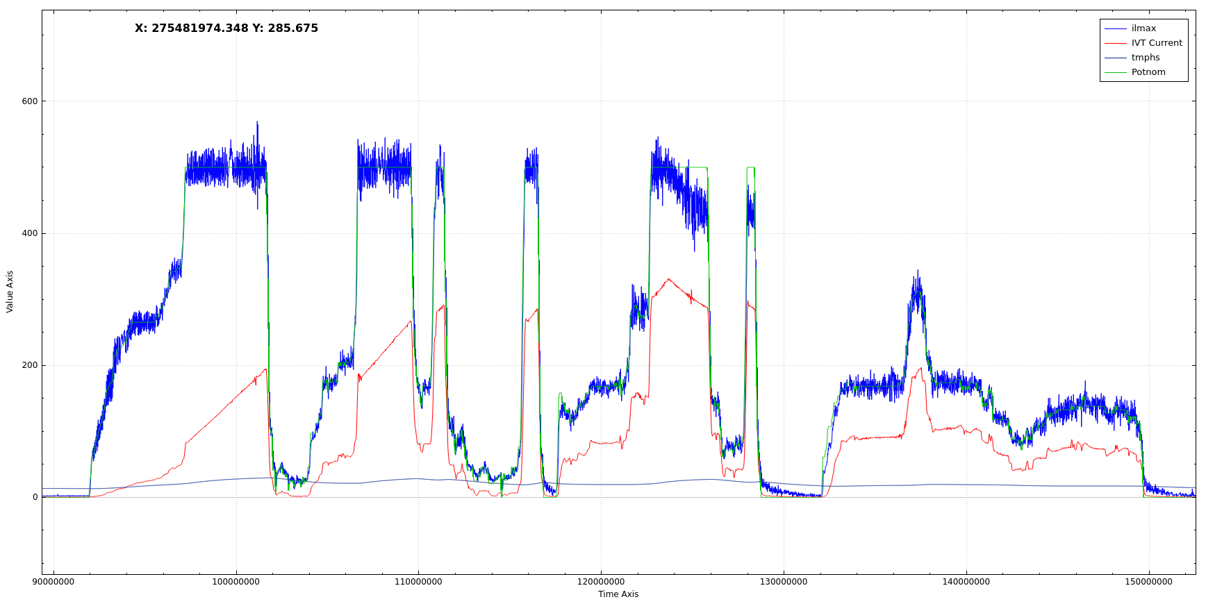

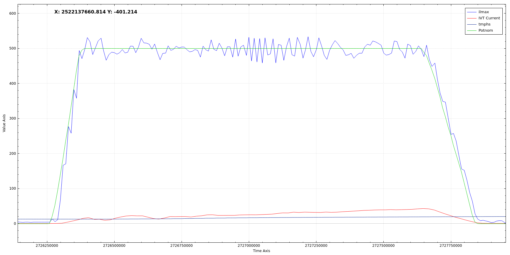

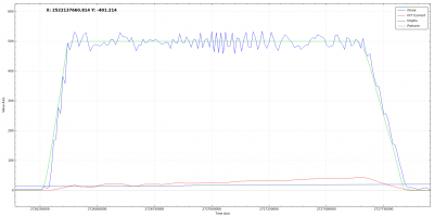

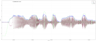

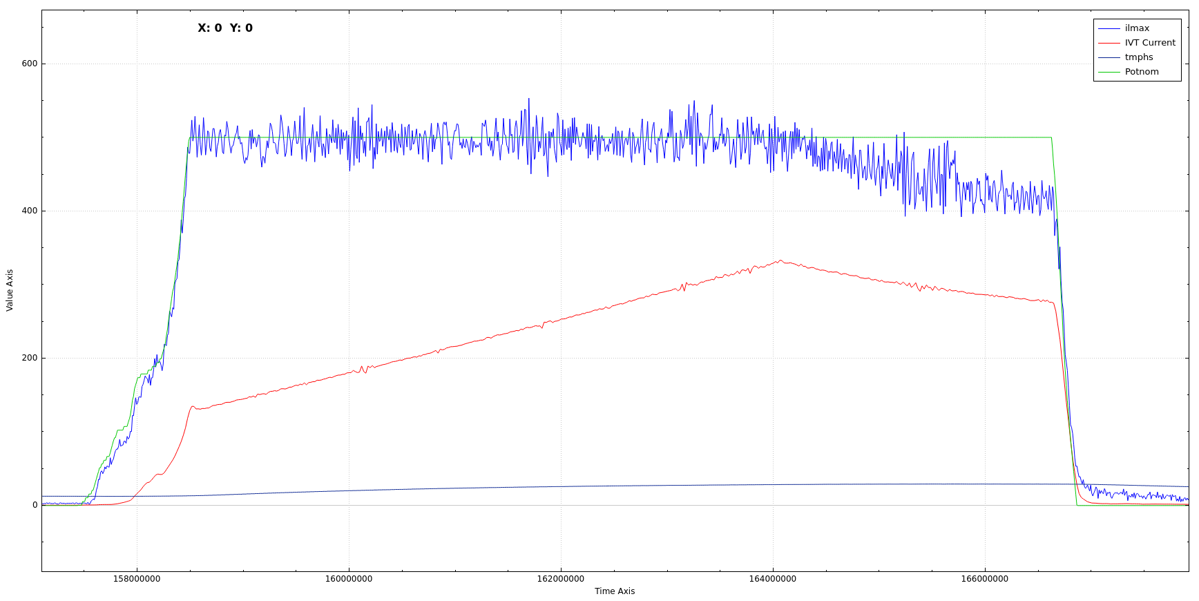

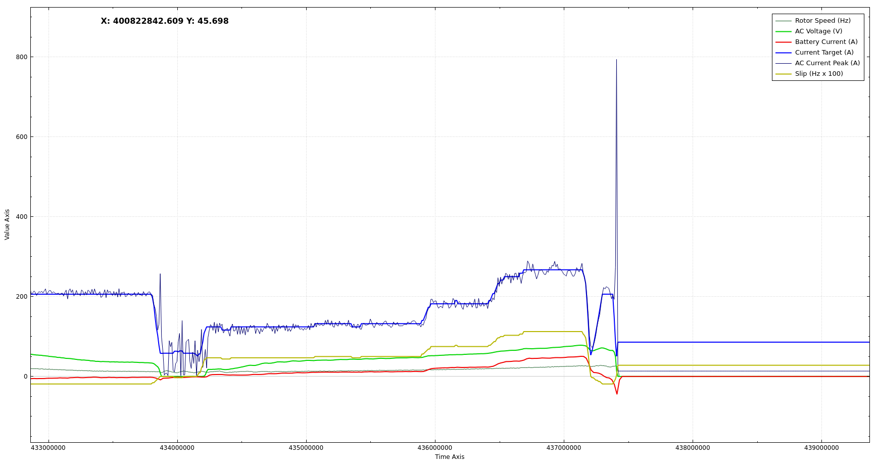

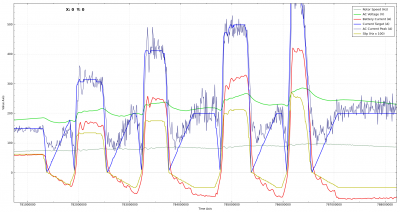

Today I decided to go ahead and test this code in my car. The initial results are extremely positive. When positive torque is requested, AC current is controlled perfectly. I was able to set a current of 500A per 100% throttle and it was followed precisely.
With regard to "feel", I would say this is a lot smoother than the old code during low speed maneuvers like hill hold and accelerating forwards from a slow roll backwards. The torque during general driving is also very consistent and predictable.
I will definitely be preferring this firmware for my daily driving while I continue to work on it.
Attached are charts of:
* Full throttle 0-60 with a gentle start
* Various driving
* Instant throttle press followed by instant throttle release
Unfortunately, regen braking is not working correctly. More on that in in the next post.
* Various driving

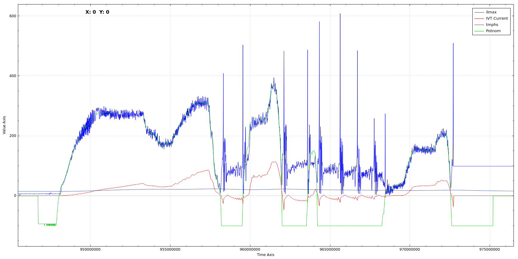

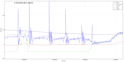

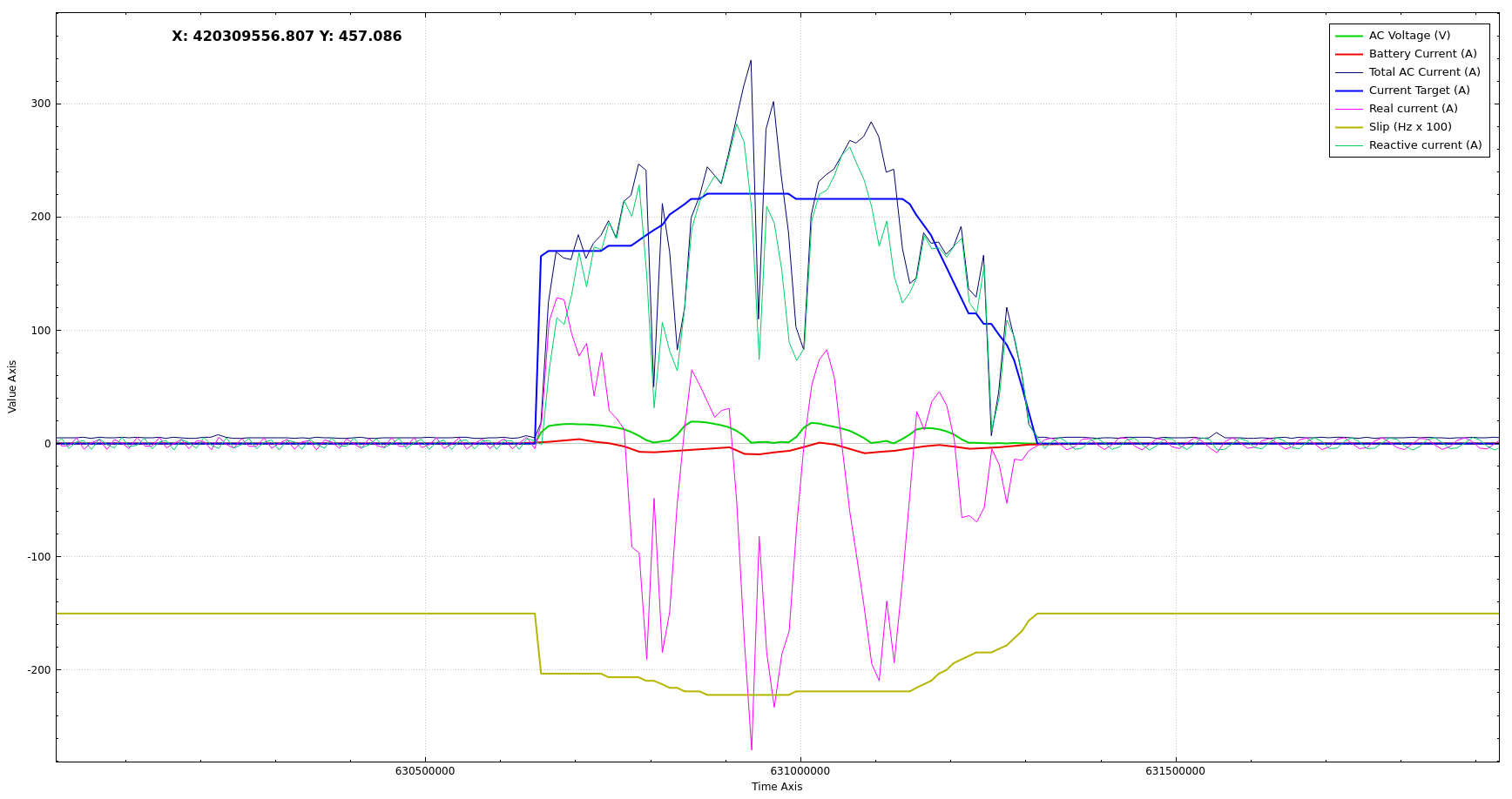

Now we get on to regen. This has turned out not to be so simple. The key problem is that I see large unexplained current spikes, usually as soon as regen is activated.
This seems to be backed by the fact that when current rises above the target, "amp" is reduced, and suddenly the current spirals until amp hits zero and the inverter stops switching.
However, this is not sitting well in my mind, because I can clearly see that the existing firmware increases regen by increasing AC voltage, and decreases regen by reducing DC voltage!
After staring at these charts for a few hours, the conclusion I seem to be reaching is that during regen, the inverter must be operating as a boost converter (converting low voltage 3 phase AC to higher voltage DC). This means that lower AC output voltages will actually *increase* current through the motor and inverter.This seems to be backed by the fact that when current rises above the target, "amp" is reduced, and suddenly the current spirals until amp hits zero and the inverter stops switching.

The inverter has to boost during regen in order to puch current onto the DC bus, is that what you mean?
Not sure I understand induction motors so the following questions could be rubbish.
Does the slip change direction when you move from drive to regen?
What happens to the current in the rotor when you switch from drive to regen, does it change sign? If so do you need to allow time for the current to decay before changing the slip?

Yes, since the AC motor voltage is (often) lower than the battery voltage, the inverter must be boosting to push current into the DC bus.
Yes, the slip changes direction. That means that when positive torque is requested, the stator field spins faster than the rotor, then when regen is requested, the stator field slows and spins slower than the rotor.
That's a good question! I don't actually know the nature of the current in the rotor at all. It sounds plausible that it may need time to change direction, however I'm not convinced this is responsible for the problem, as one of the charts above shows the problem happening repeatedly while remaining in regen mode. The rotor current magnitude could certainly be changing, but this doesn't seem to cause trouble with changes to positive slip magnitude.

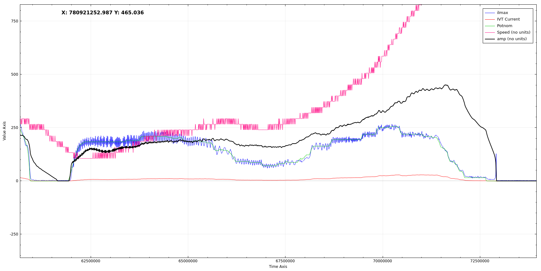

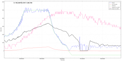

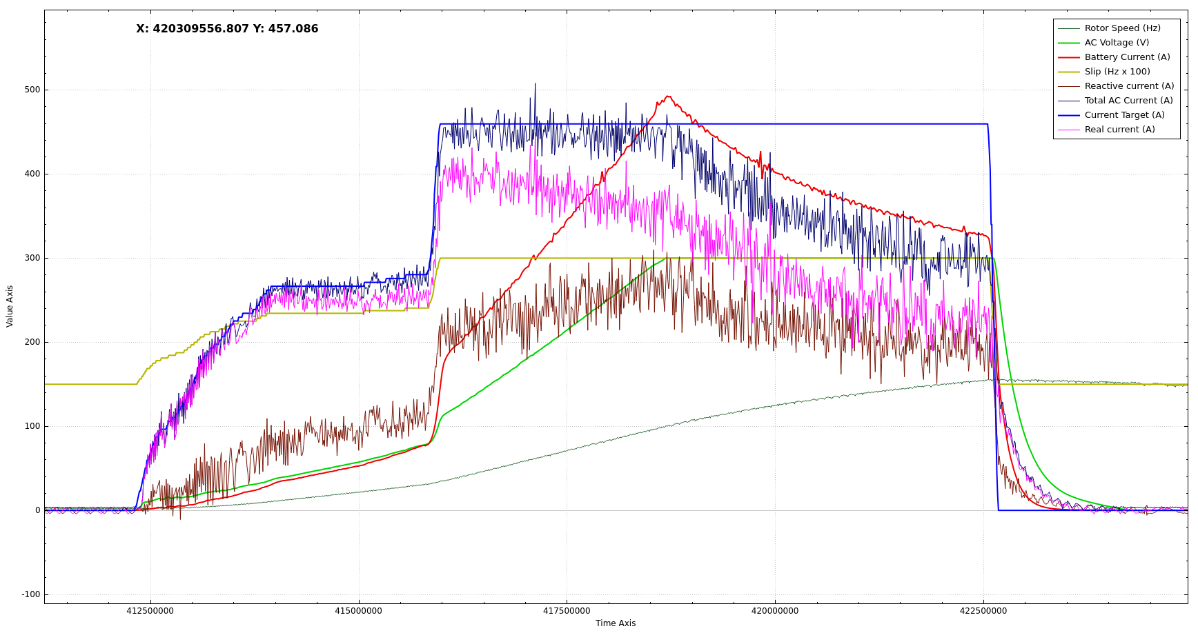

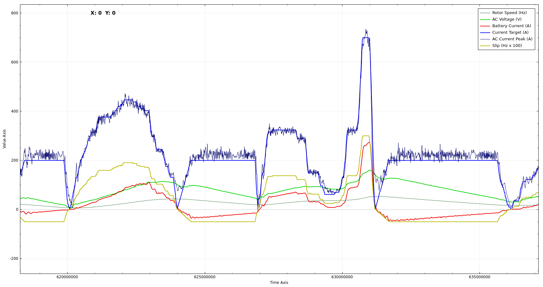

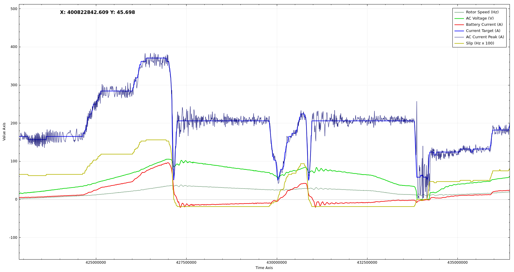

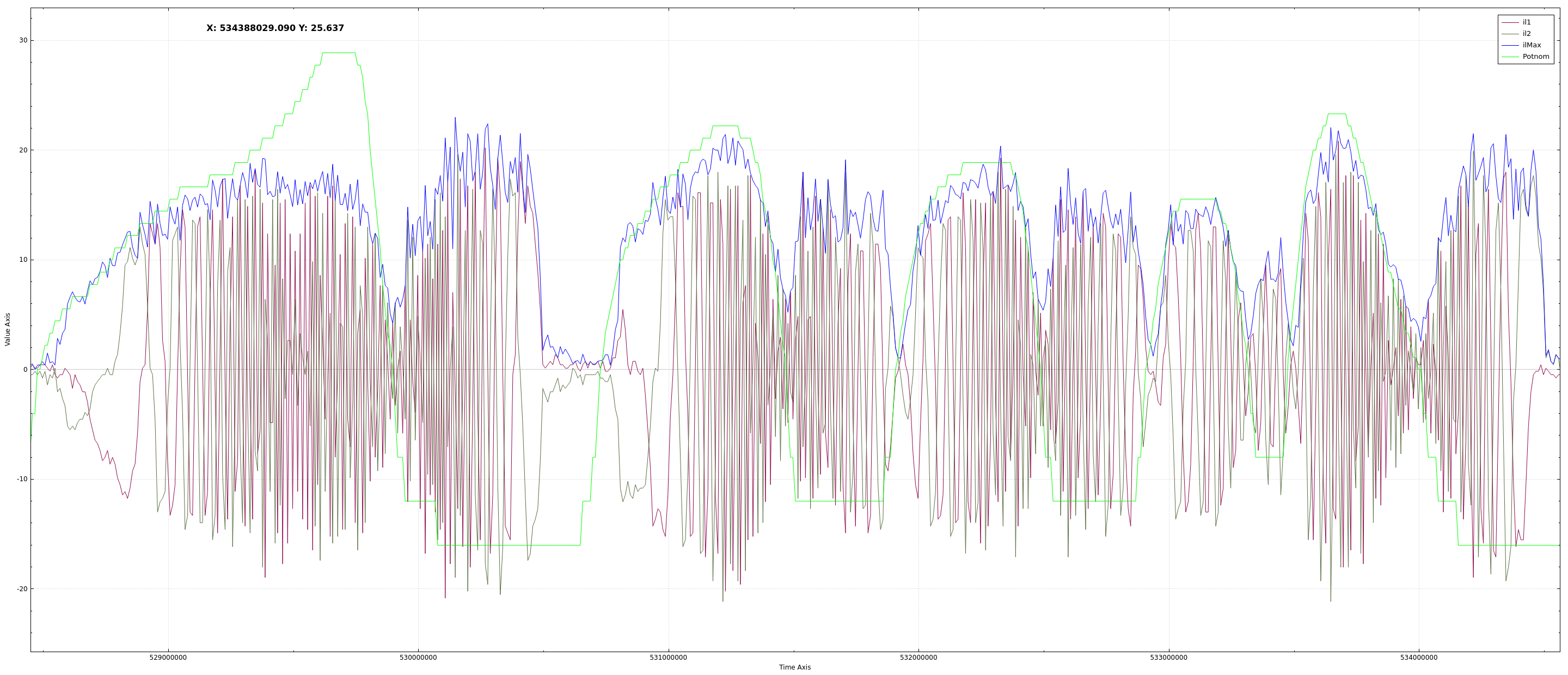

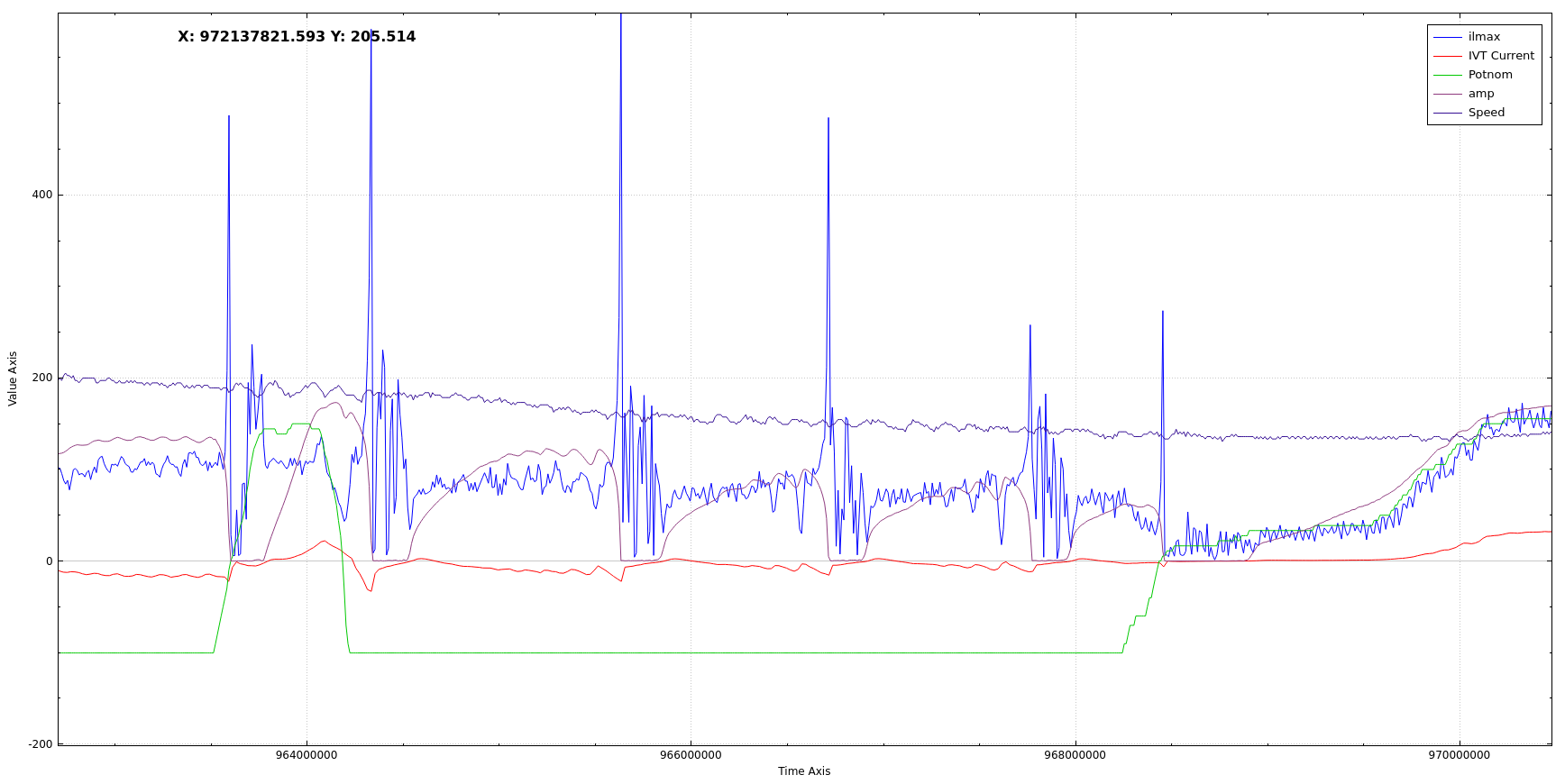

I've made a chart that identifies some oddities in the new algorithm.
The first issue is not necessarily a problem, but a substantial oddity. The black line on the chart (amp) represents the AC voltage. This *should* roughly track speed, to form the usual V/Hz ratio, but in the above chart, it can be seen that the voltage is substantially reduces when the requested torque is reduced, even though speed persists. I don't know why, but I'm of the opinion that as long as the requested slip and current are being achieved, there is no problem here. The most likely explanation is that I have not correctly matched current and slip (there is a correct ratio for these, and i am currently testing at reduced current).
The second problem is the current spike in regen. This chart shows the leadup to the problem more clearly. We switch into regen and the current plot (blue) bounces off zero in a nice triangle that mirrors potnom (yay) and lands at just over 50A as it should (again mirroring potnom's -50). However what happens next is definitely problematic. Because the current is slightly higher than 50A, the PID tries to compensate by lowering the voltage. We see the black line fall, but instead of compensating, exactly the opposite happens. Current rises, amp falls faster, current rises faster, until eventually the process is blocked by amp reaching zero (which shuts down the PWM). What happens next is equally interesting. amp hovers between 0 and some very low number close to zero. My guess is that any time it's non-zero, there is a huge amount of boost happening and the current rises again, so we see a sharp oscillation until eventually amp managed to rise far enough to stabilize things. It certainly seems that low AC voltage (amp) values increase current. I'm unclear how to fix this, except perhaps to revert to V/Hz during regen, but that will really take away from the magic of this.

The slip value I'm using for regen is very small. The previous implementation maintains a minimum value of slip (I had mine set to 2Hz) but this implementation has no minimum, and simply scales slip all the way down to zero. This means that if the maximum slip is 3Hz, and regen is set to 20% (as it is in my examples), the slip value used is only 0.6Hz. Maybe this isn't enough to be stable and we need to push slip higher during regen. Definitely worth testing.Pete9008 wrote: ↑Thu Jan 19, 2023 8:04 pm Edit2 - coming back to pole slipping - or whatever the correct term is, stalling? Wondering if the slip value that you are setting in regen isn't enough. As the amps ramp up they get to a point where the slip isn't enough to induce enough current into the rotor and it slips/stalls/whatever the term is for can't sustain the torque. You can see an oscillation building up in the current control loop just before it happens too. Could there be any bias in the position/speed measurement that effectively reduced the slip frequency for regen?
The rotor field collapsing does seem very possible. However I don't see anything like this happening at similarly low positive torque requests, so I'm not sure why it would only occur in regen.

First of all huge props for getting that far so quickly!
In "V/Hz" mode the V/Hz curve is also scaled between ampmin-100% to obtain different currents. So don't think it's unusual to see large variation there.
Regen, despite being somewhat symmetrical to acceleration has always been more susceptible to oscillation. It's almost 10 years ago but I remember I had to pull a few tricks to speed up frequency calculation to keep regen in check.
If I've understood the structure of your controller correctly it is a pure I-controller (because it iteratively adds an error term to amp) which is a bit slow. Maybe consider using the PiController class and bring the kp/ki to the web frontend for tuning.
Otherwise it's like you assume, more amplitude, more rotor field, more torque producing current, more regen.

That's why I was wondering whether there could be any bias, lag, offset, rounding on any of the position or speed measurement that could affect them differently.
Interesting problem this because you are trying to control both the rotor position/torque and the induced rotor currents (which effects how the stator fields affect the positions/torque) using the same stator fields, not easy!
I'm guessing the volts (amp trace) may drop when you come off the power because the induced current in the rotor is dropping which is then reducing the back emf. Wondering if it this change in rotor current that is also causing the instability, could its effect be out phase for positive torque but in phase for neg torque?

I have a list of ideas to try in the next couple of days to see if they fix the problem.
1) More aggressive proportional gain. It's possible that my controller simply isn't responding fast enough to changes and requires a higher gain.
2) Log ampnom and fslip. Right now I'm not logging the target current or the slip, I'm just making assumptions about what these are based on throttle position.
3) More slip during regen. Maybe regen is different to forward torque and just isn't stable with low values of slip. Using higher values of slip always hides issues caused by inaccurate or laggy rotor speed measurement, at the expense of a little efficiency.
There's one additional issue with the implementation that needs thought. When requested torque is zero, slip is zero, target current is zero, and actual current is near zero, the amp value just floats around because there's no error to correct (actually it reduces gradually to zero). Its value essentially doesn't matter and in practice it seems to quickly snap back to where it should be as soon as any torque is requested, but it feels odd that when idling we apply an essentially random voltage. I feel I should add something to naturally pull amp down when it's not actively required.
This can be seen here: Interestingly when amp eventually does fall to zero, it causes a little current spike.

I'd guess it's remenant magnetic flux in the rotor causing a back emf, if so not sure there is a lot you can do about it other than wait for it to subside?
Edit - ignore me, the rotor is stationary, think I'll stick to PM motors and leave you to the inductions ones - they're too difficult!

The rotor is actually spinning. But because the slip is zero, current is zero.Pete9008 wrote: ↑Thu Jan 19, 2023 10:37 pm I'd guess it's remenant magnetic flux in the rotor causing a back emf, if so not sure there is a lot you can do about it other than wait for it to subside?
I just realised, the fact that voltage gradually falls to zero like this is probably not random or accidental, this is probably a correct reaction to the decaying rotor field and we're matching voltage to back EMF to keep the current zero.

Which bit of the plot are you referring to? I was looking at the last bit of the second plot where speed was 0 but the amp trace was still high and dropping.
If the rotor is still spinning then remenant flux will cause a back emf.
- catphish
- Posts: 955
Sorry, I think this is just my poor choice of chart colours. In this chart, the visible line that goes to zero is IVT current. Speed is off the top somewhere.
