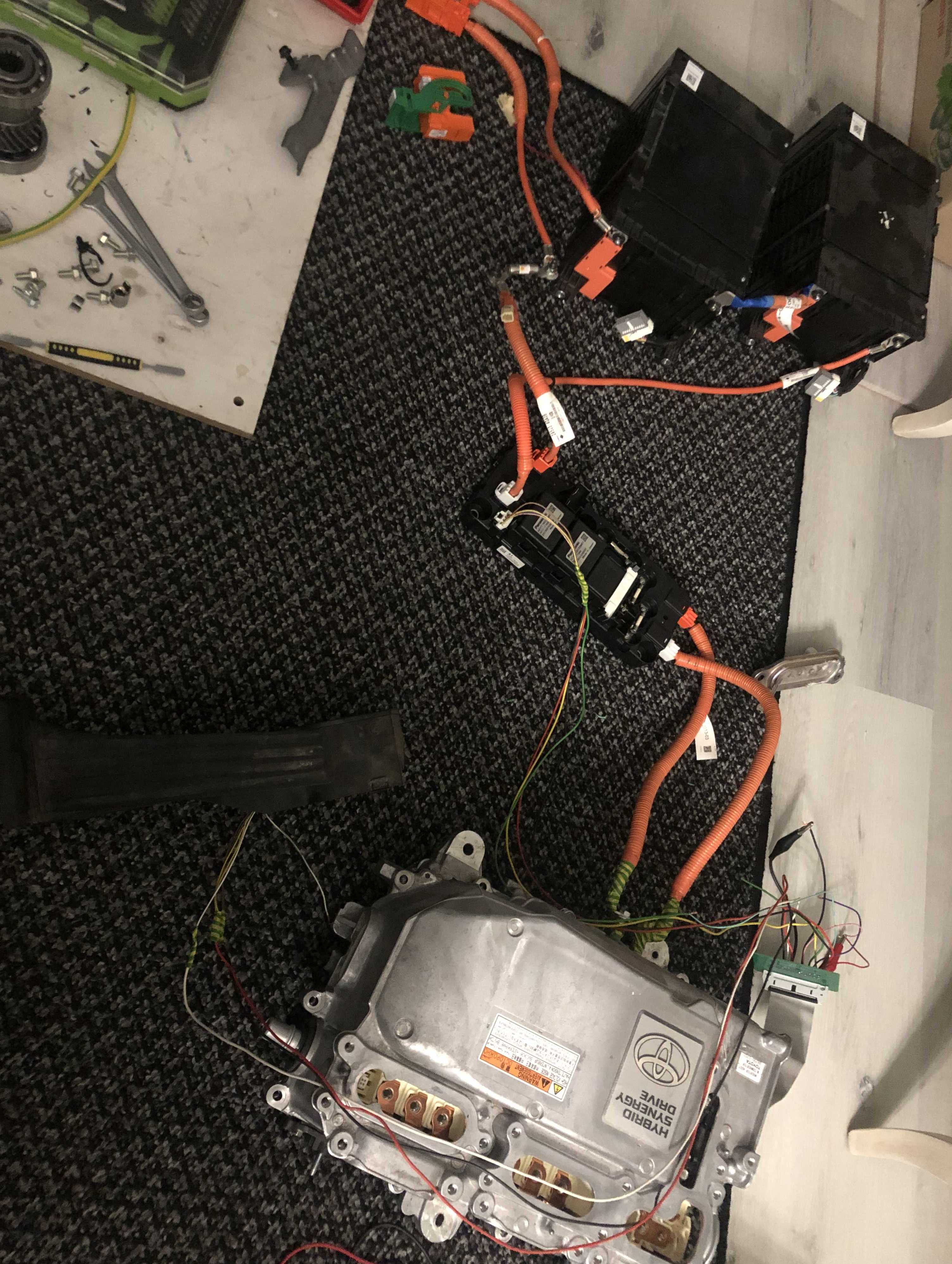

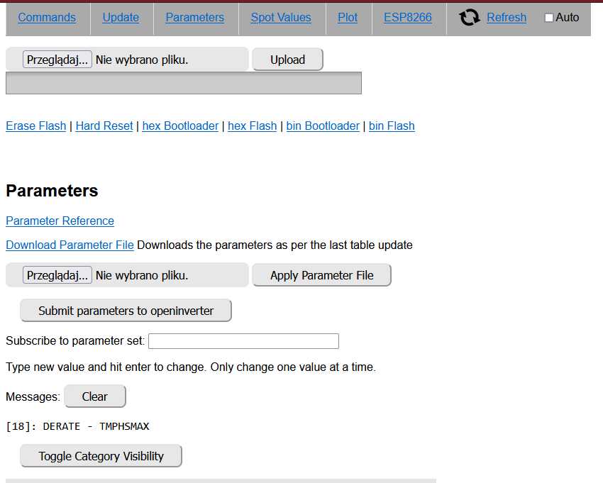

When I run it, I get the error [18] DERATE-TMPHSMAX. The small_dual_v1d board has the latest soft stm32_sin loaded, only the gas pedal from BMW is connected.
bexander
Posts: 835
Location: Gothenburg, Sweden
Has thanked: 63 times
Been thanked: 89 times
Re: Auris/Yaris inverter
Post by bexander »
You get a heat sink temperature derate. What heat sink temperature sensor have you selected? I run "snshs": 1 i.e. "semikron". Seem to work well for the toyota inverters.
And what does your heat sink temperature read? "tmphs" under "Spot Values".
youngpoland
Posts: 26
Joined: Sun Feb 05, 2023 10:04 am
Has thanked: 14 times
Post by youngpoland »
thank you very much for the hint. change "snshs": 1 i.e. "semicron" helped. I am very grateful for your help
