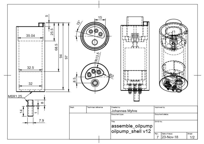

The ford Ranger EV has a brushed oilpump inside the motor.
These wear out rather fast, and are quite a big job to change.
I have got a company to machine a housing for a new oilpump with brushless motor and a gerotor pump.
They are made to fit inside the motor, but need some new wiring (3 phase) and a external controller.
Have worked in 4 trucks now for over a year. And another one in a test setup with twice the pressure 24-7.
Price will be 600 to 800 (EUR), this depends on how many I order in each batch.
