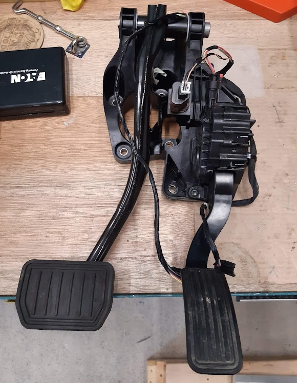

Hi All,
So I got one of these Tesla Model 3 combo units off ebay because.. it was cheap!
So I've hunted around and haven't had much luck in finding a pin out/wiring diagram for this unit - there are others out there that are similar with the 6 wires - so dual +ve, Gnd and wiper but not with these same colours. Has anyone maye used one of these successfully? If so, maybe you could share any pin out info?

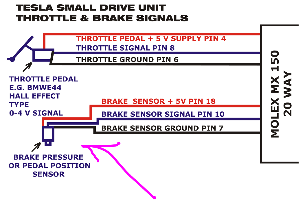

I would also like to go the variable regen route like this for the SDU:

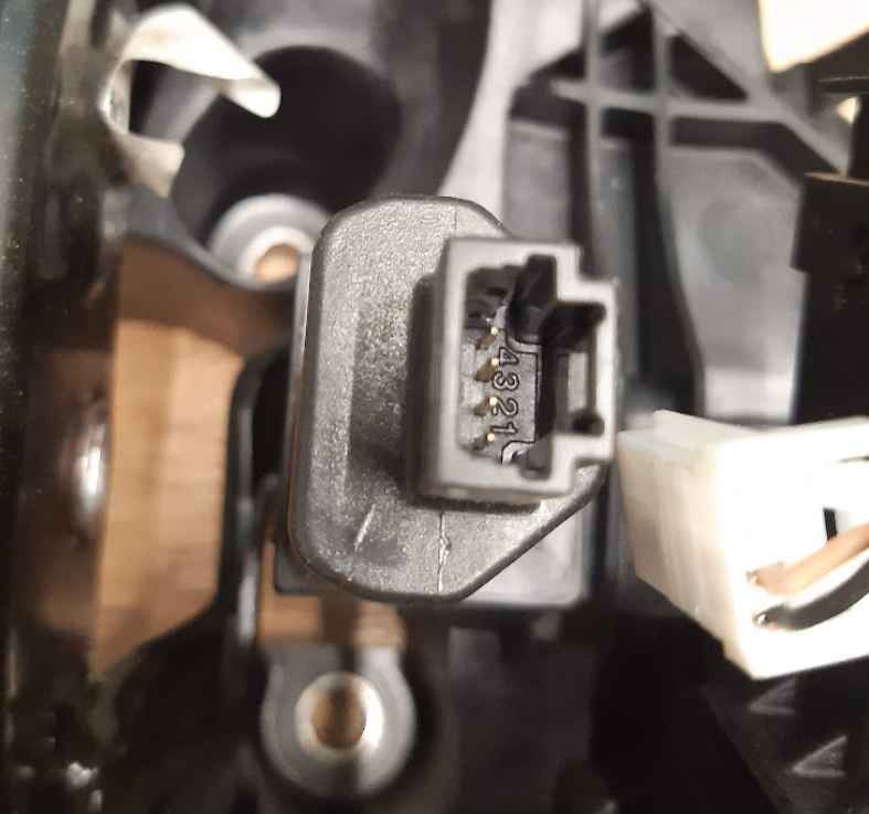

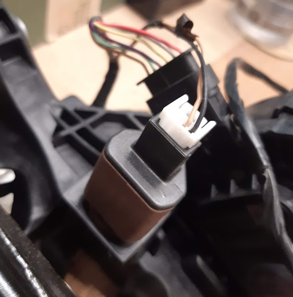

And the brake pedal sensor has 4 pins in it but only 2 leads are connected:
I tried looking up the sensor part number to get some info but not much luck.
So I wonder if this could be configured to give a variable output using the other 2 available pins?

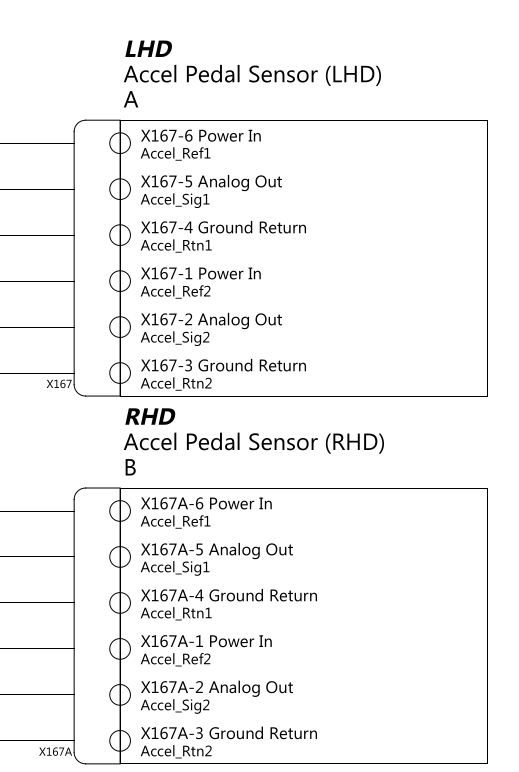

The Tesla M3 service manual is out there on the Internet. You'll likely have to torrent it (but I couldn't possibly comment). It has wiring diagrams which show the wiring of the two types of pedal:

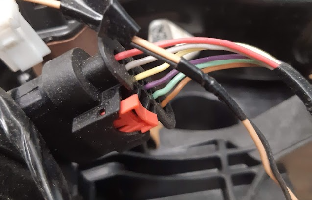

So I figured out a bunch of the info from this great video from Ingineerix here:
I then stuck 5V across the relevant pins and made this short video where you can see the voltage returns on the 2 return pins:
Hopefully it's helpful!
I still want to fiddle around with the break switch which just has 2 out of 4 pins used at the moment - I wonder what the other 2 pins are for? :)

davefiddes wrote: Wed Jan 11, 2023 4:53 pm Did you find the Service Manual OK?
No, I did a bit of hunting but then figured out what pins are what from the Ingineerix video - so I think for my conversion I will use ones that go from 0.8V > 3.8V. Hopefully that works!

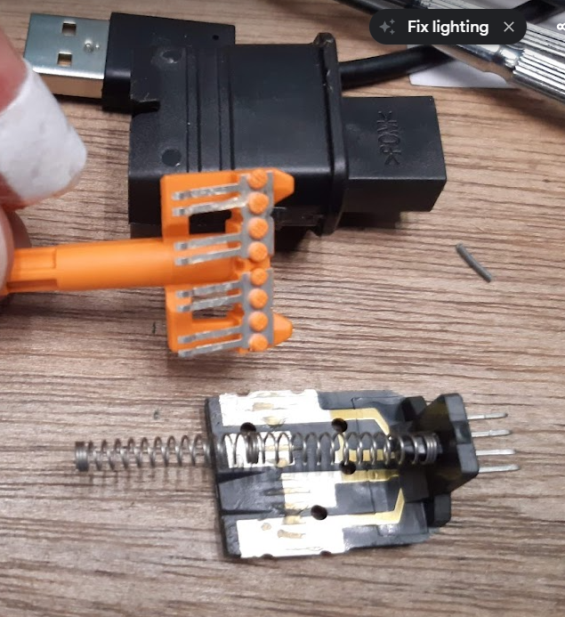

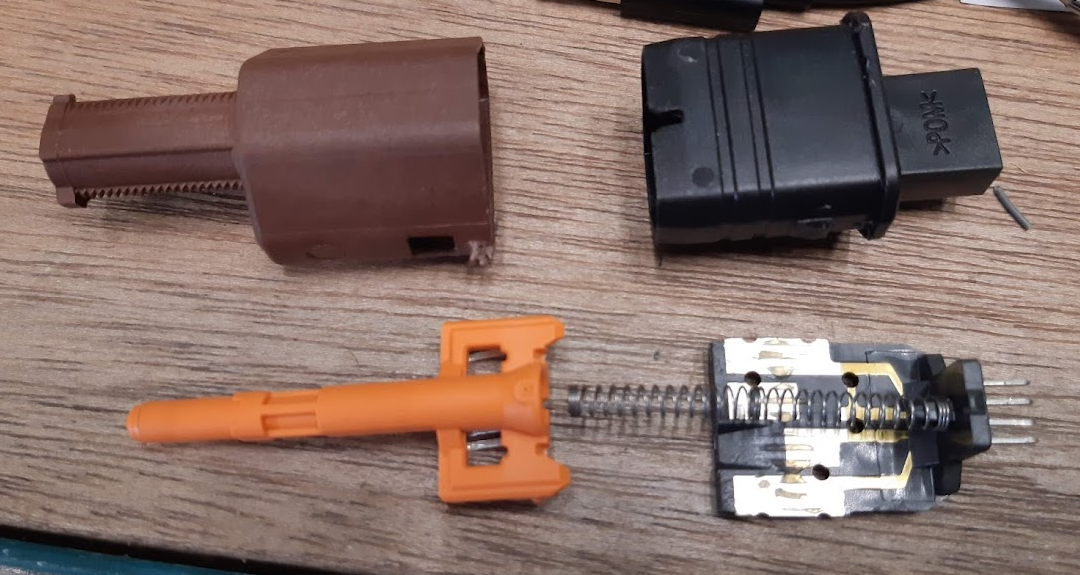

I opened up the brake pedals switch out of curiosity and inside its just a sort of slider switch with 2 sides - NO/NC:
Hopefully useful for others who might wonder about it too. :)

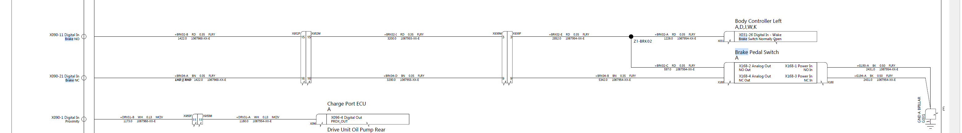

alexbeatle
Posts: 276
Has thanked: 71 times
Been thanked: 28 times
Re: Tesla Model 3 Combo Pedal Pin Out?
Post by alexbeatle »
This is how the brake switch is wired...
