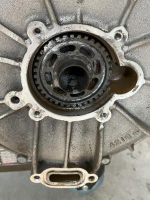

After a years hiatus from posting, I have a couple of new updates. The first is that the car is running well on a 300V-76 cell KIA SoulEV battery pack. It was originally a 400V-96 cell pack, but through some ignorant stupidity, I damaged two of the original four modules. The pack is controlled by an Orion2 BMS that works very well. So far, the only downside is the reduced range. I put the car to bed for the winter.

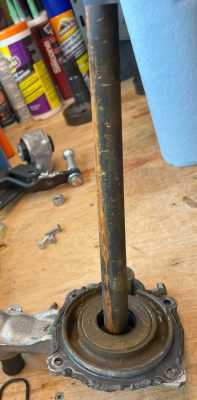

In late February as I was a getting ready for this years driving season, I noticed the motor was quite a bit noisier than when I put it to bed. Using a stethoscope, I found the most noise coming from the motor barrel. I did not find any concerning noises coming from the gearbox. I drained the oil and didn't find any coolant in the oil as it was also still red & clear. When I removed the motor cooling pipe end cap, I found the encoder wheel and surrounding area wet and rusty. There is a slight score on the rotor shaft pipe. Since this is a well documented problem with these motors, I know what the next steps are. For rotor removal, can you remove the motor rotor from the stator without disassembling the gearbox? I was thinking of lifting the entire unit vertically with the motor on the bottom and gently "dropping" the rotor out of the assembly. I have seen previous posts that "dropping" the rotor has been done. Any downside to trying this?

Further update on motor rebuild - I have order 2 new ceramic motor bearings and a triple lip seal. The motor shaft is a little rough so I have ordered an SKF Speedi-Sleeve to go over the area where the old sleeve ran. I am cleaning up the water damaged parts and getting them ready for reassembly.
See second pic for motor rotor condition.
I am wondering what is the best way to clean the inside of the stator. I was thinking of using alcohol and lots of elbow grease. Do I need to clean out all the grooves in the stator? See first pic.
I have ready a few threads about removing the entire rotor cooling pipe altogether. I’ve seen a DIY solution from Kein Erickson, and two commercial solutions from Revolt Systems & QCC. Does this mean the seal in question is no longer needed? Will it effect rotor cooling?

by Boxster EV
I recommend the manifold delete.

by canadasconvert
It took awhile for me to come around to buying the Manifold Delete, but I just bought the Revolt unit last week. Looking forward to getting the car back on the road.

by canadasconvert
I've installed the Manifold Delete and have put about 100KM on the car. I'm watching the motor temperature and cooling fluid temperature very closely to see if there are any concerns. So far the motor temperature has peaked at 57C after a couple of +100km/h driving stints. The temperature comes back down again and hovers around 40C during normal city driving.
