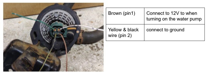

Hi guys
Can anyone please advise me on how to control Nissan Leaf coolant pumps.
I'm in the process of installing the cooling system and just realised they need to be controlled, maybe by PWM
I found the photo below on the Nissan Leaf forum from Dala but there was no further explanation. https://www.mynissanleaf.com/viewtopic.php?t=31574
I have two of these pumps so it would be nice to use them if possible.
Also any advice on how to plumb the system gratefully received

Looks like the same pump as the Tesla pump so you can try that control scheme https://www.evcreate.nl/using-tesla-the ... tesla-pump

Great call, I'll try that as soon as I figure out how to create the PWM signal.larsrengersen wrote: ↑Sat Dec 24, 2022 10:33 am Looks like the same pump as the Tesla pump so you can try that control scheme https://www.evcreate.nl/using-tesla-the ... tesla-pump

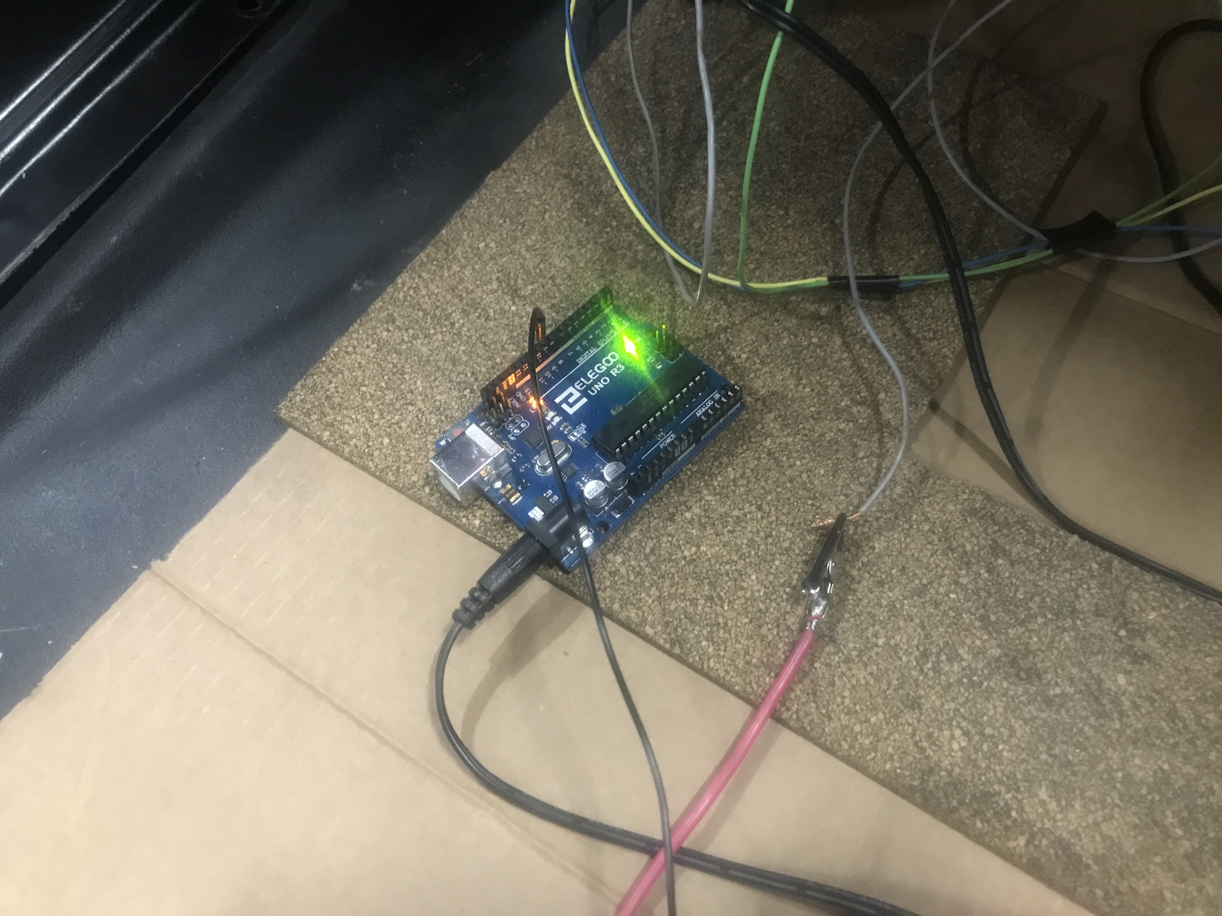

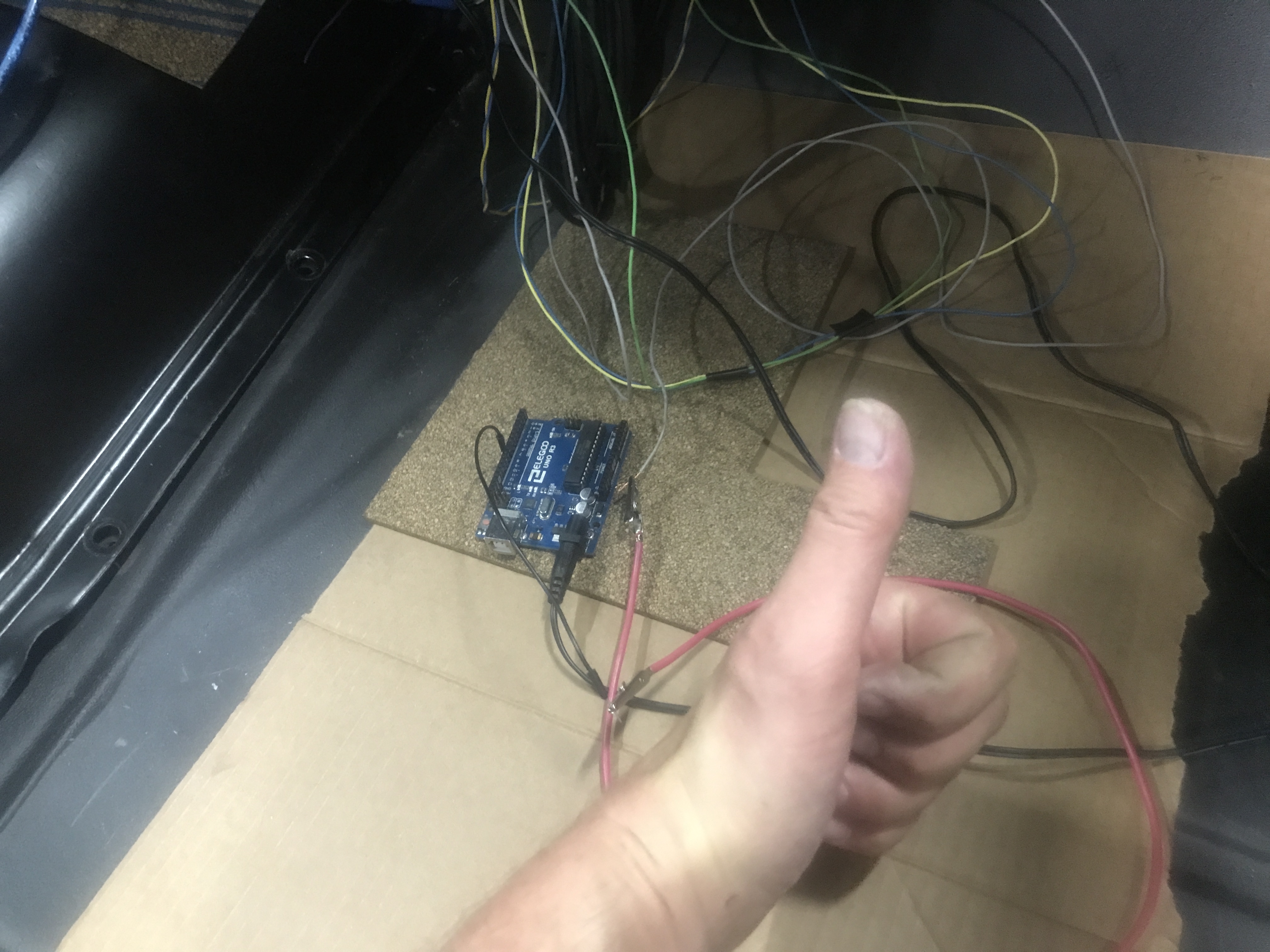

just wanted to say thanks, and prove with pics that your work, was put to good use, this is great, thank you for sharing the code / solution

Glad it worked for you. Did you make any changes to the code?
I was using an Uno to switch relays and control ignition timing so it was fairly simple to incorporate the pump code into the ignition code.
I suspect a Nano would work equally well and be a bit smaller.

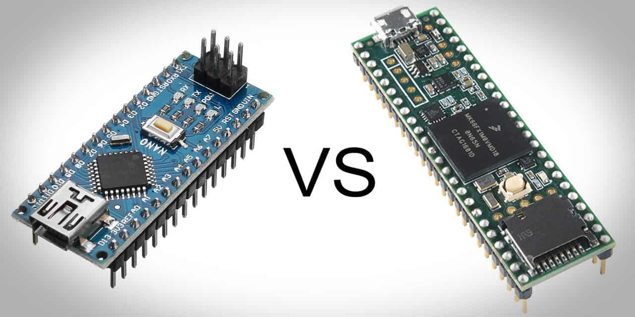

How about a Teensy?Alibro wrote: ↑Fri Jul 21, 2023 2:34 pm Glad it worked for you. Did you make any changes to the code?

small, more powerful, and run Arduino code using Teensyduino no you can't make this stuff up !

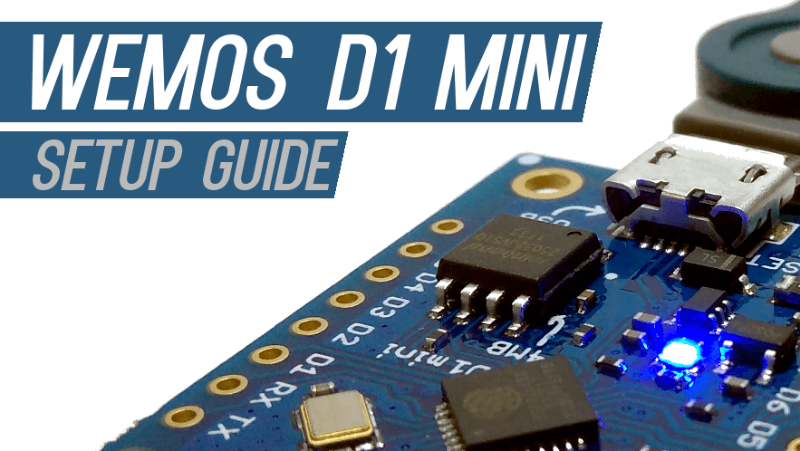

FYI if you try 'n save a few bucks and buy a knock off arduino UNO like the WeMos D1 you'll end up having to jump through hoops in order to get Arduino IDE to recognize your board and then in order to compile and upload the code, I decided to try the WeMos D1 card just cause it has the solder through pin holes in the board so that I could hard wire that PWM wire, but I gave up

Apologies if this is teaching your granny to suck eggs but it took me a while to figure out the first time I bought an Arduino clone.
Many of the Arduino clones have a different USB adaptor to the real ones so if using Windoze you need to download the driver for them as Windoze is too stupid to have the driver included. A quick Google will find it but the chip is CH340/Ch341.
Also you may need to select Nano then select ATmega328P(Old Bootloader) to get the sketch to upload.
