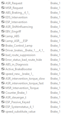

Does any one happen to have a can bus log from a VAG car engine can bus with the engine not running and then starting it?
While I have no dash warnings, I'm not convinced my ABS is working as it should and I wasn't smart enough to take a log before removing the engine.

The ABS is broadcasting it's own can messages, so I'd assumed it was working. Had a colder winter this year and ice so far so was able to test and lock the wheels up.
I'll consult the wiring diagram incase I've missed something obvious.

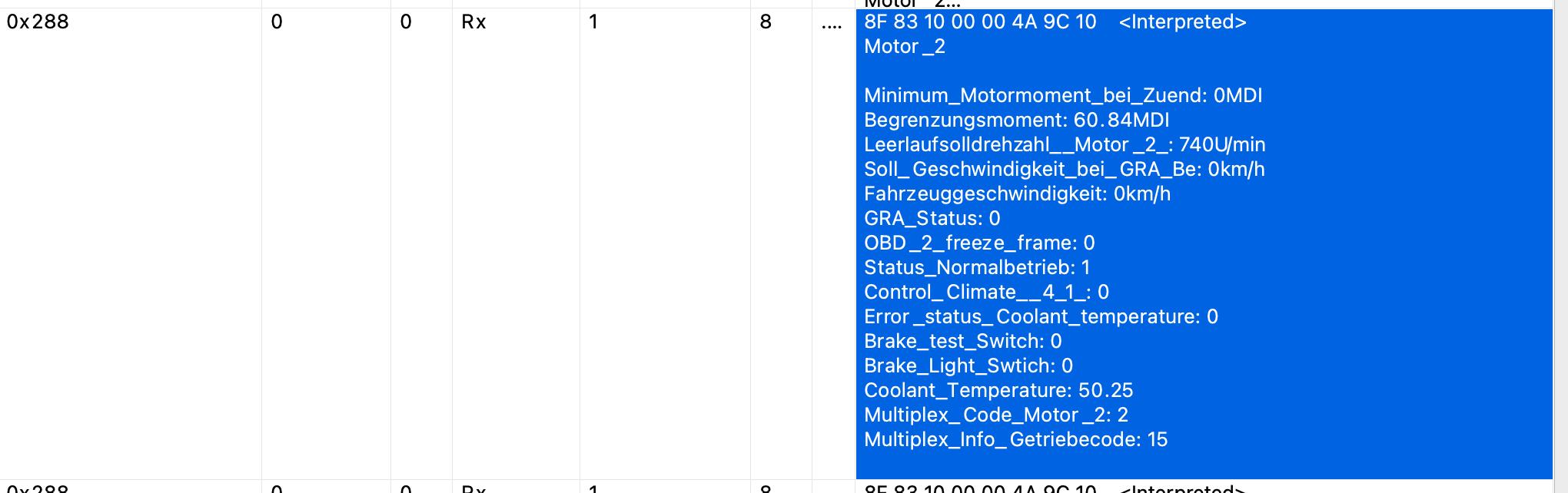

- Been thanked: 1913 times
Re: VW Can Log with Engine running
Just realized I took one single log file before pulling the engine. Hope it's of some use

on the mk3 golfs the ABS was completely independent , on the mk4 golf (same as the beetles) the ABS should still be completely independent its only if you have a ESP where it would listen for engine information (rpm, torque) to then send out torque limitations (when required).
I do have ESP, but I'm sending the RPM, I think I might be missing the torque though. Thanks for the log, will have a look
I notice on your log for 0x288 Which I'm not replicating, I need to navigate the german in the DBC and experiment when we get ice again.

as far as i remember the ABS works without many additional canbus messages,(defiantly standalone on the mk3 golfs) the ESP sends out max torque request to the ECU which you don't have so just getting ignored. i cant remembered if it looks for a reply from the ECU.
so your abs should work, your ASR might and ESP probably not doing anything. would be a nice add on to the inverter to read the signal and reduce max torque at the wheels when needed.
